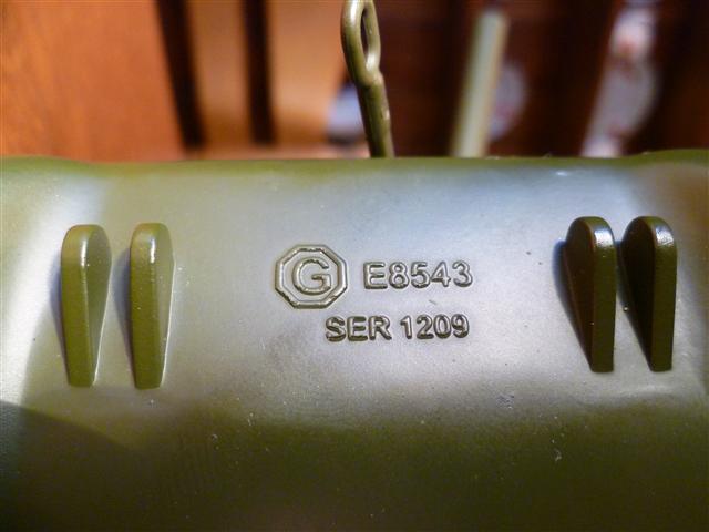

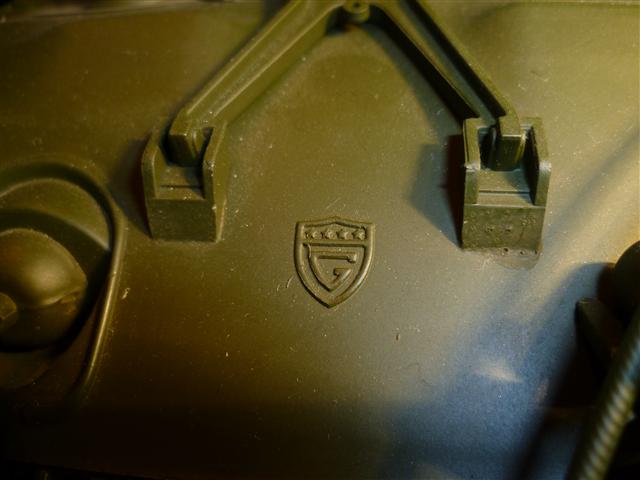

General Steel Casting Corporation Foundry Mark On Hull
General Steel Casting Corporation Foundry Mark On Hull..JPG (44.14 KiB) Viewed 3257 times
American Steel Foundry Mark On Differential Housing Along With Part Number And Casting Serial Number

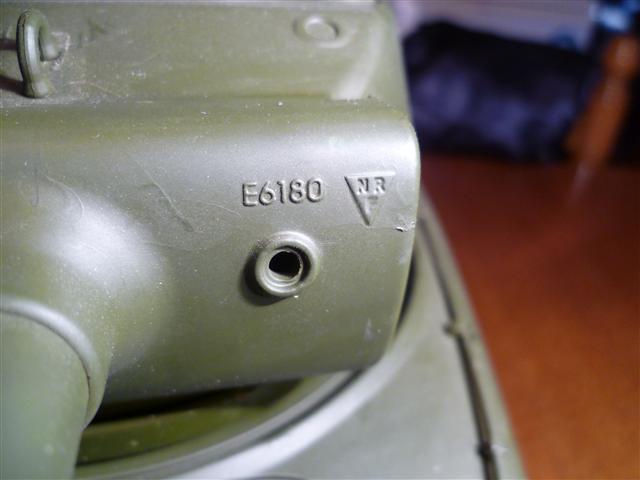

National Roll Foundry Mark & Mantlet Part Number
National Roll Foundry Mark & Mantlet Part Number..JPG (40.76 KiB) Viewed 3257 times

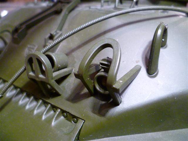

All the lifting rings will be replaced as they are wrong shape and fixing as will guards around the lights and siren which are not of the right type fitted by Pressed Steel Car.

The Light & Siren Guards Are The Wrong type & To Thick
According To Pictures & Records There Sould Be A Lifting Ring Roughly Halfway Along The Turret Edge On This Side
Area Of Missing Lifting Ring..JPG (49.71 KiB) Viewed 3257 times

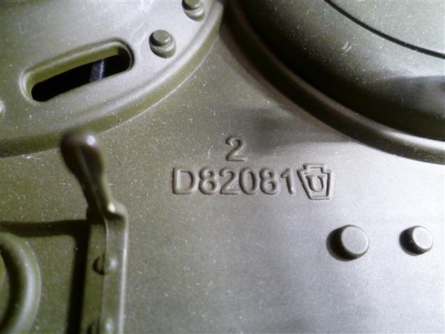

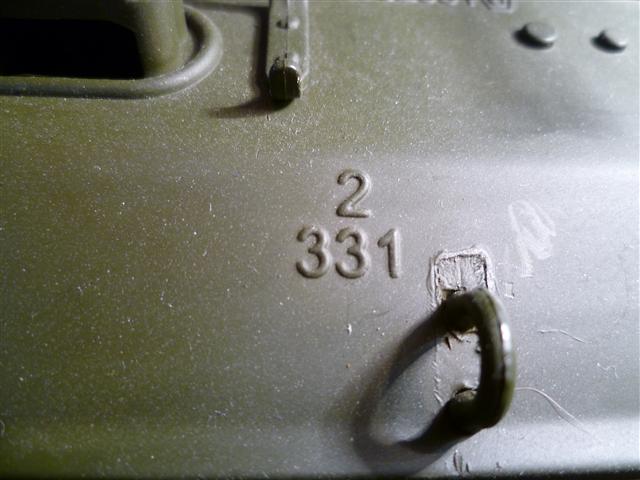

Part & Serial Number On Turret Side
Part & Serial Number On Turret Side..JPG (38.49 KiB) Viewed 3257 times
Part & Serial Number On Turret By Front Lifting Ring

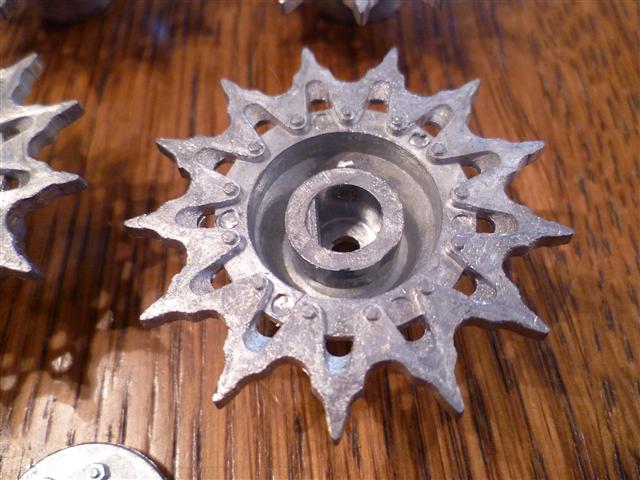

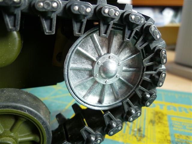

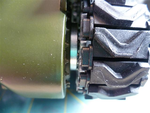

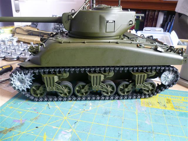

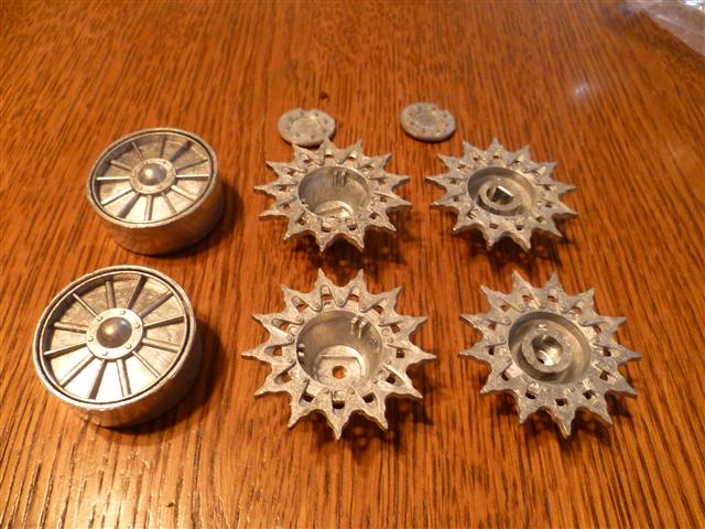

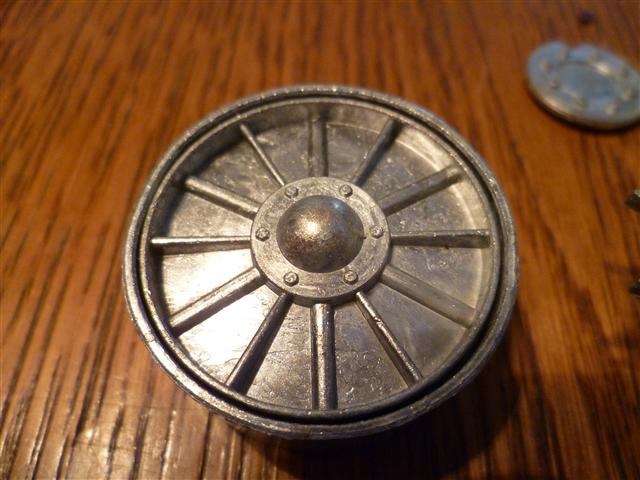

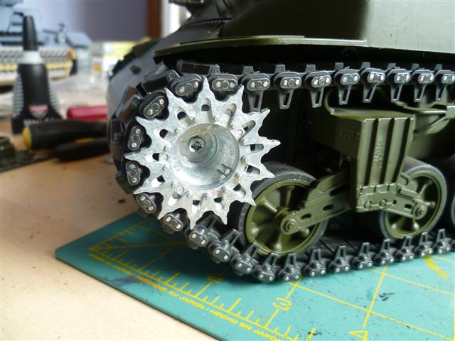

Just a quick update with a few pics. I have upgraded the idlers and drive sprockets ( courtesy of Forgebear ) with metal ones and installed drive shaft supports as well. The drive shaft supports needed a bit of persuading to fit and the motor housings needed to be adapted to allow the nuts for the supports to fit. The only problem I have now is the LH track picks up on the drive sprocket in one spot as the Sherman is driven. Not sure whether to try and cure it or wait as the next upgrade will be the suspension and track being changed for metal.
Driveshaft Support In Place..JPG (46.37 KiB) Viewed 3190 times

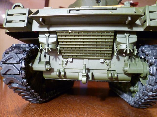

There is one thing that everyone seems to disregard. That is that the transmission cover casting is incorrect and extends out past the front of the tracks. The fix is really simple and greatly improves the tanks appearance. To correct that take the cover off cut out about 3/8 inch strip from the cover somewher in the flat section before the casting begins to curve then use a hot iron to put the two sections back together. Cut off the pieces that on the sides that fill the space between the front of the cover and the tank lower hull transmission castings. Now with your hot iron heat the trans cover casting on its inside just above the point that the covers curves start, enought that it can be bent to match the curve of the hull. Quickly put the trans cover inplace and bend it untill it matches the curve of the hull. You will now have a tranmission cover that is just prodruds ever so slightly less then the tracks. You will also have the bottom of the cover at the wrong angle so you must again heat the cover but this time at its bottom and bend it up to match the hull. When done the two screw holes that attach the cover will be in correct place and the trans cover will fit just as it originally did but with out it jutting out in front of the tracks. A little filling and sanding on the face of the cover, putting the tow cable holder ins its new correct position and your done. it took me about an hour to do mine and it really makes a difference for the better in the look of the tank.

You are right about the transmission cover being to proud and it is on my list of "things to do". Thanks for the advice on how to do it I'm sure it will be helpful. At the moment I'm upgrading the suspension and tracks ( pictures to follow ) with a view to getting the running gear working properly before I start work on correcting faults on the chassis. I will try to get on the forum more often but with work and one or two things in the house to finish off ( you know what wife's can be like ) I have been distracted but not for much longer.
