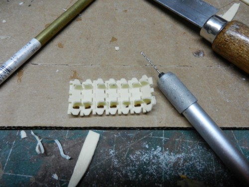

negatives: no metal hull/suspension/wheel kit/tracks available for easy RC conversion. 200+track links have to be hand drilled for pins(not included). links can be glued but hard to glue and set in correct position w/Ca glue. these links will not work for rc..too brittle. slightly warped barrel, easy to make one from brass tube.

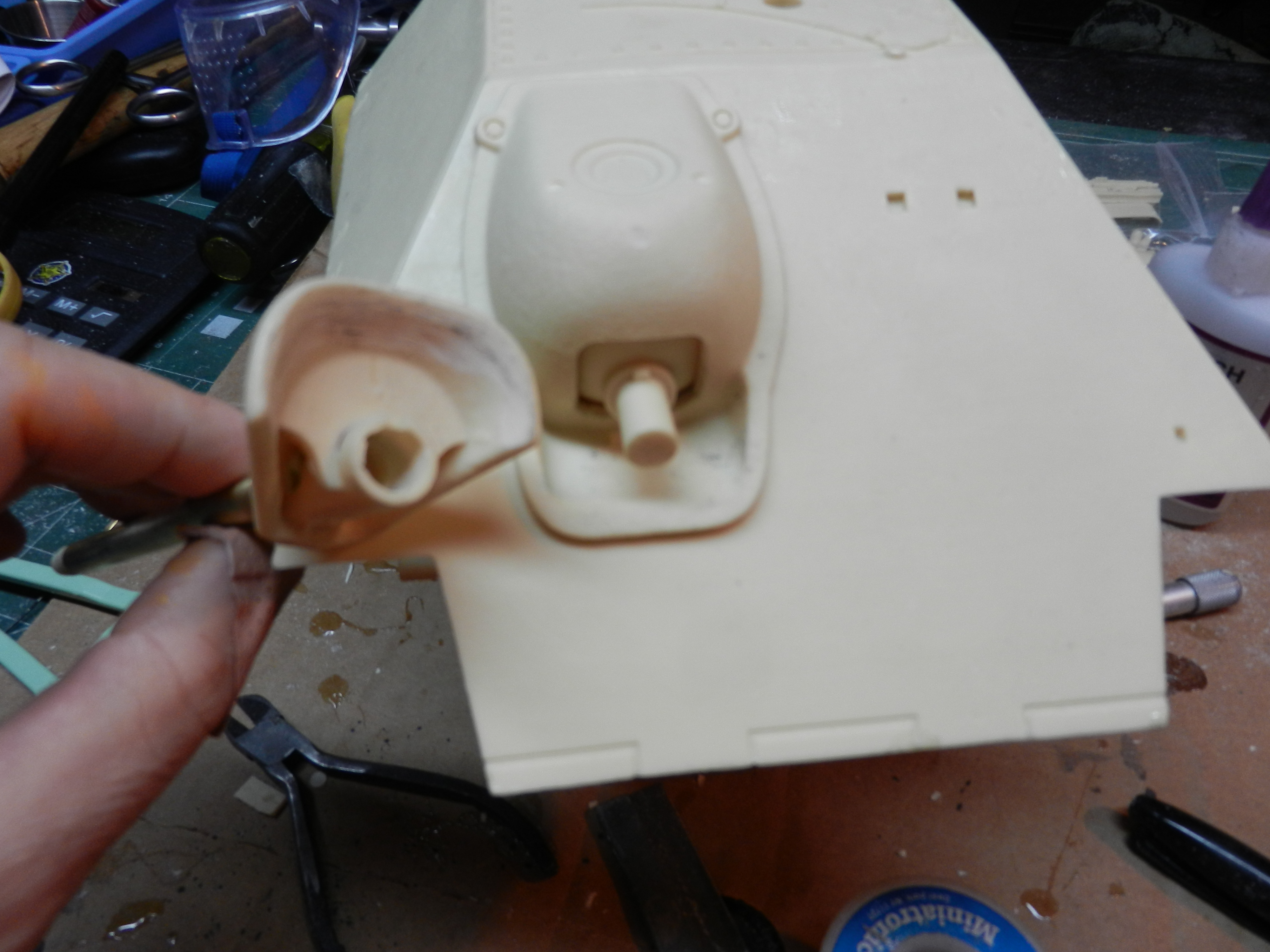

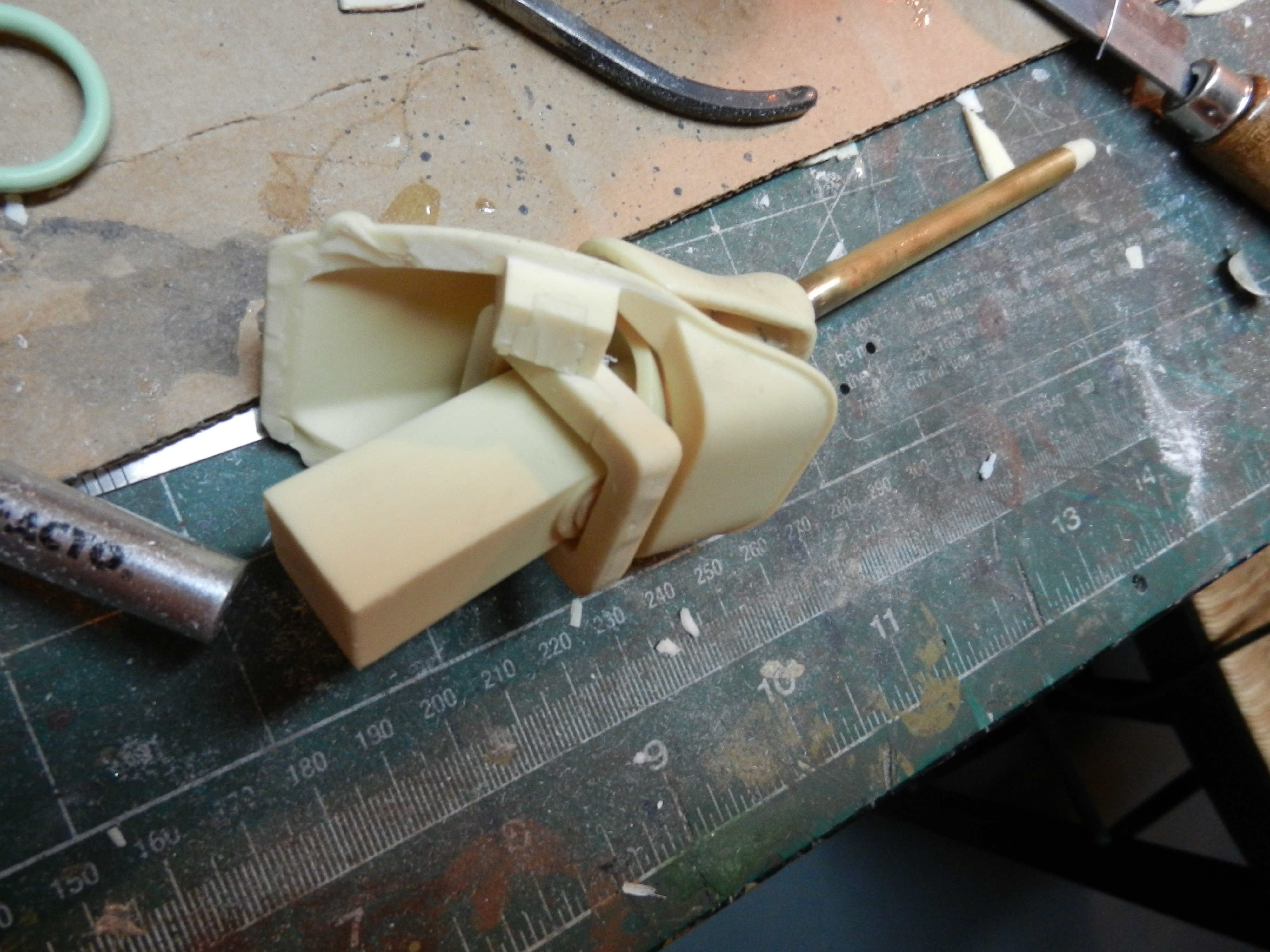

Any chance you can snap some shots of the gun setup? Is it set up for multi axis movement?
Re: XRAD'S HETZER
yep. Very nice mount system..Simple, compact and multi axis. i will post some pics....
Re: XRAD'S HETZER
pics of mount..could be rc'd with some micro servos

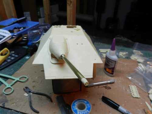

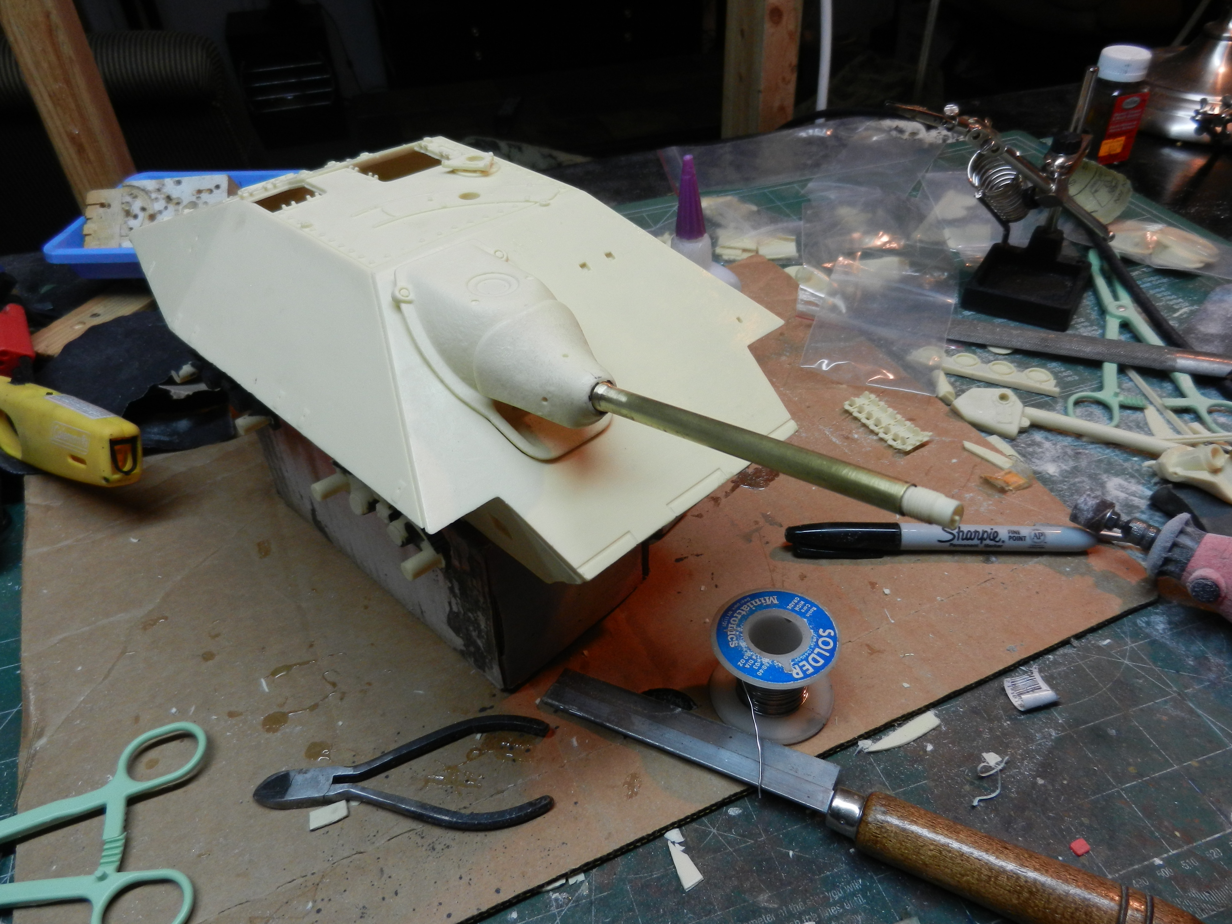

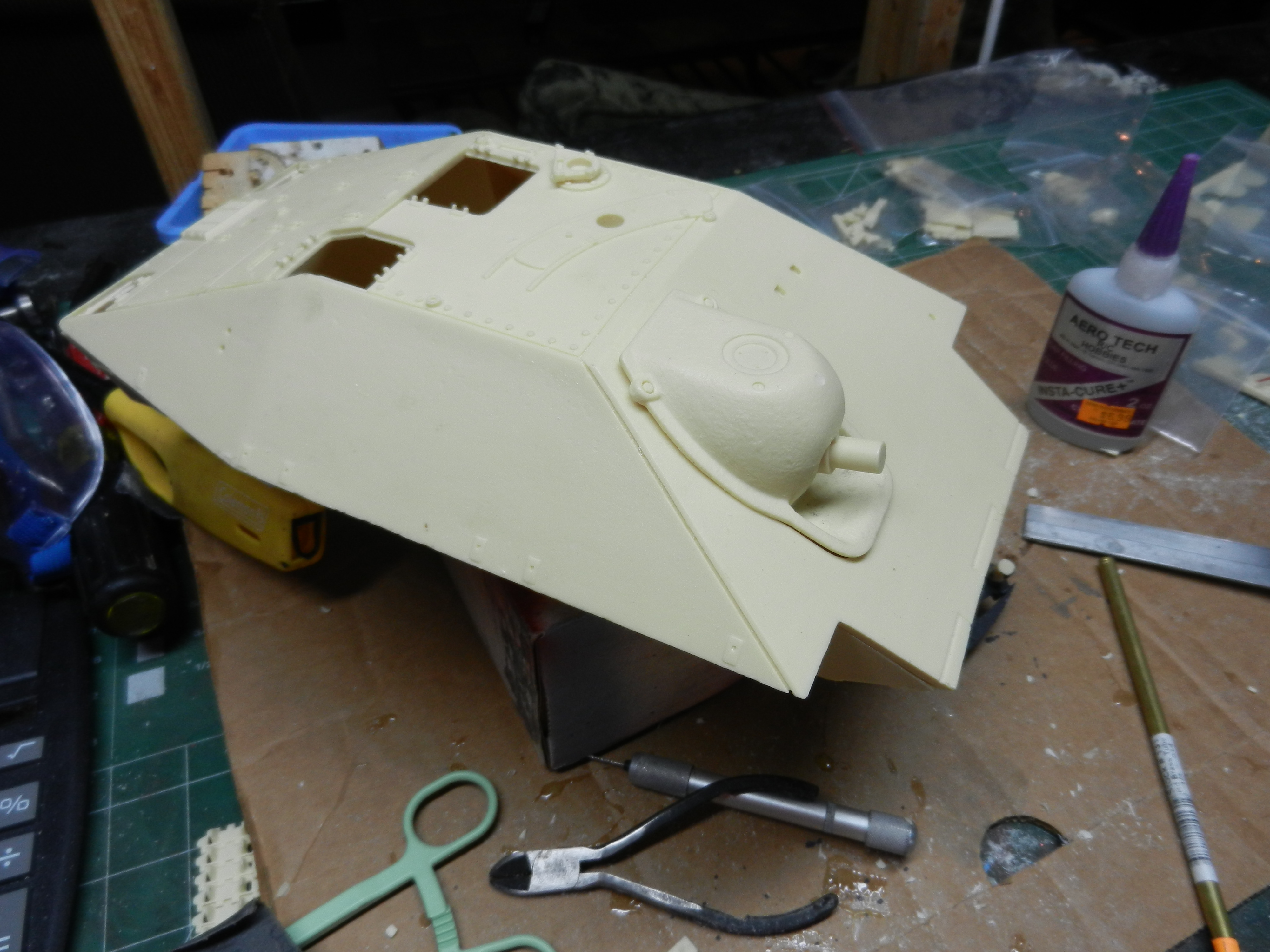

I made a two part brass barrel due to warped resin one. I kept the screw tip for brake ...
