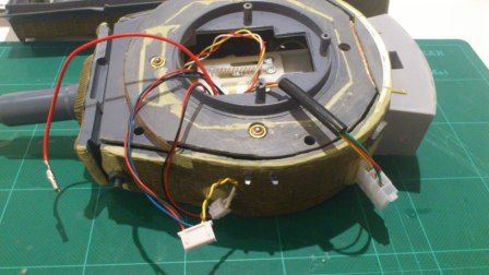

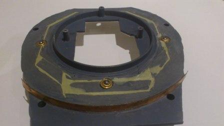

First off here’s a few pictures of the remaining work on the turret ring, etc.

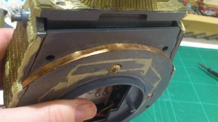

Close up of inside of turret showing lower and upper sides attached.JPG (14.17 KiB) Viewed 24461 times
Brass strip covering joins between upper and lower turret.JPG (18.98 KiB) Viewed 24461 times

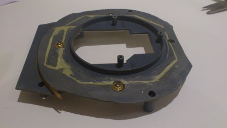

Taking my lead from other postings on this site I decided that the turret needed some extra stabilising where it sits on the hull. This is especially necessary if, like me, you are replacing the bb gun with the Asiatam recoil unit because the metal barrel makes the turret rather nose heavy. I was also keen to try and disguise the fact that the (relocated) turret ring is still far too small.
First I acquired some of those sprung ball catches which are used to keep cupboard doors shut. I drilled four holes in my turret base and then glued them in place with copious amounts of glue and short lengths of brass tubing used as sleeves where they protruded above. In the end I decided that the rear one wasn’t needed.
Three ball catches in place - they are placed so that they will run inside the new ring on the upper hull.JPG
Three ball catches in place - they are placed so that they will run inside the new ring on the upper hull.JPG (12.32 KiB) Viewed 24461 times
Side view of ball catches on underside of turret floor.JPG (21.68 KiB) Viewed 24461 times

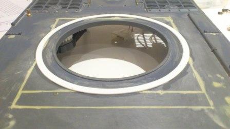

These were placed so that as the turret revolved they would run around the hull top. I order to hide them – and to give the illusion of a wider turret ring when the turret was viewed from the side – I then cut out a plastic ring of the right diameter which I glued to the hull top. Note that this is not supposed to be the turret ring splash guard which was fitted to late model Tigers.
False turret ring cut from plasticard and glued to hull top.JPG (17.65 KiB) Viewed 24461 times

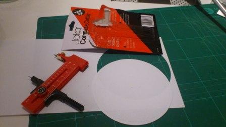

Incidentally, I found an excellent and cheap compass cutter for this purpose made by Jakar – the same people who made my cutting mat. For us Brits it’s £4.25 including postage on Amazon:
It is a little light to cut into thick plasticard, but the trick is to use the blade to score deep enough so that you can then separate by gently bending the card.
This compass cutter is made by Jakar (who also made my cutting mat). It's very cheap and, with a bit of patience, can cut very neat circles.JPG
This compass cutter is made by Jakar (who also made my cutting mat). It's very cheap and, with a bit of patience, can cut very neat circles.JPG (16.18 KiB) Viewed 24461 times
NOTE: Later on I found that, although the plasticard ring made he turret revolve smoothly, it also made it sit too high. So I removed it and all of the ball catches apart from the one at the front. The turret revolves fine...

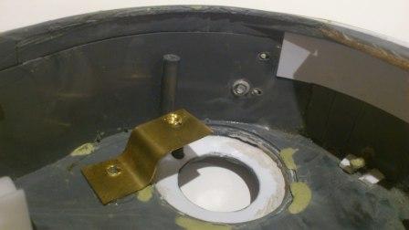

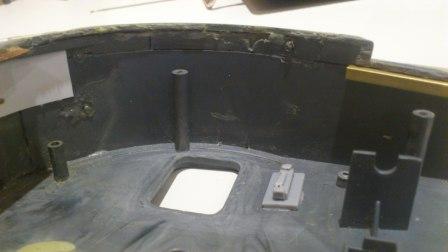

Now I needed to make two structural alterations to the inside of the turret. Again these were for the installation of the recoil unit. I will deal with the actual wiring of this in due course – having only just mastered it myself!

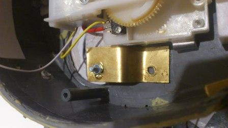

Because I had removed the old commander’s cupola I had also lost one of the internal mounts for the old bb hopper. This is supposed to be one of the anchor points for the Asiatam recoil unit. Here I improvised by bending a thick piece of brass strip into a rough ‘S’ shape, gluing one end to the turret roof and drilling a suitable hole in the other. I then used a small nut and bolt to attach the recoil unit.
Inside turret showing brass strip bent to replace the missing mount for the recoil unit.JPG
Inside turret showing brass strip bent to replace the missing mount for the recoil unit.JPG (14.37 KiB) Viewed 24461 times
Recoil unit now attached with nut and bolt.JPG (17.01 KiB) Viewed 24461 times

Eventually I was able to reattach my turret floor and get ready to turn it the right way, mount it back onto the hull – and pray that it all worked..!
Turret bottom loosely in place. Note rear undercut to turret infilled with strips of plasticard.JPG
Turret bottom loosely in place. Note rear undercut to turret infilled with strips of plasticard.JPG (35.59 KiB) Viewed 24461 times

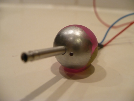

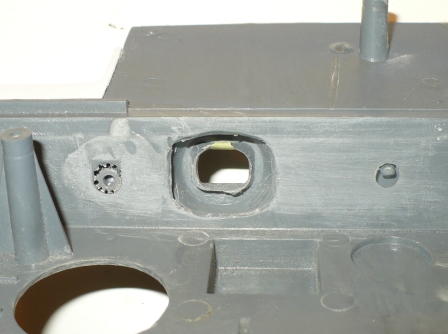

I did a separate post on this several months ago, but this is my refined version. The original HL hull MG leaves a lot to be desired. The older models (like mine) didn’t even come with a flashing version and the newer one is certainly an improvement, but there is nothing to replicate the working ball mount which they do provide on their Panthers.

First I drilled out the aperture completely and used a spherical sanding fitting for my drill to shape it from the inside.
MG apperture opened up and hollowed out from inside.jpg (96.91 KiB) Viewed 24408 times

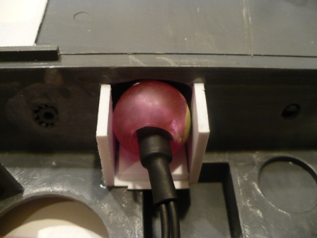

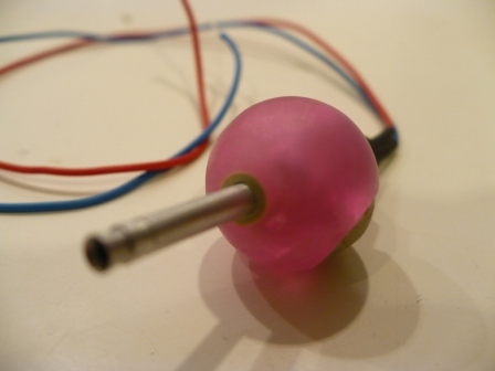

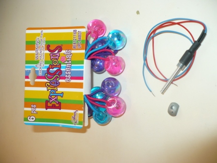

Then I found a suitably sized plastic bauble from a cheap girl’s hair band (in a lovely subversive pink) which I drilled out to accept the Asiatam MG with an additional hole for the sight.
Plastic hair baubles, Asiatam MG and the superficial metal ball mount.jpg (83 KiB) Viewed 24408 times
Asiatam MG 34 sitting snuggly inside the ball.jpg (50.55 KiB) Viewed 24408 times
Obviously the subversive pink just had to go....jpg (47.67 KiB) Viewed 24408 times

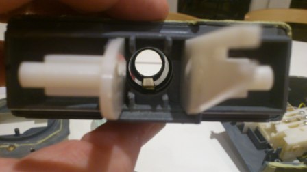

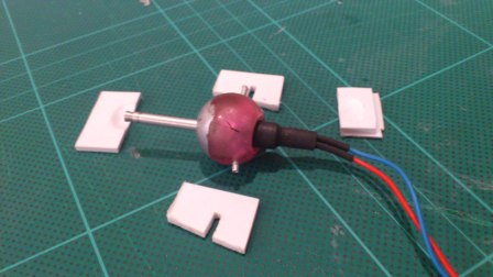

This was then boxed in internally with some thick plasticard. One I had done this I realised that, although the gun could swivel left, right, up and down, it could also twist on its axis. It shouldn’t. Accordingly I inserted a metal pin in each side and cut matching slots in the sides of my plasticard box to prevent this.
Underside of plasticard box before adding metal pins.JPG (61.39 KiB) Viewed 24408 times
After metal pegs and matching slots have been added.jpg (31.5 KiB) Viewed 24408 times

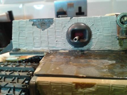

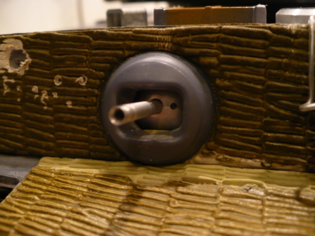

The ball I used was actually too large (it should be about half the size) but once it’s in place behind the mount I like to think it looks pretty convincing.
Finished ball mount.jpg (87.38 KiB) Viewed 24408 times
By the way, I was worried that when I wired up my Asiatam flashing MG to the HL circuit it would blow the tiny LED (there was a warning on the site where I bought it). Eventually I plucked up the courage and it was fine.
If you leap forward you will see how I changed the zimmerit...
Not all Tigers had the circular pattern around the kubelblende - but it certainly adds interest!.jpg
Not all Tigers had the circular pattern around the kubelblende - but it certainly adds interest!.jpg (30.87 KiB) Viewed 21127 times

Why don't you just box the ball insted of putting it on a axis? Then you could get movment in all directions...
tanks_for_the_memory
Posts: 501
Location: London
Re: Building a Mid-Production Normandy Tiger 1
I did simply box it in at first, but that meant it could still twist. By adding the pegs and slots I still have full lateral and vertical movement, but the gun and sight aperture remain in alignment... Does that make sense?!
