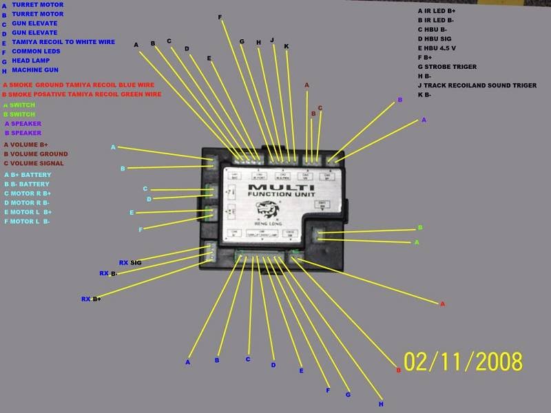

1. After I use a small Diode to bridge the RX-18 Board .....Do I use the number two PIn ( trigger strobe ) for my muzzle flash?
2. Can I use any LED or does it have to be the 'High Tension LED' unit?
3. I'm not using the AirSoft BB .....so do leave that socket empty or do I need that for the Tamiya
recoil nut?
Thanks!

Here a link the diode mod I used.
http://www.rccommand.com/guides/RX18FireMod.php" onclick="window.open(this.href);return false;
Basically it removes the microswitch off the airsoft. I used the standard HL flash unit. Not certian how to do it with an LED
Here's a quick video in action.
http://www.youtube.com/watch?v=UBzn30tO ... rofilepage" onclick="window.open(this.href);return false;
The HL flash unit recharges quickly enough to flash each time although not showing to well in the video. Only thing if you fire again too soon about 2 seconds you still get flash and recoil (track twitch) but no sound.

I thought it was cuz I did not have a fully charged battery but this morning after charging my batt for 4.0 hrs anything 'MOTOR' driven would not run .....well at least the smoke unit and the drive motors....the L motor turns but not at full speed....only when in TURN mode....the R Motor wants to but has to be coaxed.
I put a straight 6.0 DC V to the smoke unit und it ran just fine.
Has anyone else seen this in a RX-18?
I'm pretty sure this board will work on the original NC 1700 battery...I think?
On using the Diode on the 18.....my board does not look quite like the one in the video....my 18 has a third smaller board that is soldered horizontally like an roof over what seems to be the motor control circuits.
Now I can turn up the volume and with my small bass 'woofer' speaker OH MAN! I love the new sounds! well....at least the Cannon Blast/echo/recoil sound and the mini G sounds cool too.
