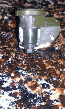

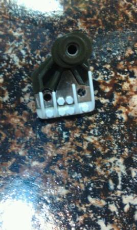

Well, I have completed more work on various items. I completed the idler mount detail and modification. I used .60, .100 and 1.25 plastic sheet and hex rod. Brass .080 and .90 bolts are far too expensive. I also utilized Tamiya's adjuster. I sanded the elogated faux bolt head into a hex bolt shape so it was much closer to a prototypical adjuster. I was going to use a 3MM counter sunk screw and glue it in place on the rear portion of the Mato mount so the idler would mount from the side as well as the rear, however the genius engineers at MATO lined up the mount hole exactly with the side mount hole. The nuts would have interfered with eachother had I done this. Being I used the Schumo plastic back plate I will just cement the mount to the plastic rear plate and screw it to the side via the Schumo screw kit I purchased. I probably should have sanded all the detail off and started from scratch, however I was concerned with the integrity of the part had I done so. I also wanted to incorporate the metal reinforcement that came with the idler. Anyway, here is what I came up with.
Regards,
-Dan

Your modified idler mount is a vast improvement on what comes as stock. Great build so far - I am really enjoying it! -Mike

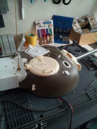

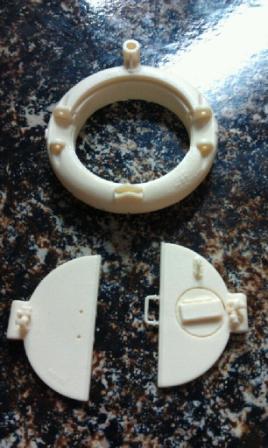

Well, Nick Aguilar comes through again! I got the first of his new "Early" Sherman commander's cupola. This is the early style with the aiming vane and the hatch locks. This is much thicker than his earlier offering. I will be converting the M2 .50 barrel rest to the early style "goal post" that was common on M4 Shermans and most common wealth Shermans with the split hatch.
Another work of art and came just in time so I have the correct style hatch!

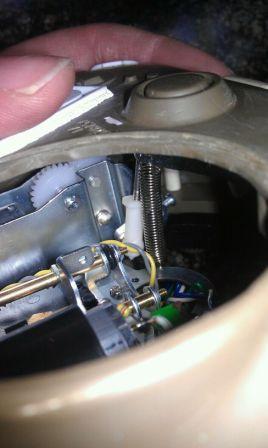

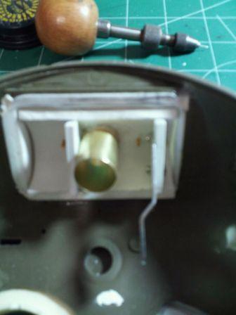

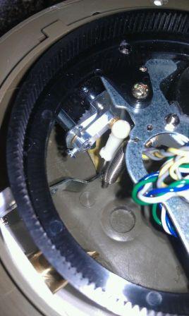

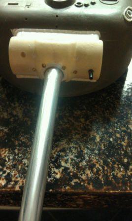

After looking at options to make the elevation reliable and smooth being I used Ethan from RCU's rotor shield I came up with a clean mounting and smooth operation.
I used the piece of 1 1/4" tubing supplied with the rotor shield and used my self-adhesive sand paper and used several different grades attatched to the tube and rotated it in the recess where it is designed to move for elevation. Finishing with 600 It's smooth as a baby's ass. I then cut the tube length-wise to about 1/3 of it's width. I used the tube to trace a pattern of the interior tubing to make a pattern on .125 sheet plastic. I made the half moon portions and after careful measurment of a non-modified turret I located the half-moon plastic in the back of the tubing where it would allow attatchment of the Tamiya elevation lever. I wound up being able to maintain factory locations and geometry. It's a very clean install and maintains room in the turrret.
Now that I have completed all of the mechanical but the recoil link I can seriously attack the exterior turret details so I can move on to the hull and the completion of the VVSS conversion.

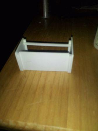

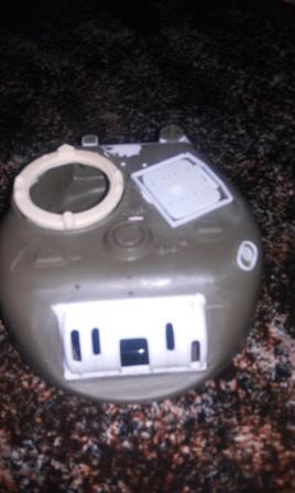

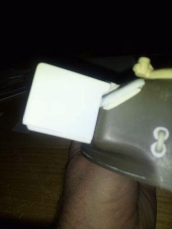

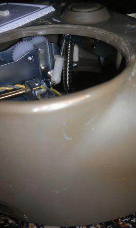

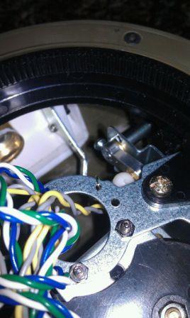

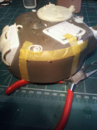

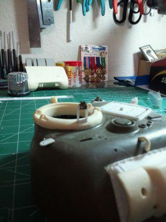

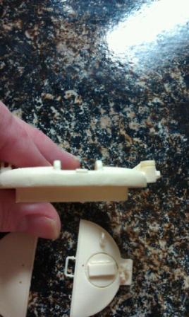

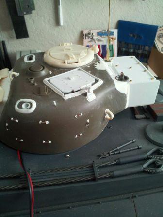

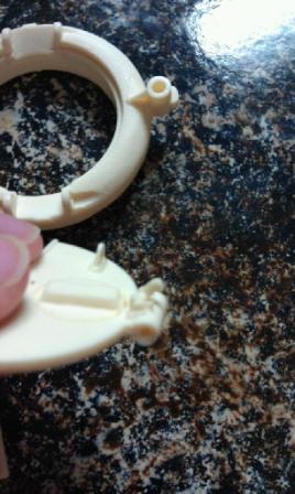

Well, I have been under the weather for a few days, however I have been plugging along and have now completed the Sherman 1C turret. The recoil and elevation are positive and work flawlessly. I used my Tiger 1 to test the electronics. I must admit, it makes the Sherman turret look puny in comparison to the Tiger 1 hull.
Here within I am posting the equipment rings and their installation, as well as the Early MG mount I fabricated, and also the radio compartment I scratched. I only have to do the cast texture now, which I'll be doing with Mr. Dissolved Putty.
I can finally start the hull and the dreaded bogie modification. I dread the thought of replicating the same work six times on the VVSS bogies. LOL
Anyway, enjoy. Comments, suggestions and constructive criticizm always welcomed!
