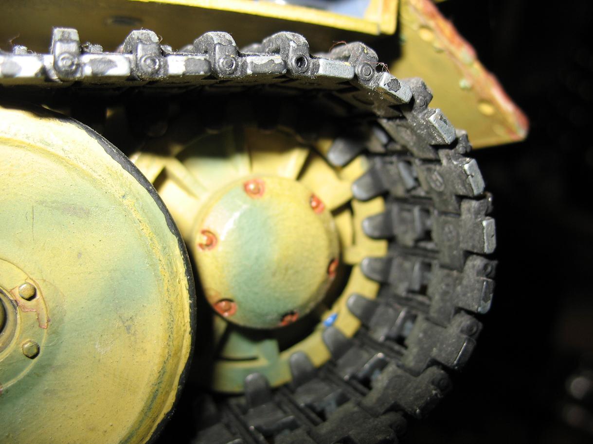

Yes it is amazing, how the things work again when you turn them upside down....The Heng Long smokers are not very good or reliable so well done on getting one to work :D I look forward to the pictures of your track pronblem....But just to try and second guess you here are some photos of where the two vertical guide 'Horns' belong on the rear idler. They go on either side to 'Hold' the rear idler. Alb

You are rignt on the money! When I put the metal tracks on I had one with the track running over the outside horns. The weird thing is the tank worked fine like that! I only noticed it when I took the track off to remove a link and then I wasn't sure what the correct alignment was - inside the horns or on the horn. I figured it was between the horns as the track sure seemed to turn a lot easier when it was aligned that way :)
You are very perceptive and sure know a lot about these tanks!
