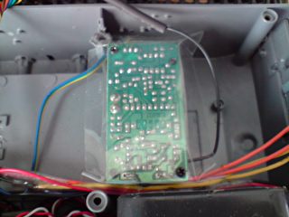

Am I right in thinking that this is an RX18 board?
That's what is in the StuG at the moment; unless I've ended up with my wires crossed (no pun intended...) I was under the impression it was an RX18! I'm afraid that I'll feel like a bit of a wombat if it turns out it's not
Re: New StuG III misbehaving!
yep thats an RX-18
Hi
Yep It is
Try putting a piece of plastic film over the exposed area of the receiver board
the antenna or upper hull wires maybe rubbing on it
just cut a piece a little lager than the board and put two tiny holes for two of the board screws
Jon
Yep It is
Jon
