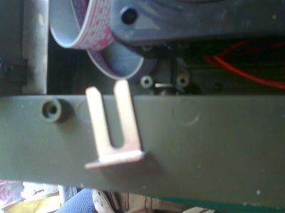

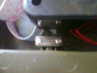

Firstly locate the two screws securing the bogie to the tank;
Once undone remove the bar held by the screws;

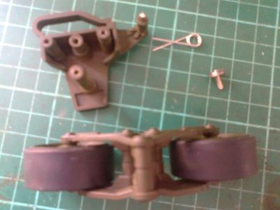

prize apart and this is what you see;
remove the screw for the spring and remove that too;

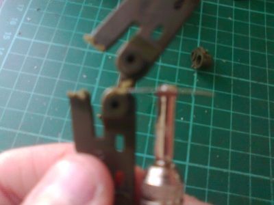

then carefully seperate the two halves of the wheel clamps;
the rods above can stick and its easy to damage/break the arms. Now I used a rotary tool with cutting disk to do these bits as its quicker, but a craft knife will suffice, the middle section needs to go so cut this on both ends;
try to cut the following staying flush to inner cylindar, this means the wheel arms wont meet and foul in use;

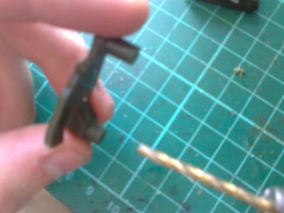

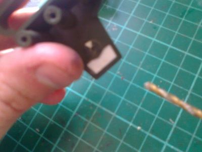

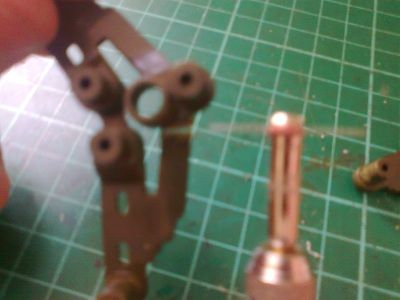

then remove this shaft for lower screw;

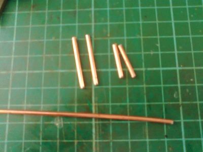

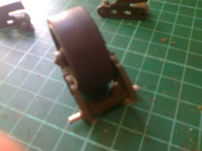

and file down the other side of it. Now I managed to get some 2.4mm brass covered steel rod from a fellow moddeler friend at Uni, but you can use any size rod really, so I drilled these shafts out with a 2.5mm drill bit;

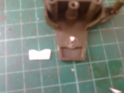

and same with the bogie sides;
for the outer side I add a small bit of 1mm styrene sheet and stick in;
without I found that the rods were able to work loose.

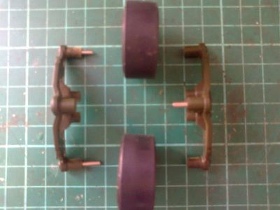

The rod I have mentioned, I cut two 30mm and two 20mm lengths;
Place a 30mm rod in the new shaft, and rebuild around wheel;

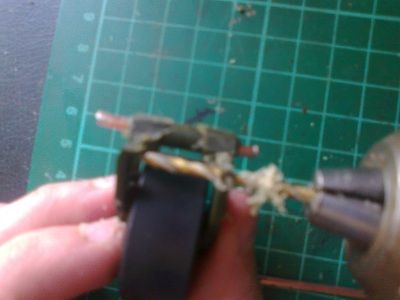

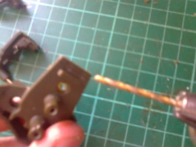

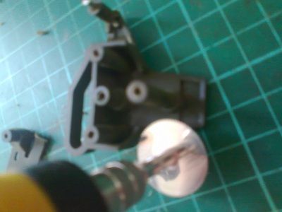

this lines up following for drilling;
now that adhesive is dry drill the outer bogie side;

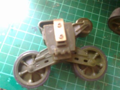

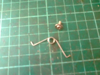

find the spring and try to bend each side out to around 80 degrees apart and put a 90 degree bend at either end;
the further you bend here the stronger the spring action on the wheels, but if you go too far they can ping off.

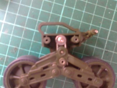

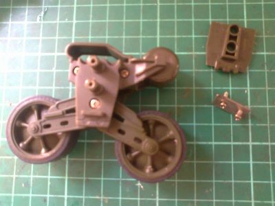

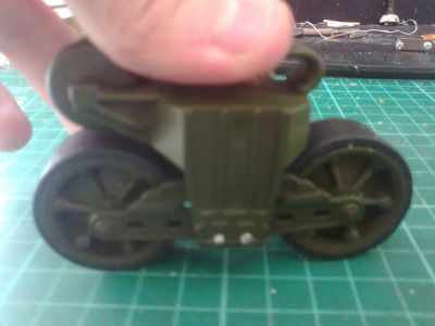

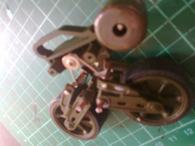

Now replace spring, place one side of new shaft in the bogie side and hook the spring on to the upper shaft;
replace other bogie side, reassemble, and it should work like this;
If there is any fouling or you cant push down this far, just go back to the bar cutting/seperating stage and file either side down a little.

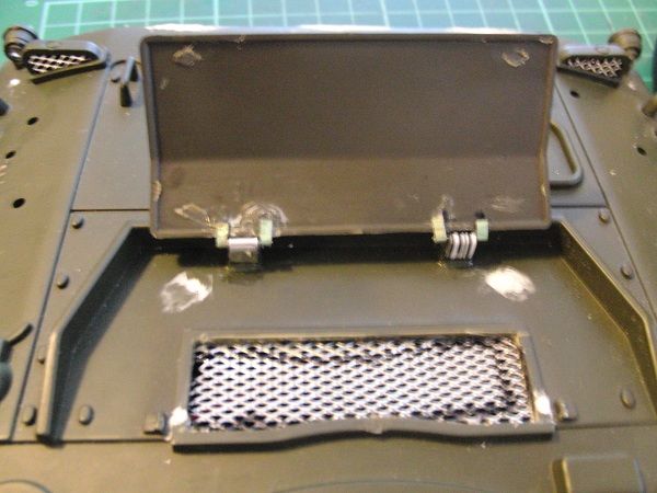

Will start this update with yesterday and todays minimal progress :S As said above I found some pics of the engine vent so got that done;
hinged for use, hinges are made from the ali sheet I mentioned here: http://www.rctankwarfare.co.uk/forums/v ... =38&t=7391 and staples as the rod. Mesh underneath is just ali reinforcement mesh for vehicle bodywork repair (89p), also applied to rear vent at top of pic.
I also filled in the loaders hatch, not present on early turrets, and a few other holes, also removed rear vent;

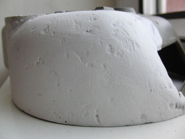

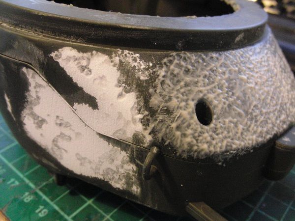

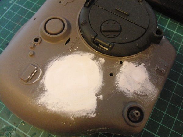

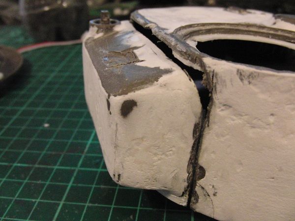

Moving on to cast texture, I applied the joint compound to T23 turret rear for practice, it stinks and is horrible to work with, still not close to dry after eight or nine hours. For these reasons I wont use it, it is on right of pic around curve of turret;
So I ventured into town today and had a look at the product in Poundland, compared it to similar better known brand stuff in Wilkinsons and other hardware/tool shops and found it to be pretty identical, it looks like this;
so I guess any filler may have same effect. I mixed with water to consistency of yoghurt (got some to check, yum :D ) as I had done with the joint compound (though turps was only thing it would thin with) and applied with a sponge using the stipple method, after maybe an hour was dry and I sanded with 120 grit (all I had) to the effect on left of turret pic above. I know it doesnt look as good as streetsquid got it to but I think I did it too thick and I need to put more on and get finer grit sand paper. I will try again later in week (away tomorrow) so will let you guys know, but I am pretty confident it will work as well as streetsquid got it to.
Thanks for looking, Dave

Following on I applied some this morn to one side, sanded with 120 grit (all I have :S ) and applied some more a bit thicker, then sanded again and the result is as follows;
I am happy with that, though fewer ditches and a bit more eneven surface will look better. I will get some finer grit sand paper tomorrow and may put the odd bit of un thinned filler on the surface to give that eneven look. Will report back once done, for now I have covered the turret and I think I have the key to consistency.
Cheers :D

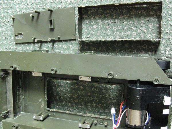

Right been running around the electronics for a few days and not getting far, but have jumped the first hurdle today :D which is the last bit (pics and vid).
Cut out the battery bay the other day, then glued the cover in place as bottom;
will fill and smooth edges. Battery is central to tank to keep it balanced but not sure where to put other stuff lol.

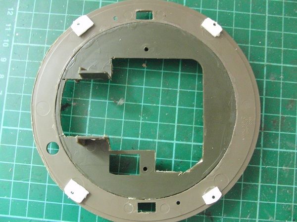

I have fitted recessed fittings for turret bottom to turret using the shafts cut from bogies '8 ;
Have cut a bit out of the turret ring;

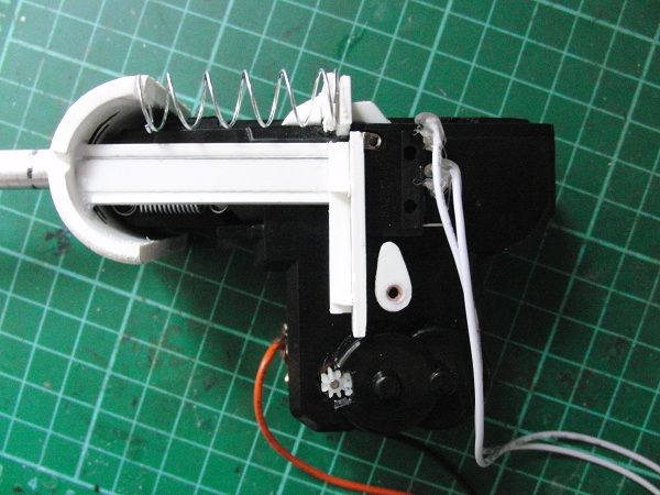

And then the piece de resistance (forgive missing accents) for this update, the BB gun modded to recoil, here is how it looks;
and a short video of a few cycles;
http://www.youtube.com/watch?v=XMjJv09uG3c" onclick="window.open(this.href);return false;
The idea was not mine sadly, I first saw it at the following and have to give credit to blimp (third post from bottom);
http://www.rctankwarfare.co.uk/forums/v ... =33&t=6821" onclick="window.open(this.href);return false;

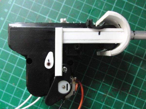

Trying to keep it short, I fitted extended shaft to final gear in gun, made cams to fit to the end (I calculated from a vid of 75mm firing recoil is around 7mm at scale). A sort of cradle running down each side from the pipe section which fits behind the rotor shield, with a square on each side which runs in the cradle. Added a spring to return gun to forward position and CAd the jump switch behind the left side of cradle. If anyone wants more info just ask away........ :D

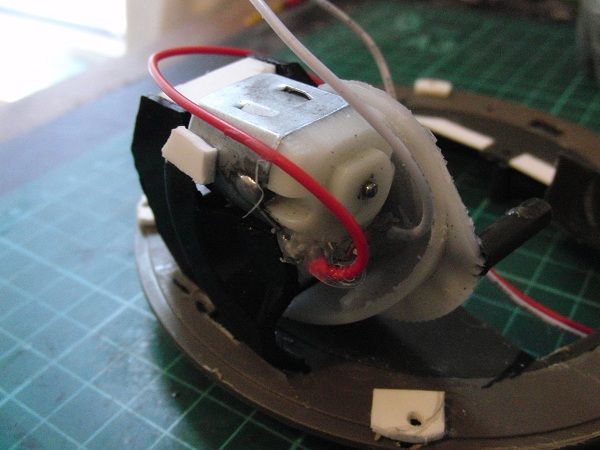

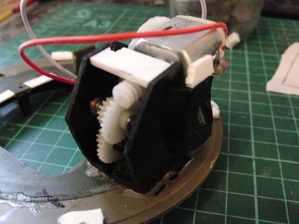

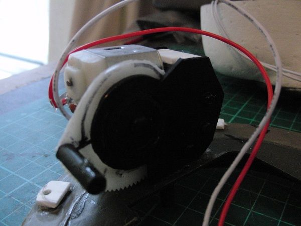

Last few days have been a bit slow, I have been chopping down the elevation unit to work in the cramped turret and got it down to just 42mm tall, a perfect fit! :D
Following is a quick vid to show turret electrics working, elevation is a tad noisy though!
http://www.youtube.com/watch?v=QpFMDntnfMM" onclick="window.open(this.href);return false;
It looks a fair bit different too, I managed to fit the motor within the big cogs rear section (appologies for the mess!);
The rod that sticks out simply runs in a channel on the side of the gun, enough room added for the recoil too. The idea again came from blimp, so I have to give him credit and say cheers for the good ideas mate!!

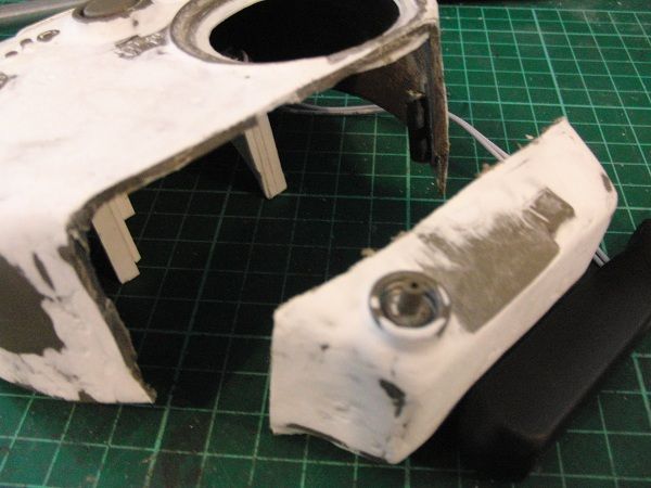

The following is my pretty poor attempt at altering to the low bustle, a rough cut around the edge of the bustle,
trim the bottom where it meets the ring and re-stick;
I still need to fill the gaps and join it all into the right look. I do prefer the look of the high bustle but seeing as all Grizzlys and probably a majority of M4A1s had low bustle turrets.

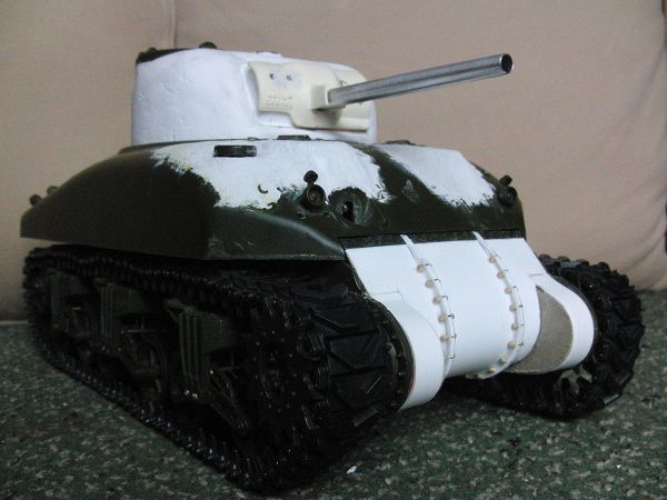

Here is how the tank looks before adding the detail bits, texturing and painting;
I have also turned the front half of the barrel to try to replicate its increase in thickness, not sure what I can use to get the thickness up to mantle??
