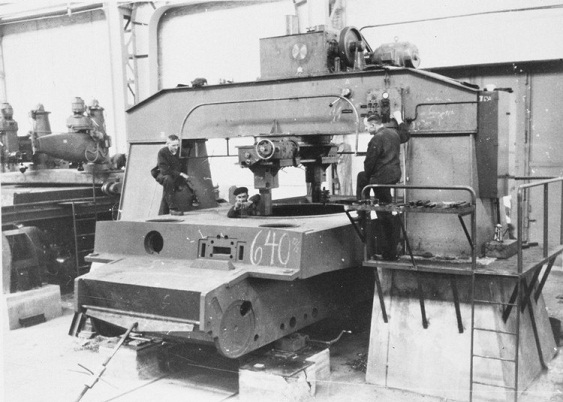

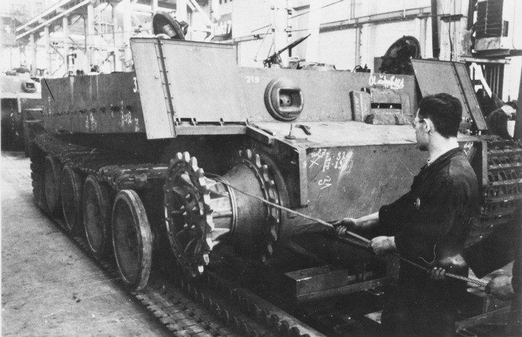

John,I am posting a few pictures,my front plate is cut to tall. Also these pictures show very good details of the front track guards and the hinges we discussed.
