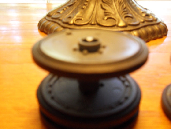

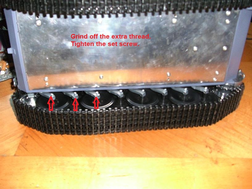

When the Asiatam Hull came out the wheels were not yet available or in my case the Early Road Wheels were more than the hull. So I needed to use my H/L Wheels.
Solution was to use bolts,10-32 thread at first,removed the set/grub screws and tapped the arms very slowly as not to stress the soft metal,and using light oil.
Then I used the bolts and tightened them until the wheels did not move backed off a 1/4 turn,cut off the extra thread and installed the set screw. This lasted for the first 4-months I used the H/L Wheels. Later I was given the WSN early rubber lined road wheels,I removed the bolts,re-tapped to 3.5mm and used shoulder bolts with Allan heads,also had to cut the extra threaded part off but this time the shoulder fit the wheel bushing,and I used plastic washers between the hub and the control arm,ran my tank checked the axles,adjusted and after over a year no tracks thrown and not wheel issues ever.

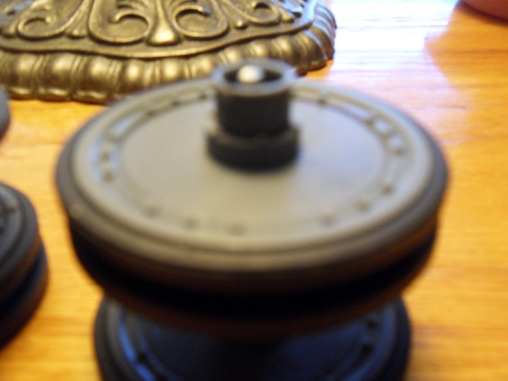

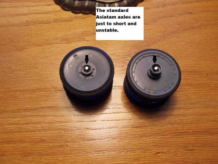

Then when given the WSN Early rubber lined wheels I tried to use the Asiatam axles,they were to short.
Re: a sloppy wheel solution
I do not have the next set of picture which detailed the use of Allan head shoulder bolts,4mm shoulder,3.5mm thread. Control arms can be tapped to 3.5mm but beyond that is risky as the hub is to thin. Sax
