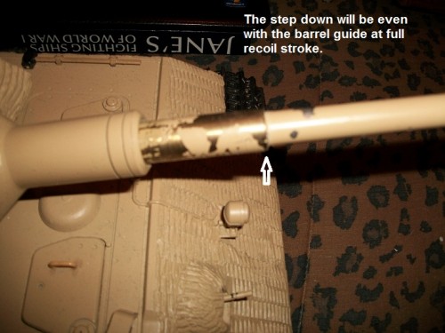

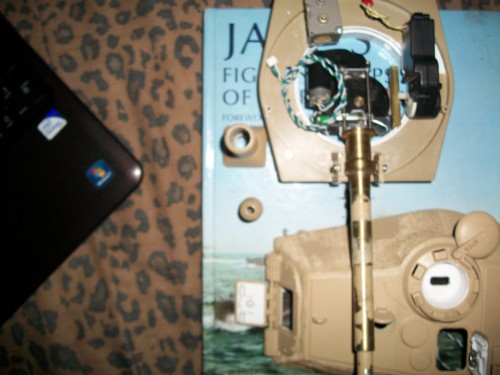

The Porsche barrel isn't fitted right on the model. On the third picture the part of the barrel with the step (white arrow) should actually be at the point with the black arrow (sleeve) and when the gun recoils will disappear inside the sleeve (mantlet). I presume there is some kind of extender fitted between the main barrel and the recoil mechanism that shouldn't be there? Can you show the inside of the porsche barrel to confirm? The barrels on the real thing extended by the same amount whether one or two part and as far as I can tell had the same breech & mounting as inferred by the Porsche pictures with 2 part barrel.
Re: King Tiger Main Gun differences

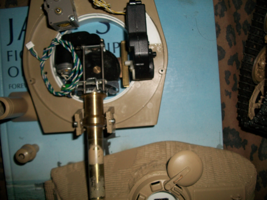

Not real clear on what you mean,here are some pics with the barrel guide attached and the Turret house installed.

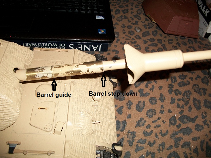

I can't work out why its wrong but for sure the barrel step down should be at the leading edge of the mantlet when its at its maximum forward stroke so not really visible, as with the real thing. I think you will find that the barrel is then the right 'calibre' ie the same length as the 2 part one. I note from the chipped paint that the forward part of the barrel is aluminium & the inner and outer sleeve look brass. Is there a fitting problem here somewhere? - the problem is definitely with the model, though and not any difference in length with the real thing.

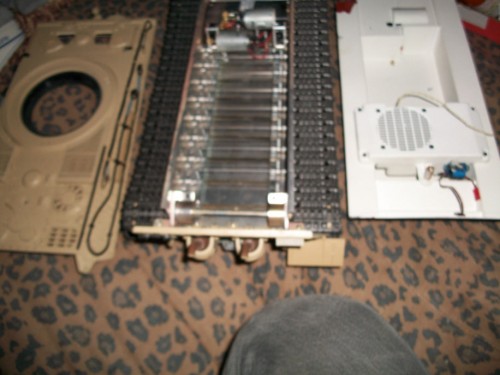

The paint issue is just the result of no primer. I intend to give it a good restoration but for now it is at the end of my to do list. Here is a picture of the complete mounting assembly,these were sold through RCCOMMAND and built by Bubbajoexx for resale in custom tanks.
Not sure of the proper original mounting,my Henschel uses a Tamiya recoil bracket arrangement that seems to have the same barrel length difference if I install the one piece barrel into that turret assembly? So for now I will have to wait on any change,this is a completely custom built tank,the internal assembly has a one piece inner hull. The hull MG is servo controlled to pan left to right. I intend to post a build thread of the restoration. Saxondog
