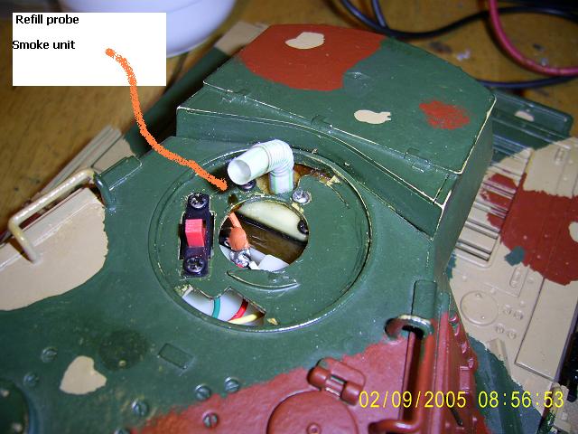

Here's my latest results with this project :
http://www.youtube.com/watch?v=CzPPS66rVTk" onclick="window.open(this.href);return false;

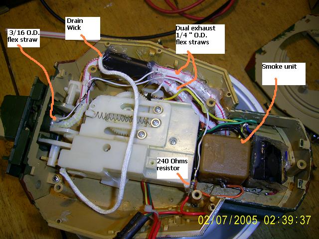

That system is amazingly simple : A mini smoke unit ( made with a discarded H.L. smoke unit and a 5 Volts mini fan ) ,

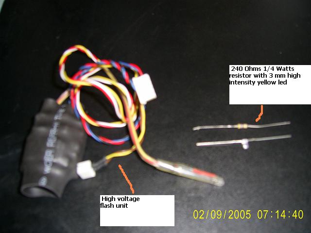

a pipe system ( made of 1/4 " O.D. and 3/16 " O.D. flex straws ) , a 240 Ohms 1/4 Watts resistor in line with a 3 mm high intensity yellow led ( to replace the high voltage flash unit ) ...

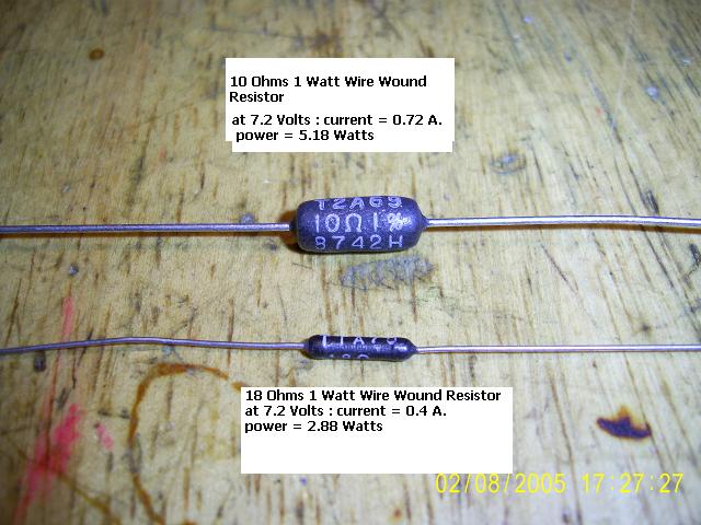

The smoke unit is running with a high efficient 18 Ohms 1 Watts Wire Wound resistor , ( I'm also using the same type of resistor for the exhaust smoker . The current consumption at 7.2 Volts is 0.4 Amps , or 2.88 Watts for each smoke unit ; for a total load of 0.8 Amps , or 5.76 Watts for 2 smoke units ; which is pretty reasonable , considering the amount of smoke produced ....
http://www.youtube.com/watch?v=8Rb-CqYex3k" onclick="window.open(this.href);return false;

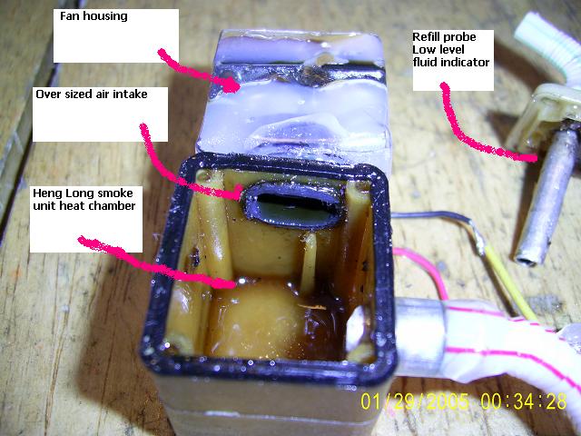

I enlarged the air intake and double the exhaust of the smoker to get maximum air flow ..
I tried to put the mini fan away from the smoke chamber to minimized the smoke leakage through the air intake when the system is at rest ..
I put the pipes in a slope with a drain to prevent clugging by smoke fluid liquid residue ...
So this design is working right now and I'm ready to proceed to long terms field testing ....
By no means do I believe that this is the only way to get the gun smoking , nor is it the best way ; but in my humble opinion , this is a small step in the right direction ....It does prove that it is possible to get the gun smoking repeatadly ....
The system is customised to fit the turret of my Panzer IV , so a bigger turret , like a Tiger ; should be even easier to work with ....
Here's a few pictures , with comments ; to help ....

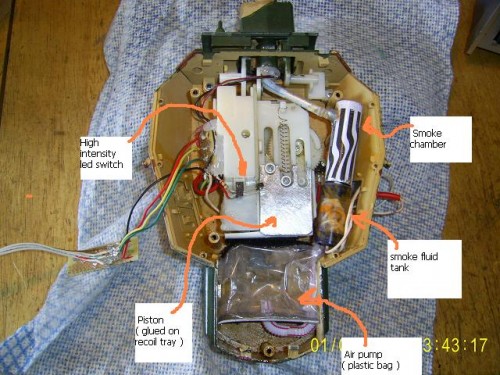

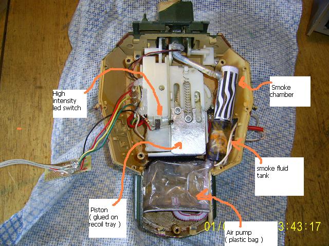

Re: Smoking Gun
Here's an update on my never ending smoking gun project ....
I simplified the system to the bare minimum and the results are interesting so far ....
Here's a picture of the mod. and a short video ...
http://youtu.be/t5YHDs-qY8c

Re: Smoking Gun
Now that is very much better, well done and a super effort, much more like the real thing .......
and I take it the recoil pushes on the airbag ?...............
