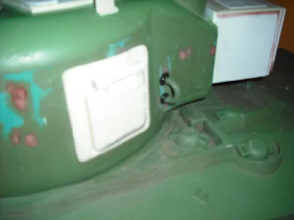

Update:
Well the rest of the detail parts for the Shermans from ECA arrived yesterday afternoon and I'm back at working on the Shermans. I was talking with Geoff about the rear doors for the engine compartment about how I would have to grind off the stock doors then cut a hole in the rear bulkhead and he suggested I just replace the whole bulkhead so that's what I did I cut it away then I laminated 2 pieces of 1/8th styrene then just cut out the opening for the doors then mounted the hinges, doors, etc. Then I removed the doors and left the hinges and bolts in place. Here are pics of the new bulkhead glued in place. Now it's just a matter of filling and sanding the joints and re-enforceing the inside joint..... Harold

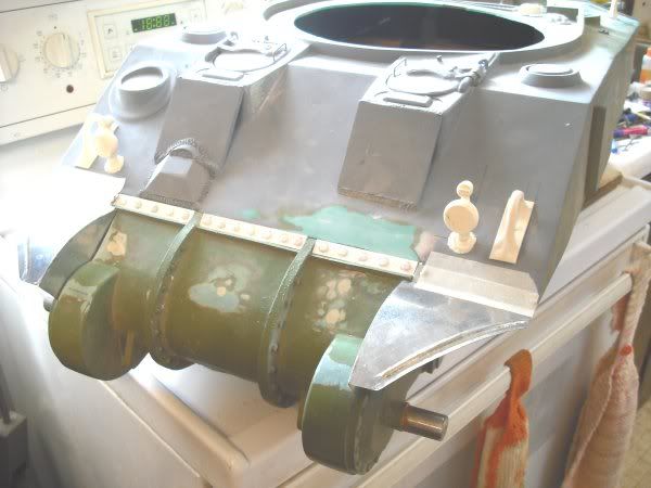

Update:
The construction crew have been hard at work on the firefly. Here are the next series of pics.
Here are the air filters assembled and installed. They are held in place with a screw on the inside of the rear bulk head. Will be adding the smoker boxes and trailer hitch shortly. The rear bulkhead is is starting to get crouded .....
The next 2 pics show the fuel/oil/water filler covers, the external fire extignuisher box, and the rear lift rings installed
the last 2 pics are of the headlights, lift rings installed, and the front fenders trimmed and temporarily taped in place
as always comments are welcomed..... Harold
