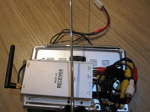

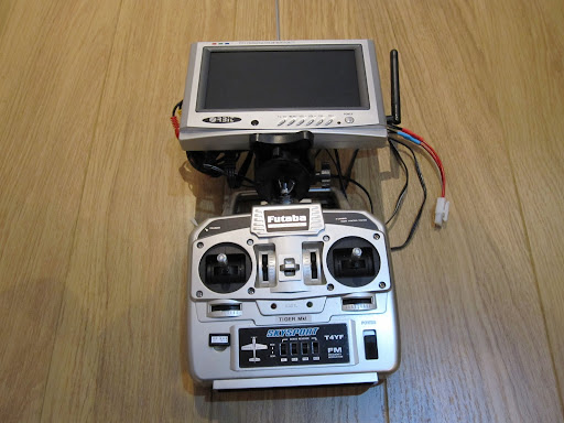

Hi all,
As promised, here is the set up I used.
The mini cam and reciever came from "Bigboysstuff.co.uk" here is the link.
http://www.boysstuff.co.uk/product.asp?id=14884" onclick="window.open(this.href);return false;
The TV I used was the Orbic 7" LCD colour TV/Monitor (not sure if thats still available ) but any portable TV will do.
I fixed the reciever to the back of the TV and adapted the bracket so I could fit the whole assembly onto the top of the controller so it was easy to view while operating the tank.
Both TV and reciever work on 9-12V DC, so I linked the two supplies to a Tamiya type plug and bought a 12V racing pack to power them.

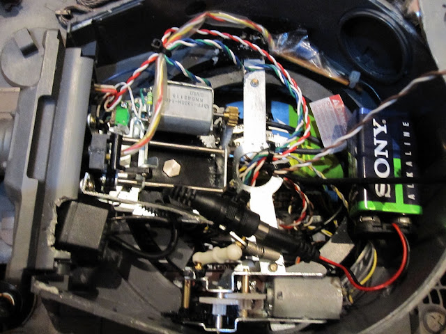

The hard bit ,for me anyway, as this was a retrofit to my existing Tiger 1, was to make the top of the turret removable to fit the cam and be able to change the battery. I wanted all round visability, so it had to go in the turret, but if fitting to a new build, you could extend the cable so the battery is in the hull.
You can see the top/rear of the cam in the bottom left of the pic and the P9 battery is velcrowed to the side or the turret centre right.
Total cost is around £150.00 (£50 cam and reciever, £50 TV and £50 racing pack)
