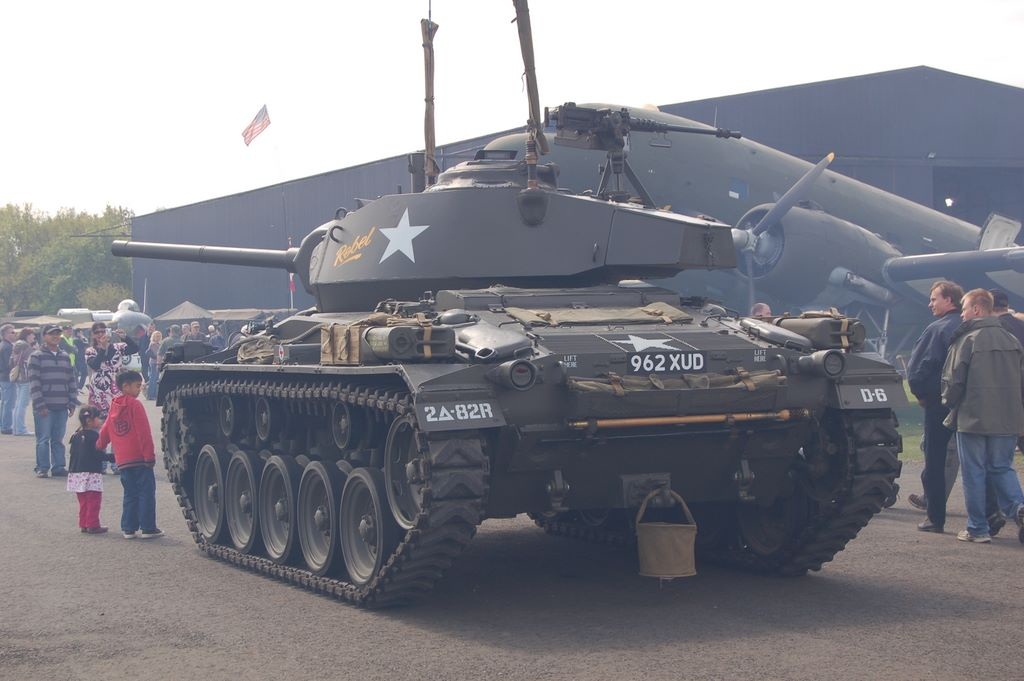

No Alan all German, I do have a large 350 scale fleet of battleships. British,German, Japanese and American. I am waiting for the new 1/144 scale Arizona due out next month. I have built these over a lifetime,Armor is a new hobby been building for two years.
The Bulldog is in my future, I wish to model the REBEL from Korea I believe.

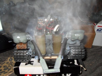

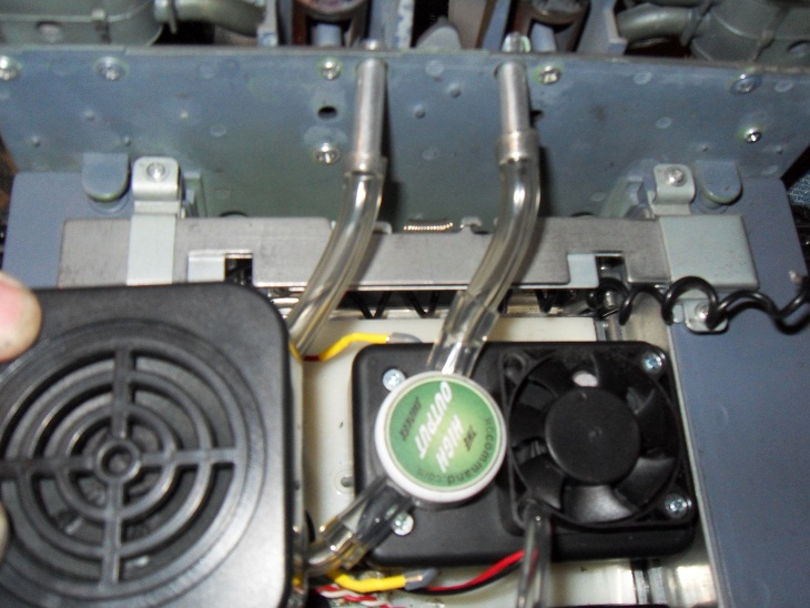

Do you bother with the smoke generator. I'm thinking of taking it out as there is not a lot coming from it. Drilled out ports and made sure no blockages but smoke still very light.

The smoker is junk, noisy and very poor output. I have the Super Smoker unit in all my tanks,works very well output controlled by engine speed and very quiet. Dave Forgebear can get these units in the UK, or Bill @ rccommand has them state side.

That smoker is the business. Will get a couple of them. Thanks for that. Been working this evening on stripping all the metal parts off and painting with etch primer. Realy strong stuff but should give a nice tough primer to the metal.

Your welcome John, we are going to market a 1/2 scale unit due out soon. I will keep you informed these units will last a very long time and are easy to maintain, also the fluid is not the cheap oil but fogger fluid similar to stage fogger fluid leaving no residue.
