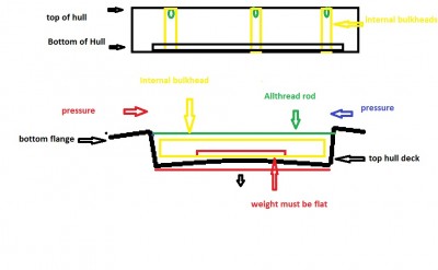

I sorry for the length of my answer,and should add that a heat lamp may be a better source for heat in the UK Climate. But the principle is sound. Hope it helps,cheers Blake

no it was a perfect answer,im going to try putting one of hulls in the boiler cabinet to heat it up

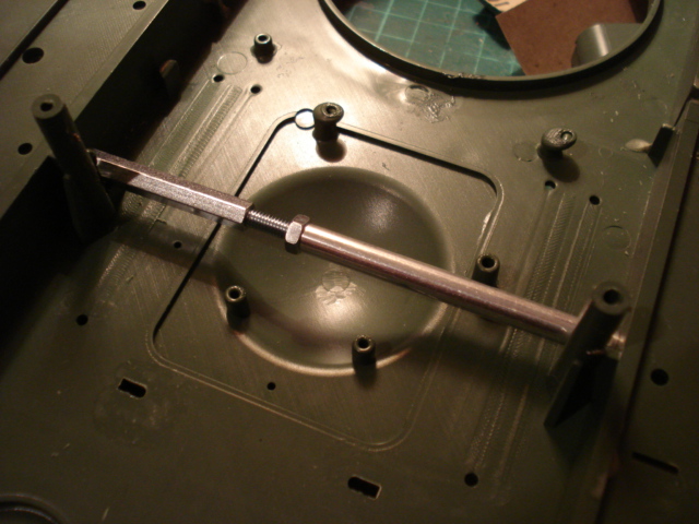

HA! suck it shitty hulls
used http://www.welshdragonmodels.co.uk/tank ... -817-p.asp" onclick="window.open(this.href);return false;
hulls now as flat as a mill pond,well the rear is(could only afford one support rod
) another one and were away
thanks for the help everone(especilly saxondog
