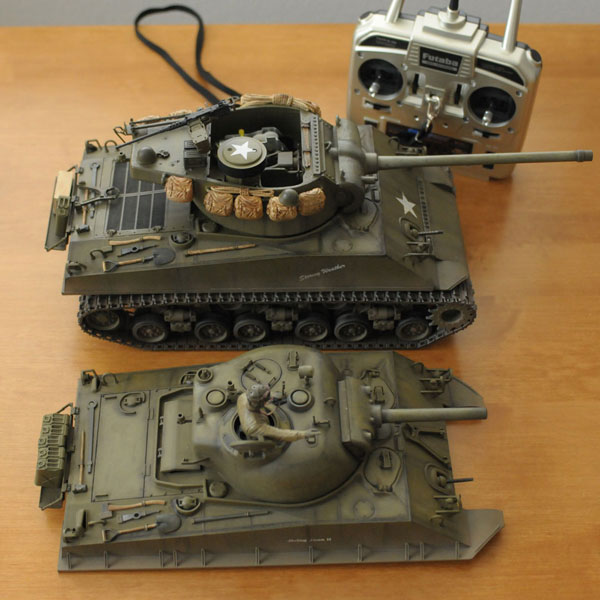

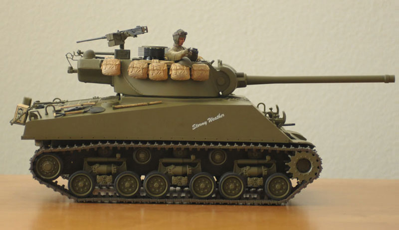

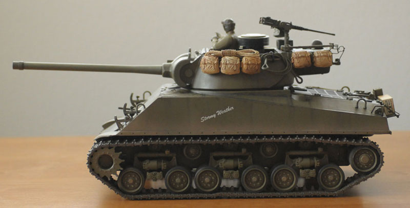

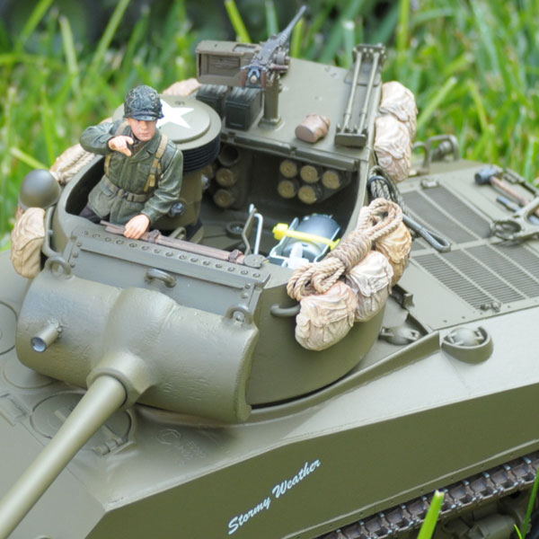

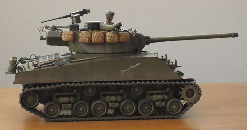

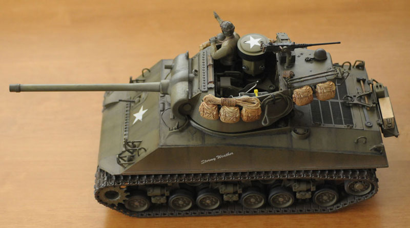

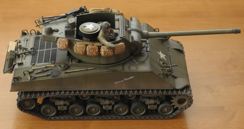

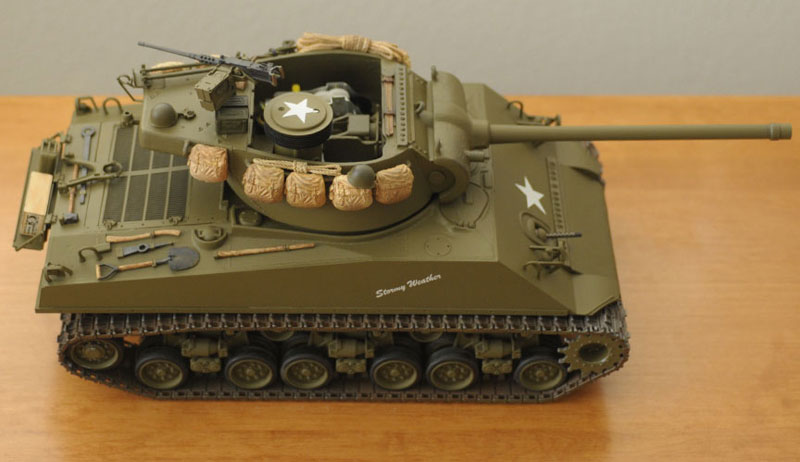

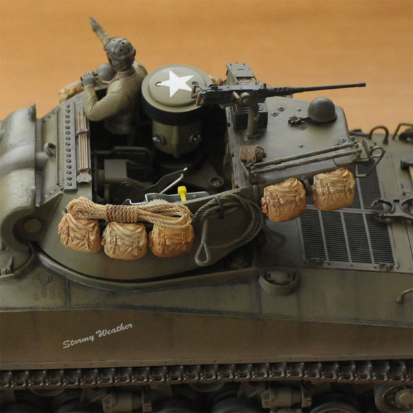

USA M36B1 Stormy Weather Turret and Upper Hull Build Details:
1. Tamiya Sherman Upper Hull, pioneer tools, light guards, etc
2. Tamiya Pershing 90mm Metal Barrel (arrived with the turret kit)
3. Nick's M36B1 Resin Turret Kit and accessories
4. Daryl Turner mantlet metal emitter tube
5. Tamiya turret rotation solid blue gear, replaces the black clutch gear
6. Color Matched Impact Battle Unit receiver
7. Impact Battle Unit Receiver Plug installed in the turret
8. Flashing hull mount machine gun
8. Dragon 1/16 WWII US Army Figure
9. Base painted using Tamiya Gray Primer, Testor's OD Paint and sealed with Testor's Dullcote.
10. Schumo Sherman rear deck engine vent installed
11. Tamiya Sherman elevation unit with plastic elevation arm (no real weight involved)
12. Tamiya Sherman turret rotation unit
13. Tamiya Sherman parts stay bag and black turret ring gear set
14. Custom Stormy Weather "transfers"
15. Star decal left over from the Tamiya Sherman 105mm Easy 8 build

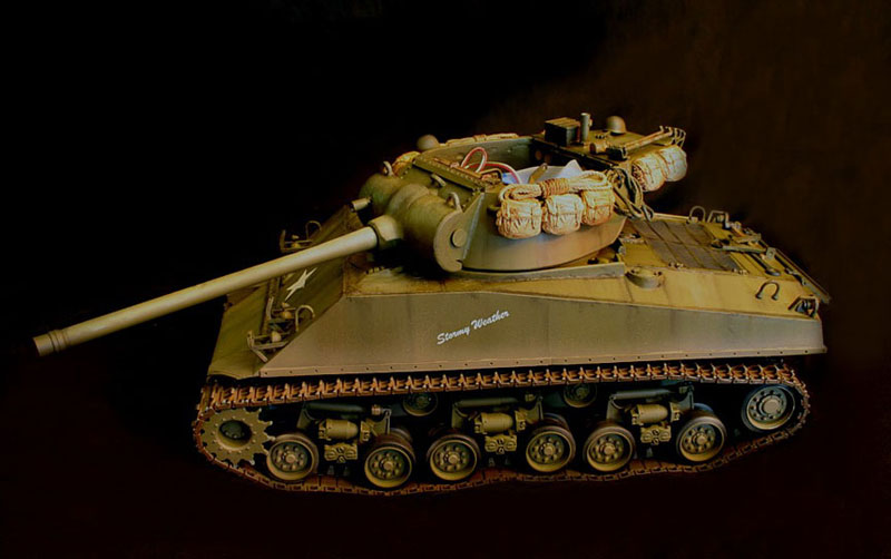

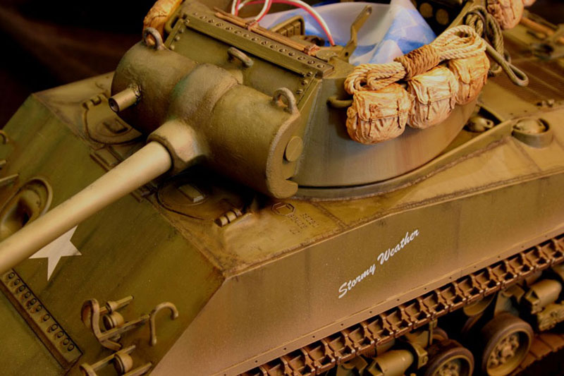

Work in Progress Paint & Weathering
Post by Pcomm1 »

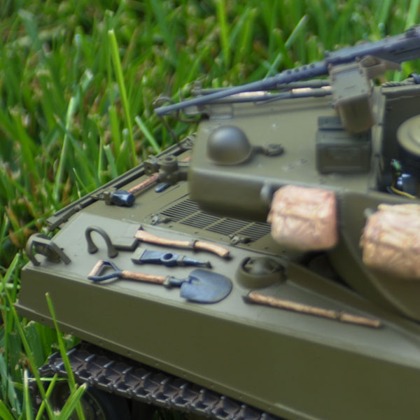

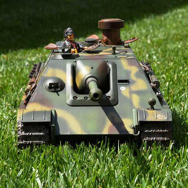

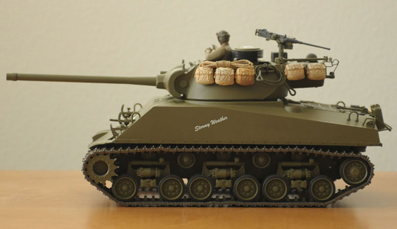

Again, I most enjoy building backyard Tamiya WWII rc tanks with the Infrared Battle Systems and I did not want to always fight an Axis tank. Though, I didn't want to end up with two Sherman rc tanks, since I had built a "5 hit" Sherman tank. The goal is to build and run a more interesting Sherman 90mm gunned tank destroyer that can better fight the big Axis tanks. LOL.
This build uses a top hull – turret swap out between the M36 TD turret – new top hull and my existing Tamiya Sherman 105mm turret and top hull: like an rc car chassis with 2 different bodies.
Next is to put all the DMD gear back in and run it around the backyard killing Jagdpanthers and the other critters.
Enjoy, John
Pcomm1
Posts: 287
Joined: Tue Jun 23, 2009 7:27 pm

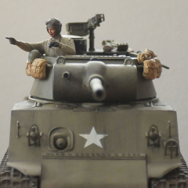

Up and running; M36B1 90mm Sherman Tank Destroyer
Post by Pcomm1 »

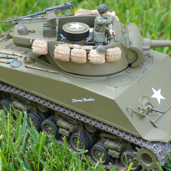

The M36B1 is now ready for battle using a Futaba SkySport 2.4 radio and Pershing DMD units. John
Knocked out by the 399th TD Bn
M36B1 Lead Tank Destroyer for the 399th TD Bn in Germany
Backyard foe
Backyard foe

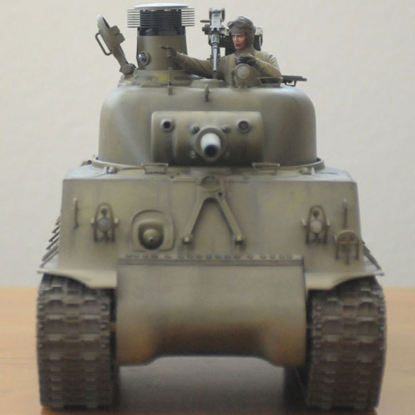

Pcomm1
Posts: 287

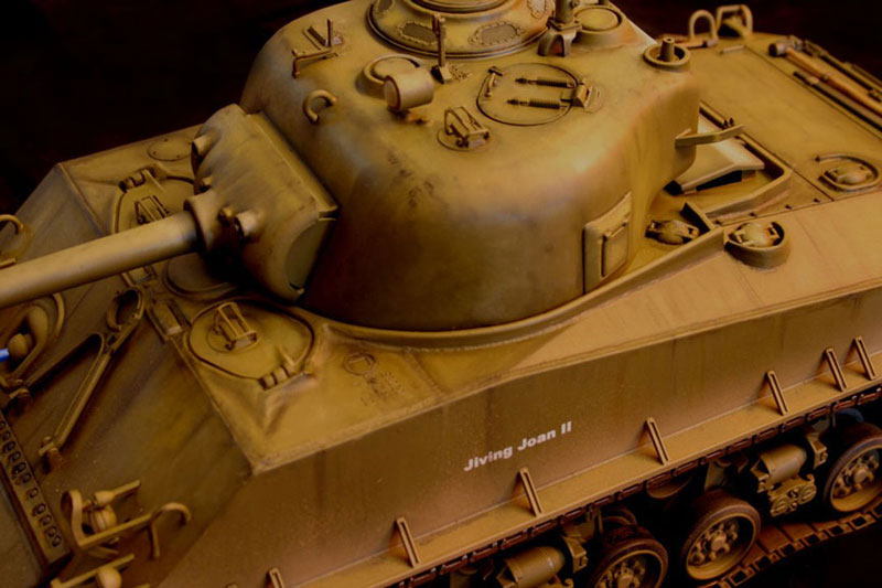

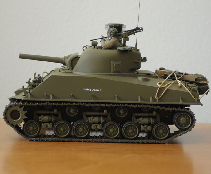

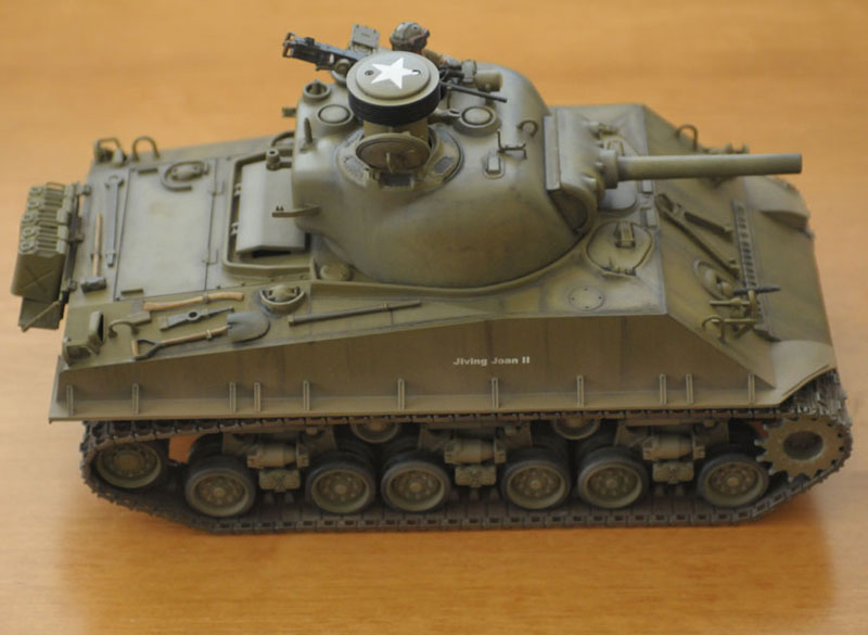

Sherman Easy 8 105mm Assault Tank

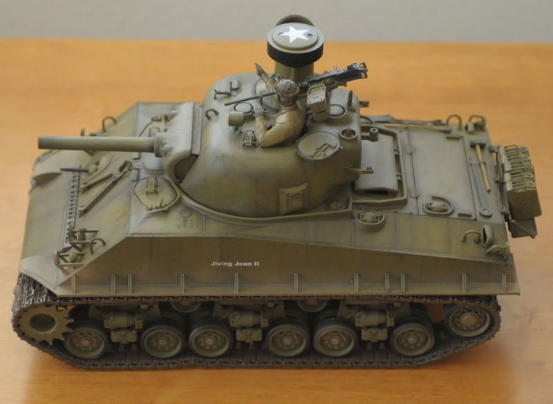

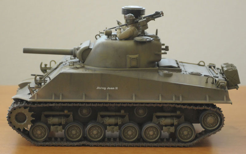

Post by Pcomm1 »
The brother to the M36B1, the Sherman E8 105mm ready to go.
