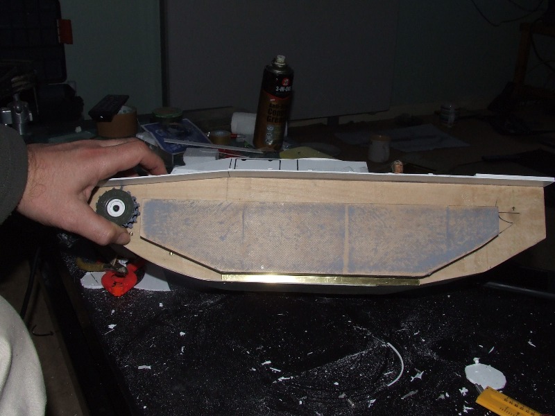

Re: LVT (A) 1 Alligator
Hi Nick . Still thinking of the suspension . I think Ive made a mistake . The pontoons how low do the sit in comparison to the bottom of the LVT from the drawing you cant see 100% how low the LVT is . I took my measurements from the front curve and rear angle . But I feel my one is to deep. As shouldnt the pontoons sit lower with the LVT main body to allow swing arms for the suspension fit on ? please could you post a picture showing how your pontoons fit on the LVT . Just shows your ahead on this project and leading the way.

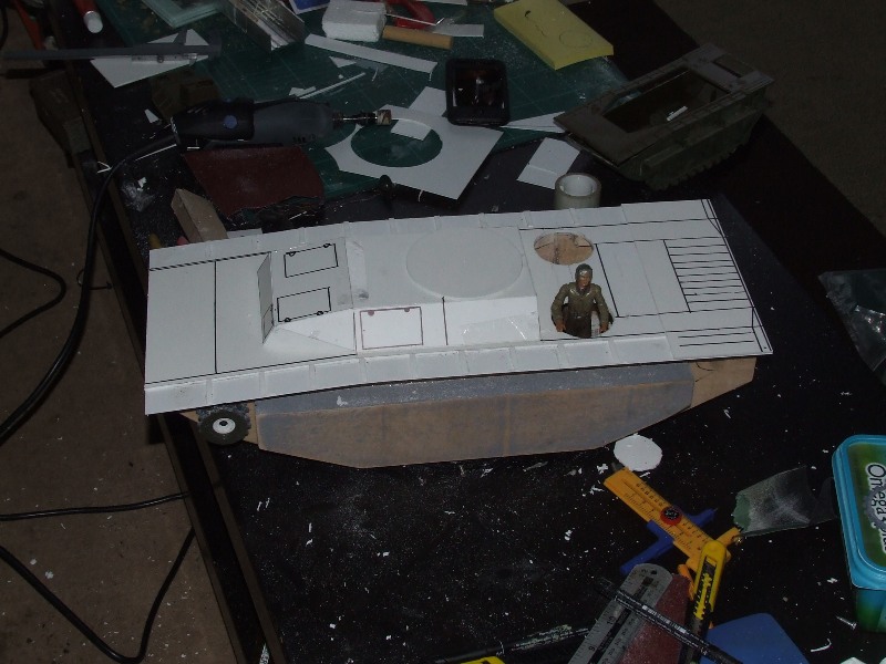

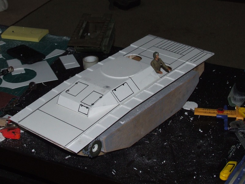

Progress, Work on the running gear is on hold as I think Im going to go with Mato Sherman Tracks and Sprockets ? !
So started on the upper Hull. One thing I hadn't thought of is how its going to float. I suspect its going to sit really high in the water and will need the C of G working out. Battery in the back methinks. Andy the Pontoons sit about 5mm up from the base of the Hull. Thats how I interpreted the drawings and using the Revell model as a reference. This should show you how Ive fitted the Pontoons. That is a 5mm Brass strip Im using as a re-enforcement for the suspension arms when they go on. Hope thats what you needed.
Hi Mate . I put it level at the bottom but can be lifted . I sent some picts of my top its only cardboard Im making it out of styrene , tom if I have time . Some how I want an opening panel in the rear deck to access the internals. Thanks for the pict . I had my pontoons up a bit initialy . But lowered them . I will email some picts of LVTs I found including a walk around.

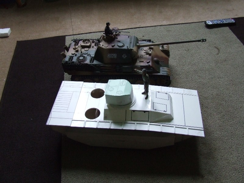

Nice one on the pics Andy. Ive done a bit more and made a start on the turret. Im on nights at the moment so project slowed a bit.
I put my Panther alongside for comparrison too !

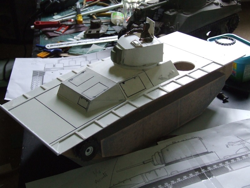

Ok night shifts over and couple of days off to do admin, laundry. vote and crack on with the build. Anticipating the change of running gear main focus is on the top of the Hull, speciffically turret. Here we are so far, had fun making brass hinges, I think I need specs
