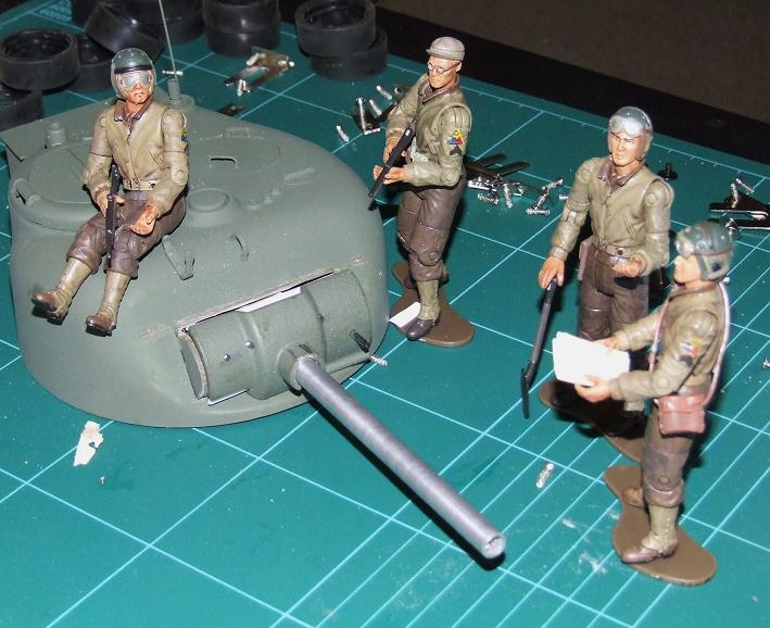

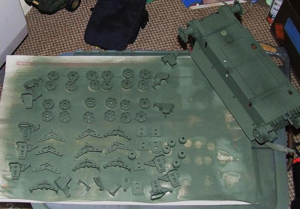

More work this evening,
Come to an acceptable conclusion on the mantlet, and the Crew seem really pleased though the skipper is still trying to figure the plans by the looks of things ! Also stripped the suspension right down and sprayed having succesfully completed 1 complete unit split as per Bubbajoes technique ! Boy needs a lot of patience
I used Humbrols canned spray Light Olive Green, which isnt quite the shade I was after but I think it will weather up well. The finish is really very good out of the can.

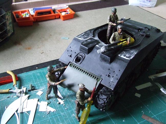

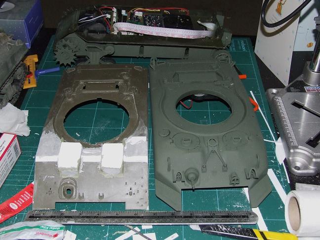

Things are progressing. Man If I had any idea how much work in terms of man hours this thing was going to take, Id of stuck with the out of the box look

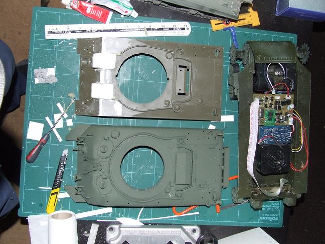

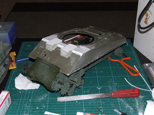

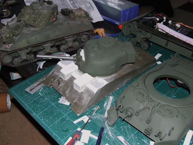

So... oops Tamiya upper hull arrives (well it was cheap as chips and I thought..why not ?) Set to work trying to construct the drivers and co-drivers compartments, after re-angling the Glacis plate from 47 to 56 degrees. Not such a difficult task, as I downloaded a printable protractor and used it as a cutting template.
http://www.ossmann.com/protractor/" onclick="window.open(this.href);return false;

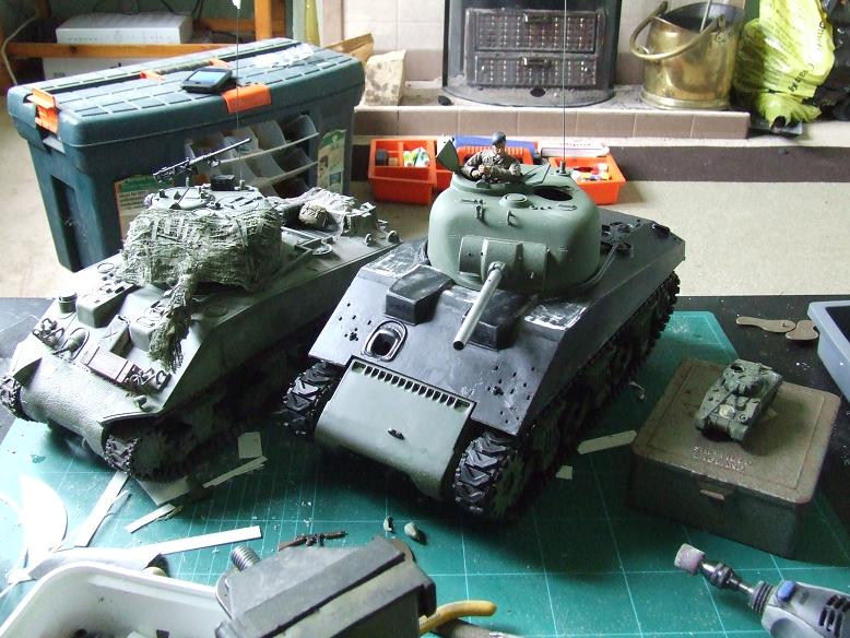

Struggled to find a scale plan and looked at thousands of pics for reference...then remembered my 21st 1/18th Sherman was sat there as an ideal model to work from. Sometimes I amaze myself how thick I can be. Next to the Mato Hull for comparrison, The Tamiya hull is a good fit but you need to shave off about, rough guess 1.5mm off each side of the Mato lower. With the Turret on for checking fit Primed to see how rough the sanding had been, and little helpers are keen to get on with the job. Suspension finished. Ive left the centre suspension units unmodded for now. I figured they would lend a bit of strength to the undercarriage and not detract too much from the effect produced by Bubbajoe's mod. With reference models, 1/18 to the left and 1/76 matchbox firefly, I built in mm let me see 1979/80ish !! So now it looks like a sherman again ! sort of. More work to do over the weekend.

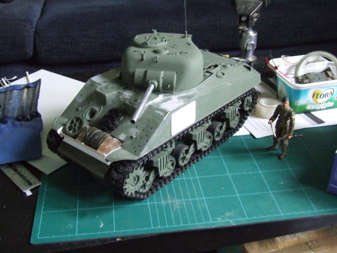

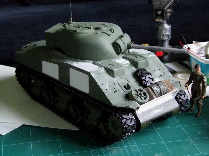

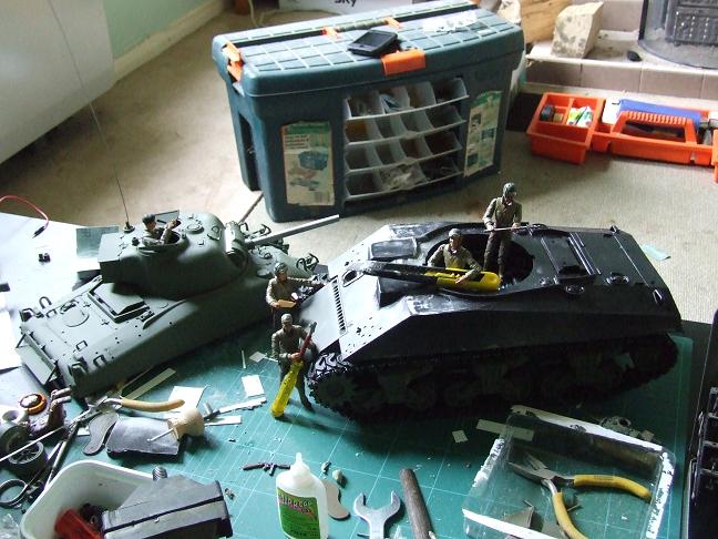

Bit more progress, starting to look the part now
Will keep slogging...problem is Ive had an idea for a slightly bigger project
