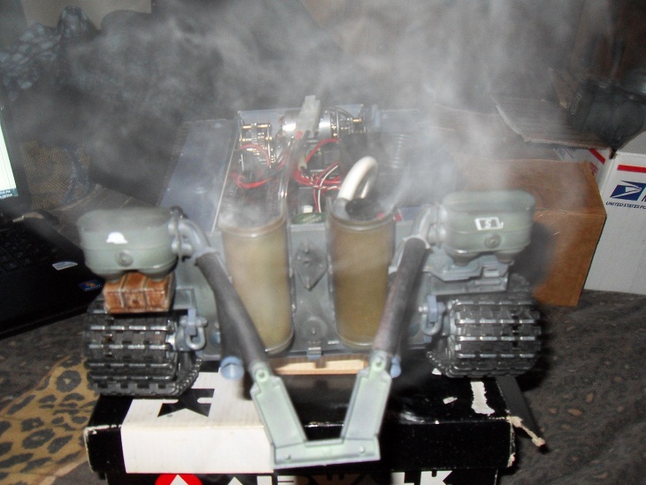

Re: Heng Long smoke units..problem solved!
Posted: Sun May 09, 2010 4:28 pm
by Saxondog
I believe this is the smoker problem solved in a different direction,fog fluid,fan powered,Kevlar wick,fluid matte,and no spill filling system.Next application is the Kill mode smoker coming soon.
Finished Product
Finished Product
Installed in my Tiger S13
Smoker at full speed
