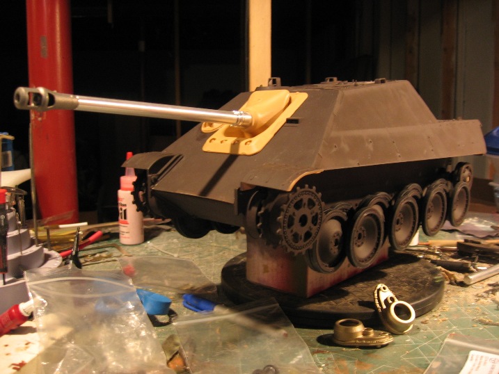

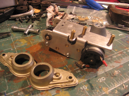

Some recent work done. I was able to get a few asiatam motor mounts (pre-tapped brass standoffs) which are the perfect height for tammy hulls.
Replaced some of the 3mm screws, locktite, etc..

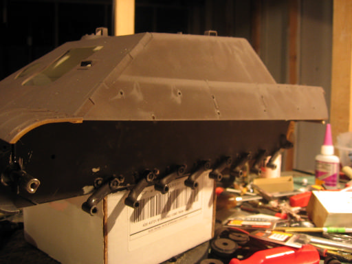

Primed in rustoleum brown (i find this takes all military colors better than the red primer and dries in 15 minutes and really sticks to metal and plastic)
Primered flat winter dirty white inside (left over from stug spray). Much easier to find little bits...

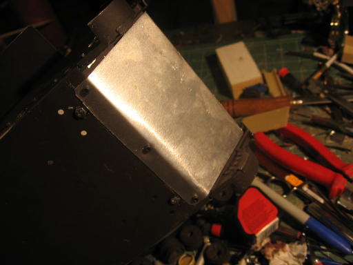

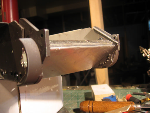

I don't need the tammy motor grooves in the hull so covered with sheet aluminum tucked and epoxied to upper hull lip (inside another aluminum u channel) and the bolted to bottom w/some epoxy to hold it all together. A little milliput and all will be well...

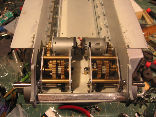

Brass standoffs on asiatam motors and Schumo final drive covers (real nice items..come with rubber covered guide wheel). you will have to drill some new holes. BE careful not to put your mount in the way of the torsion bars!!

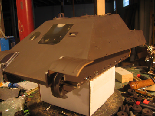

primer flat brown. Impact metal drive guards (real nice casting)

You certainly don't have much clearance between those motors, the stand offs have saved me on two builds and look really good as well.

motor clearance not too bad as the solder lugs are opposite each other and can be bent for more room. The gearing of these boxes is more than enough for moving the scale weight around, so I can afford smaller motors with less torque. Unfortunately, hard to upgrad these stubby motors...

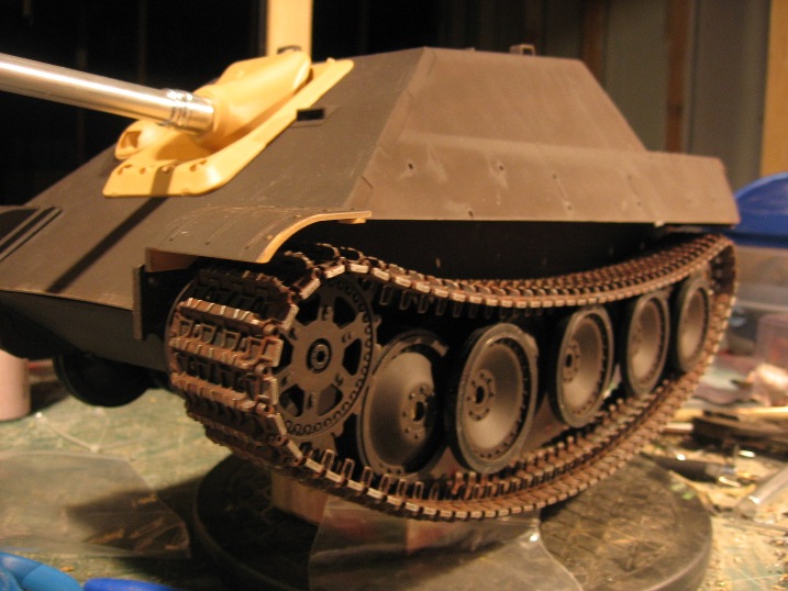

The tammy JP goes together really well. Parts are easily available for the lower hull from several dealers (Jason's store/ AAF/ Ebay)
You can construct the lower hull fairly inexpensively (compared to the whole JP tammy kit)
The best part is the tensioners. Really well designed, but make sure you buy the correct tammy parts bags otherwise you will be missing some of the parts.
going together well
going together well

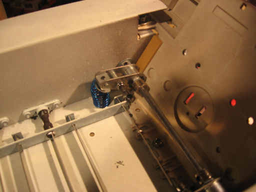

rear tensioners with my spring upgrade

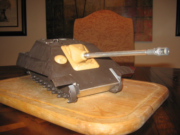

whole upper unit is stock tammy. But i have to say that the HL upper hull actually fits the Tammy lower hull better than Tamiya's own piece!!

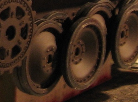

Thanks to Steve at Welsh Dragon! I finally have a complete wheel set for Tammy hull. I was unimpressed with the quality of the new Asiatam tires as the rubber has that distinctly Chinese sweet rubber smell. The rubber is somewhat soft but looks like if left out in the sun for too long, it will degrade.
BUT: the detail is MUCH better than the polyurethane looking older model rubbe (shiny, smooth, featureless) There is very nice wear/rough surfacing and appropriate lettering/numbers. I am not sure if ALL of the panther/JP wheels metal wheels have this rubber, it may be date or manufacturer specific. But I avtually like this set better even though I don;t think they will last foir years.
ALSO: I ordered a set of tammy rubber wheels. The tires for the spaced set of road wheels WILL fit the asiatam metal roadwheels. But you have turn the tire inside out and with a set of sharp scissors, carefully trim the THICKER band by about 1mm. Easy to do and then they fit perfectly. However, the closely paired wheelset will not fit the tammy tires without major work. The tammy rubber is excellent, but also lacks details...
