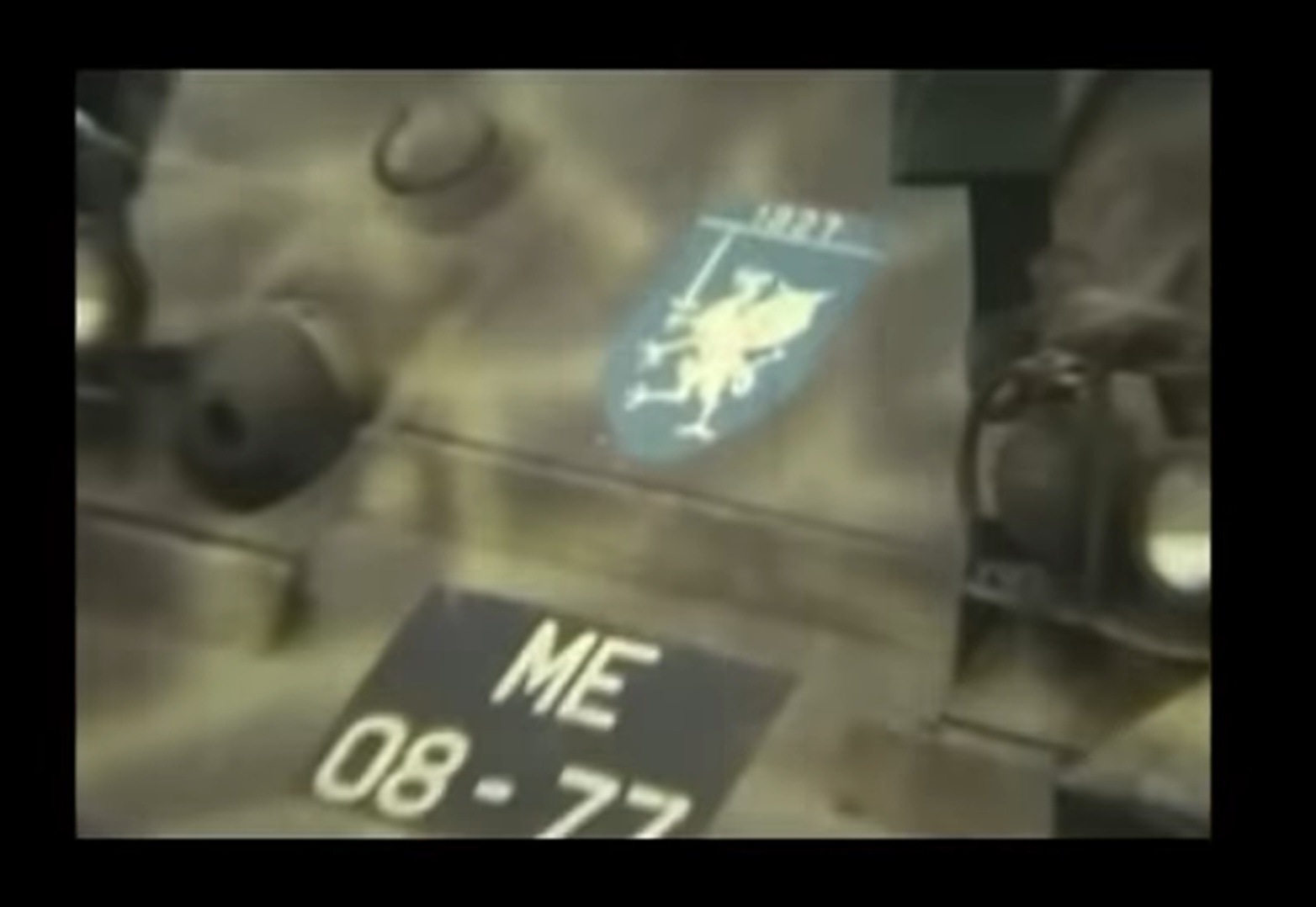

ME-08-77 had "Gina" painted on the turret machine gun shield, and on the hull front at some point. She also has crossed sabres in white on the left hull sponson, and a stylized 1927th Cavalry Battalion coat of arms on the upper glacis. I like the splash of blue on the camouflage.

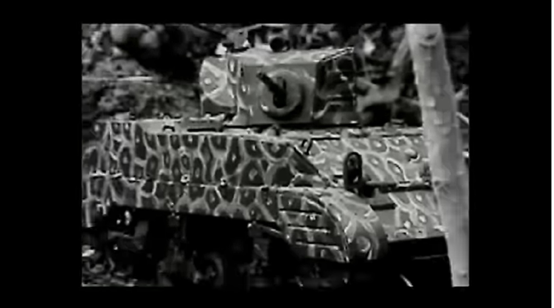

So there will be chopping and sanding to remove the sideskirts. And then I see these cryptic photos on the DVD.
But other than those two images and a third one capturing a tiny bit of sideskirt, none of the film or stills of the tanks being unloaded from the freighter or in action in Angola show sideskirts. So where was this mystery tank?

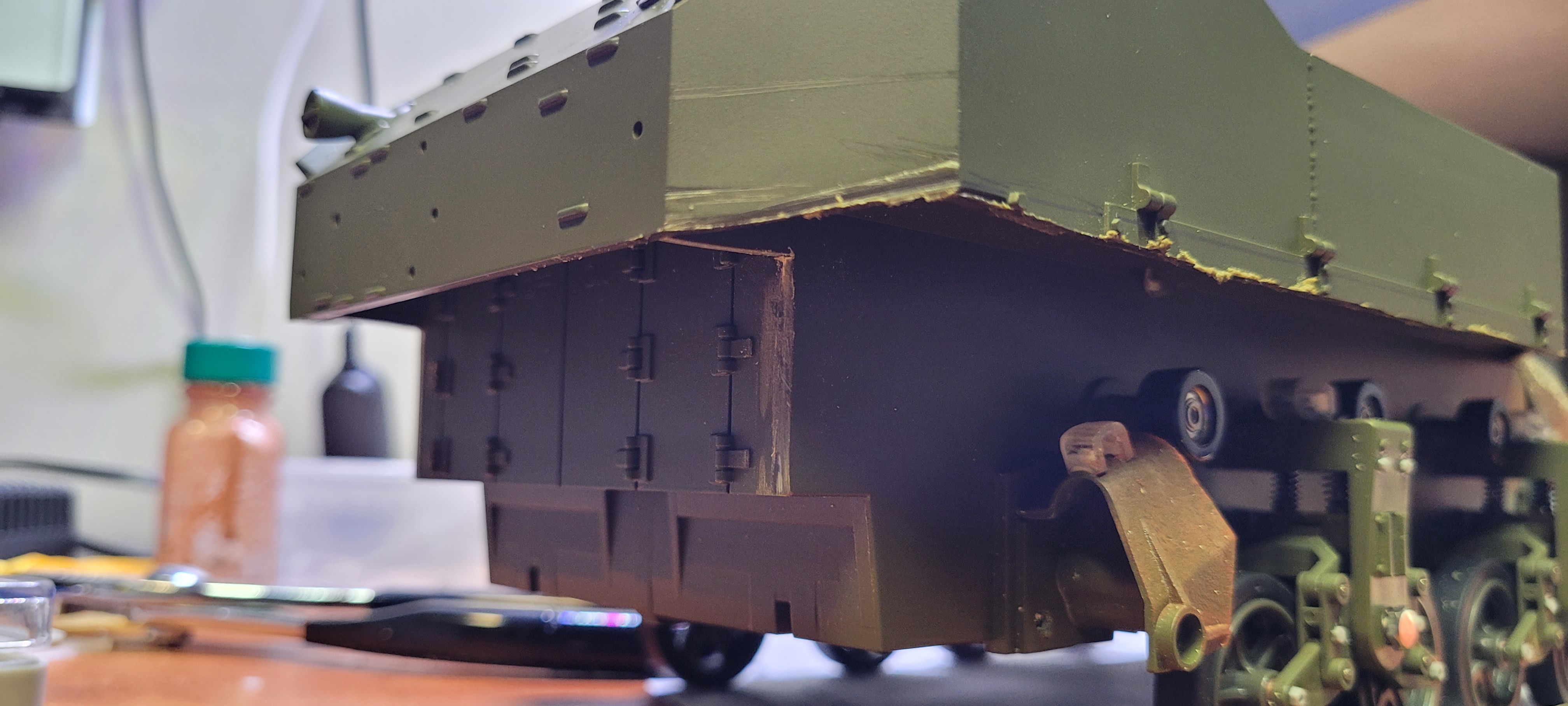

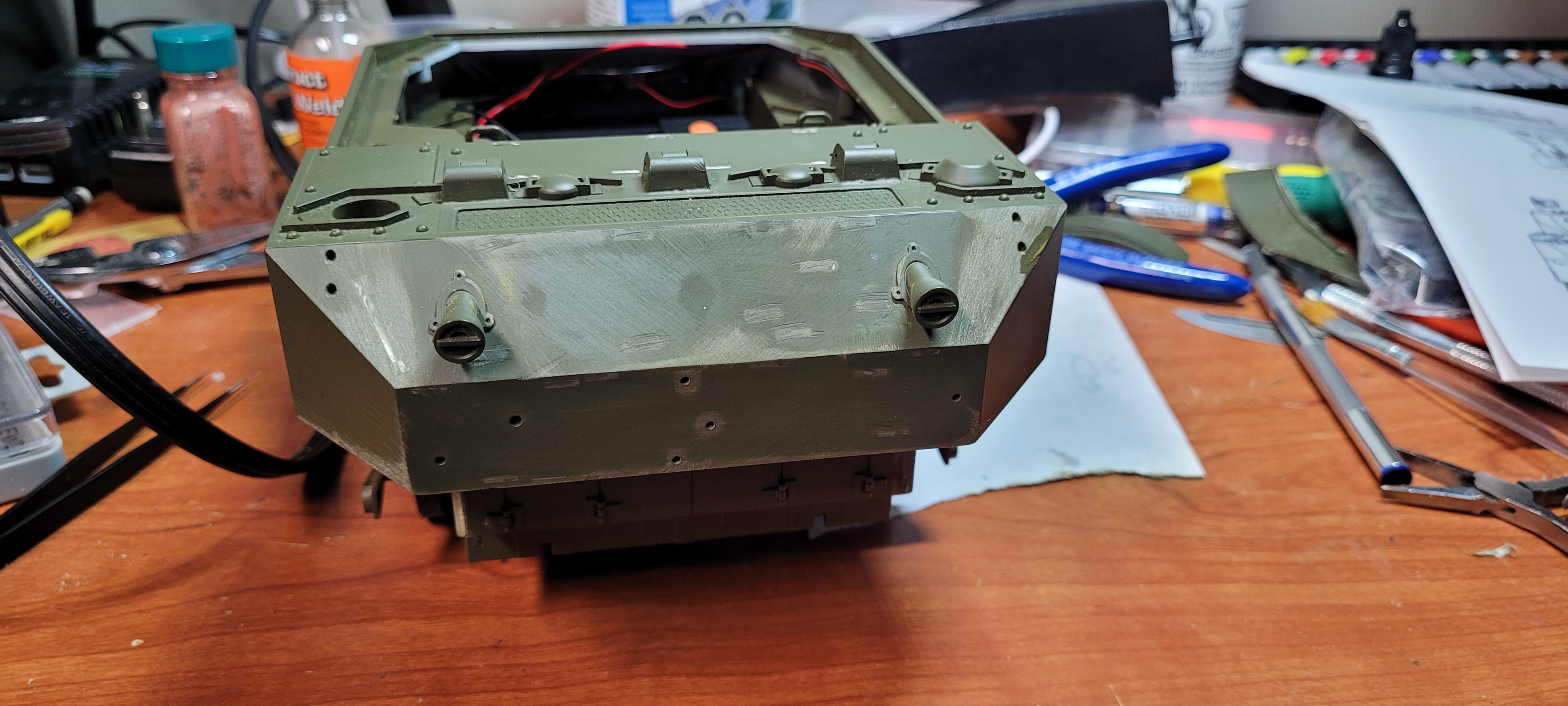

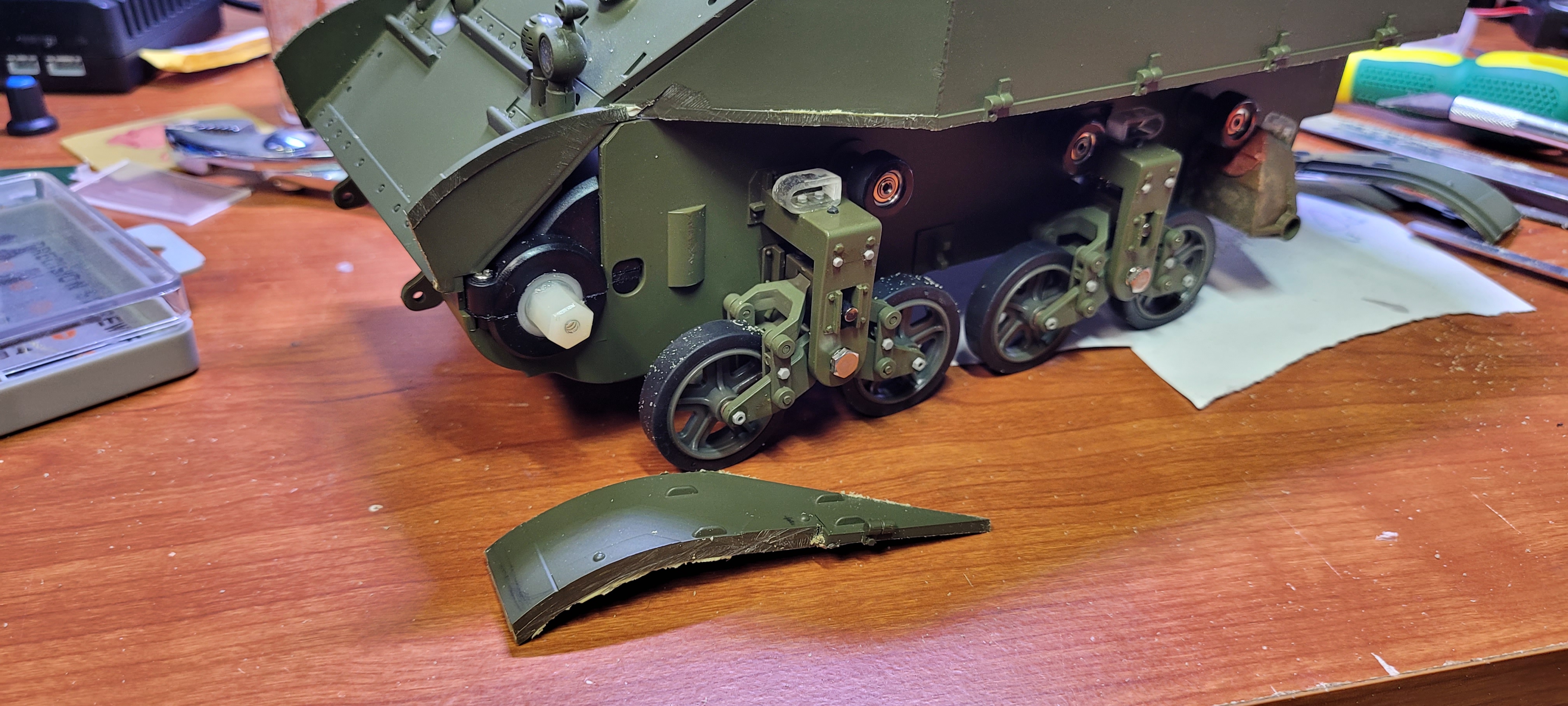

Off come the skirts! Preliminary sawing gets the bulk off and then final trimming.
The front and rear fenders are pretty small on a Stuart, and that just emphasizes the overly thick Coolbank versions. With no skirts to hide the edges, and some weird stepping on the fronts, I decided off they come to be eventually replaced with thinner versions.

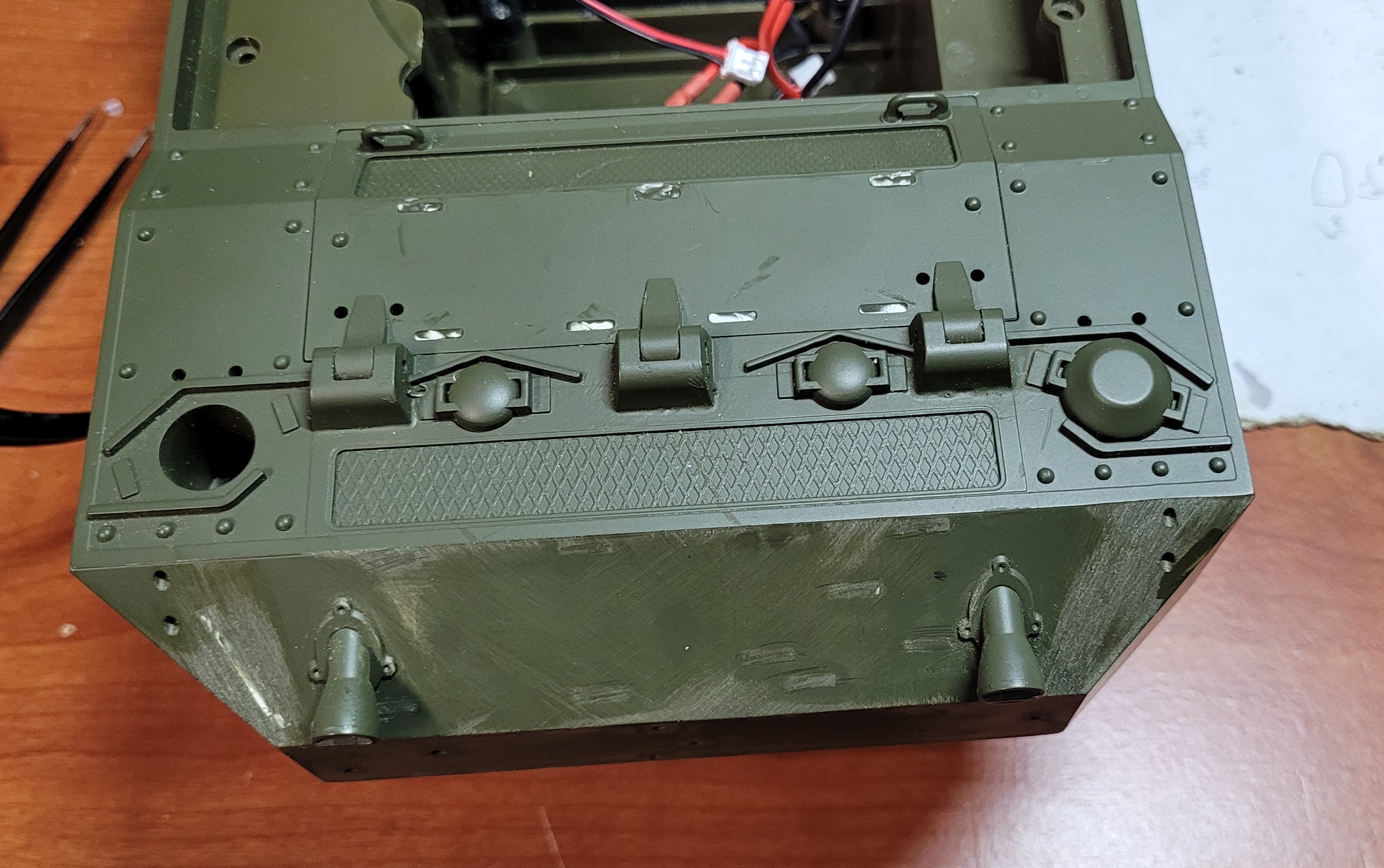

And the back end needs all of Coolbank's little bumps and warts removed that are supposed to be tie downs for gear and tools. Wire will replace them. Some small brass hinges are in the mail to replace the ginormous hinges on the engine cover. Drat Ecam for pointing out how comically large they are. Now I can't stop staring at them!
Coolbank has really simplified and toyified this tank, but nothing that can't be cured at least part-way.
