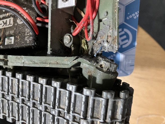

Either type of metal track will cause issues. While we in the UK can not see pictures from Imagu, I am aware of what you are referring too. The all metal tracks just look horrid, and will never look good on a modern tank, as they do not look realistic. The tracks with the “plastic boxes in the middle “ better represent modern tracks, with rubber pads, so they can drive on public highways without ripping up the surface. Both types of tracks are heavy, with the ones with the pad being even heavier. Both types of tracks need to be tight, modern tanks behave very differently to your two WW2, ones, depending how hard you run them. All metal tracks look good on these WW2 tanks, because they were never fitted with the rubber pads, and are generally wear in a realistic fashion. These also run loose, so are less prone to coming off. By staying with the all plastic tracks, you will alleviate a lot of track retention problems. If you do buy metal tracks the very least, modification to do is fit drive shaft bearings, to give support to the gearboxes.brucektrain wrote: ↑Mon Nov 24, 2025 3:49 pm
You meant a Track with Metal and Plastic boxes in middle? But there's some of metal track in aliexpress are all metal.
You suggesting to get all metal track (no plastic in between?)
T90/T72 will crack the hull at the front idler.
Challengers, just love to cause issues. When fitted with metal tracks.
My Leopard, with it’s all plastic tracks just works. It has never detracked, and needs far less maintenance. The terrain here in Scotland is difficult. Your terrain may be different. There are so many variables. The choice is yours, but for me, I’ll stay with all plastic tracks for now.

All the models you have considered will be fine on the terrain you have mentioned. Just retain the plastic tracks, and upgrade the sprockets and idler to metal, and fit drive shaft support bearing. It is only when you start adding the heavier metal tracks the problems start. T72/T90 metal tracks look good, because the Russians don’t worry to much about ripping up the road surfaces, so don’t bother with the rubber pads. T72/T90 will be quite happy with about 6mm of slack at the bottom when there is no weight on the tank. The cracks in the hull were after 6 years of hard abuse on the T72.
Rc Tank Liegion, Forgebear, Motion RC, and Haya all carry support bearings. But they can be expensive. I get mine from Amazon, so I don’t have a link. From memory they are 8mm x 12mm x 3mm.
These were built as plastic toys, to be run buy kids inside so the hulls were never designed for the upgrades we do. It seems you are a little overwhelmed? But we are all here to help, and give support. Once you have done one modern tank, and got it running as you like, the rest are easy, as they all require the same modifications. It’s all been done in the past.
