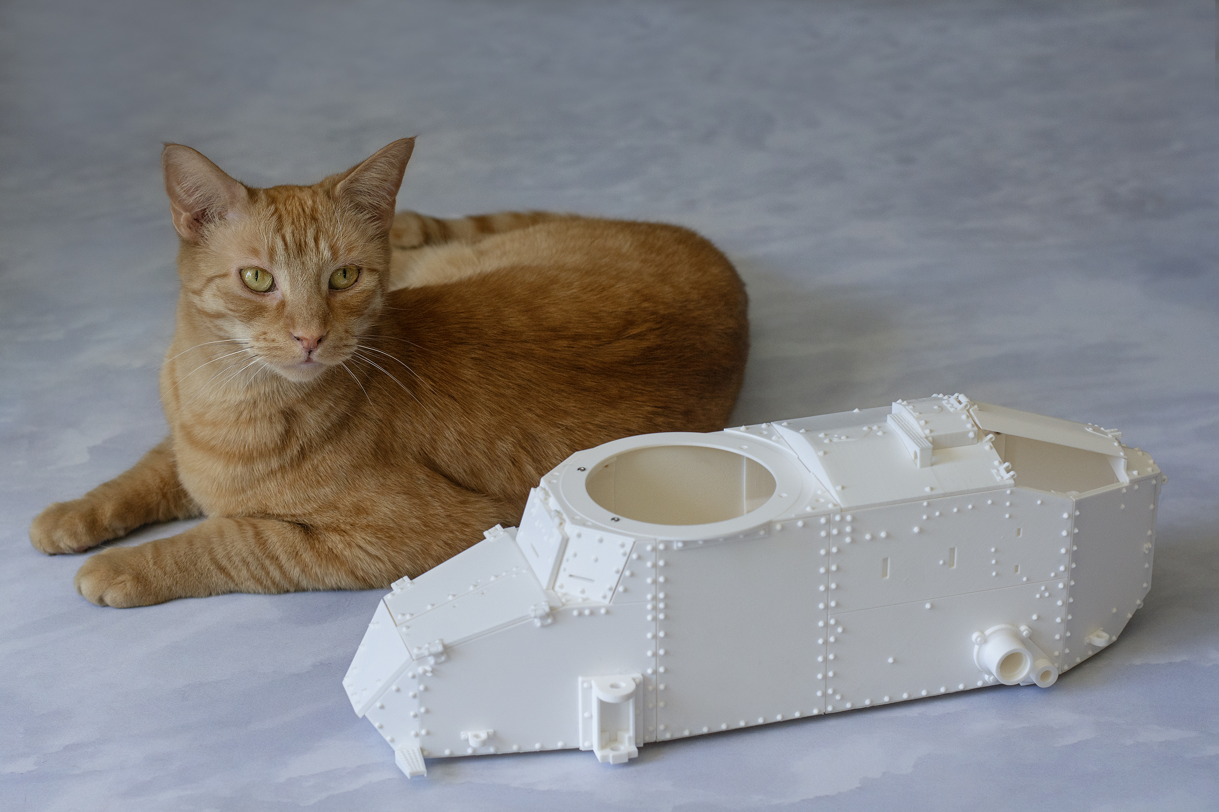

Kaczor wrote: Tue Aug 26, 2025 6:06 am Great looking model! The FT17 looks nice too. ;D
I've got four models at home, but only two are interested in RC stuff :D

Cute kitty's
My cats are the same when I am doing my models :crazy:

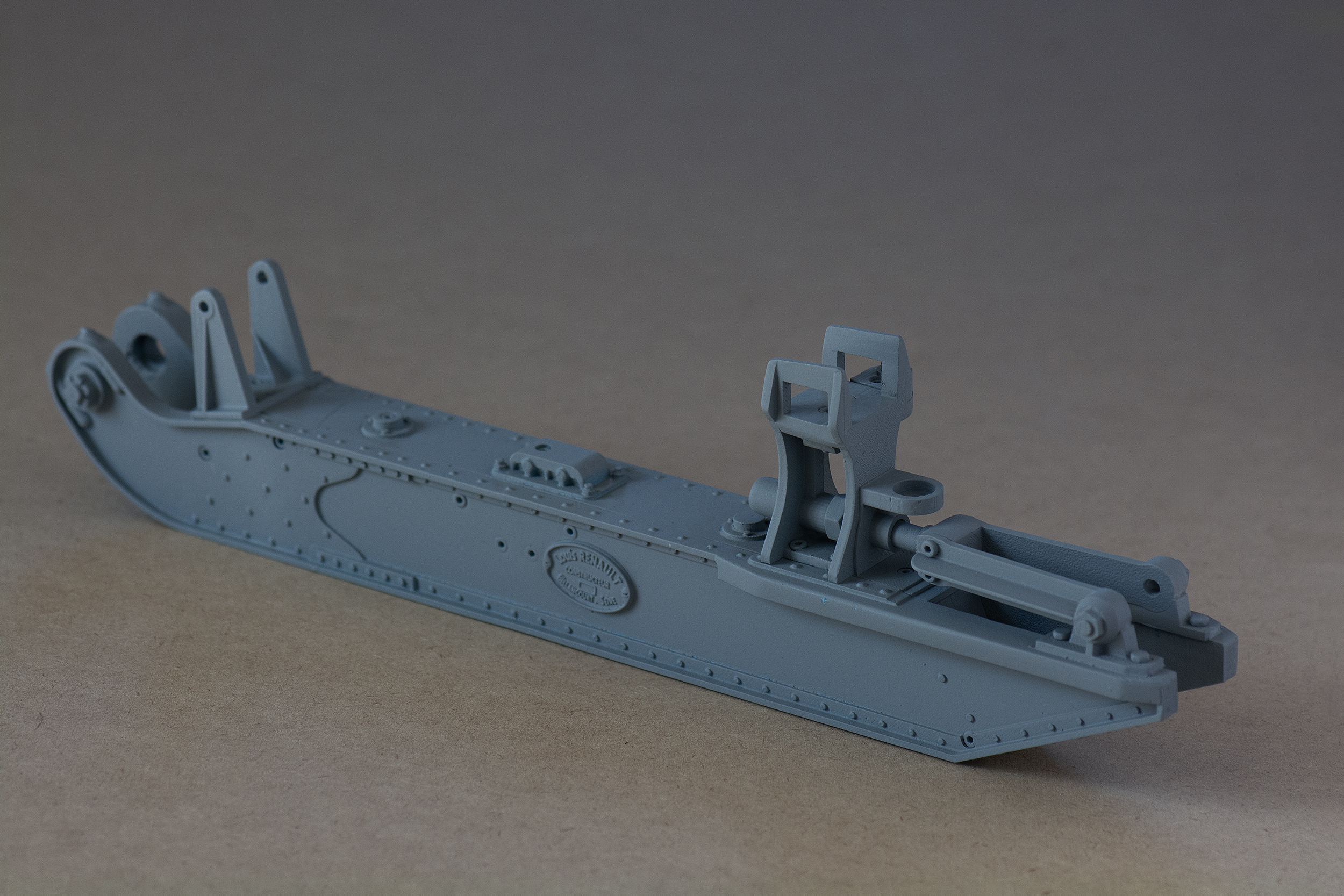

Main drive train parts assembled, partially glued together, primed, sanded, and received a second coat of primer.

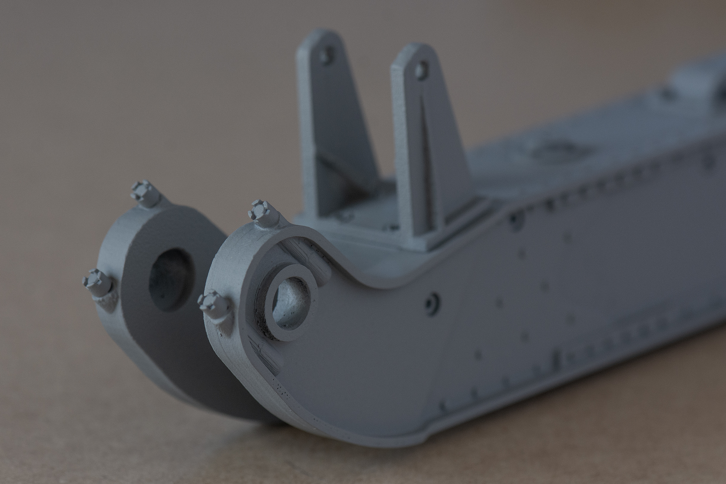

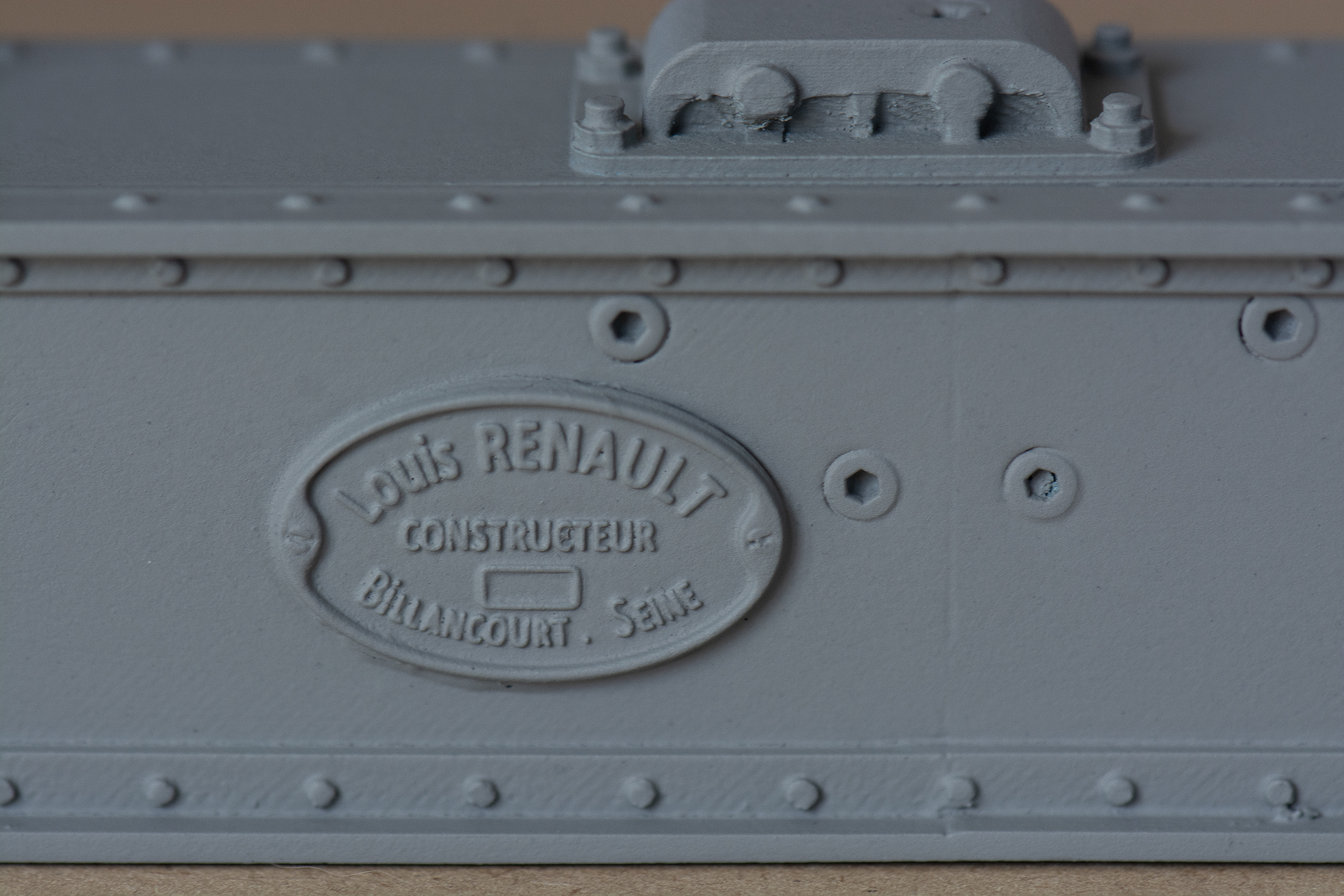

Some close-up micro shots with added small details. I modeled the Renault logo and wheel fixing bolts and printed it in resin. On micro images, you can see some 3D printing imperfections and lines left.

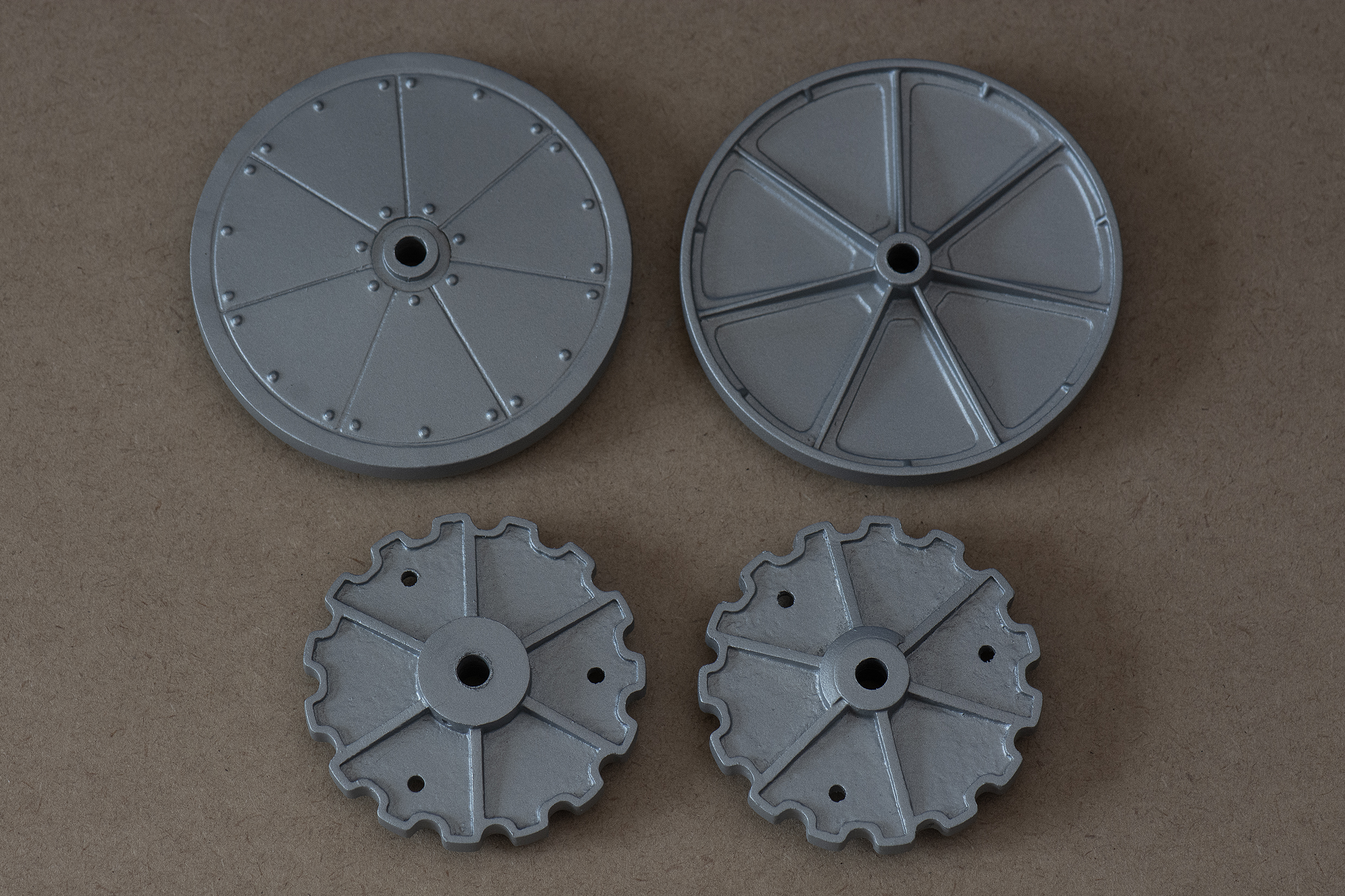

Sprocket and idler wheels. For a 3D printer, low-slope surfaces are most challenging to print; you can see layer steps clearly and easily. So there was a lot of sanding on the idler wheels.
On drive sprockets, I was trying to imitate casting surface finish. At the end, the wheels got one coat of zinc paint, just for fun, to see how it looks.
