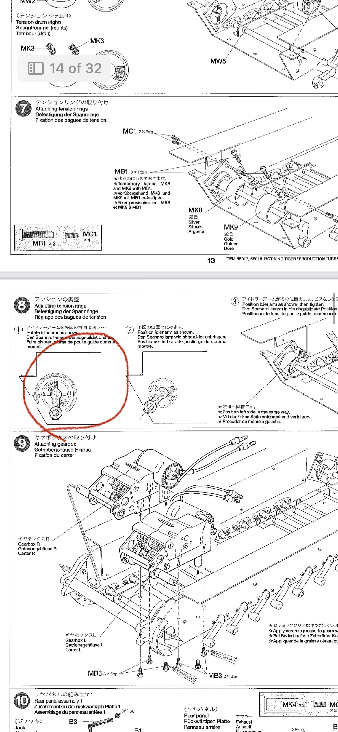

Hello
Thank you for your instructions but I have a question nothing in the stock tensioning system will be needed and can be discarded right.
Also the idler arm the one I circled in red would also be discarded and I just put the shaft in and secure it with a grub screw correct?
Also do I keep the square bracket the one I circled in red? I see online it seems not necessary?
Please help!
Idler Arm
Idler Arm
Square Silver Brackets
