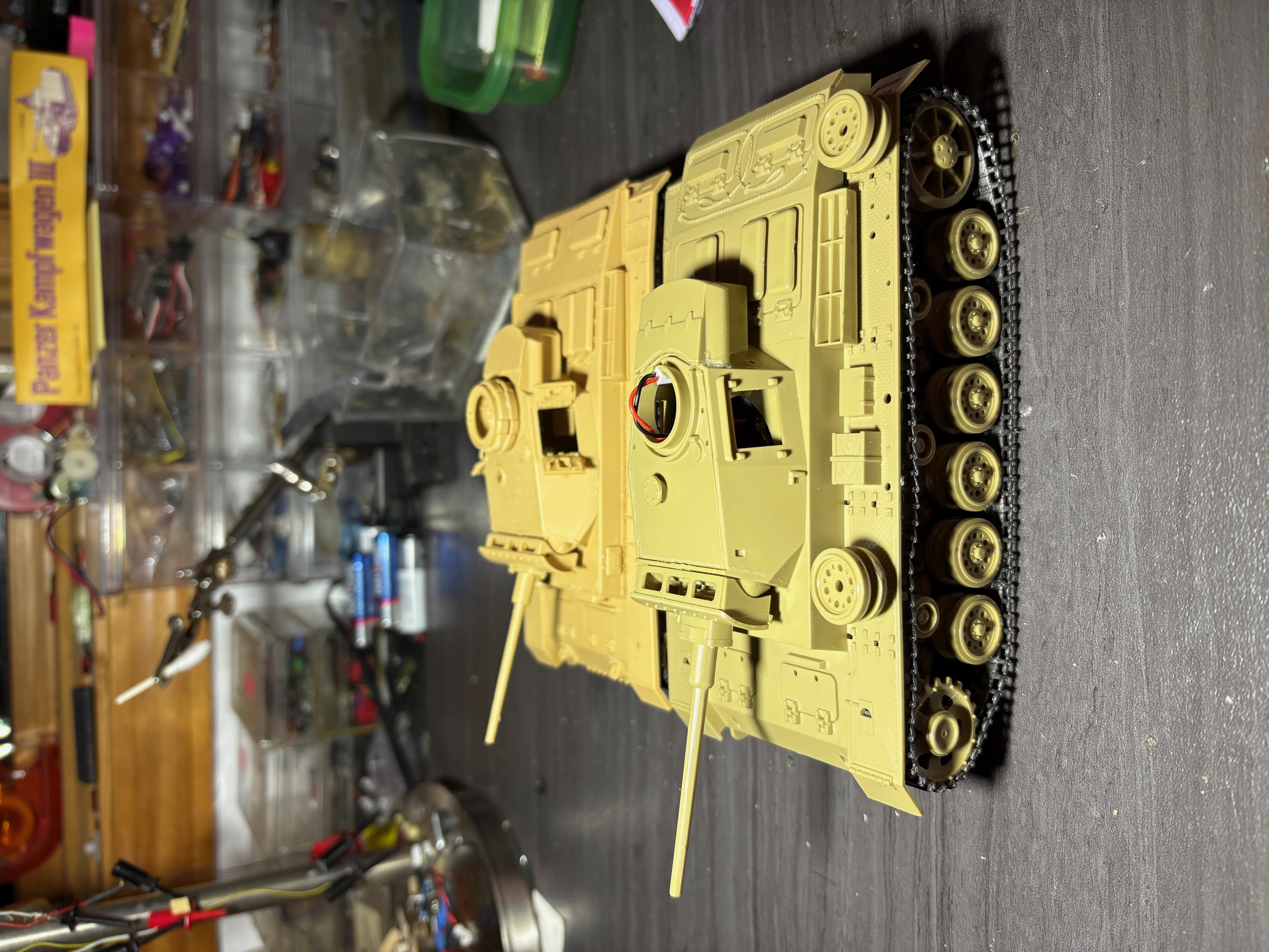

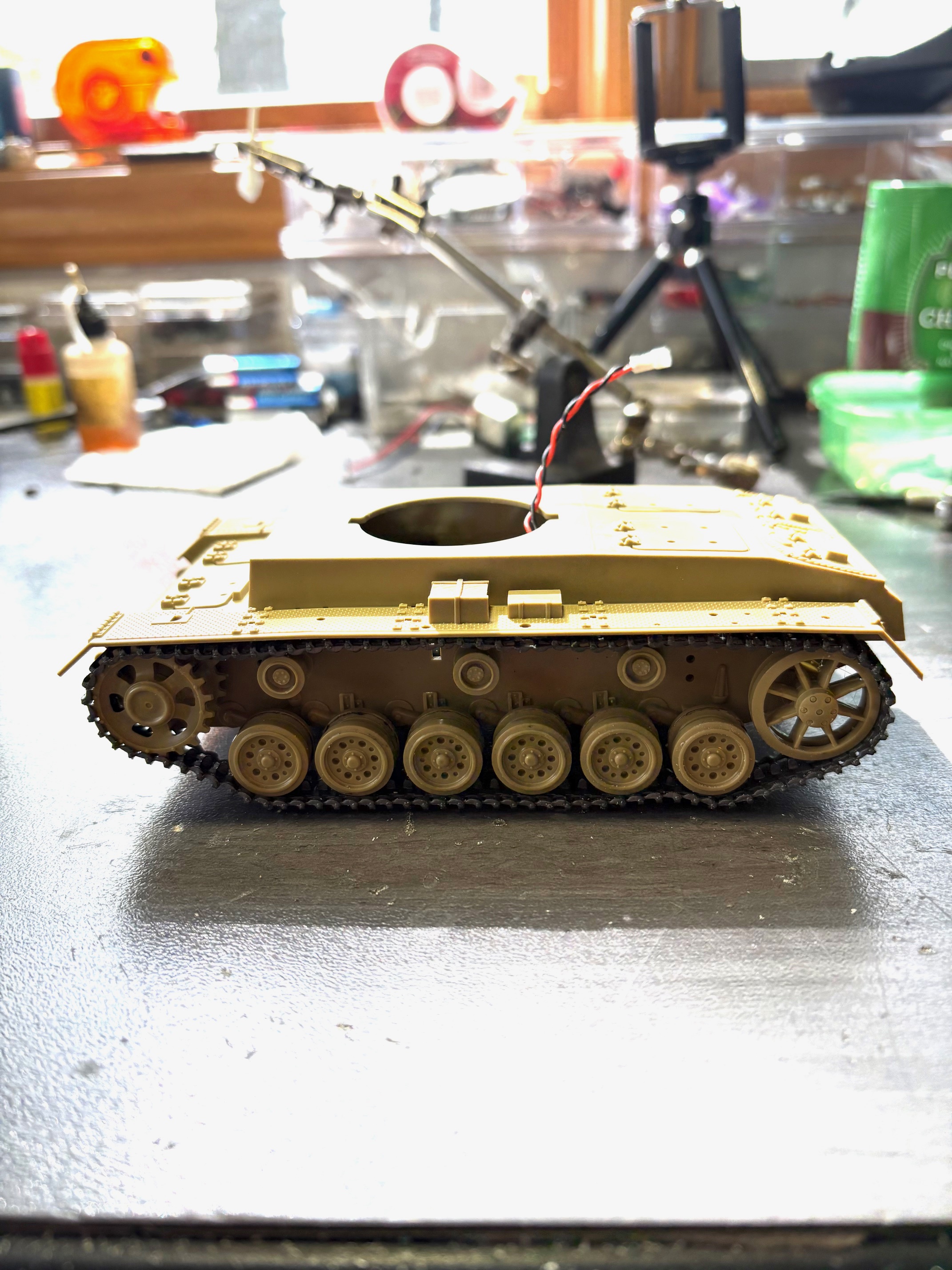

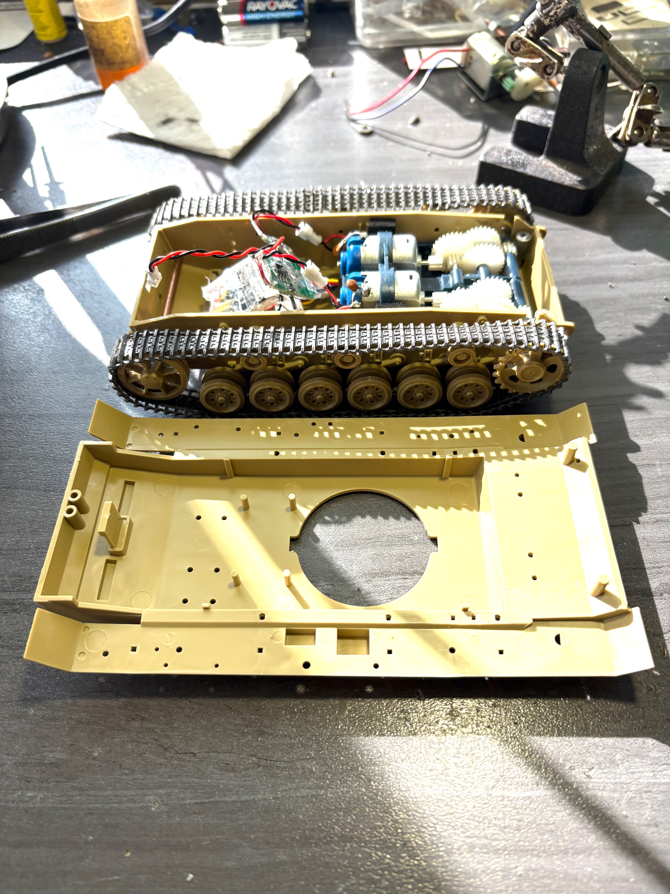

Meanwhile I tested the Panzer III chassis and it gets a pass although the poly tracks are not the best as sitting in the box for 54 years, they are a bit deformed but still just work. I will look into some ITL tracks for this Panzer.
ready to install upper hull.
IMG_0432 (1).jpg (1.72 MiB) Viewed 2360 times
More testing now to make sure the tracks don't bind or rub anything on the upper hull. You can see some of that track deformity on the lower right track in this picture.
IMG_0433 (2).jpg (1.4 MiB) Viewed 2360 times

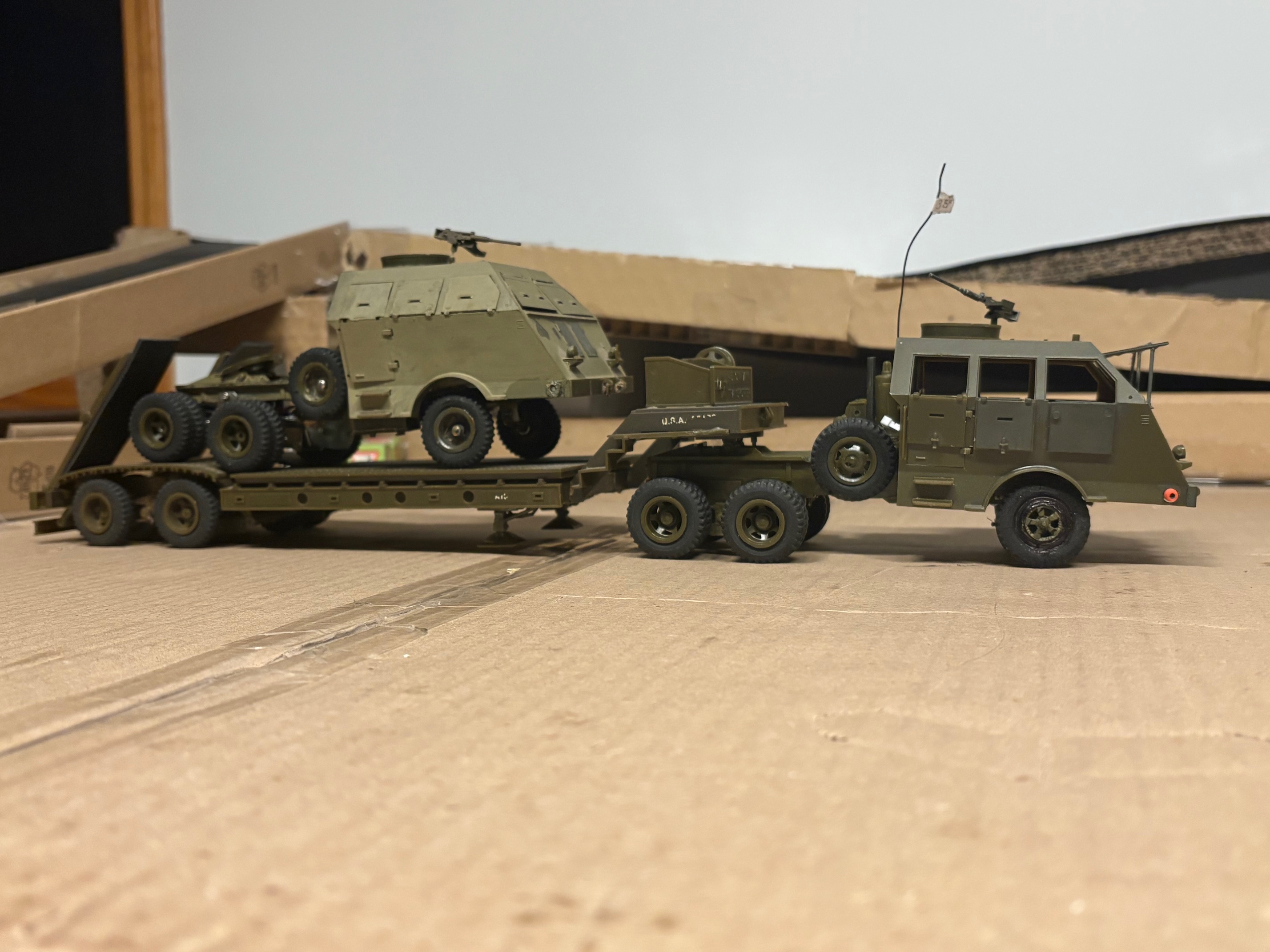

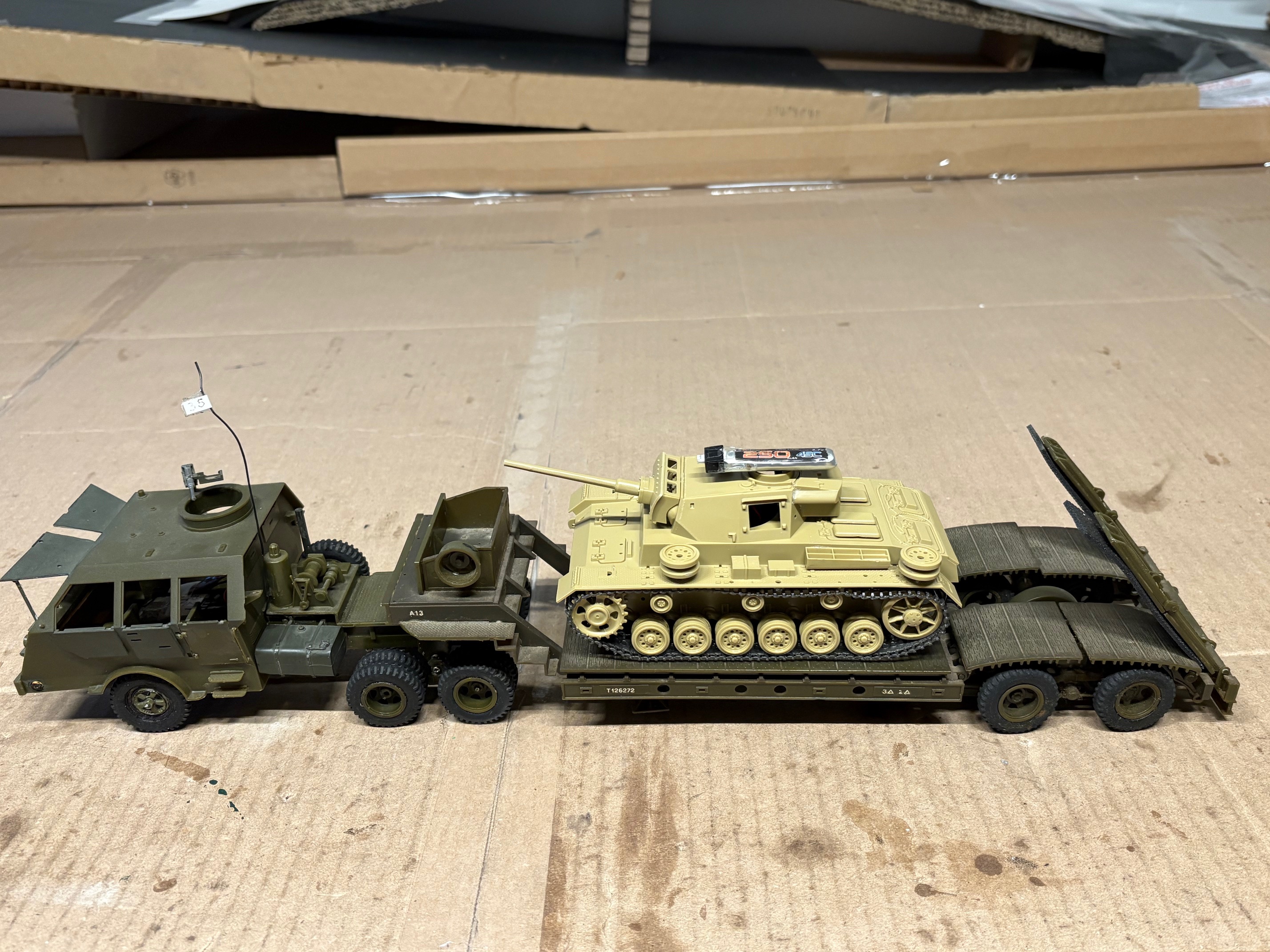

A little bit off topic discussion about the M-26 tank retriever then back to the Panzer III M\N build.
Here is the video i said I would post earlier in this thread. It shows the M-26 hauling around a Panzer III L :D
https://www.youtube.com/watch?v=9uDhTe6dP3s
This new Panzer III I an building in this thread is a "M" version so its one level higher then the old Panzer "L" series. One of the changes in the "M" series is the wider tracks with revised drive sprockets.
It can be be built as a M or N so this kit is a Panzer III M\N.

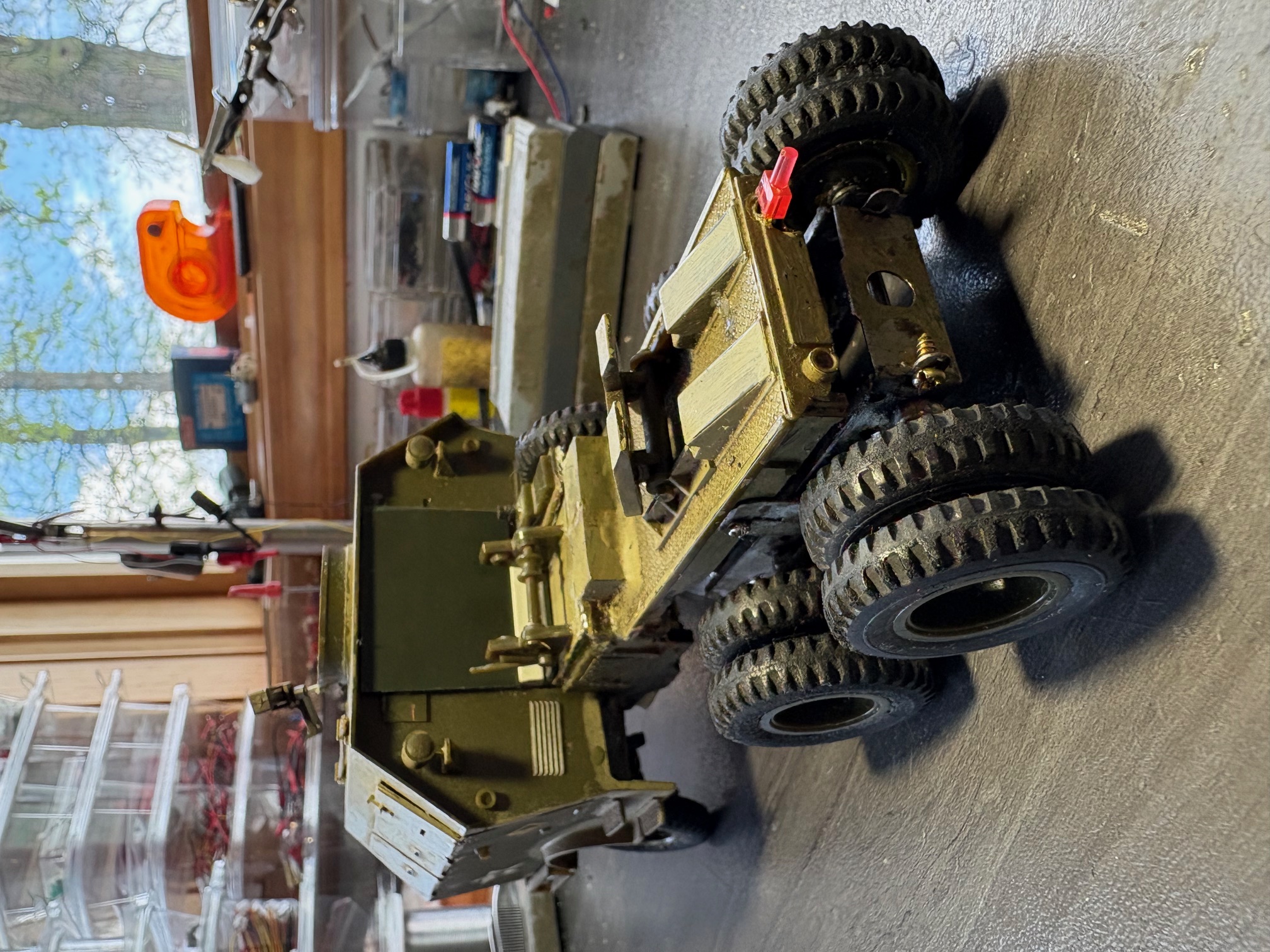

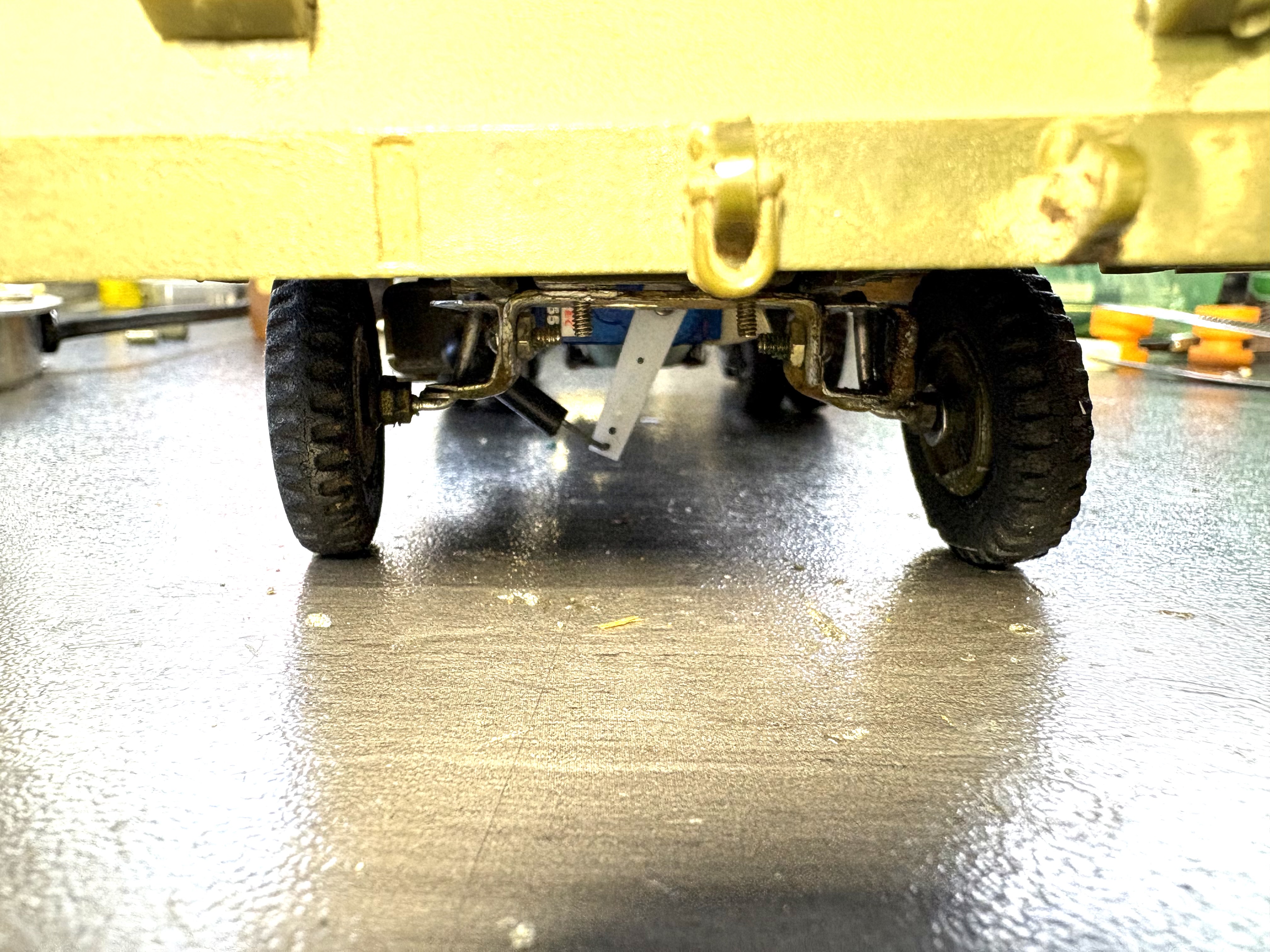

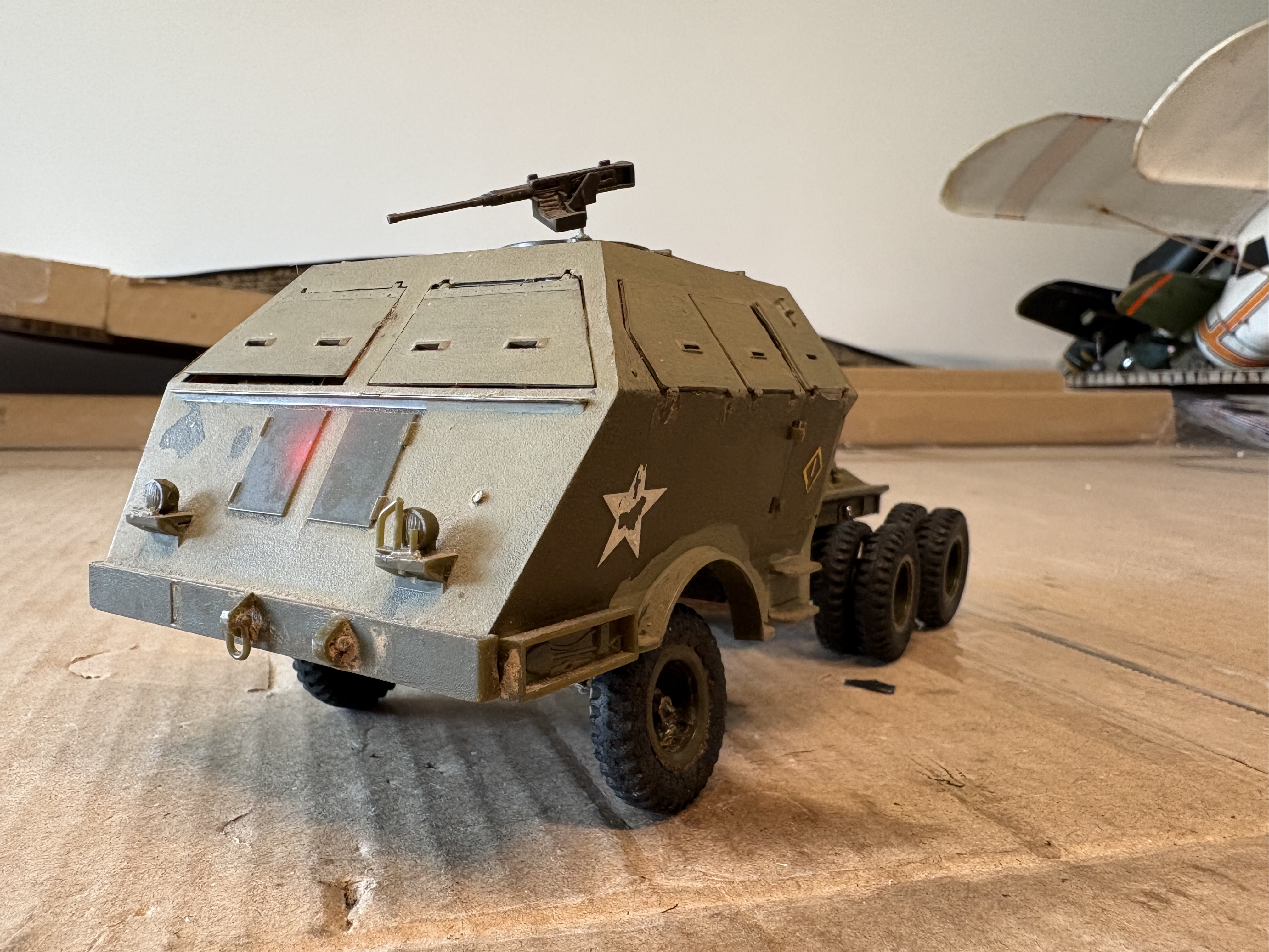

This is a view of the hand made metal front end under this M-26. I used to run this truck outside back when I lived in Tucson AZ. To run there, I needed a 4WD rear dually axle with wider front tires. I just changed the rims today to the stock width military front wheels as I no longer run it outside. In the video you can see the older white front rims inner rim extensions as the truck is coming towards the camera. Those extenders have been removed and are now back to stock width as seen in the first picture above. Yes that is an extra long servo horn to give me a tight turning radius as required for my indoor track.
4WD dually dual axles made of steel. Hand made just for this truck. I would not have the patience to build one today. This gearbox\axles were built in 1983. The front suspension on this truck is handmade as well and is also all metal. I built stuff HD back then lol. After looking at this picture, I may have to redo that taillight.
IMG_0441 (1).jpg (1.09 MiB) Viewed 2337 times

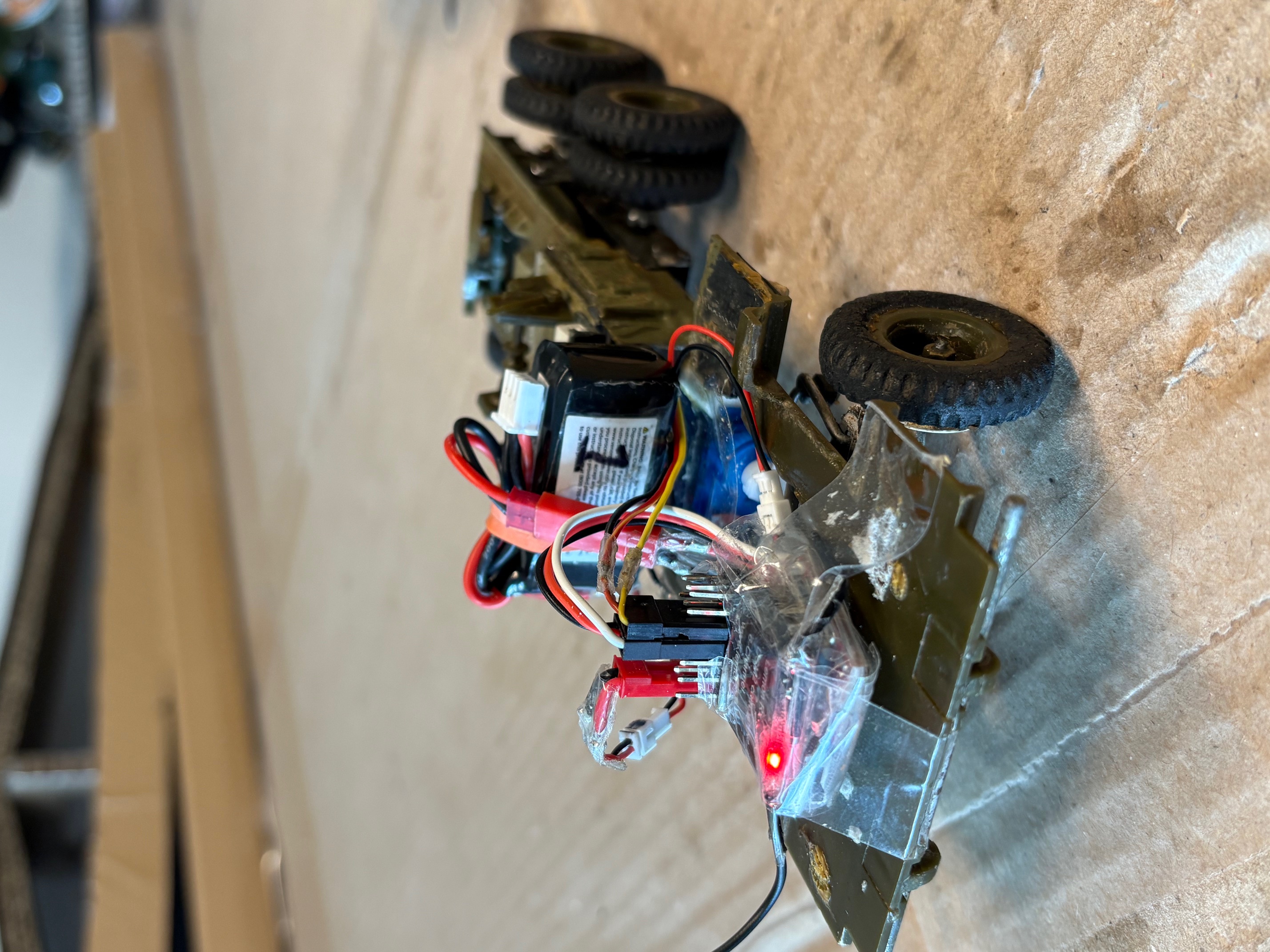

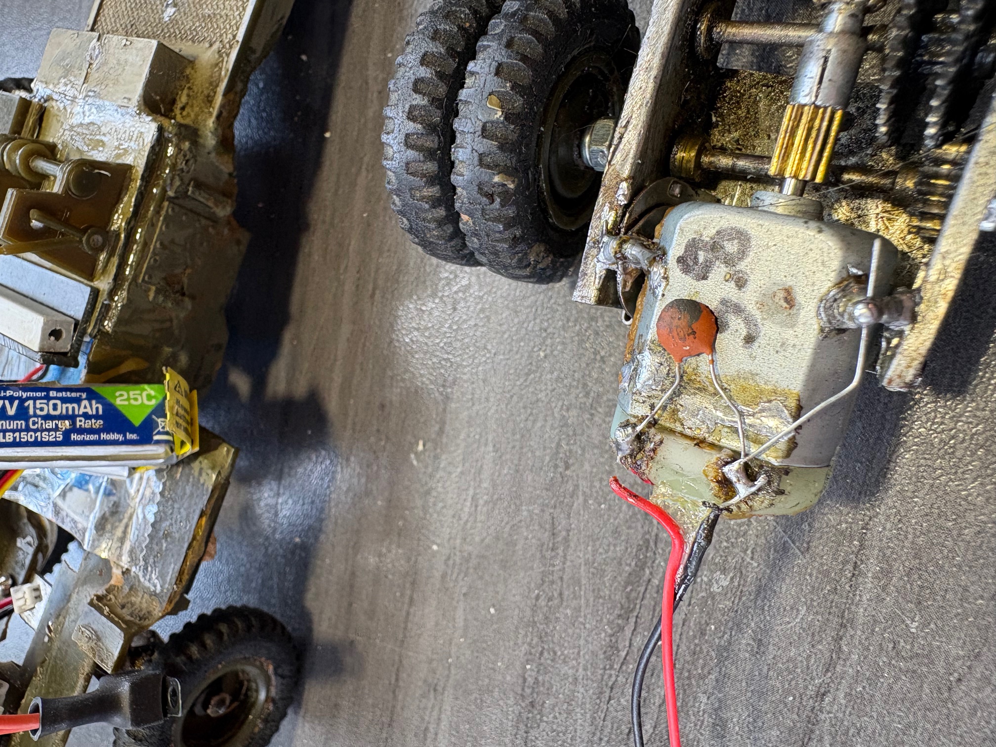

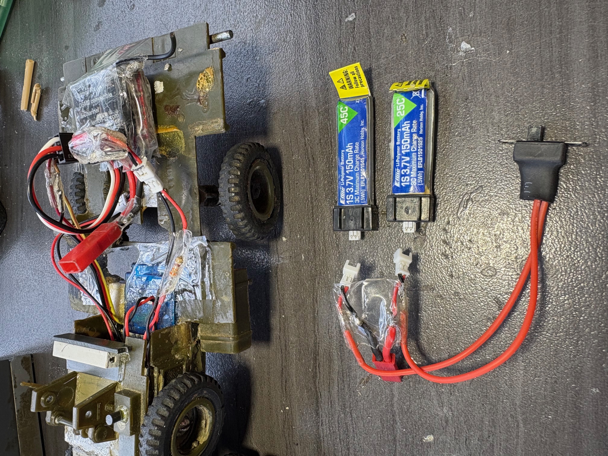

Here is why it took so long to do a video. Red wire is broken. The other wire has a solid wire going to the metal frame and the frame of the motor. This eliminates electrical noise from the moving metal parts which can cause RF glitches in receivers.
micro 250 mAh 2s wiring harness. With that removed, the chassis wiring looks a bit more resonable.
This chassis could be used for a 10 wheeled military cargo truck. Shown here with a 350 mAh 2s lipo.
IMG_0438 (1).jpg (1.34 MiB) Viewed 2339 times

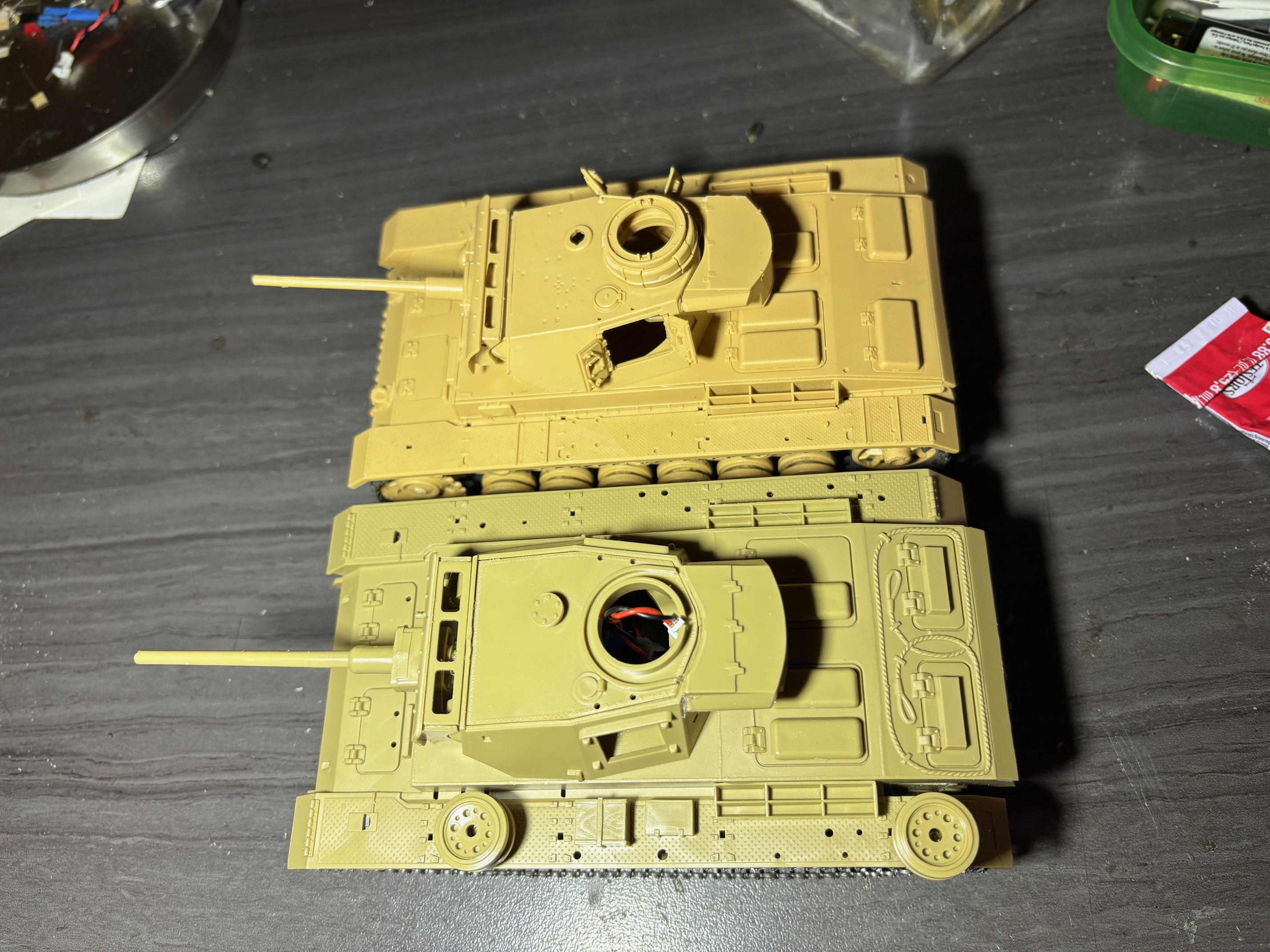

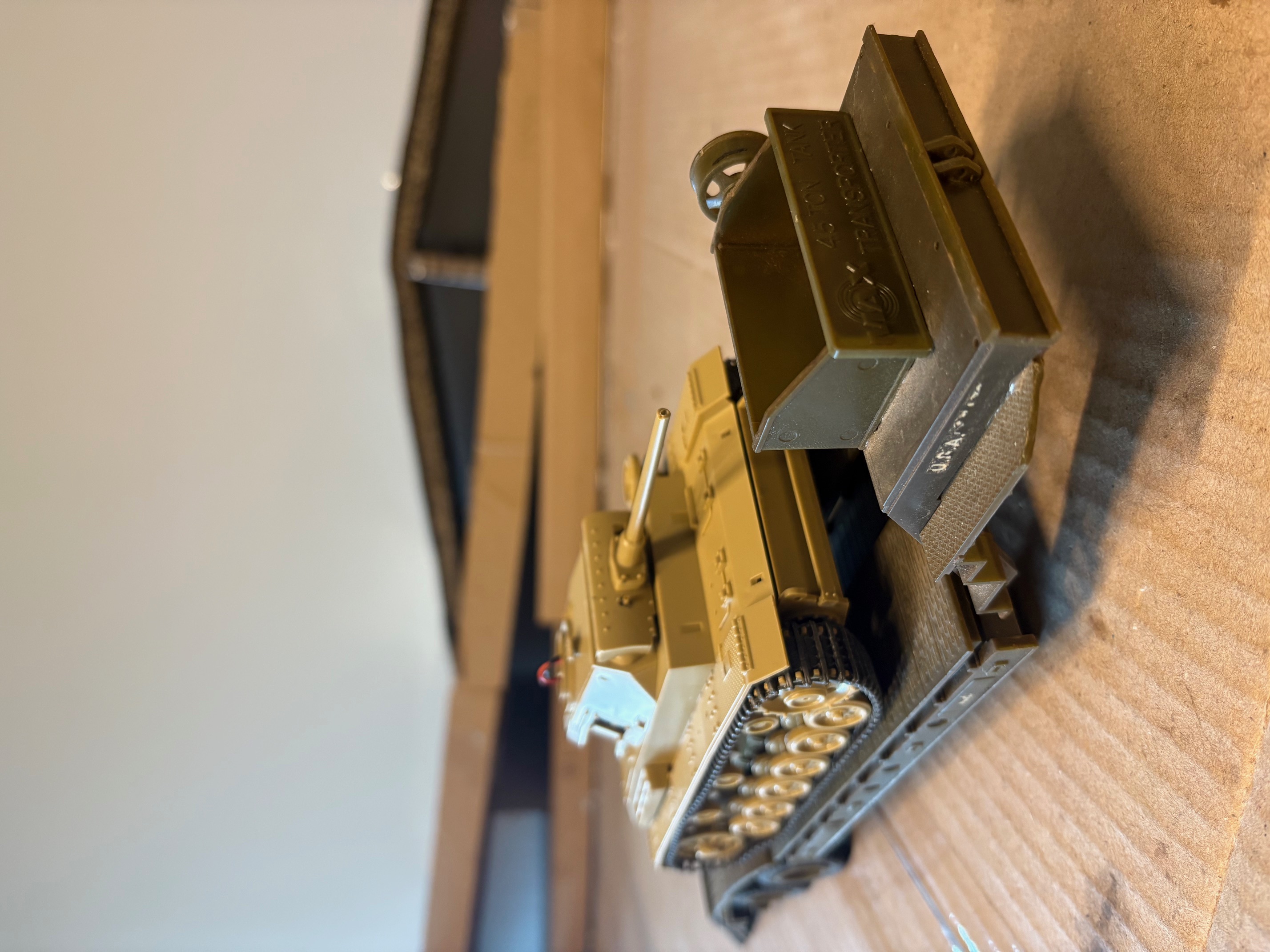

Panzer III M is nearing completion.
IMG_0447 (1).jpg (1.65 MiB) Viewed 2234 times
Panzer III M on the left, Panzer III L on the right.

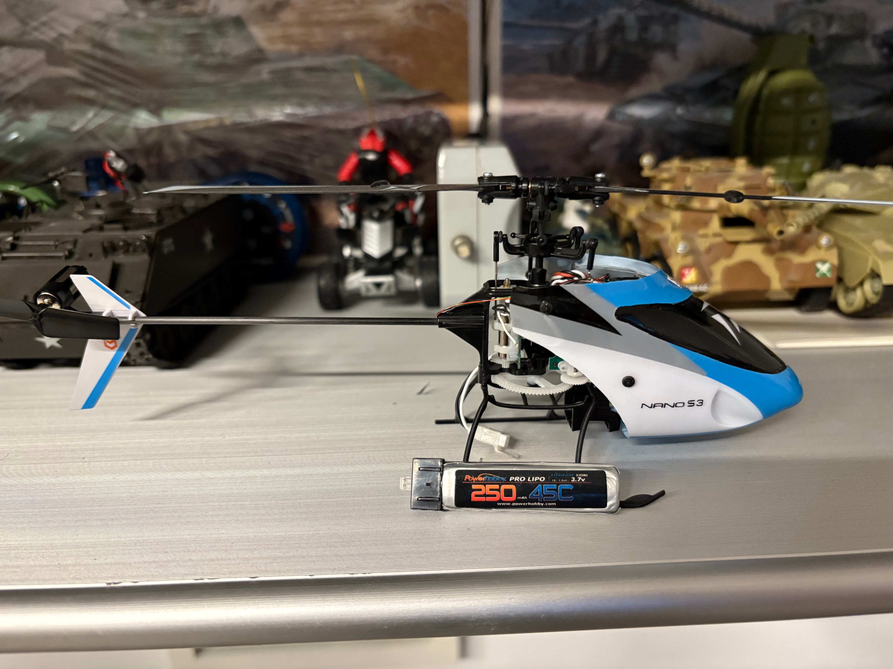

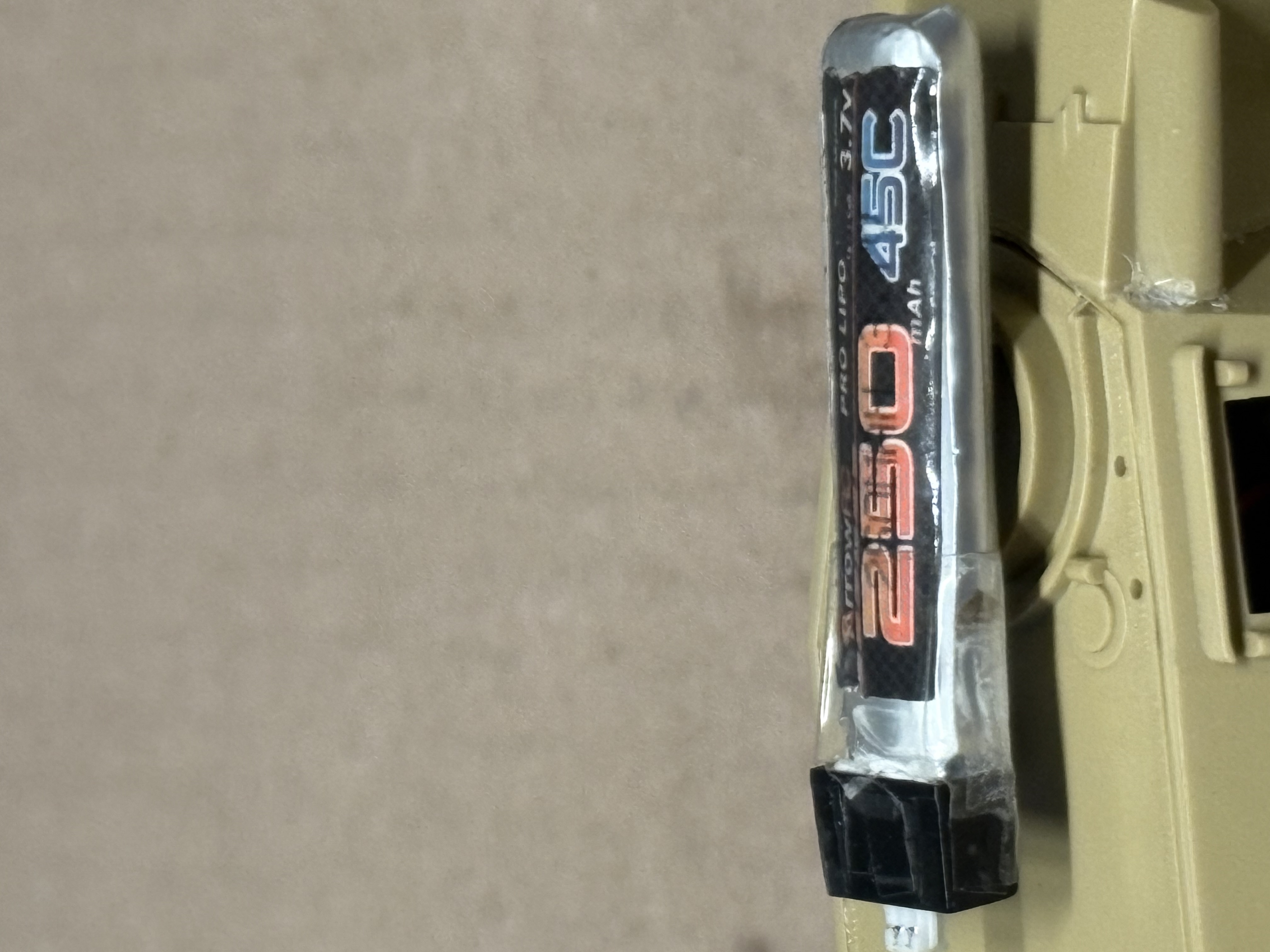

Well, it looks that way Herr Doctor but actually the yaw axis (L\R turning) needs some expo as the motors in this tank are low voltage (~1.2 ohms) so they are very sensitive to yaw inputs. You might have noticed at one point the engines got up to full speed then shut down momentary due to LVC. The battery I used in this video is very old and small and I exceeded its capacity showing off the top speed ;)
250 mAh 45c (11 amps peak) but these are old and well used and no longer work in the Heli but still good for 1/35 scale tanks.
that's a small battery for a set of 130 motors. the truck uses the same battery
IMG_0469 (1).jpg (1.71 MiB) Viewed 2095 times
The batteries I am using come from a Nano S3 UM Heli.<br />The battery in this picture is fairly new and is very potent and will easily fly this Heli 7 minutes.
