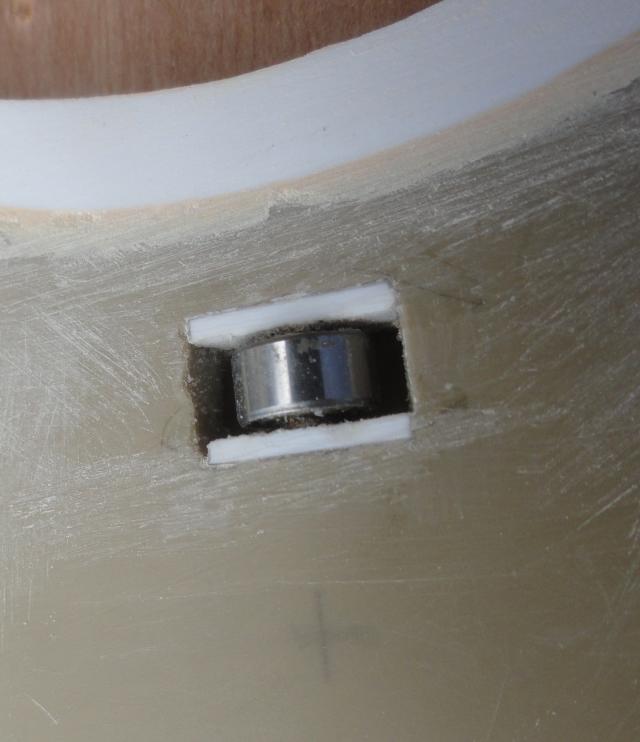

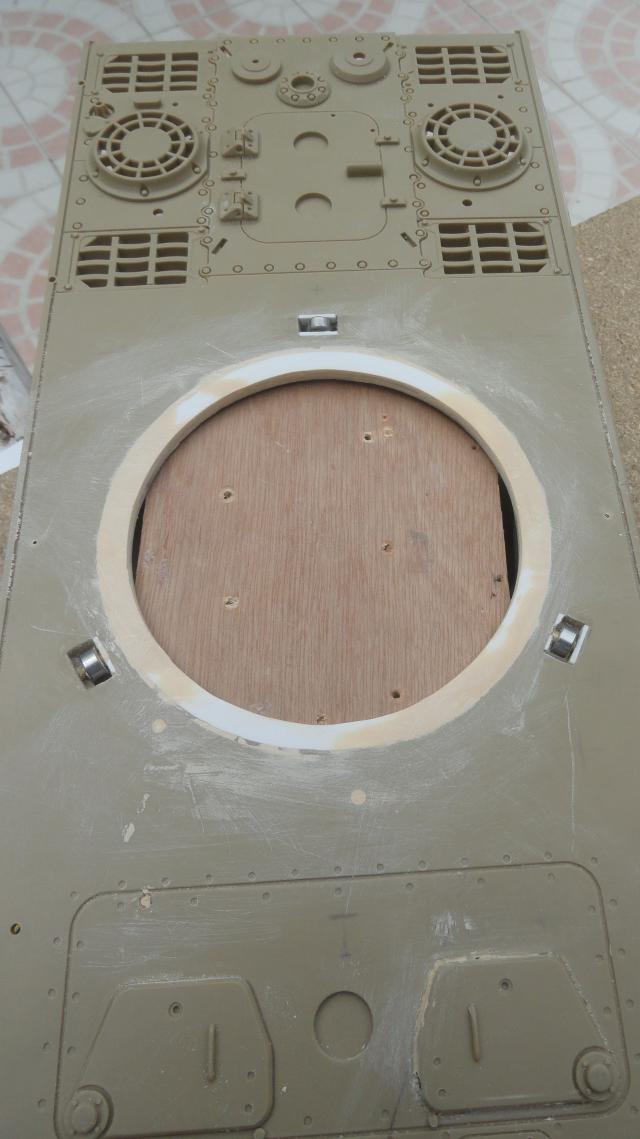

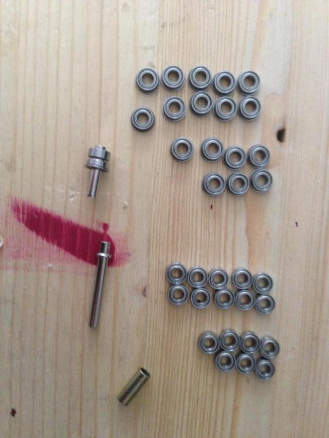

:D Hello, effectively replaced the bronze rings with bearings, on the entire running gear (purchase on eBay) plus the dimensions in mind? also for the turret rotation, with adaptation, replacing plastic rollers, photos attached, for many modifications :thumbup:
roller bearings

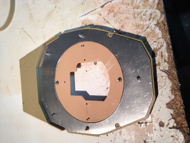

1.5 mm aluminum turret vase reinforcement

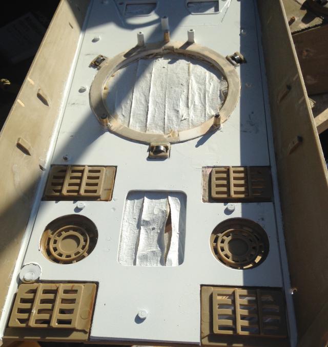

Upper chassis reinforcement

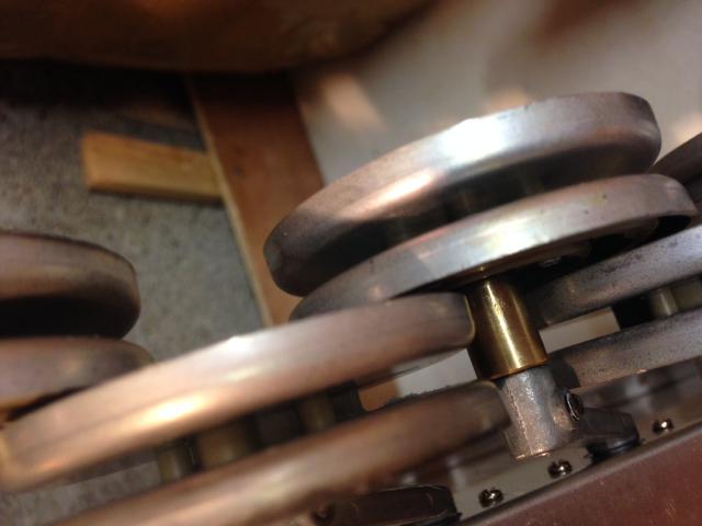

Suite:

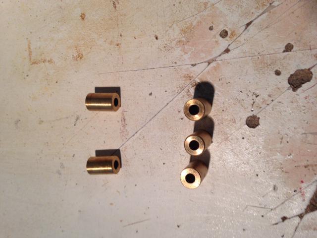

A friend also made me brass parts to reinforce the axles.
There were other modifications, because originally a model with a single engine,

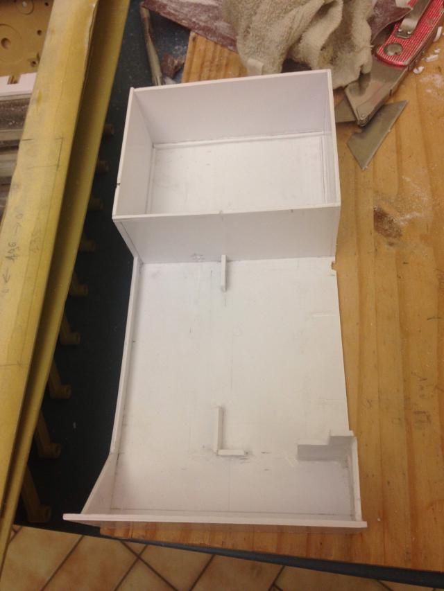

:D For bearings ? plus the reference ? just measure the dimensions of the axles and housings, and see on eBay
Here, if I can help? It's great, as a gift some additional photos, interior design
