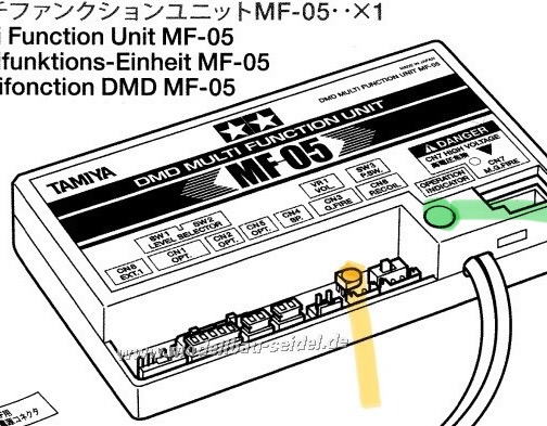

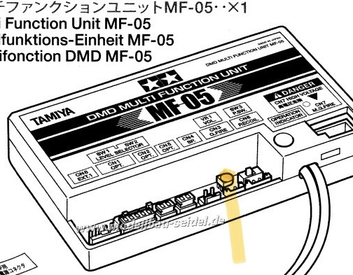

:headbang: The white rotary sound button is located to the right of the connectors just before the small slider, the same regardless of the type of MF

Thanks for the information It will come in very handy when I get the Tx to bind with the RX haha. I currently have a MF-05 (I think) as it is covered by the TO-3. The 05 has a flashing green LED and the TO-3 Drive indicators are flashing both green both yellow and orange or alternating. The switch closest to the MF-05 is too the left.
Do you have any ideas on what I am doing wrong? Thanks Carl.

Green LED flashing? It's the LED of the cannon flash
volume adjustment
