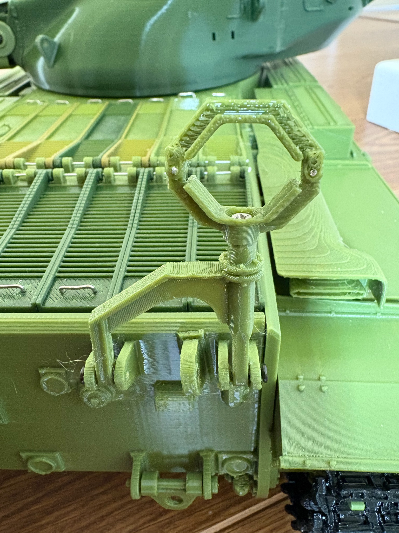

British Cold War Conquerer Tank. Gun Clamp.
The articulated 3D printed gun clamp is really good and should clean-up nicely.
- Easy to make fully working - it almost is !
- 3E4E68DB-1B0C-4C98-AEC3-6FE8105242D4.jpeg (862.85 KiB) Viewed 1830 times
