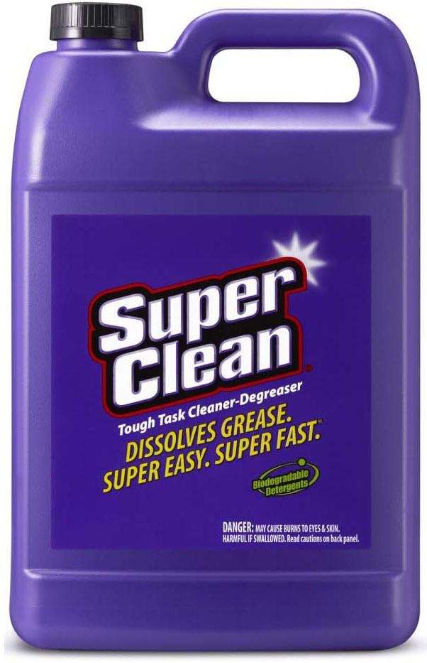

I do have some experience with paint removal from plastic. The first is Super Clean. I have even soaked plastic in this stuff full strength. Obviously, one needs to remove all the electronics, etc., first, which you clearly know to do.
Super Clean.jpg (98.93 KiB) Viewed 1805 times

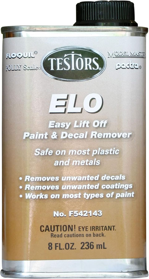

The second is Easy Lift Off. I am a tad more wary of this stuff, so I have never used it on anything but a decal on an isolated surface, followed by super-fine sanding. It is, however, a Testor's product specifically designed for modelers.
I would read all the instructions and proceed with caution, even testing each on a nearly invisible surface before working more generally.
