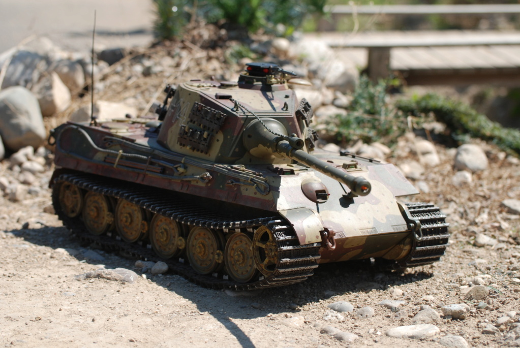

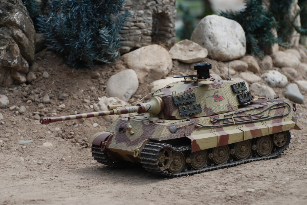

I don’t plan on battling as of now but it’s good to now that your gear boxes don’t have any issues which is good tho. Did you also keep the wheels stock or you had to change them too? And in terms of the tracks do you just put them on or do you have to remove a track or two?Panzermechaniker wrote: ↑Mon Oct 07, 2024 1:08 am I have 2 Tamiya KT both running Kenny Kong metal tracks and Henntec tensioner systems. They are fantastic. That being said they are no good for jack rabbiting IR battles. You have to almost drive them like a real tank but i have had no issues running them on the Tamiya gearboxes over 3 years even with the tracks weighing 1.1kg each
Thank you

Drive sprockets , road wheels and idler are all stock Tamiya. As others have said the Tamiya road wheels are mostly metal. I think I removed 1 track link on each side although it's been a while since I did these KTs. The Henntec works flawlessly on the Tamiya KT. I suppose if you don't really run the tanks hard you could stay stock but everybody in the club told me to ditch the original Tamiya tracks and the idlers. Considering i have never had an issue with any of my Tamiya tracks (I think on their WW2 tanks other than the KT they are the best for outdoor running) I was surprised at how poor their KT ones are. You shouldn't have any issue with the gearboxes. I know there are upgrades to beef up the gearbox shaft housings but our field is about as big a torture test that there is and knock on wood i have had no issues
