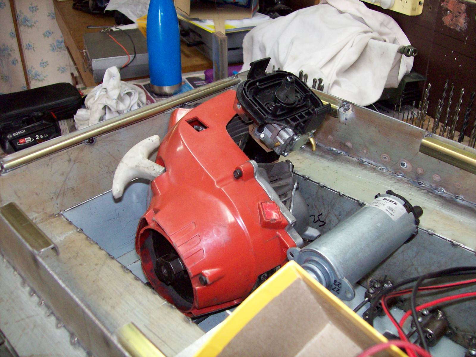

Hobbyman
Posts: 14
Joined: Tue Jul 09, 2024 12:28 am
Re: Scratch Built Tiger 1 1/8 scale
Post by Hobbyman »
Have striped /welded and ground the hull and painted It .Made new rotary switches using retract sw for forward and reverse...rudder for left/right and throttle for engine speed . Test drive just before todays photos , rec battery voltage dropped just a as I opened the throttle and the beast took off through the flowers and tried to climb the ivy fence before I caught up to It. Heaps of power at just off idle speed .Thoughts ....maybe one generator might be sufficient ......changing carb to a twin needle chainsaw carb and adding flywheel to crankshaft , missing some weight here as not using the clutch....rough idling and unreliable with only one adj for fuel .
