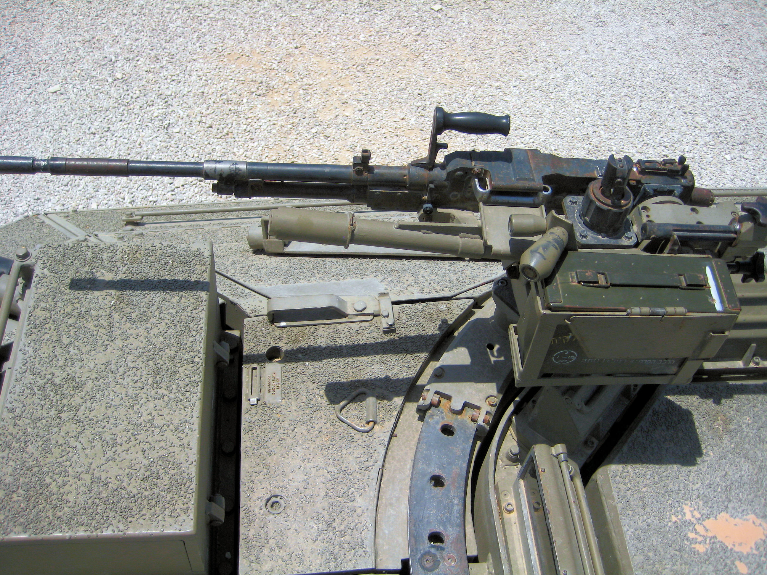

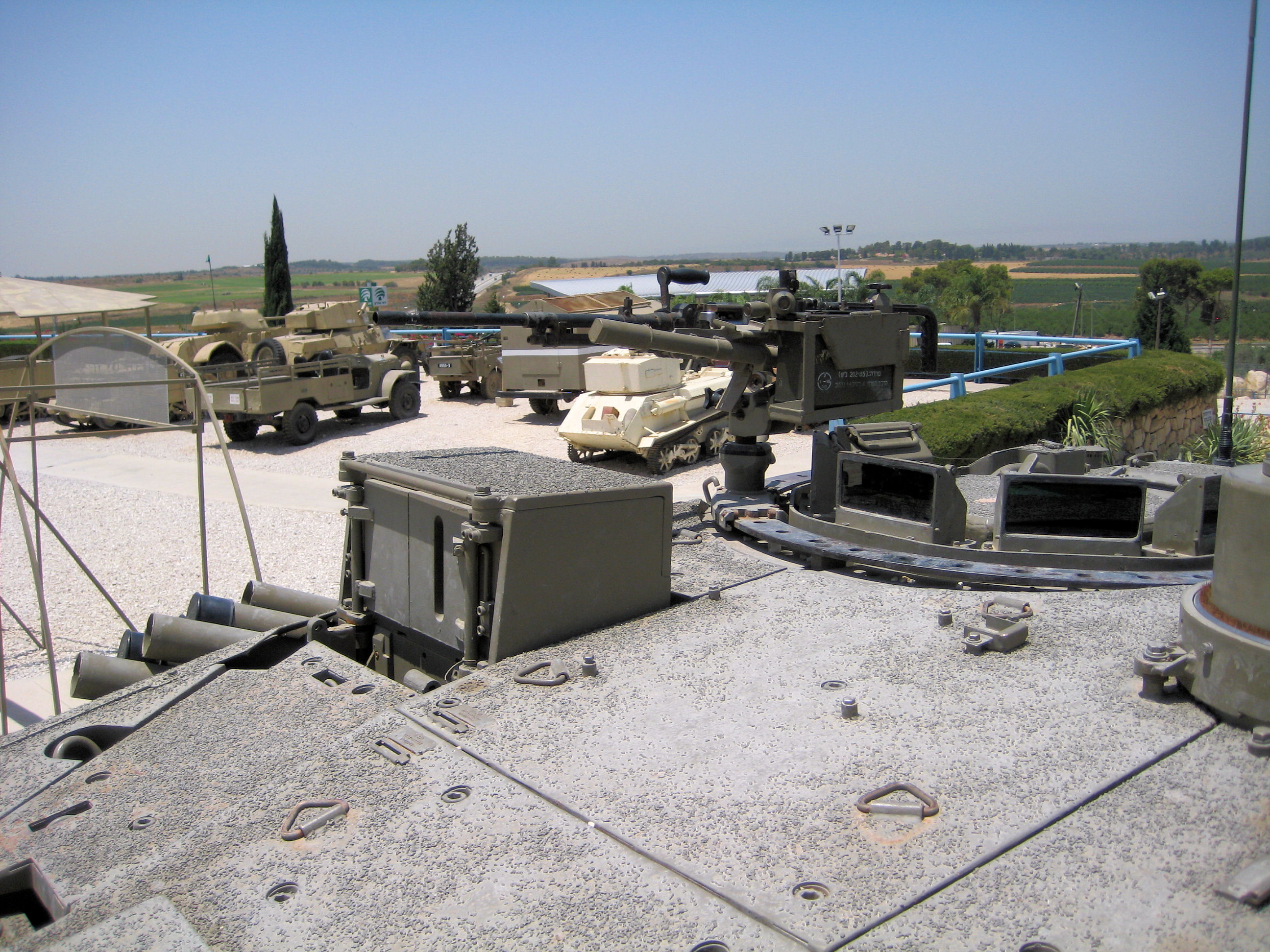

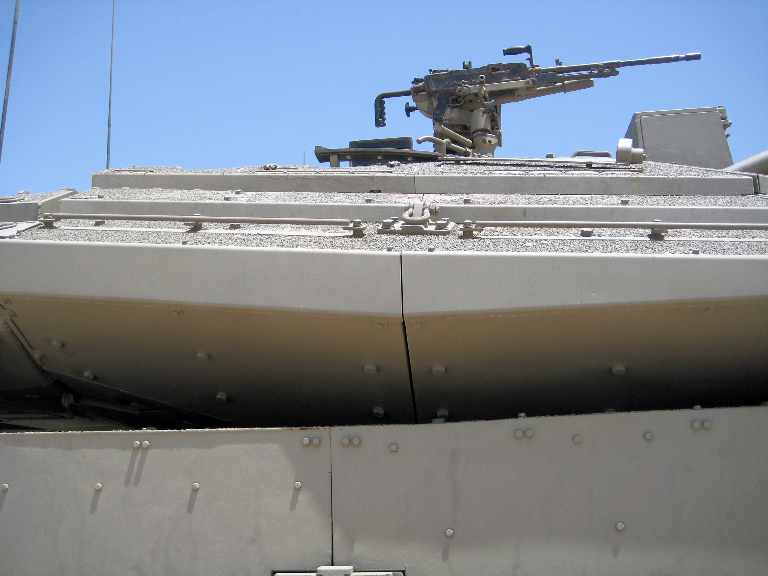

Pavel
Posts: 506
Location: Москва Россия
Re: Heng Long Merkava IV mods
Post by Pavel »
I couldn't resist and bought myself a chariot...
Well, the process of finishing is still ongoing and I'll soon post it as a separate topic so as not to interfere here.
But one detail bothers me....
The inhabitants of the Celestial Empire place the machine gun to the left of the device for its control, and in the original it is installed on the RIGHT.
Of course, I trust the photo of the original more...
