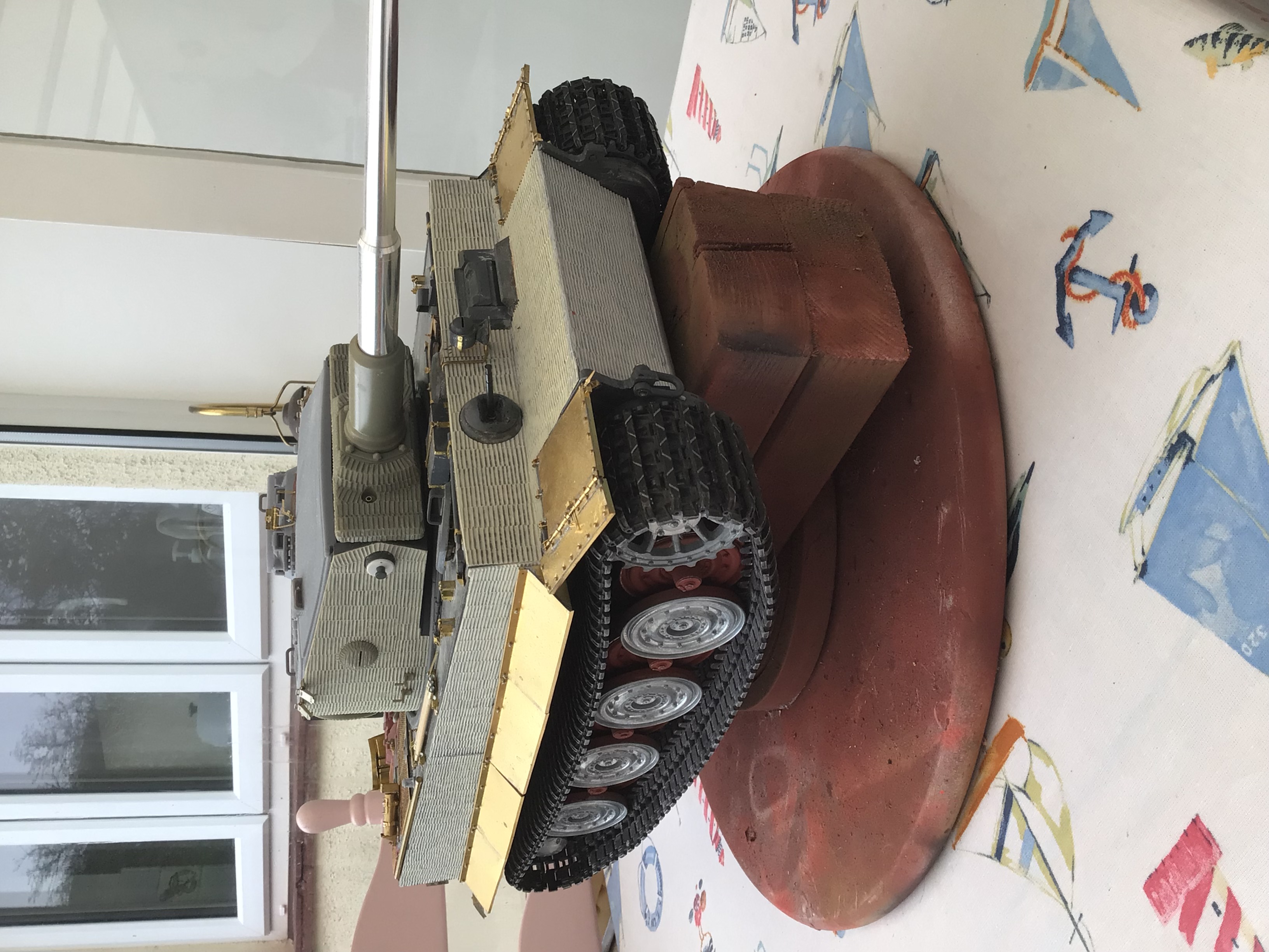

About ready for the paint Shop. The painting will have to wait for drier warmer days. I must admit I hate painting tanks. I have 6 or 7 tanks all waiting for the paint shop, next summer I must get them painted. I thought you all might enjoy a few photos of the very nearly finished conversion.

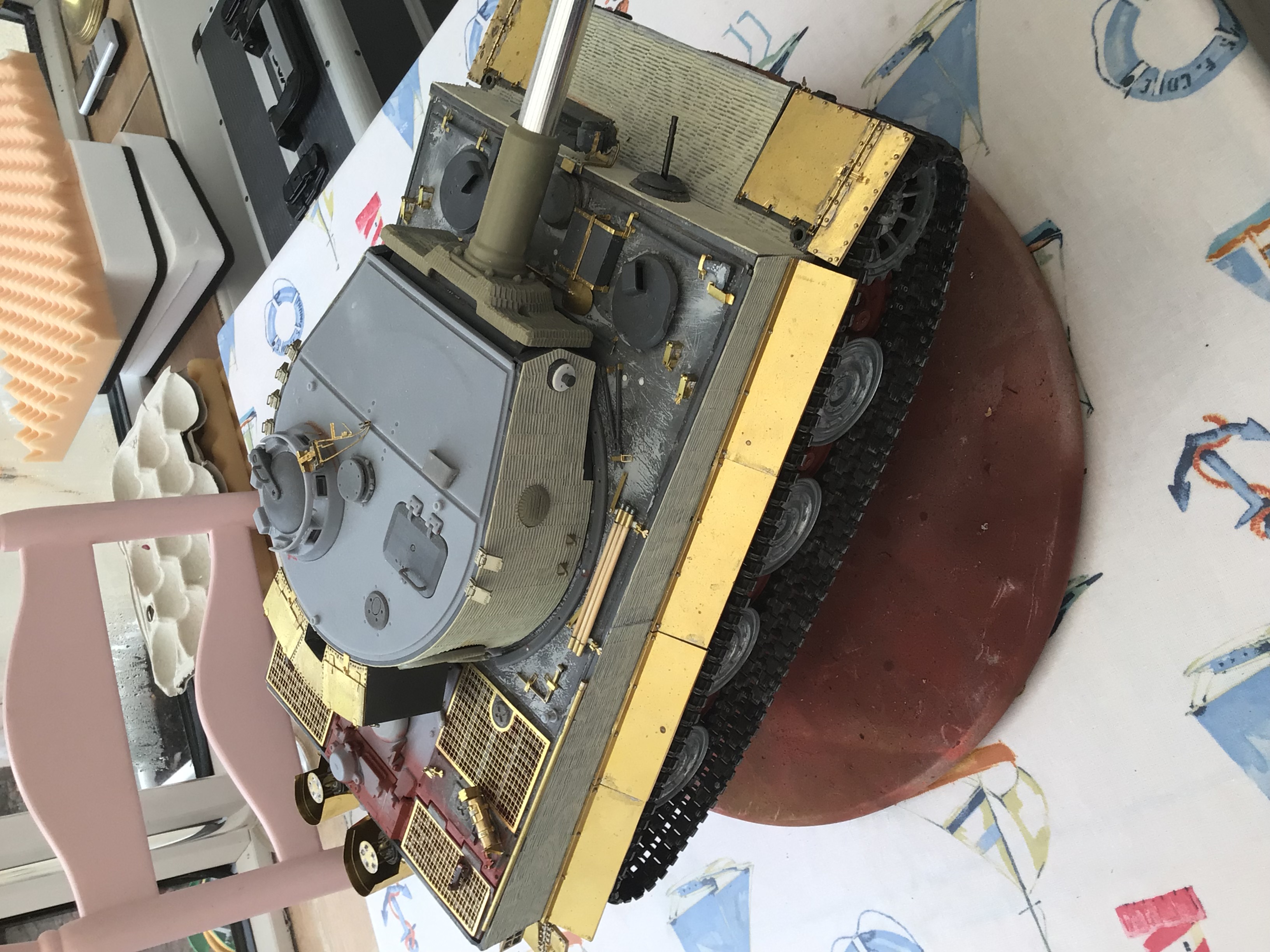

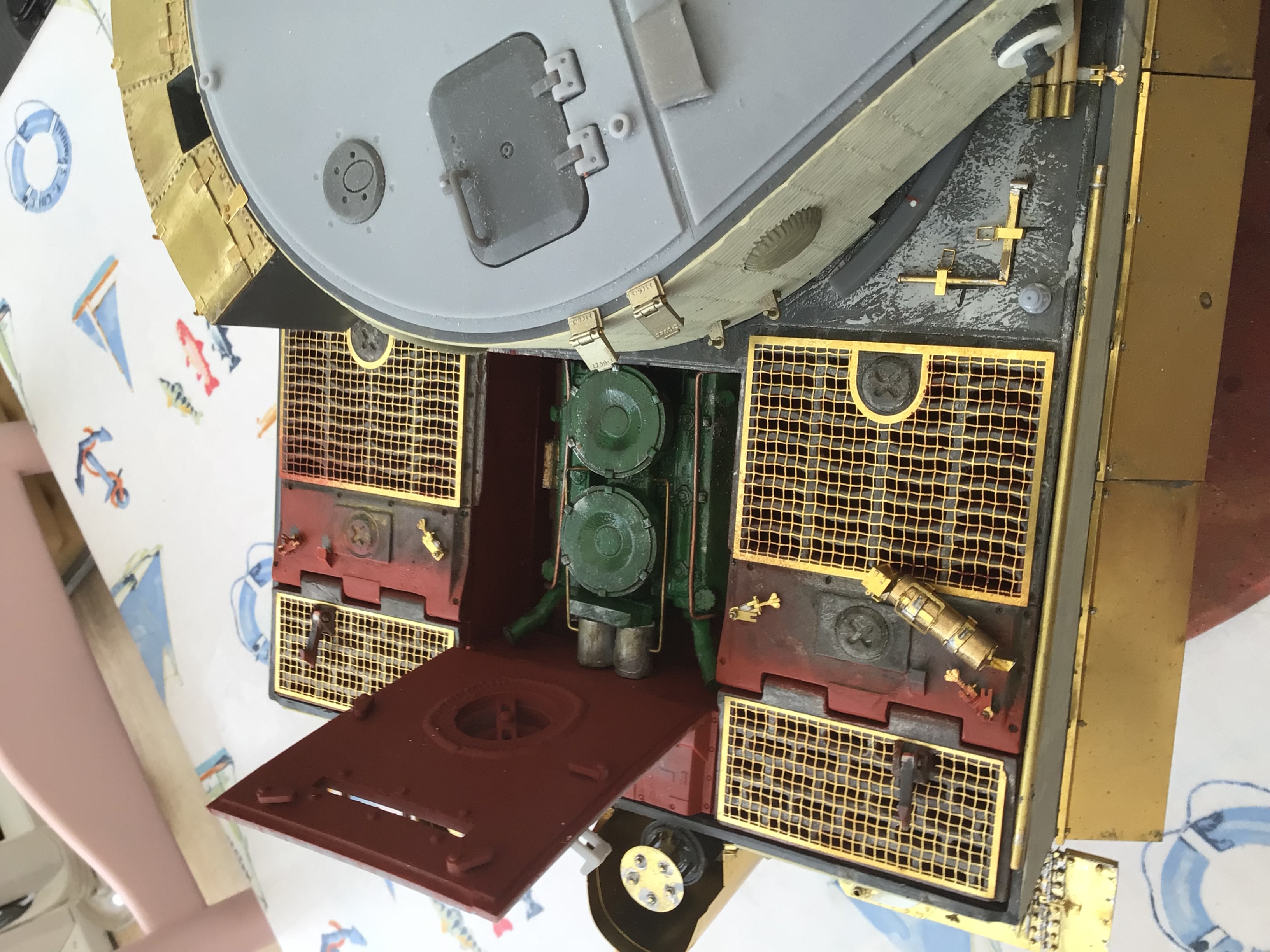

More Photos
