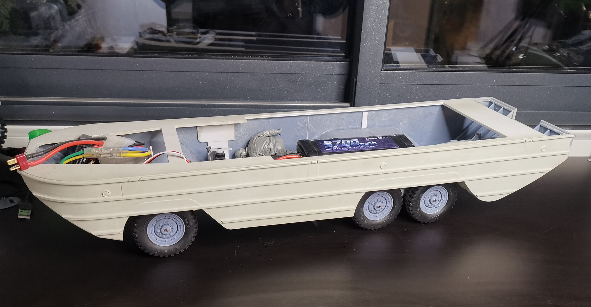

Some news about the DUKW !
The hull is done is done but with no details. I still have to do all the superstructures, cargo bay etc.
Im still testing various motors but it runs. It doesnt do sharp turns... it's so long !
I had to design my own axle casings and I fitted the shaft and gears from WPL axles. All the axles available off the shelf were too wide. I may redo the front one.
The suspensions work pretty well, I just copied the original, it's as bouncy as the real one on rough terrain ! :)
This thing is huge in comparison to the small M8 I'm also working on !
The hull is made of three 3D printed parts. It was not easy to get virtually seamless assembly. Lot of sanding was required !
It's super heavy but it float very well, and I guess I'll have to add more weight to it when finished.

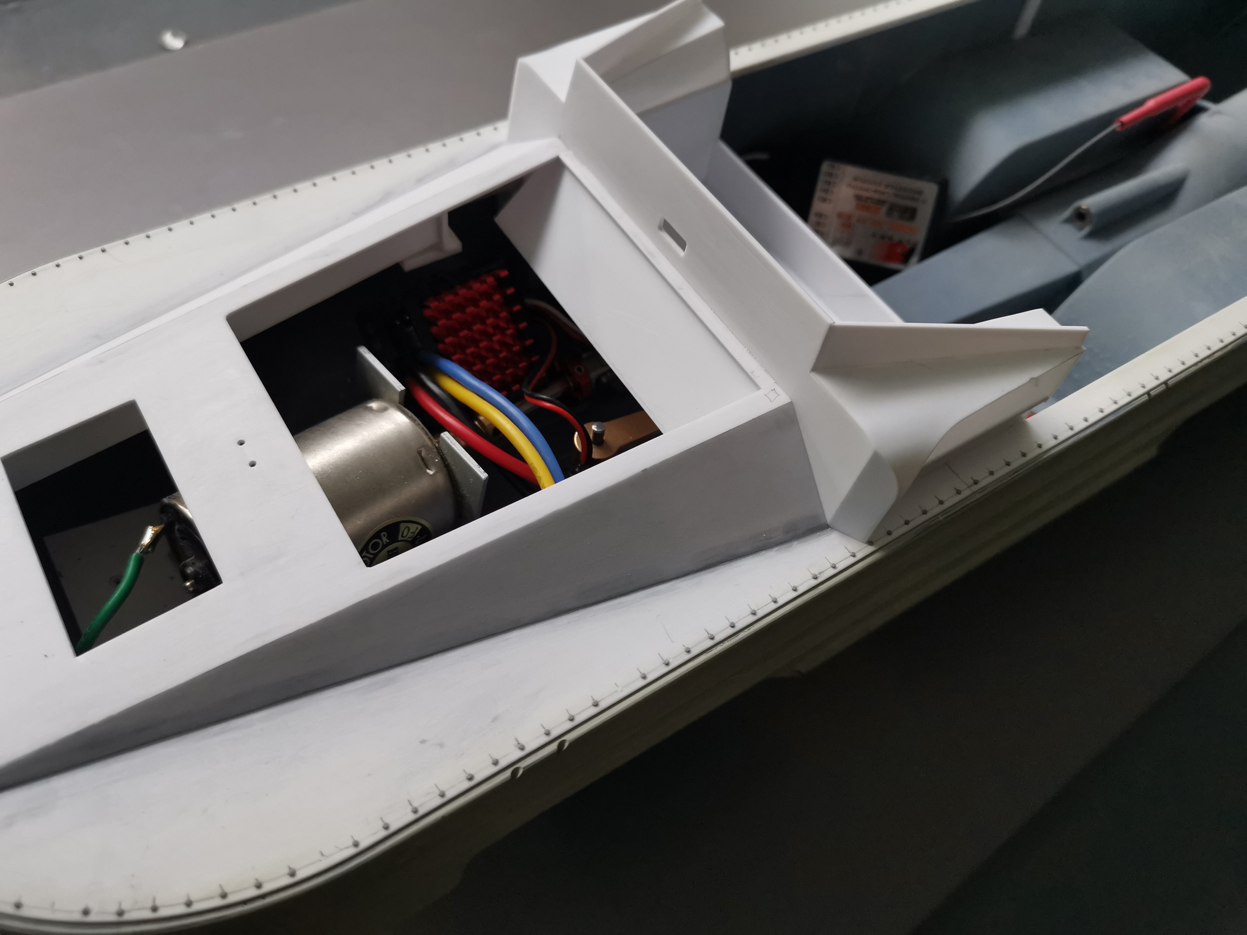

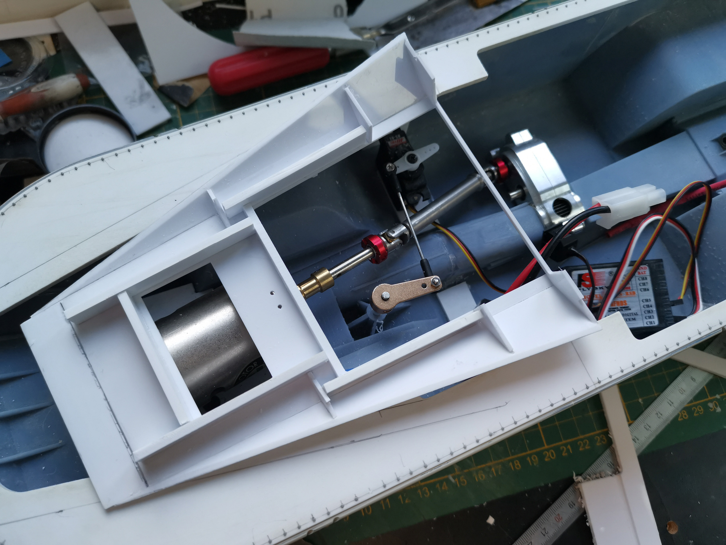

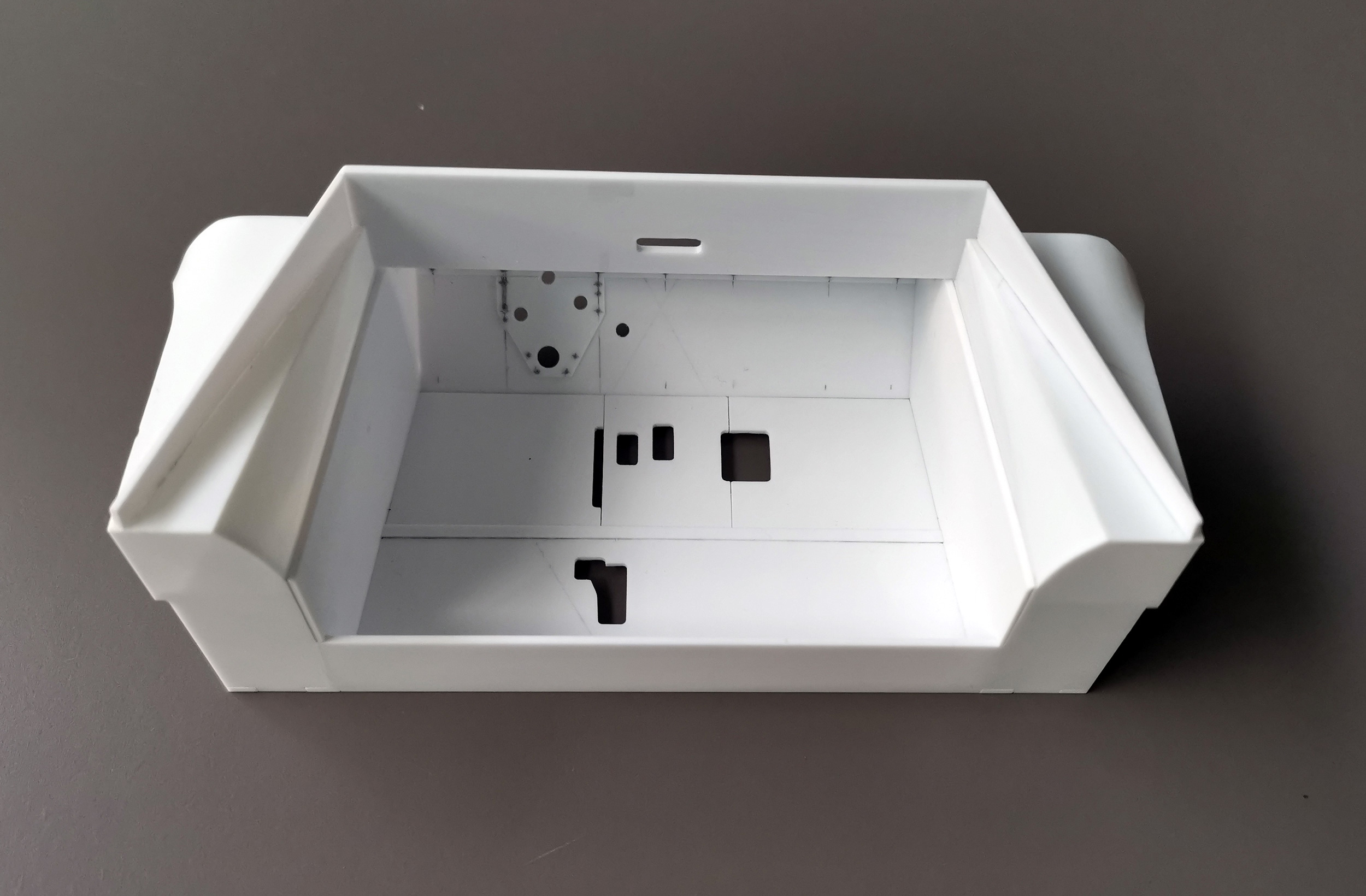

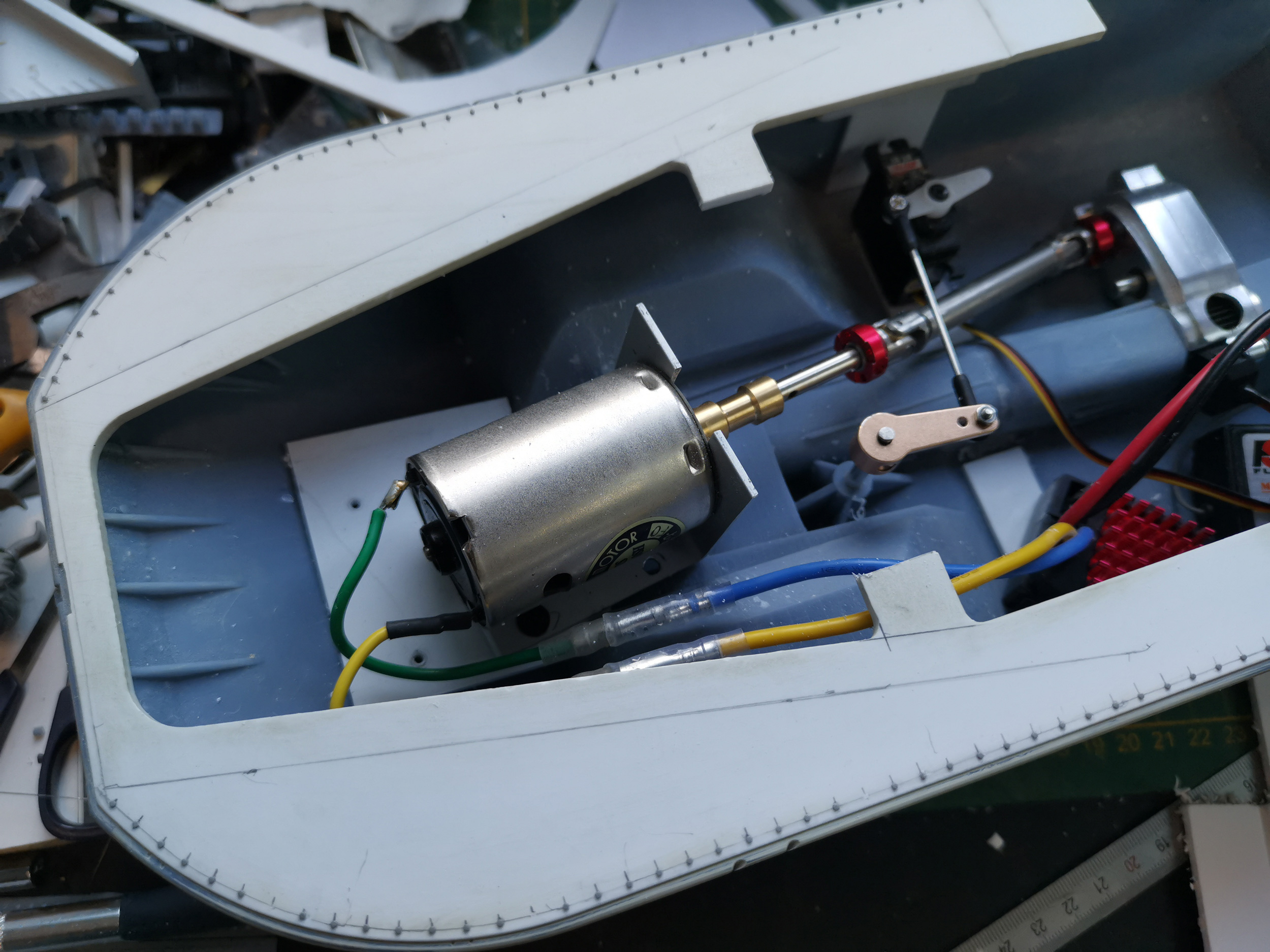

Finally some progress on it...
Winter is coming, trying to get some old stuff finished...

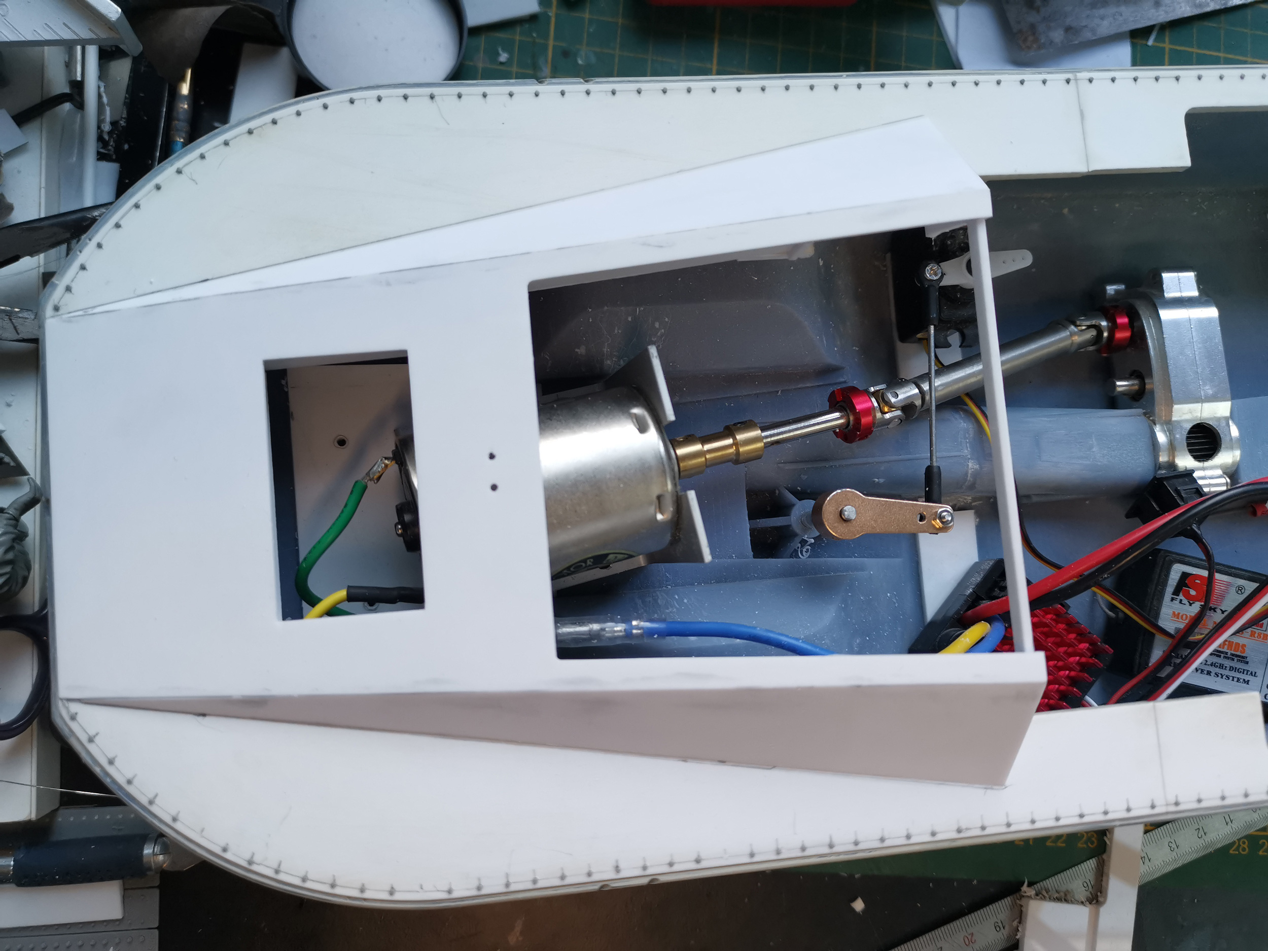

The motor is now screwed to the hull :

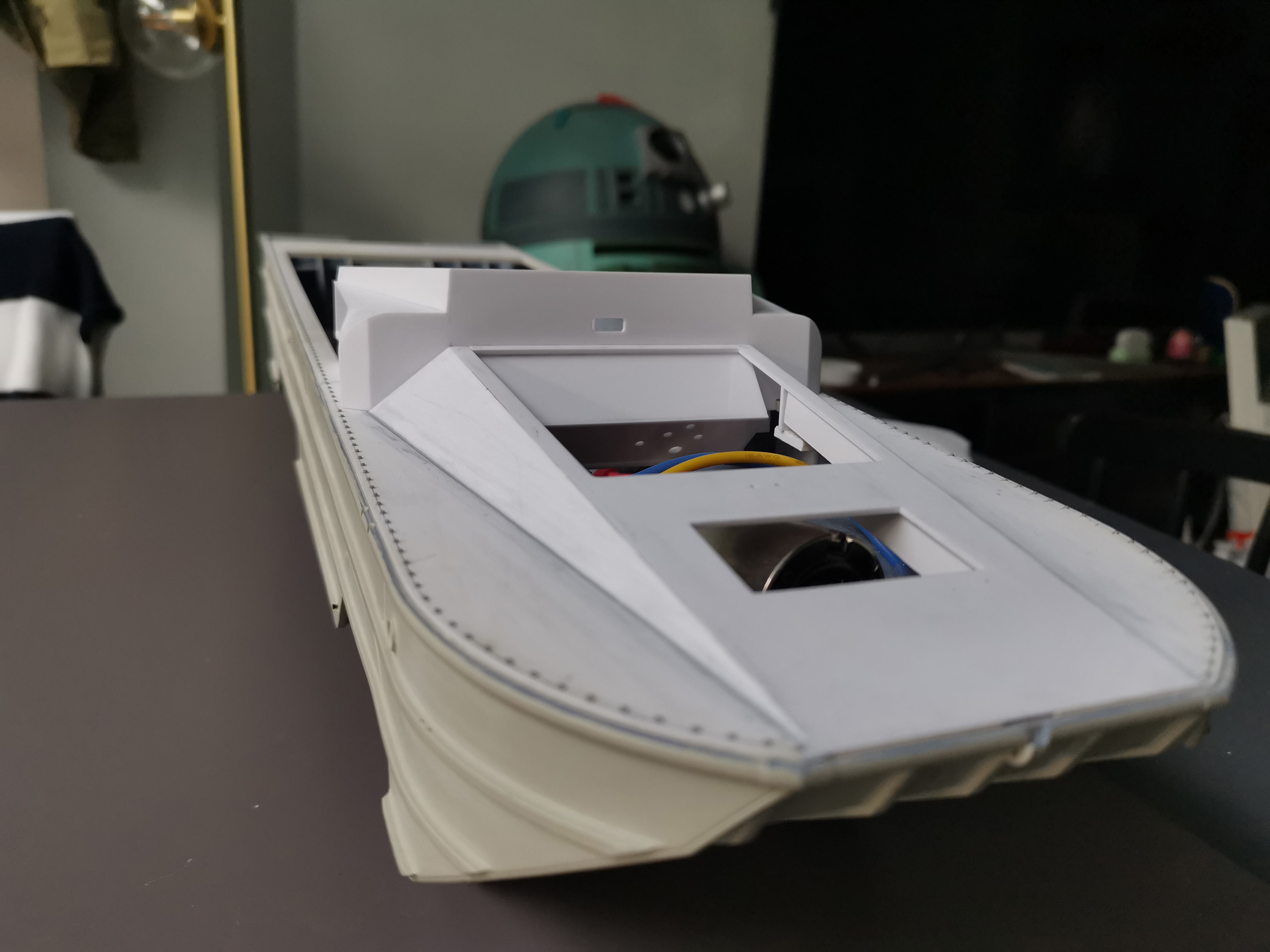

And I made the hood, it is permanently glued but I still have access to the motor if needed.

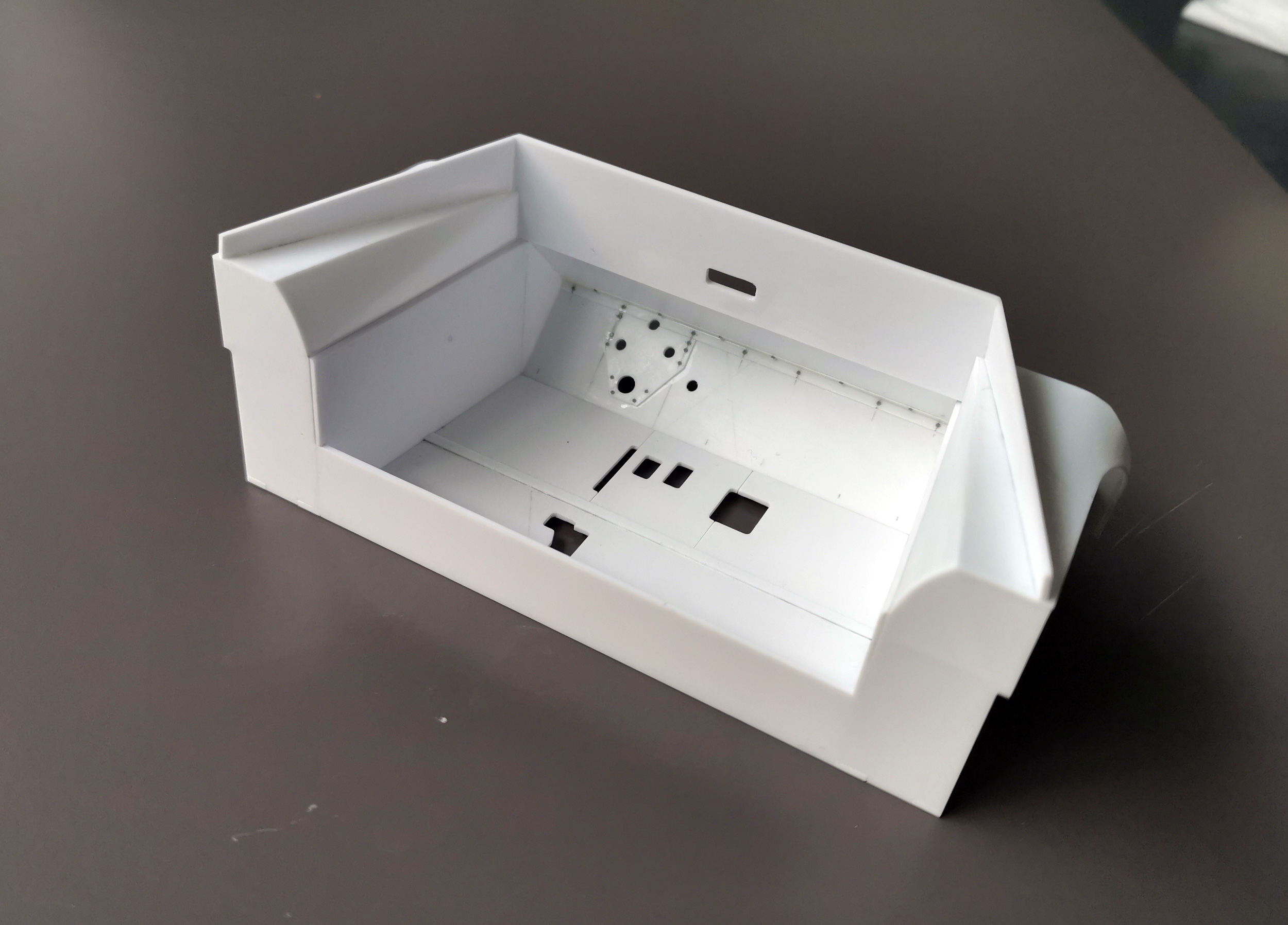

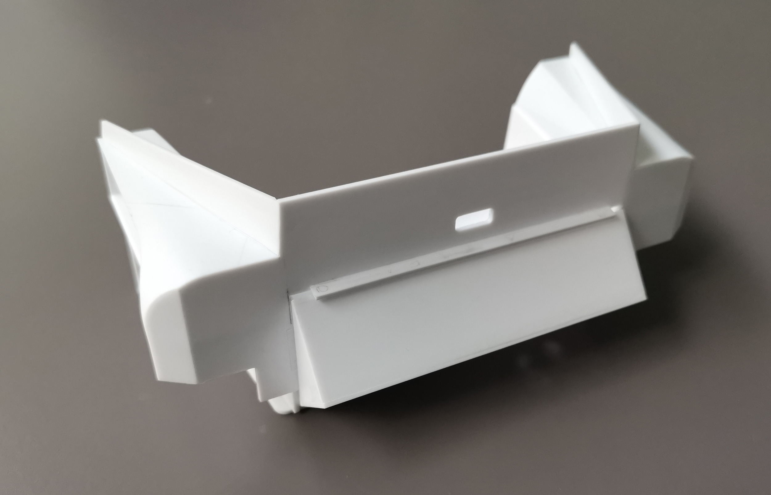

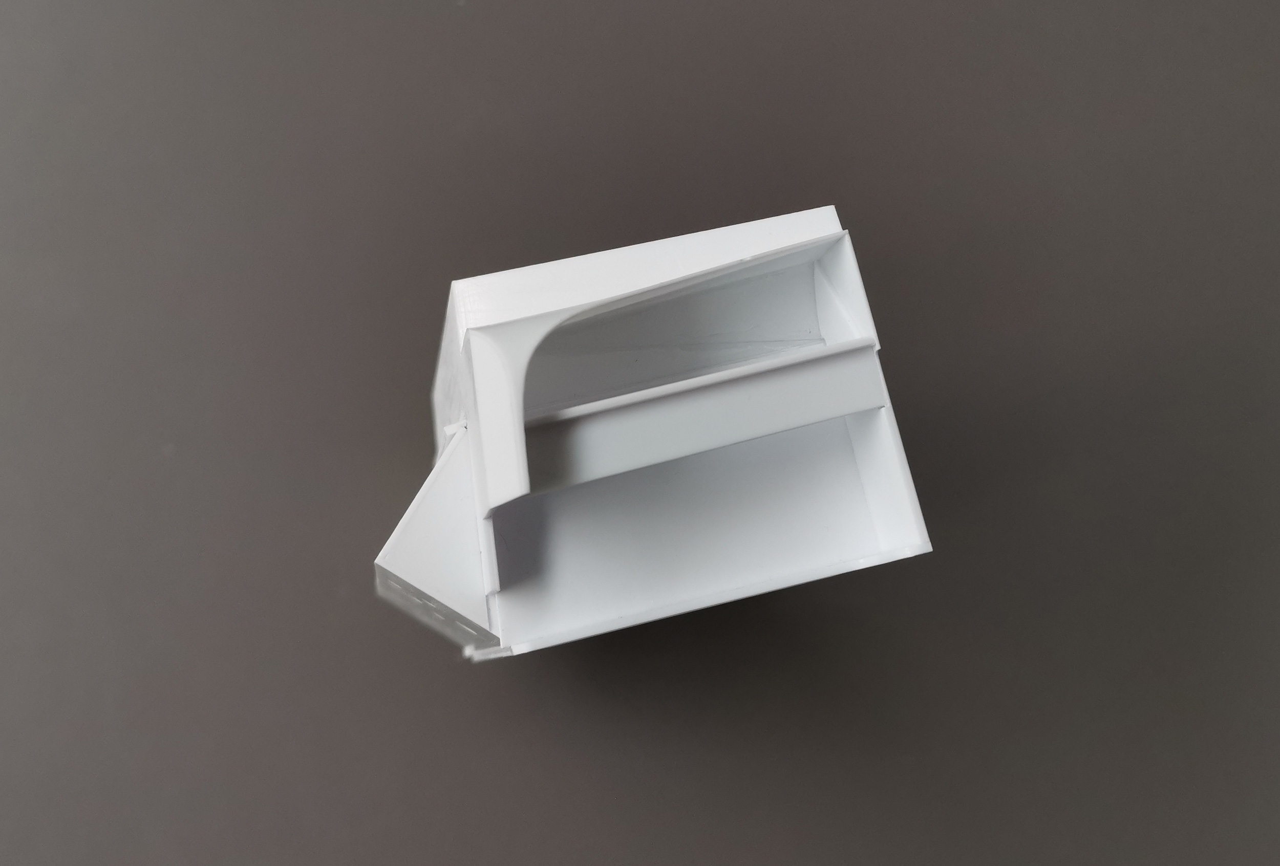

Then I built the basic shape of the cockpit (?), well I guess it's not the right word but you get what I mean !
Fortunatly, I got a good fit ! Cockpit can be removed to get access to the electronic.
