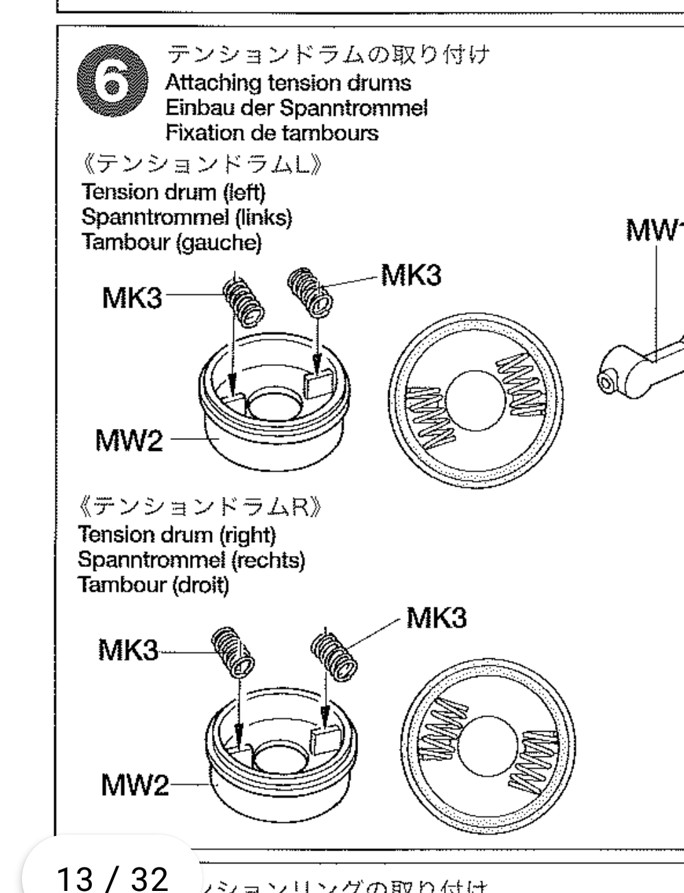

I've looked at my KT build manual and the only thing I can think is you might not have pre tensioned the springs for the idler on the right side before tightening the screw on the MK9 collar. I hate to keep banging the drum but just order a Henntec. You are going to eventually end up going that route anyway. You can order directly from Guido at https://www.henntec.de/produkte/kettens ... ya-panzer/ or through RCTank.de

Eventually I will get one but for the now what do you mean I didn’t pretension the springs? Sorry English isn’t my native language so sometimes don’t understand everything

Son of a gun-ner wrote: Thu Jun 27, 2024 4:23 pm If your idler is still sloppy/floppy/wobbly, tensioning the tracks won't help. We need to know why the idler isn't firmly fixed in place to stop it from being unnaturally pulled forward.
The Thing with the aftermarket idler tensioner, it keeps the idlers from flopping about like a dead Norwegian blue.
Yes it’s floppy and wobbly for some reason

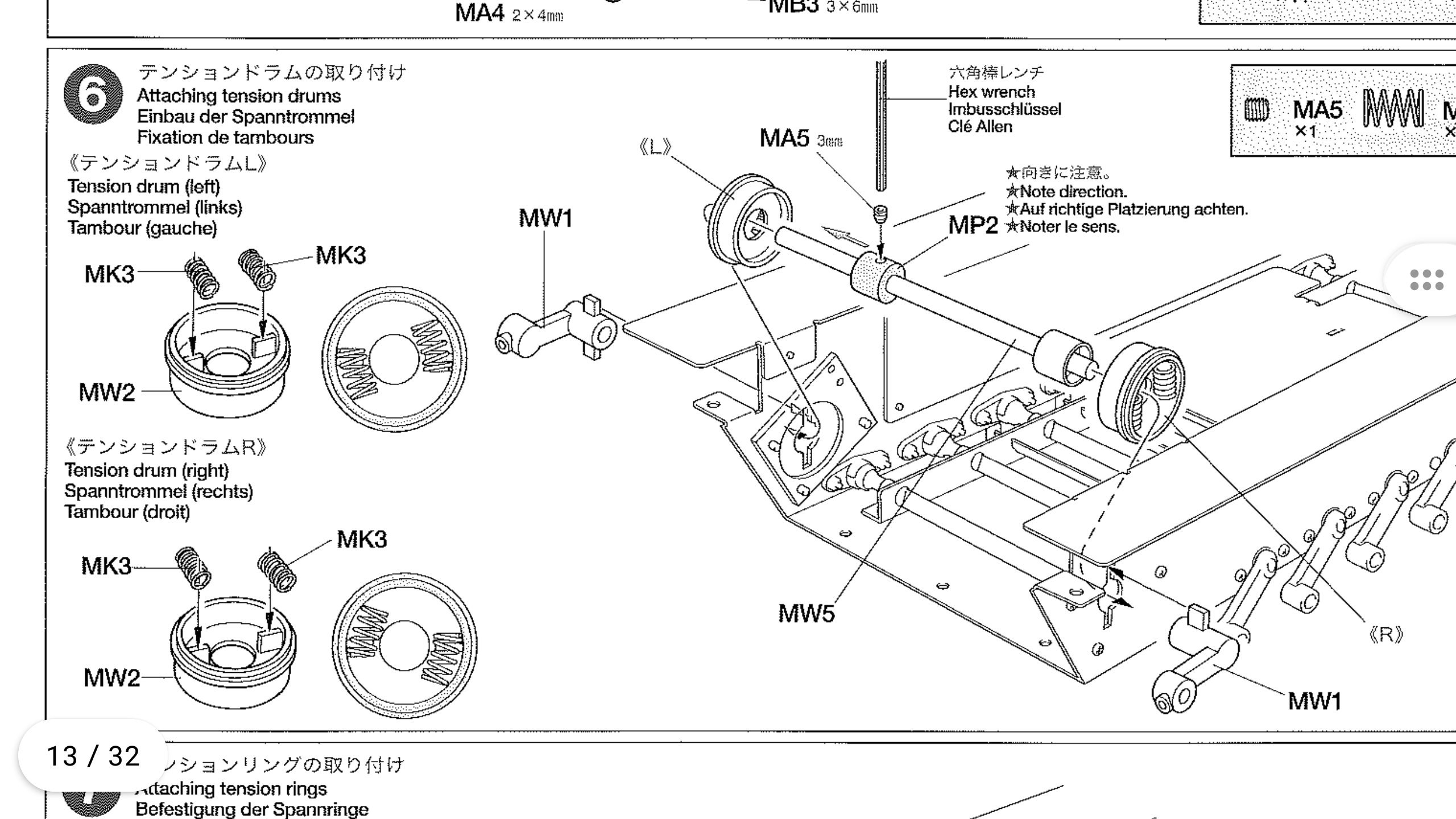

Try re-doing Step 8 in the manual again. If that doesn't work you might have to try re-doing Step 6,7 and 8 again completely. It's not that bad but you will have to unscrew your back plate and speaker and start over again. A spring might have popped out. It's a finicky poorly thought out system

Michael151722 wrote: Thu Jun 27, 2024 4:34 pm
Panzermechaniker wrote: Thu Jun 27, 2024 4:31 pm I've looked at my KT build manual and the only thing I can think is you might not have pre tensioned the springs for the idler on the right side before tightening the screw on the MK9 collar.
I believe he means making sure these springs are correct, and handed like the pictures.
Posts: 7610
Re: 1/16 Tamiya King Tiger Road Wheels won’t spin
I notice the springs are drawn handed on the instructions, yet they all have the same part number, I'm betting this is part of the failing of the system design, that the springs aren't handed like they should be for correct seating within the drums.
