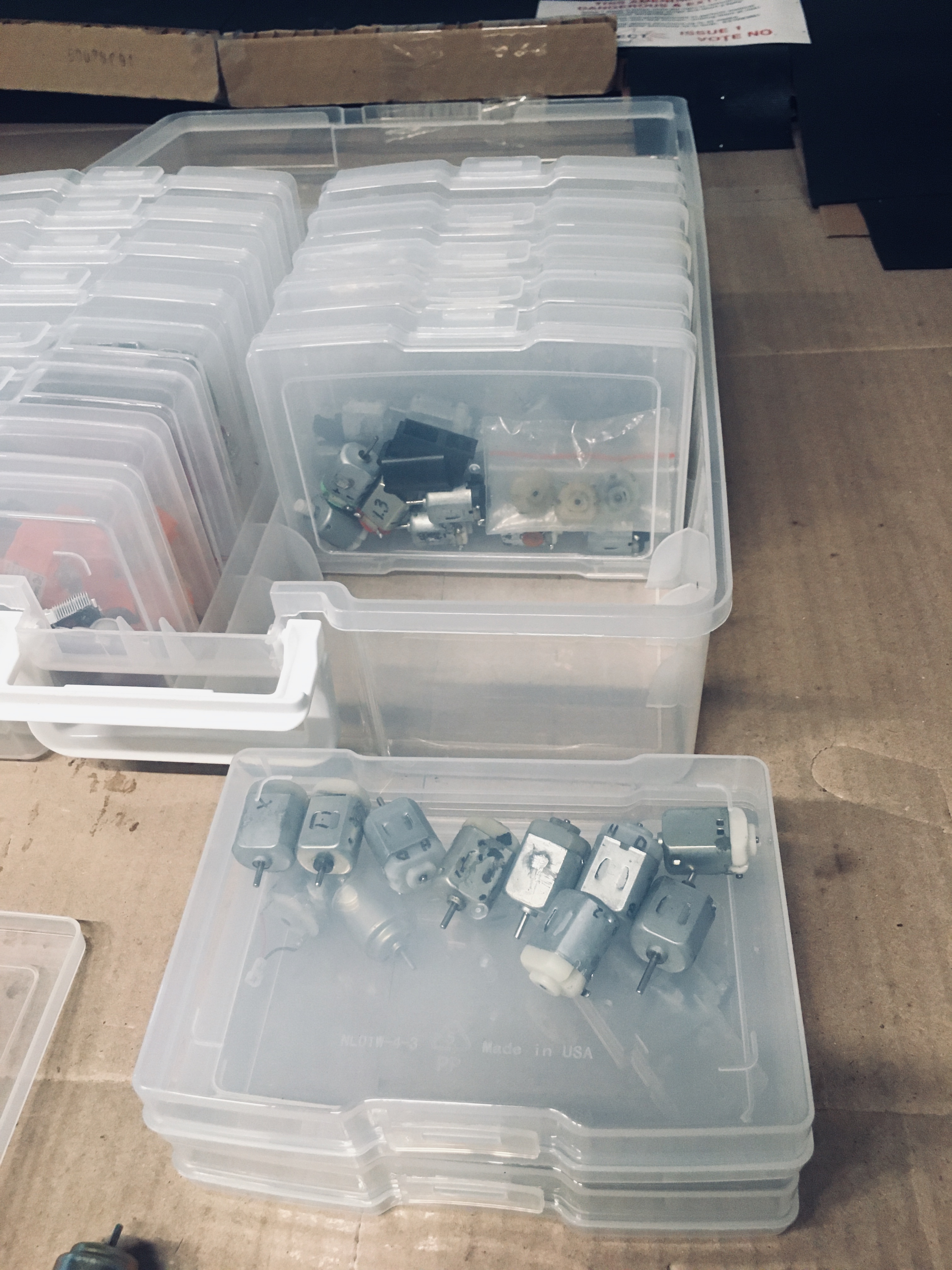

The factory motors use a brush lubricant which dries out due to heat and heavy use then after sitting a while clogs up the brushes and redners the motor inoperative. Iis not that hard to refurbish them back to new condition. I may do a thread on this process as sooner or later in needs done. The small mabushi motors have two tabs that with the proper tool is bent up to release the brush housing. These can be a bit delicate until you get the hang of removing them without damage. The may be black with sludge as will be the 3 amature contacts. A simple wipe down with a piece of toilet paper usually will do the trick. cleaning the brushes if necessary then reassembling the motor with brush housing with the correct timing.
I will add more if requested as I get time.
small brushed Hobby  motor storage.
Different types of brushes shown here. The one on the left is a premium HD version which I tend to use in my best projects. The can be hard to to remove without damage. I have many years practice working on these motors. 90% can be restored to like new operation.
