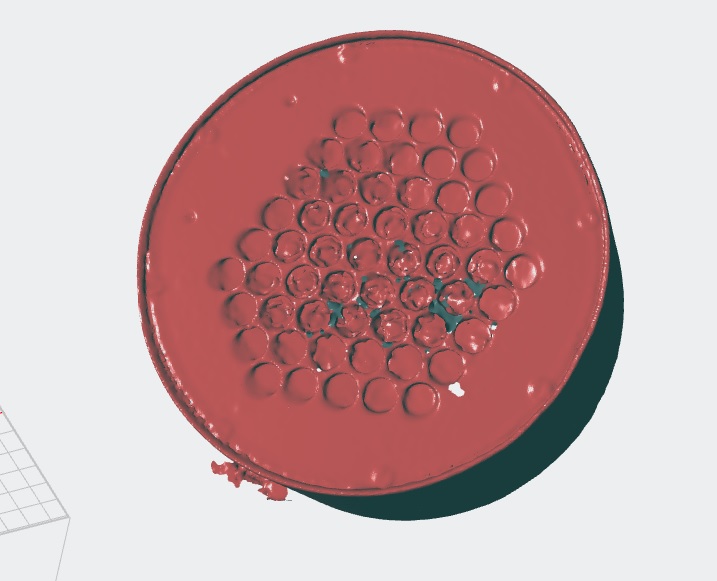

Today i got a 3D scans of some other accessories for the radio.
I will add those to the next units produced.
I dont use the scans directly.I always redraw the whole thing to make it nice.
A small sample of the newest 3D scan:
