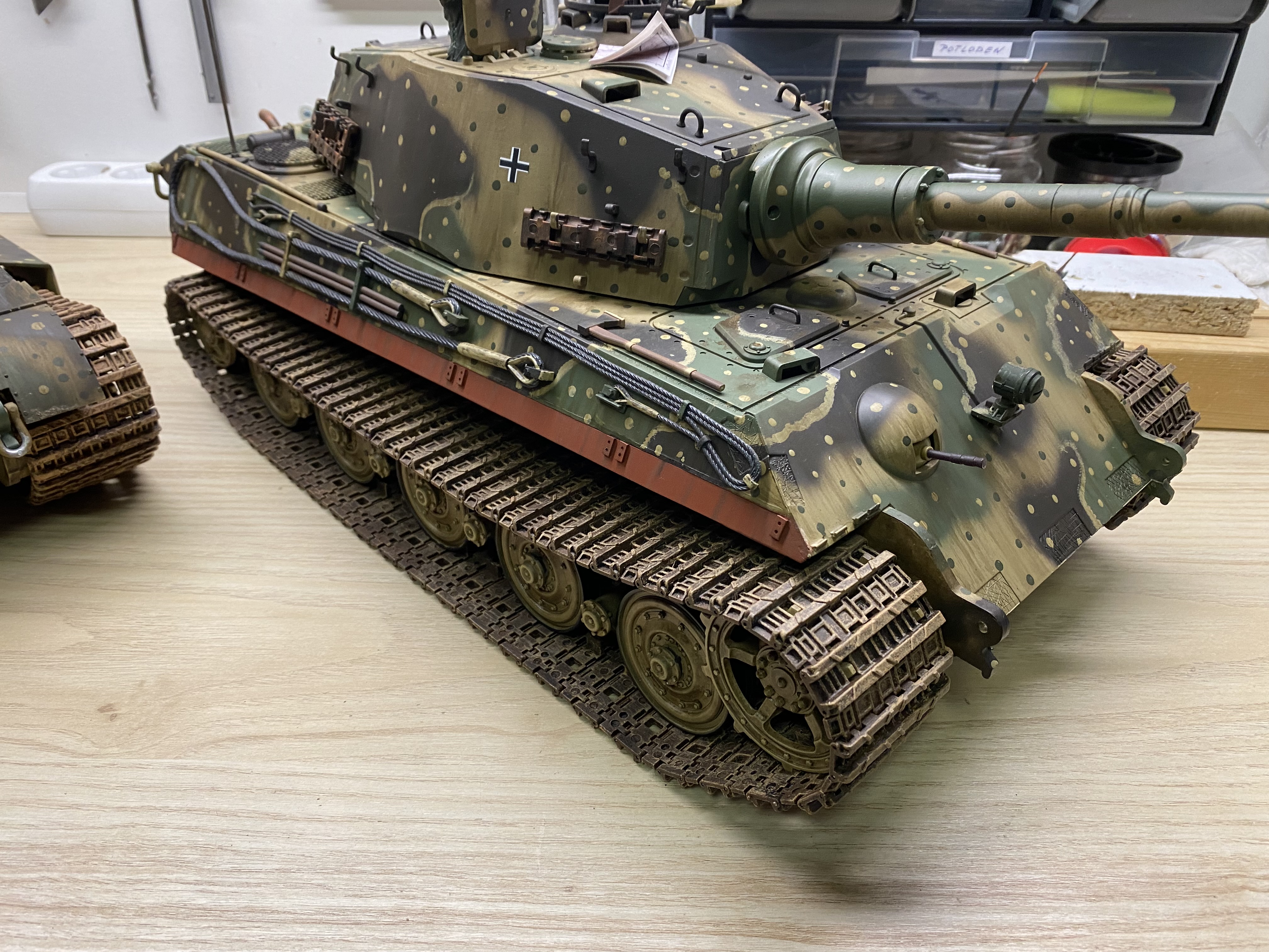

This is my fenderless HL Königstiger
My fenderless HL Königstiger.<br />You did a goid job so far on yours!!
Due to my issues with uploading pics, I had to try to upload with the attachements button, as the moderators advised me.
It worked very well!
I filled up the sides with 2mm polystyrene too.
Before I took the skirts off, I marked the spots were the brackets had been on which the skirts were hanging.
Made the brackets of 1mm thick brass strips in which I drilled 2x 1mm holes in each.
