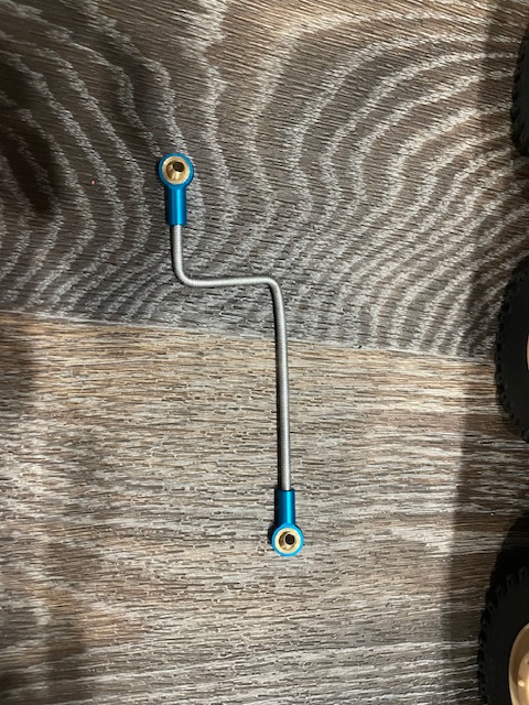

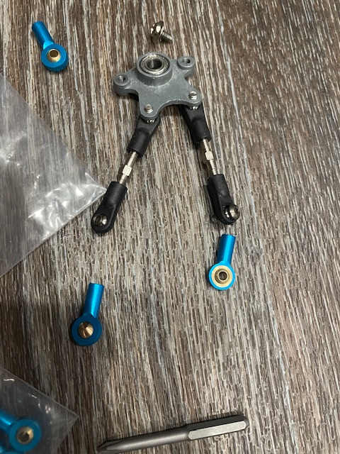

Thanks, Met5. I was thinking of gluing the gears with loctite. But now I'm thinking bushing or washers.
The tie rod lugs have arrived. They are excellent quality, however, I will have to pick up or fabricate new tie rods. The tie rods on the wheels turned out to have different thread directions, and the pivot rods will have to be matched/made to length.
Made some of the axles myself.

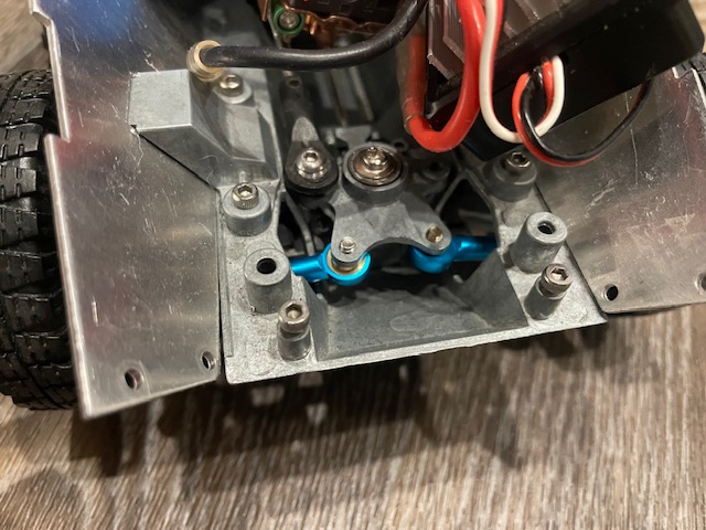

At the moment, the puma turns like this:
https://youtube.com/shorts/eSEOL4VPe18? ... 0T4ORskoex
Note how the servo drive pad wobbles.

pay attention to the steering of the wheels.....

The internal and external wheels travel different circumferences so they cannot have the same steering angle. Metal Origin did not think about it but the modeler can remedy the error.

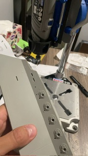

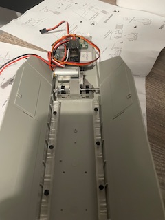

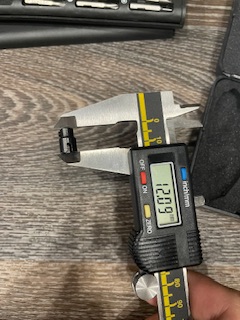

Slowly continuing my projects. Still haven't decided what to do with the bones. On the cougar. I'm thinking of using the upgrade version, pre standing part of the cup.

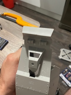

Also, the package from 35rctank arrived and I started another project. I attached some photos. Its a very interesting project, but in my opinion its very fragile and not for outdoor play.

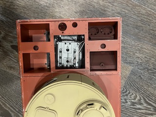

For the tiger, I've made working coolers, and I'm almost done assembling the engine.
I plan to make partitions, but with the size of the engine this may be a problem.
There are some questions with the puma. is it worth cutting the cups and is it possible to buy them in case of failure?
Should i cut this for upgraded kit?

I also started the 35rctank conversion for the 251 and I would agree...probably not going to take a lot of abuse.
