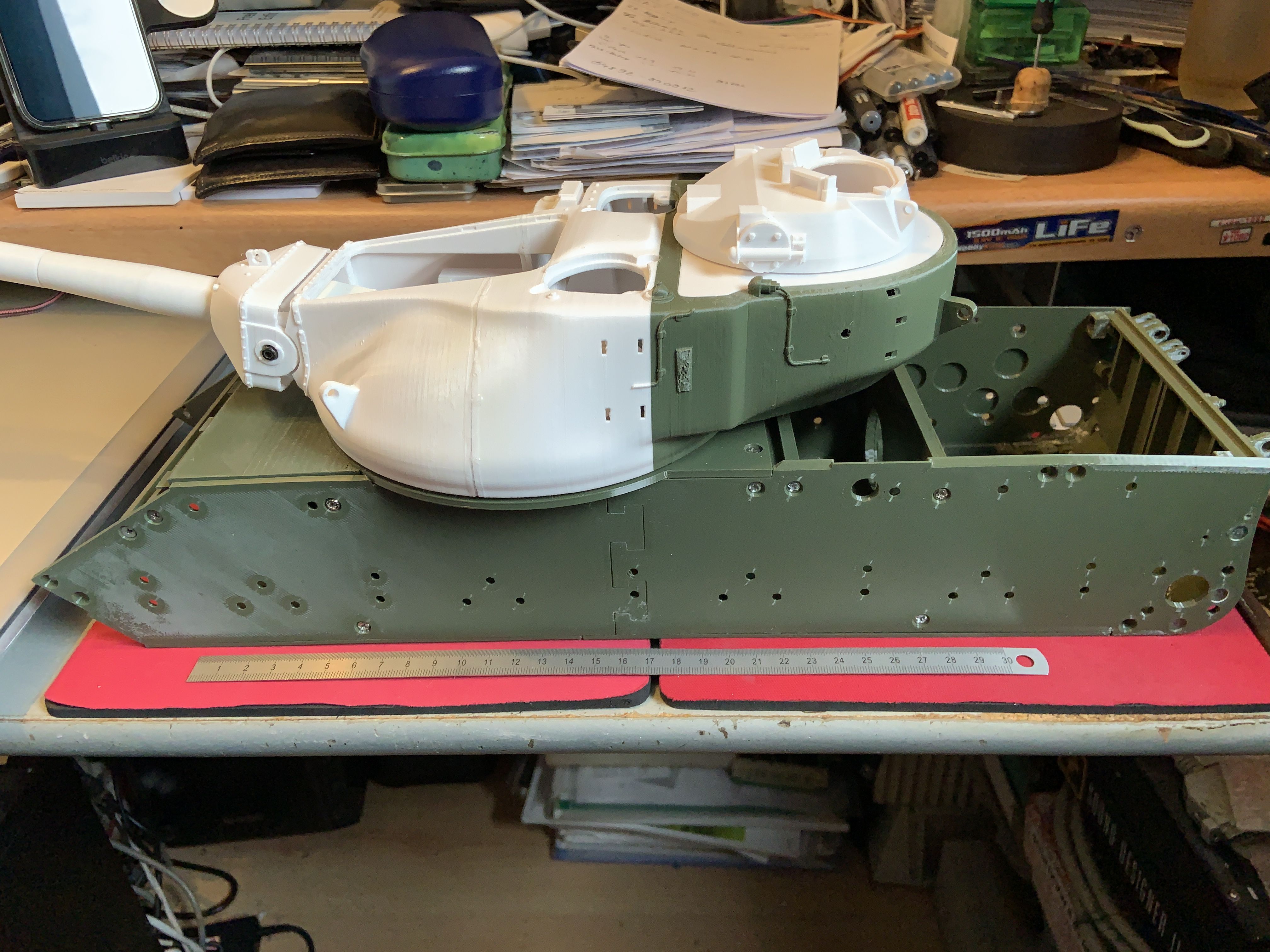

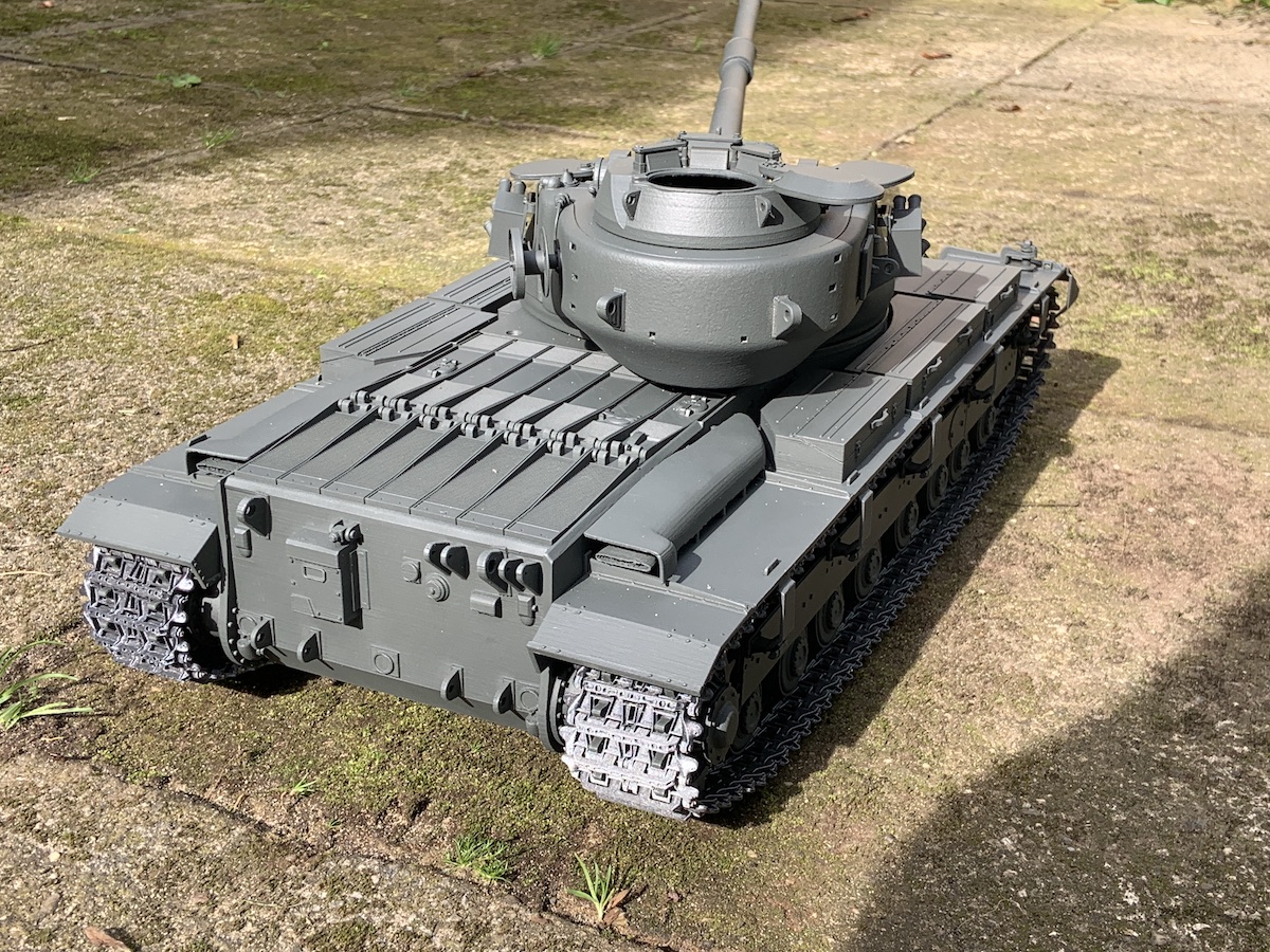

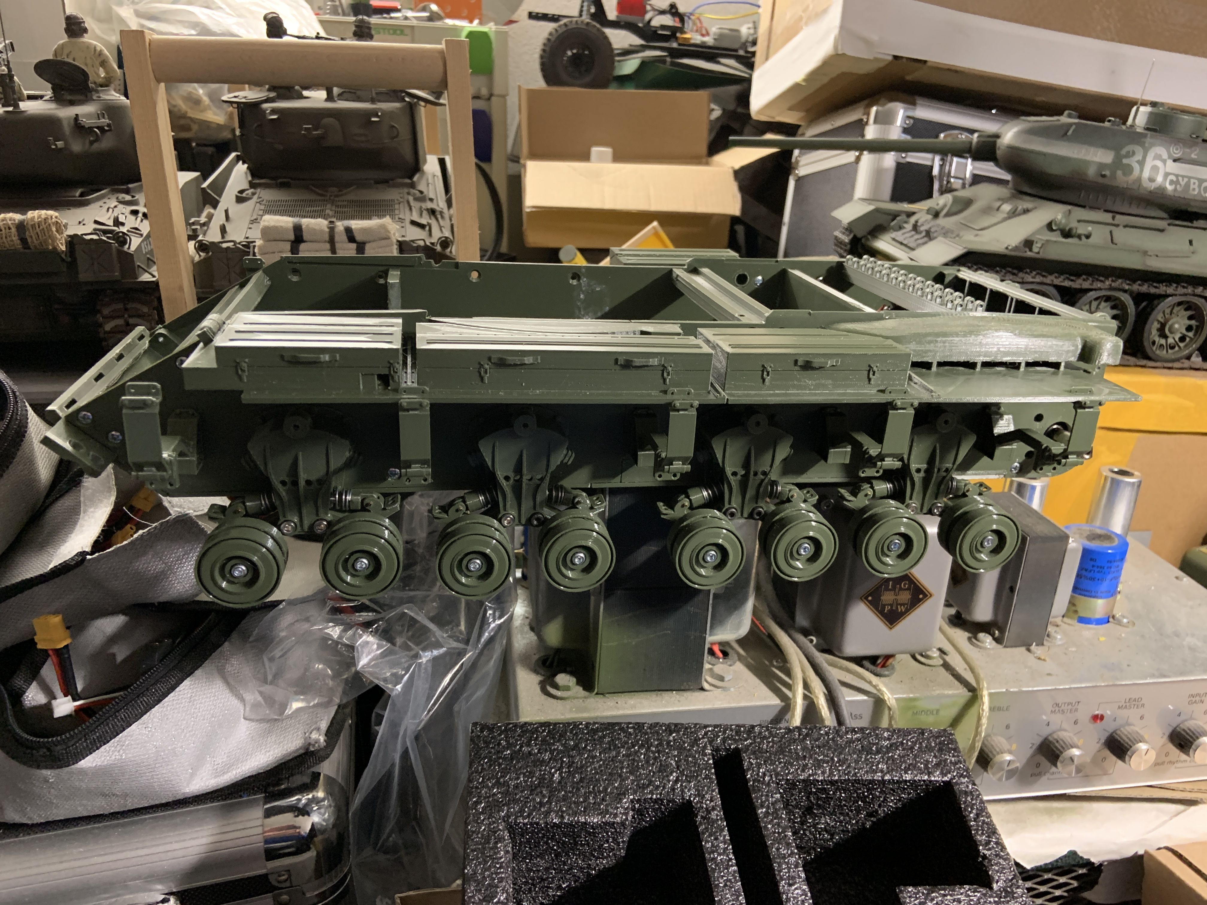

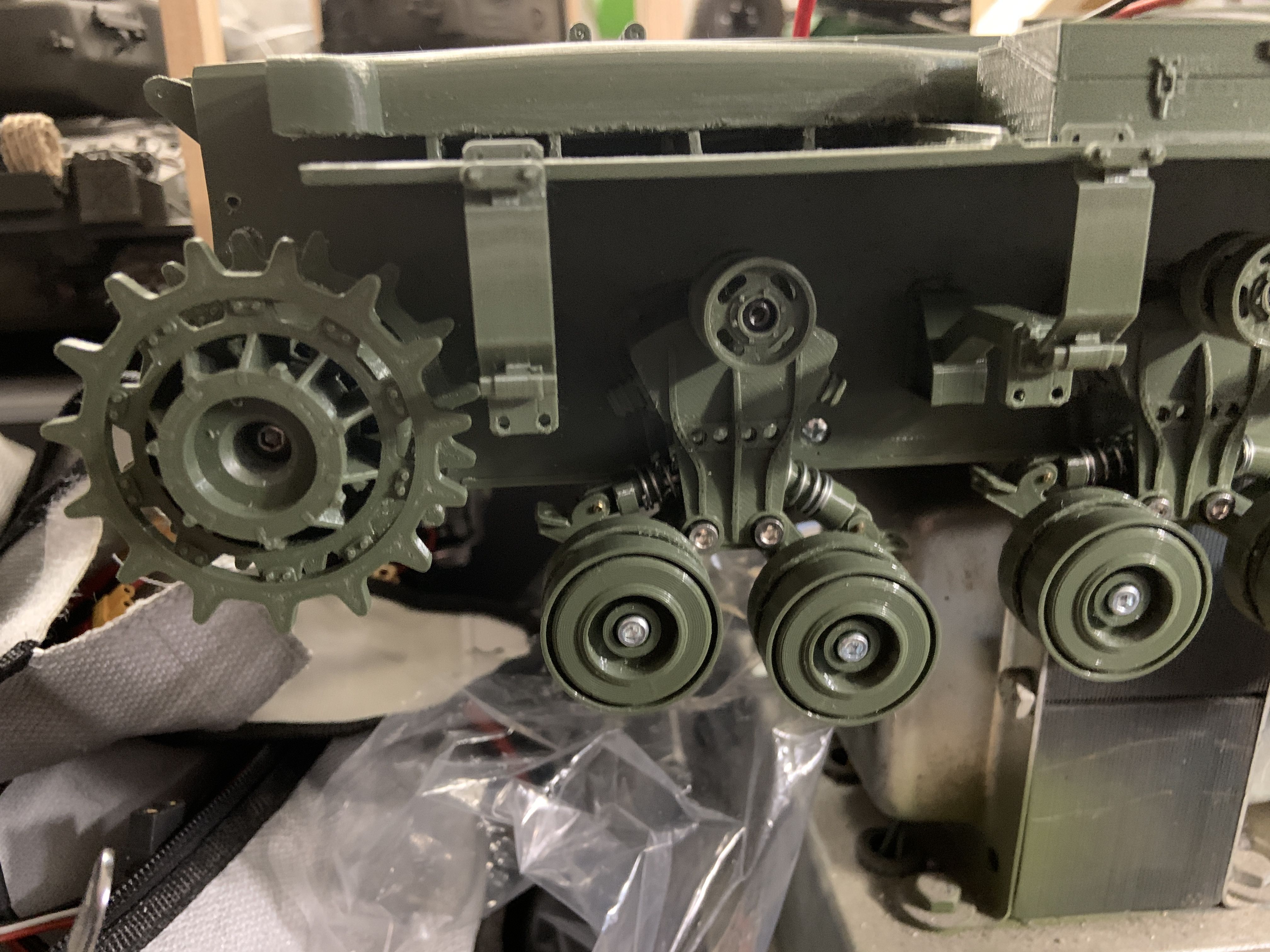

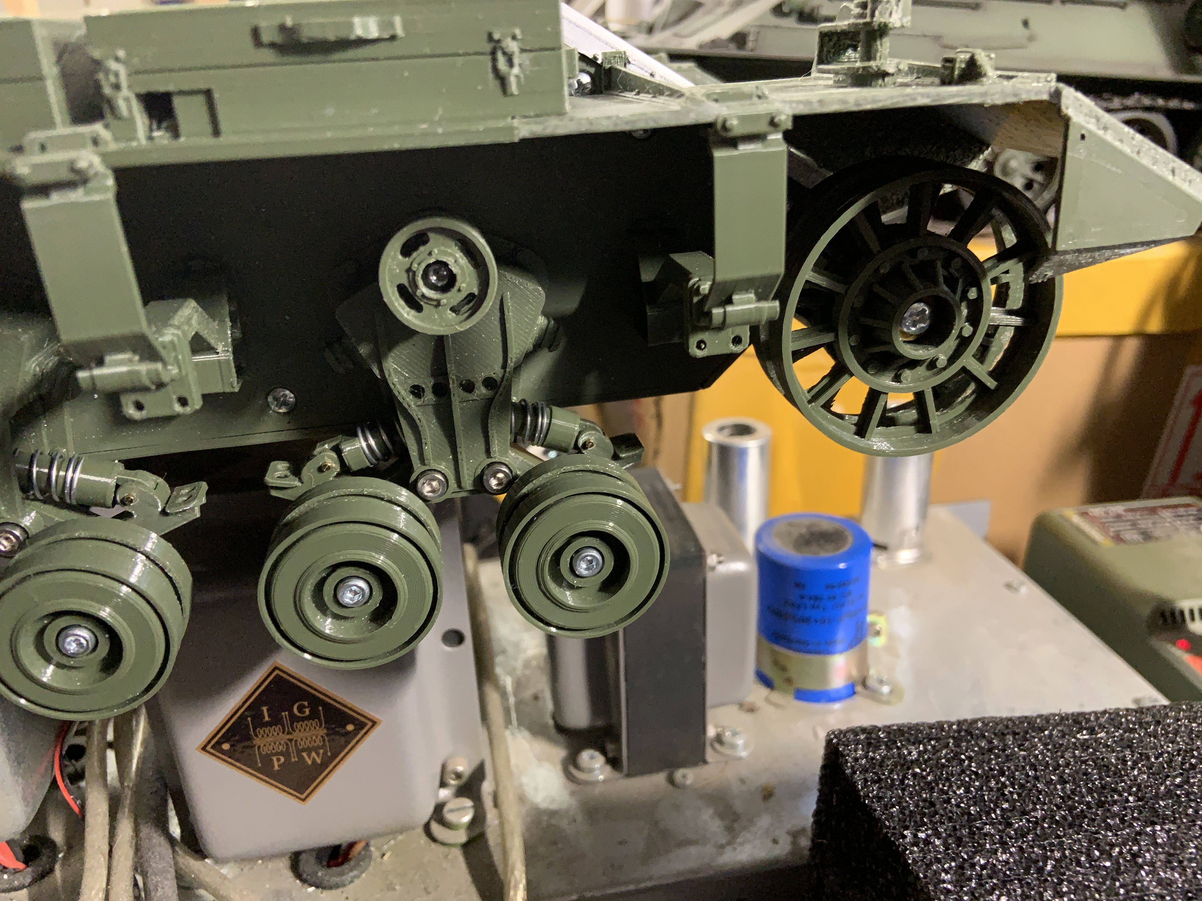

I am also printing a Conqueror...

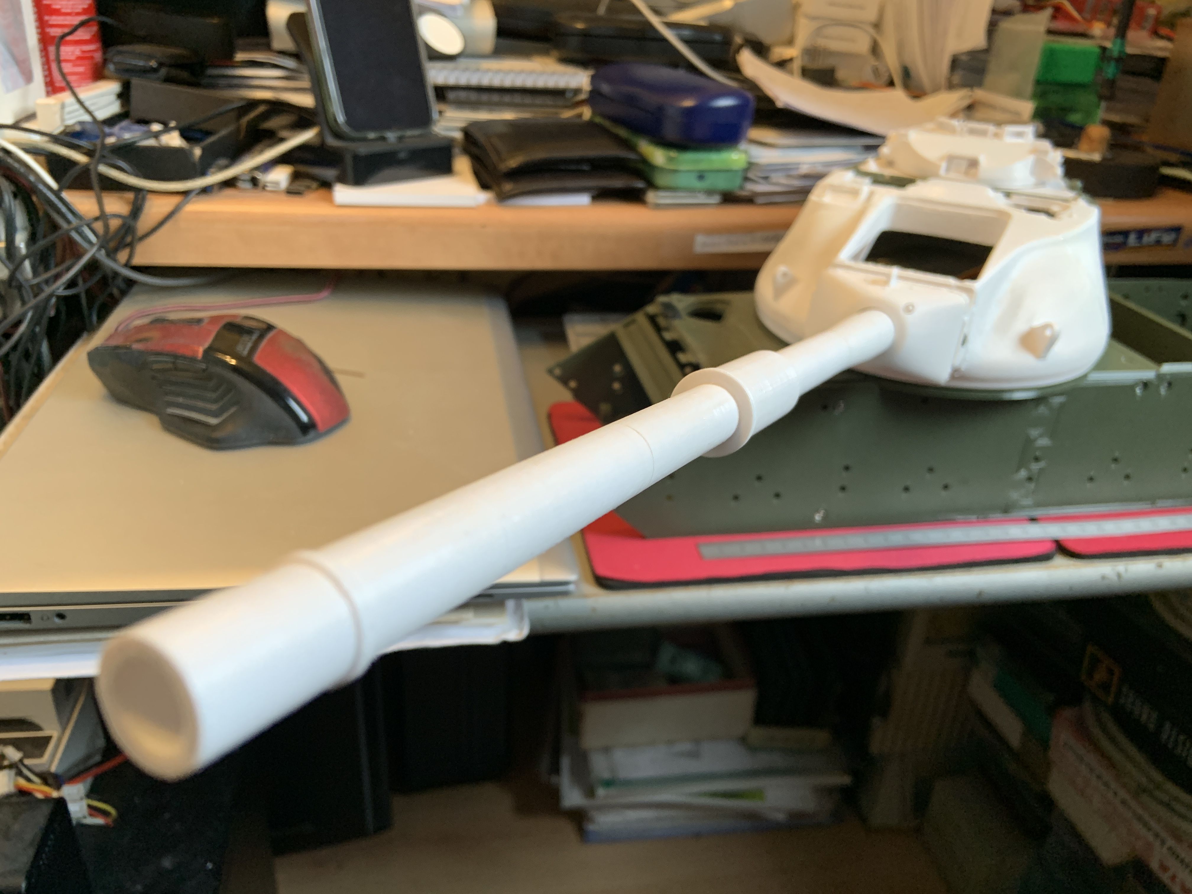

the print files are from Cults.

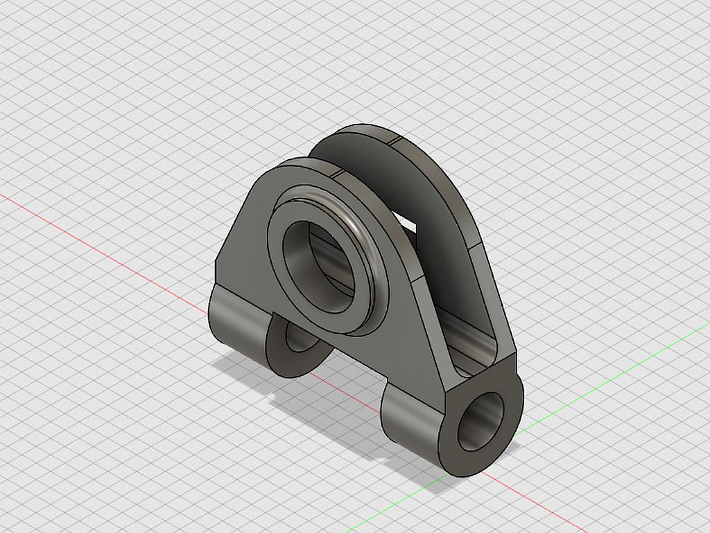

There are some things that are not consistent and should be improved.

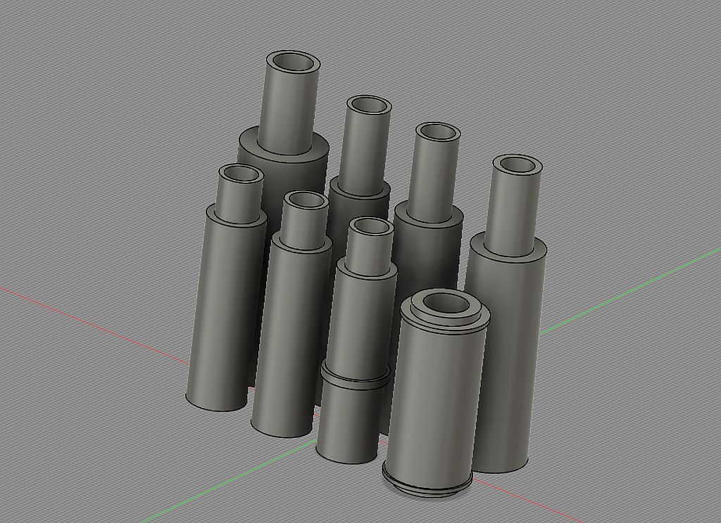

First the cannon barrel, the diameter at the end is too small.
In addition, a model with such a long barrel is difficult to transport, so the barrel should be divisible:
Due to the larger diameter, the barrel no longer fits into the recoil and the guide is too short.
This is too unstable anyway and leads to a wobbly barrel:

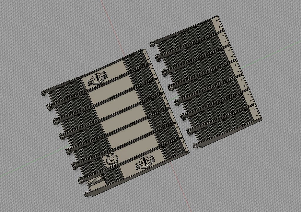

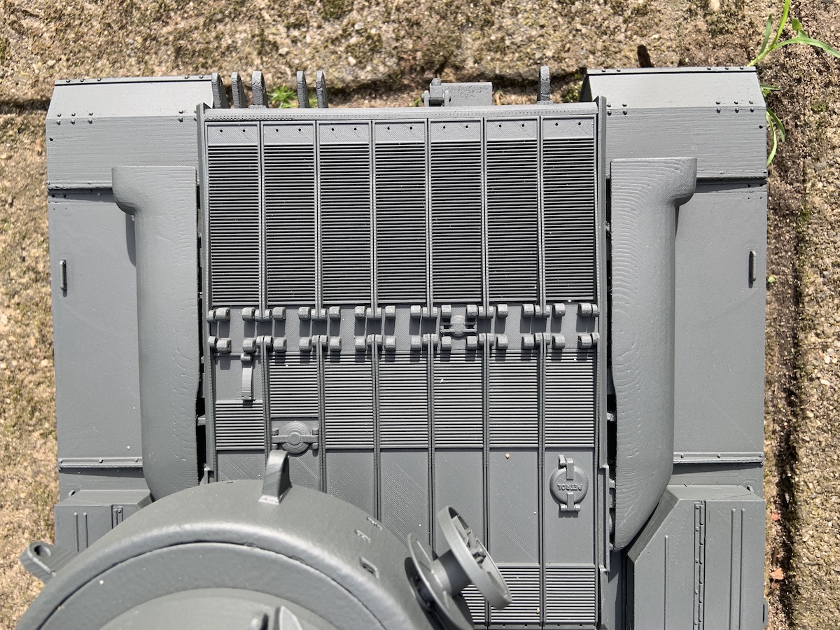

The motor deck needs moore details:
The rear hooks are also incorrect, as well as redrawing:

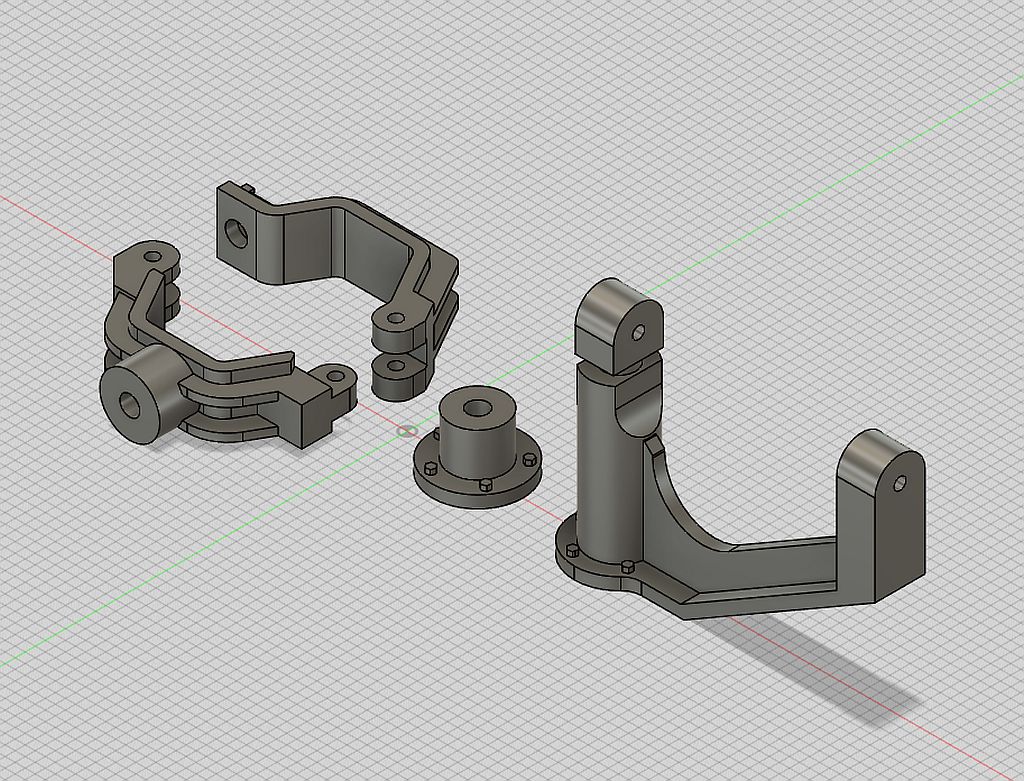

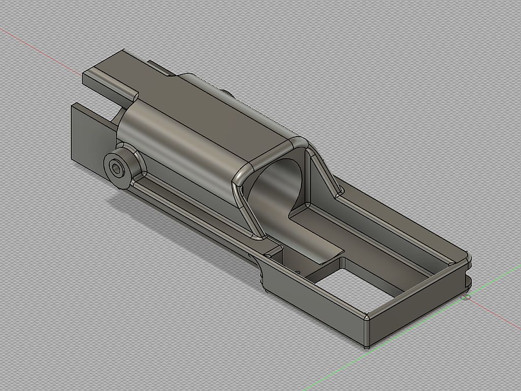

And if we're going to redraw everything anyway, we might as well redraw the barrel fixture as well:
Barrel fixture.jpg (195.83 KiB) Viewed 1324 times

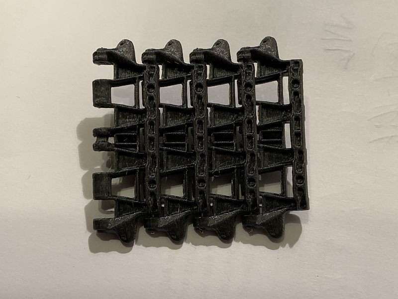

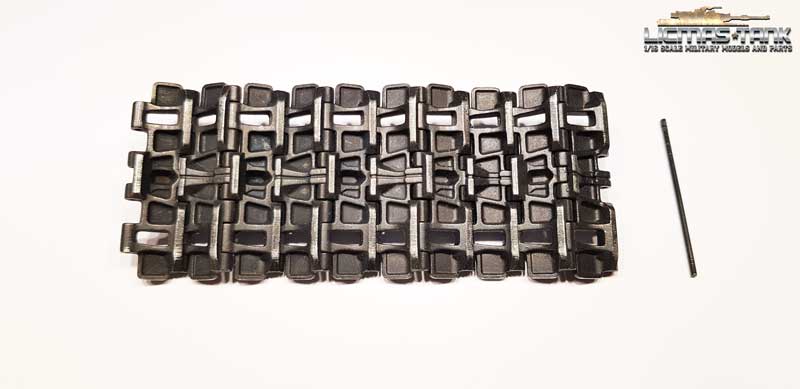

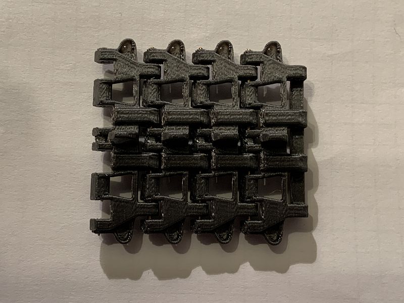

The track-links are currently being printed, 70 pieces fit on the printer.... 3 passes are necessary:
Comqueror 05042024-001.jpg (263.52 KiB) Viewed 1324 times
Test fit:
Comqueror 05042024-002.jpg (69.7 KiB) Viewed 1324 times
Comqueror 05042024-003.jpg (80.84 KiB) Viewed 1324 times

These tracks look very similar to KV-1 tracks. Maybe it could be used?
jhamm
Posts: 1102
Location: Germany
Re: Conqueror!
Post by jhamm »
The track links are printed from PETG and are very strong.
Other tracks require the sprockets to be adapted.

Post by jhamm »
Hello,
the conqueror is almost finished.
The upper skirts and only details such as tools, lights etc. are still missing...
Posts: 11879
Re: Conqueror!
Holy-Moley what a whopper.
You have aced this one Mr Jhamm, outstanding work.
Could you do us all a favour and take a pic of it next to something we all can scale against, like a Tiger, Sherman or King Tiger for example!
Or going by the size of it, perhaps a Centurion or Abrams!!!!

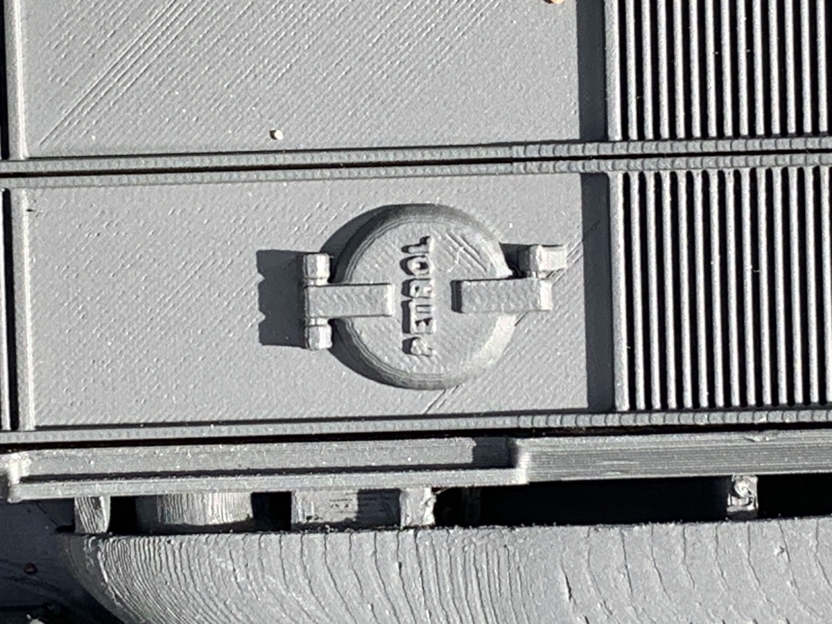

Herr Hamm: you continually create remarkable models. I did not even know that the Conqueror ever existed, so now I have more about which to learn. While there is so much to praise about your model, I will pick just one: I like the "Petrol" indicator relief cast into the fuel filler cover.

Nice build. The Conqueror is on my list of tanks I'd like to build one day.

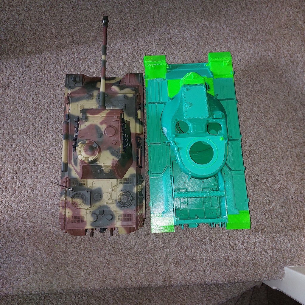

Tiger6
Posts: 1492
Re: Conqueror!
Post by Tiger6 »
Comparison to a Panther:
