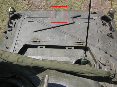

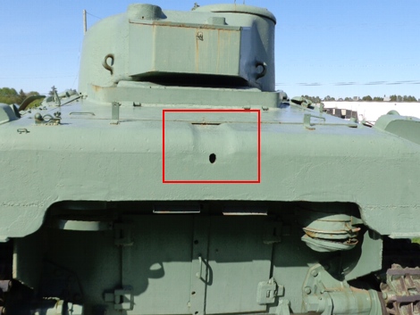

If you studied the Grizzly page you may have noticed something not accurate with my hull !
http://the.shadock.free.fr/sherman_minu ... izzly.html
There's a groove in the center of the rear of the hull made by General Steel...

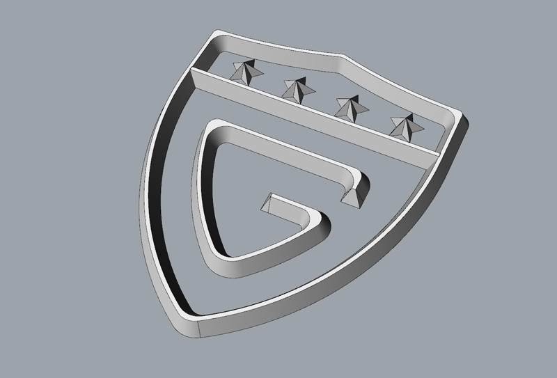

And the one I used for photogrammetry did not but I 3D modeled and added the General Steel logo to it :
This is not accurate as General Steel stopped to make this groove (which was unique to them) when they switched to the production of the M4A1 hull with large hatches. This means the Sherman I used as reference has a hull that was probably manufactured by Continental Steel. But... I like the General Steel logo so much so I decided to include it in my 3D model, I thought I would be easier to sand it if I ever changed my mind aboout it than adding it.

The Grizzly Groove! Yes, I noticed its absence, but I'm not enough of a Shermaniac to say whether all small hatch cast hulls had one. Anyways, I was too busy drooling over the small hatch configuration up front! Plus the fact your hull has "The Look".
I have a Mato M4A1 hull with nice thick plastic (and the General [Grizzly] shield upfront--more Sherman Minutia fun there), so the groove is no problem to carve in. The large hatches to small hatches? Not so easy!
