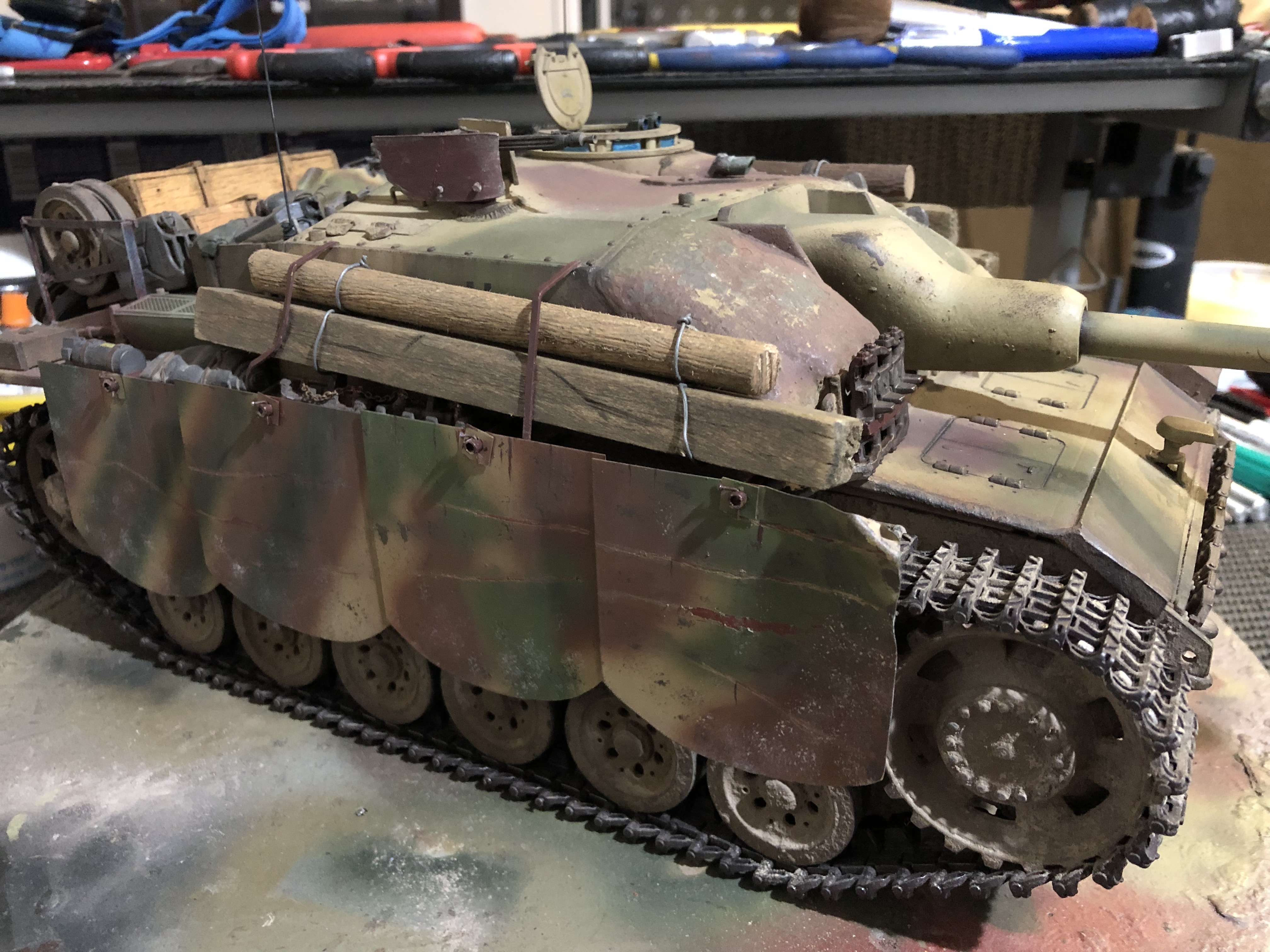

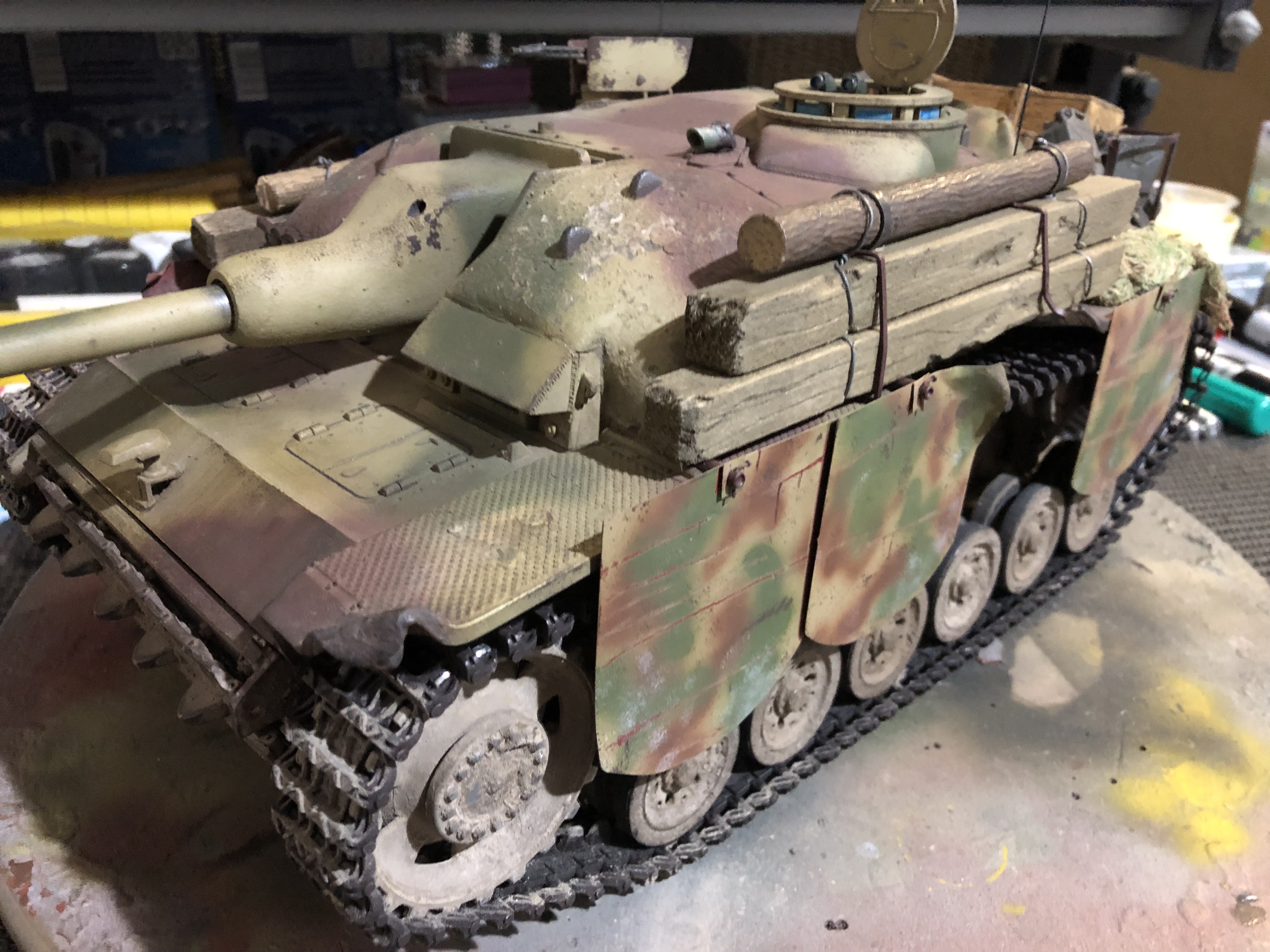

Well after a long=ish break from this, its taken a turn for the better.
As I couldnt get the Tamiya control system to work, I swapped it out for an H/L 7.1s.
Now the Tamy system was operating, its just that I couldn't get it to work with new radio gear as I am too dumb when it comes to that.
So, out it came & into a bag to be replaced with something I know and can make work, ANNNNND can keep working later on.
The recoil servo turned out to be stripped, and it was glued on to a degree replicating a bad day at the H/L glue Monkey assembly line, as was the Tamiya flash cable into the muzzle. :wtf:
The flash was cut and can easily be soldered to go again, the servo I had to literally disintegrate into shards to remove so I could replace it with a new one.
A benefit of the new 7.1s H/L boards is that they have a servo reverse option on them. Which was handy in this case.
Mato metal tracks arrived & were painted to suit, plus new drive sprockets to replace the originals which had stripped teeth. I suspect this model had suffered a drop from a height which punched the barrel back(stripping the servo) and a consequential impact (damaging the drive sprockets) so when I got it, the tracks were gone from it already (broken off I assume).

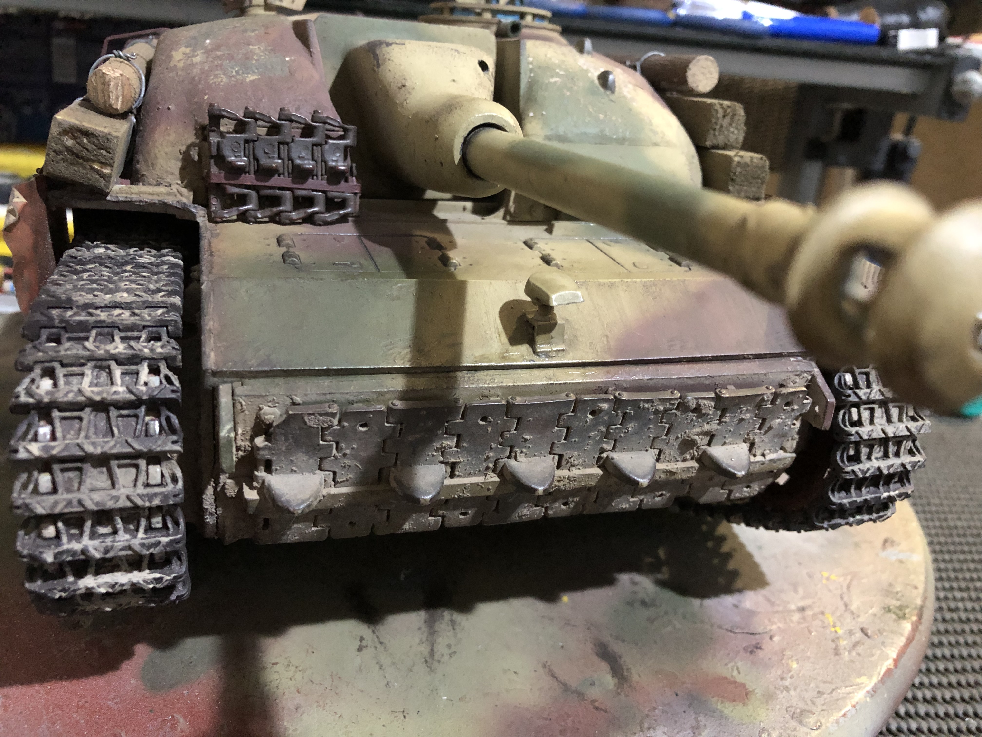

I grafted a short section of spare track over the radio mans frontal armour with a brass strip to retain it, and added a bit of pigment here & there to blend the lot in.
job done.
