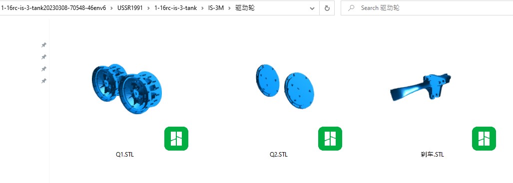

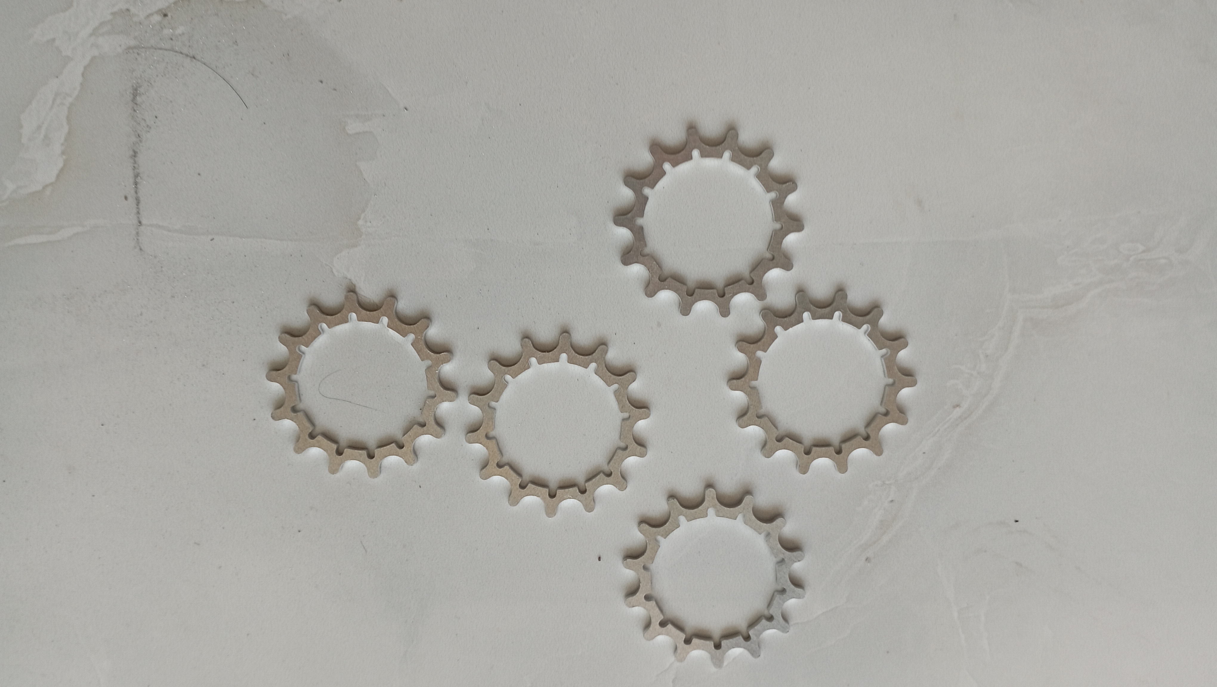

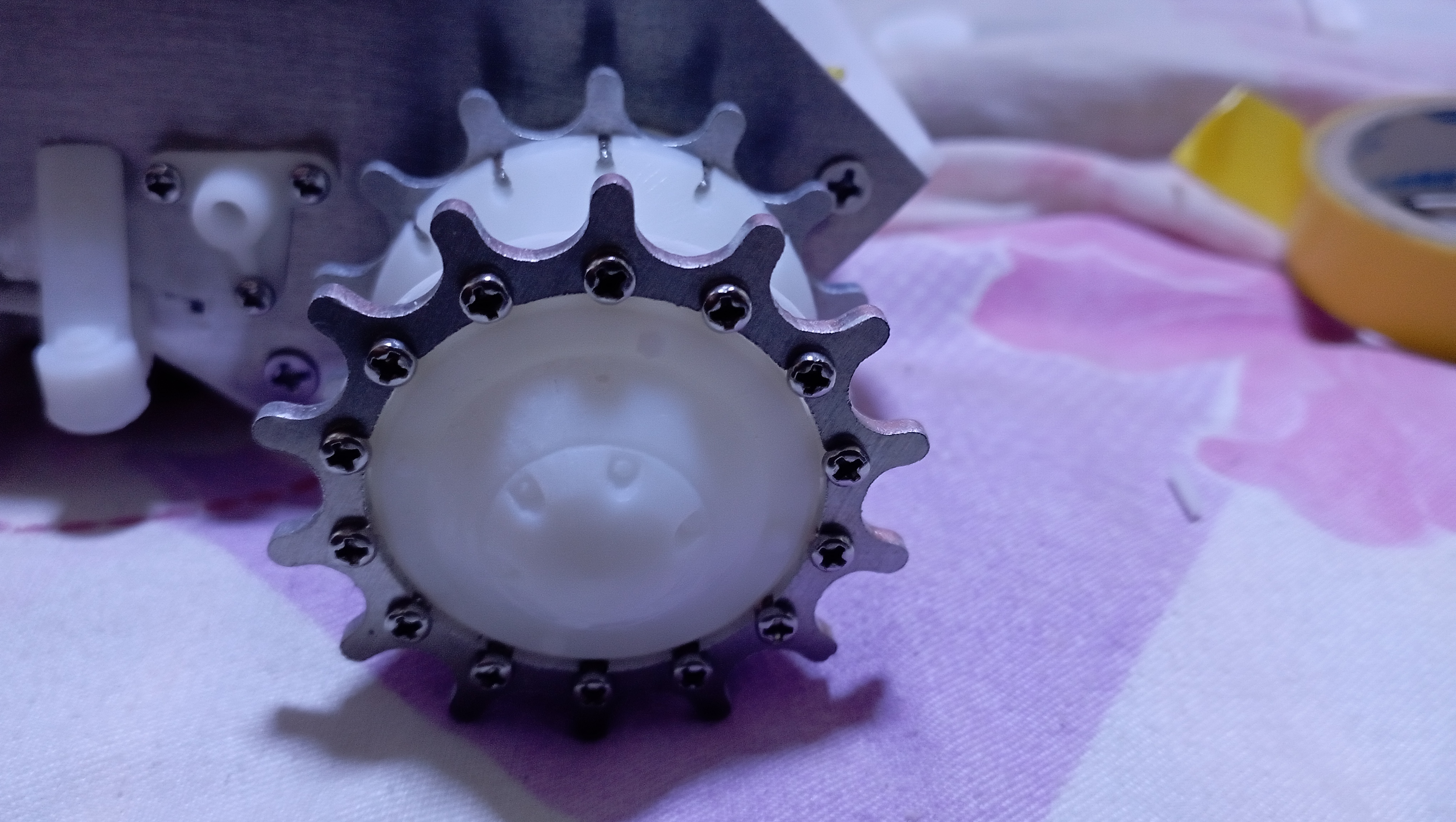

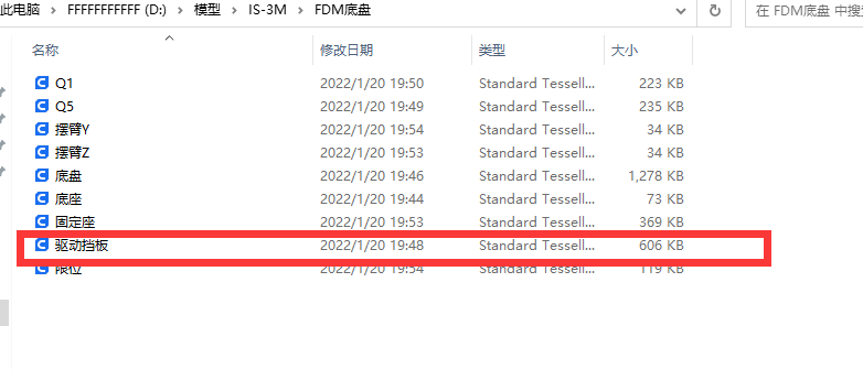

I just looked through all the STL files I downloaded from Cults and the sprocket ring that has the teeth on it that interface with the tracks is missing. I even downloaded a fresh copy of the files from Cults. This is all I have for files for the sprockets:
Screenshot 2023-08-14 023555.jpg (35.53 KiB) Viewed 2122 times

tankme wrote: Mon Aug 14, 2023 8:25 am I just looked through all the STL files I downloaded from Cults and the sprocket ring that has the teeth on it that interface with the tracks is missing. I even downloaded a fresh copy of the files from Cults. This is all I have for files for the sprockets:
tankme
Posts: 3203
Location: Elgin, TX
Re: 1/16 IS-3
Post by tankme »
Thanks. I redownloaded the files and it's there now.

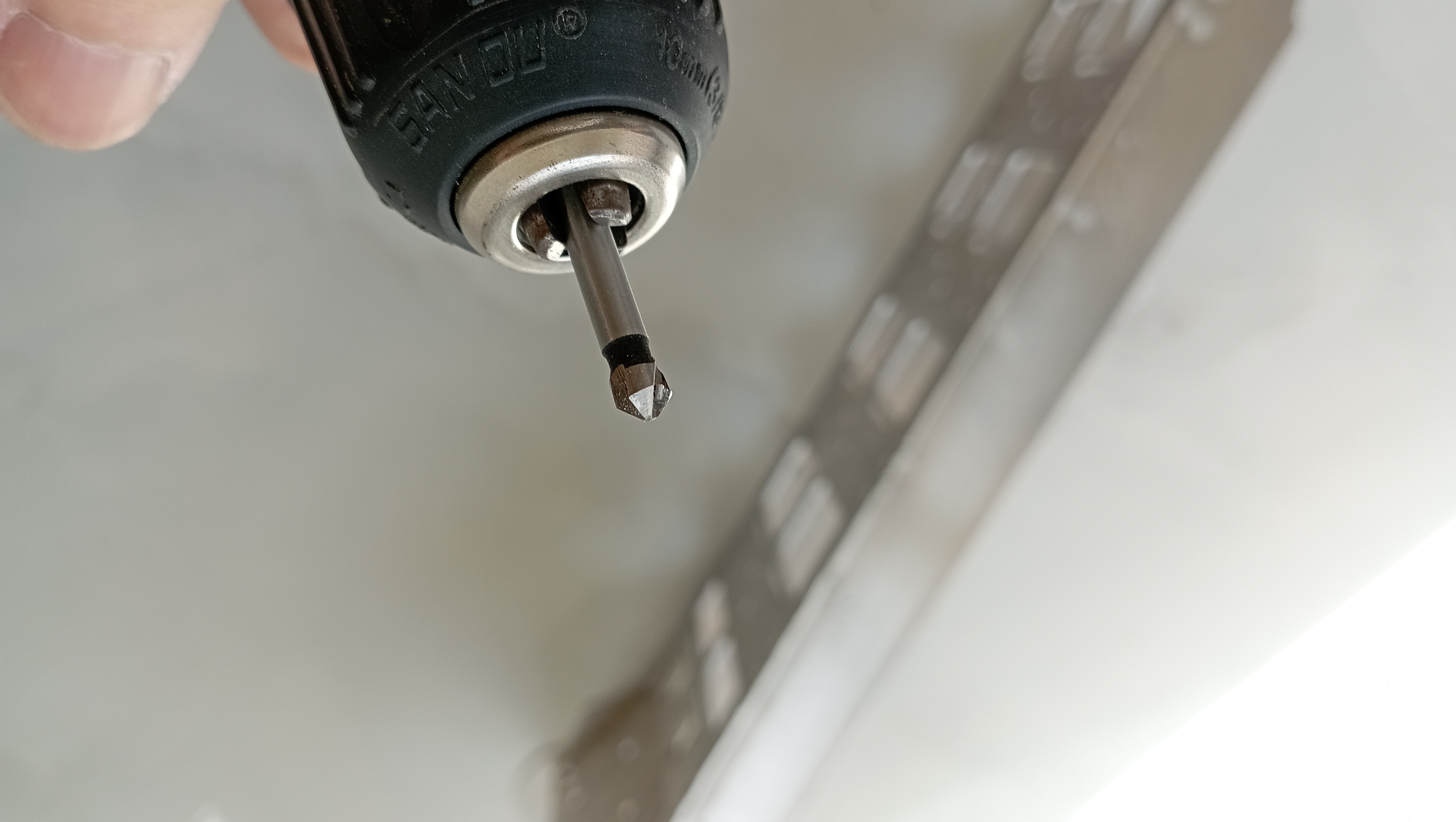

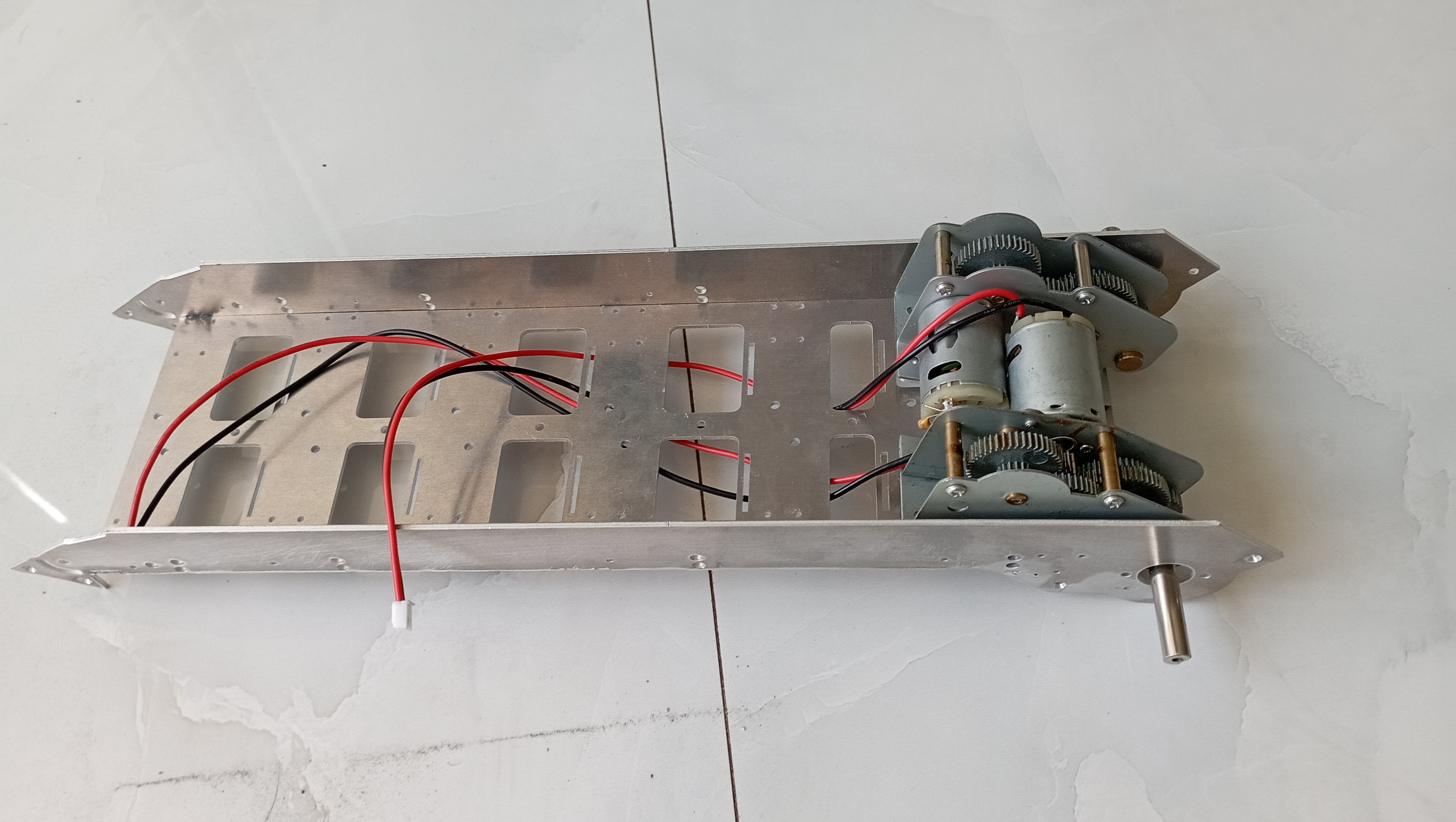

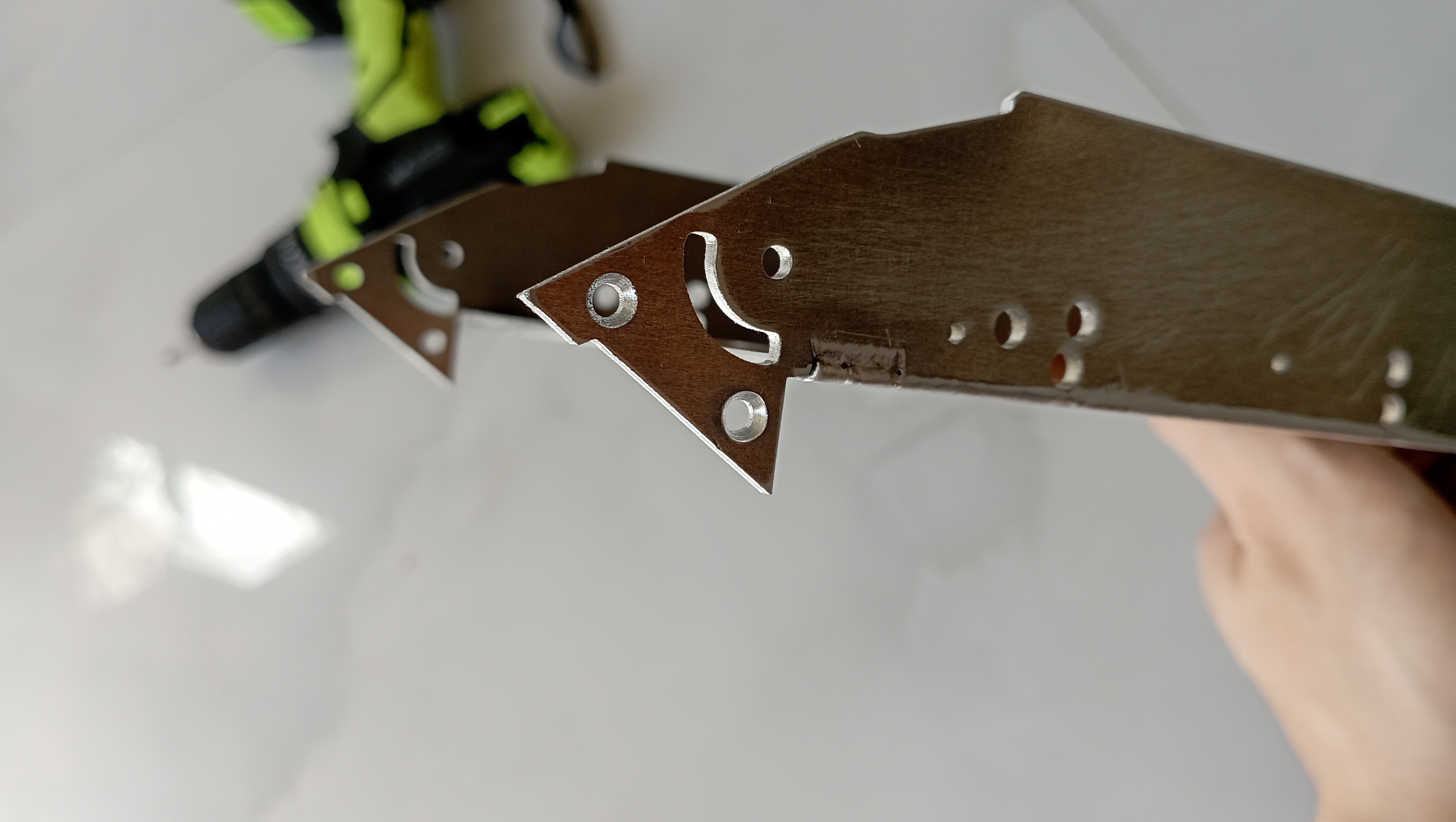

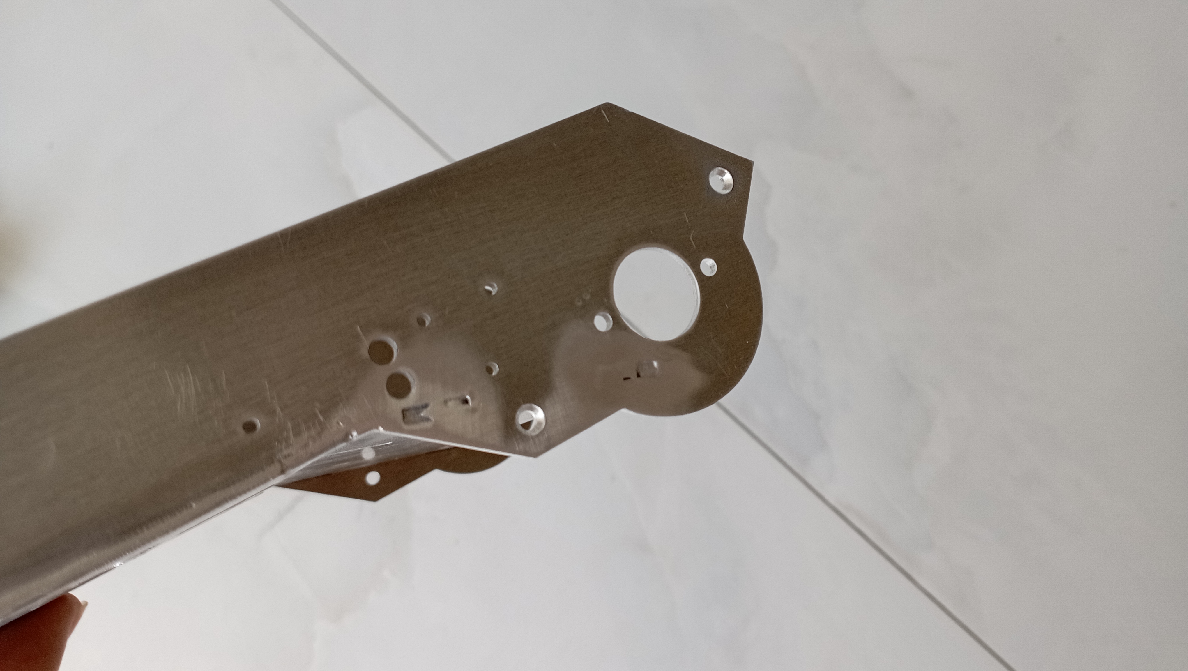

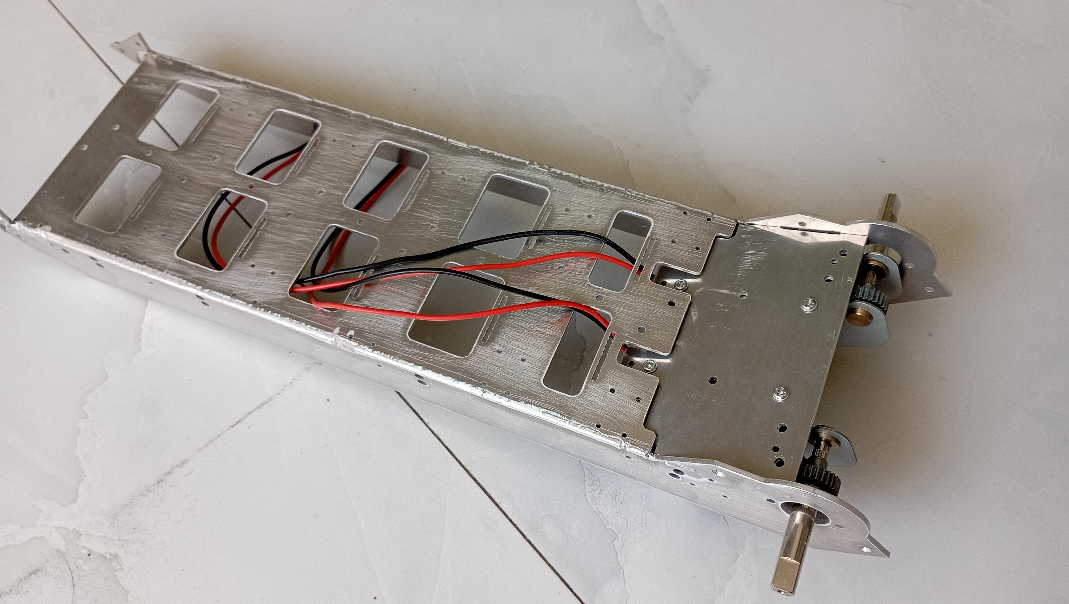

Use a chamfer drill bit to chamfer several of the holes and use a file to shape the weld seam. Install the main gearbox and it looks good.

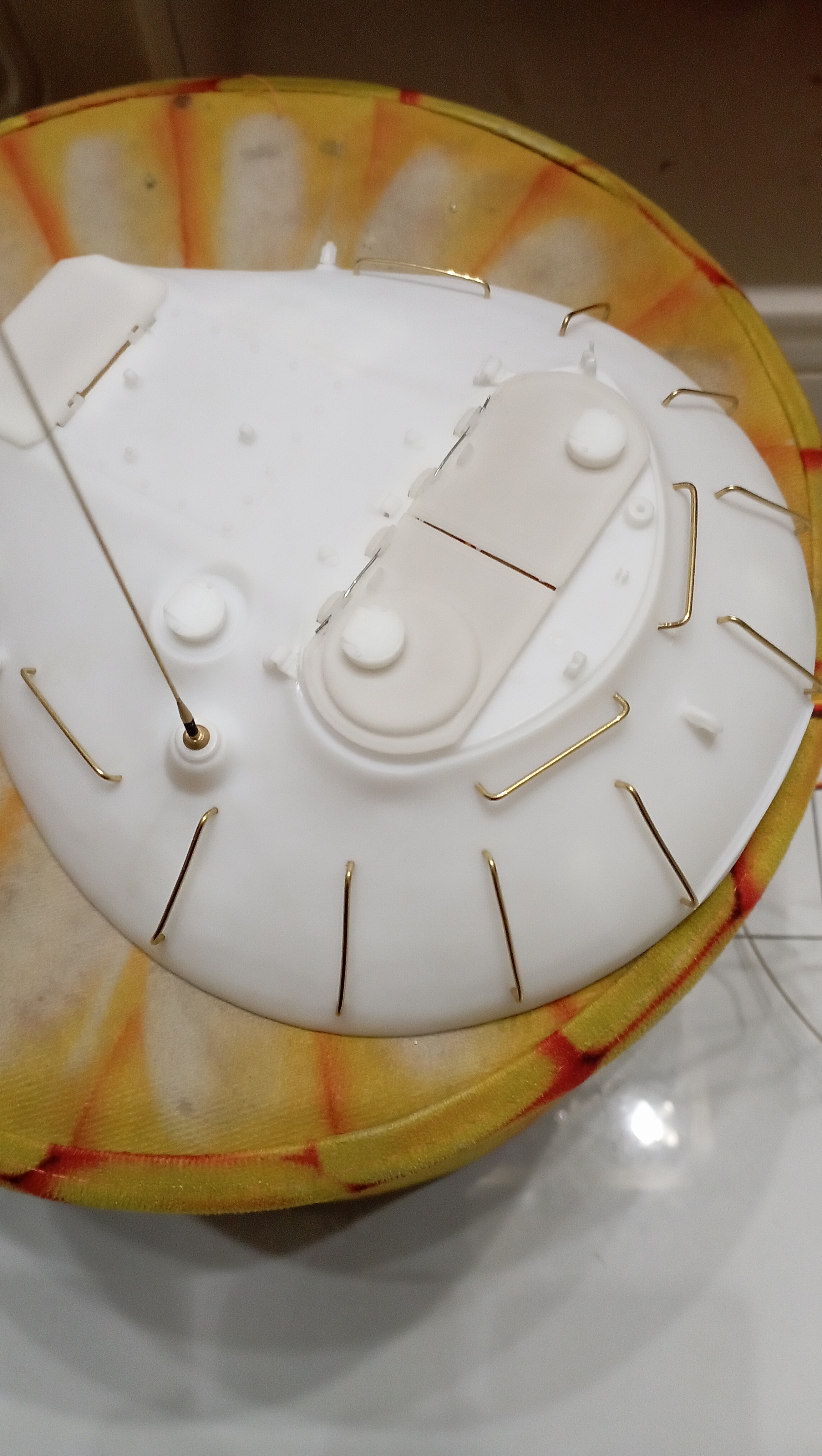

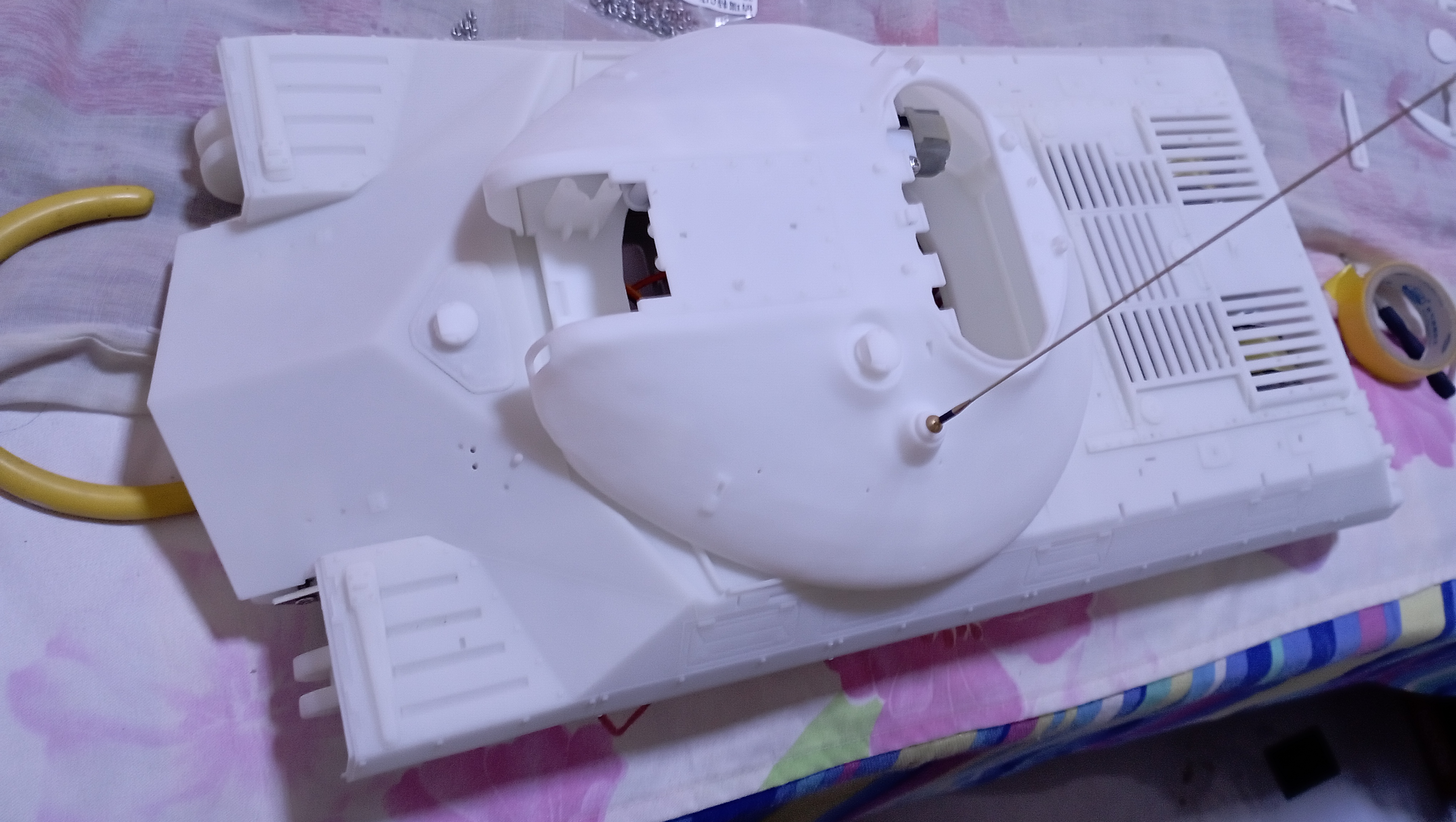

I have completed the painting work, but I have always forgotten to update the forum,
The handrails and antennas on the turret are made of brass.

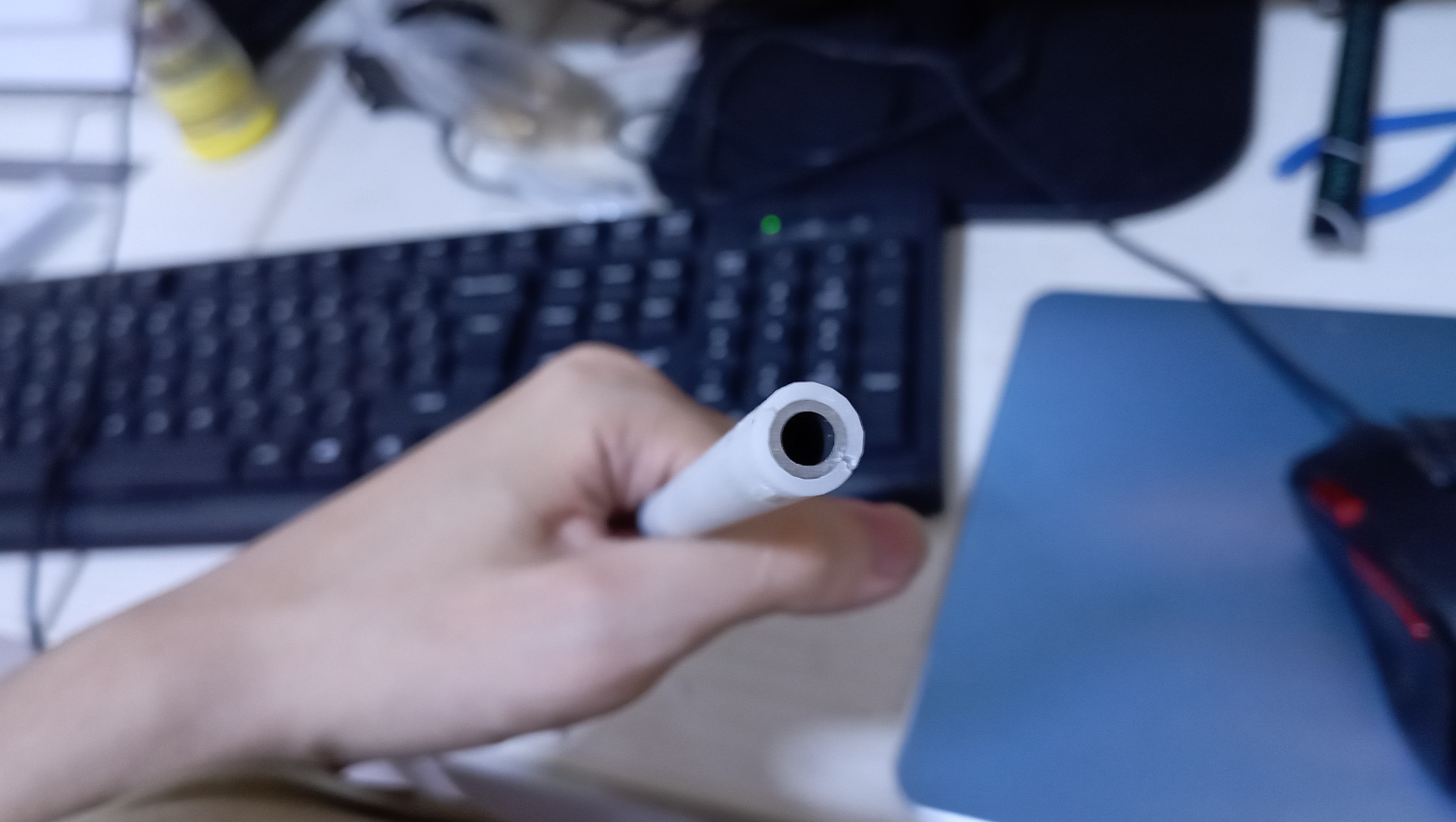

3D printed gun barrel embedded with steel pipes
Kaczor
Posts: 2390
Location: Ciechanow, Poland
Re: 1/16 IS-3
Post by Kaczor »
Is that SLS print? Looks so crisp!
