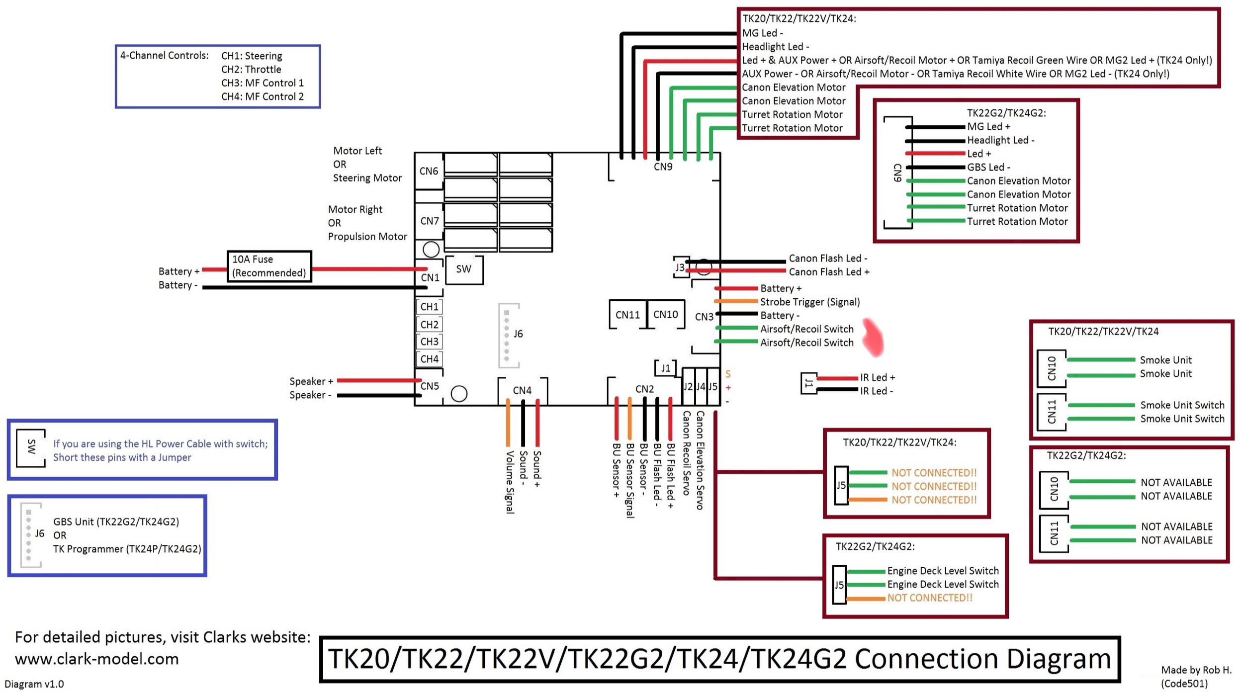

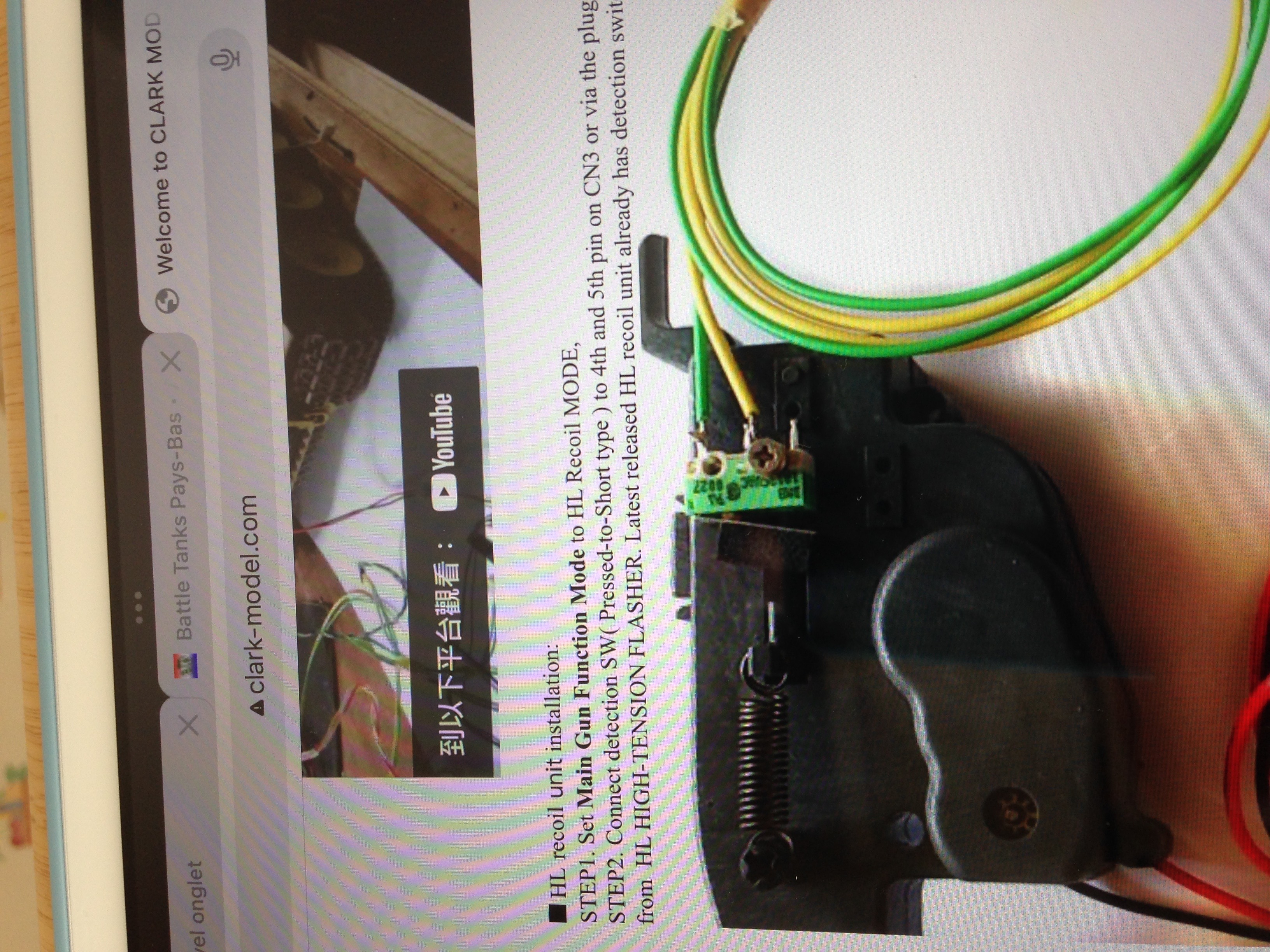

:P Hello, yes it is on this terminal block, the last two pins at the bottom, on the diagram of "Tank me" it is indicated "recoil.switch airsoft" (red dot on attached photo) as you do not have a system Flash? a simple 2-pin plug will suffice, and everything should go back to normal? because I think you don't have the sound of the barrel when firing either?

I would agree with Jofaur's assessment. When I use the Taigen flash in that port, I actually remove the plug from pin 4 and 5 on that side as I don't use the BB function. The wires go to the microswitch on the BB unit. When the switch doesn't close after the BB unit fires, the board doesn't detect that the firing sequence is complete so it just keeps firing.

in the photo with the turntable? I noticed a shunt (red wire on CN4) there is no volume adjustment then? see diagram Tank me, in principle it is a potentiometer at this place

@Jofaur86, if there is no volume control connected to the Clark a jumper on CN4 will just play at max volume.
