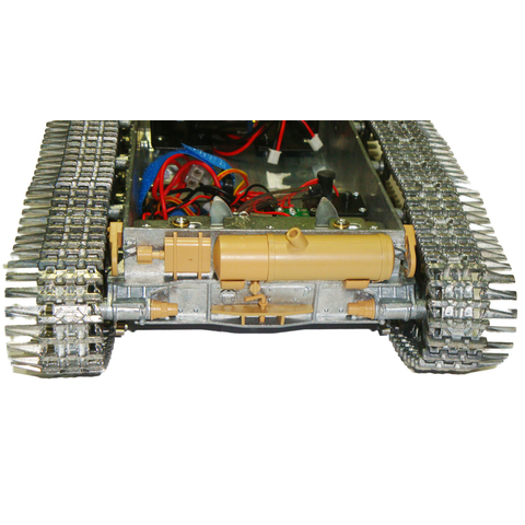

Personally, I would say no? but if you glue the existing hatch in place, and as explained above, a layer of resin, in my PZ III I glued a styrene bottom (ABS) it is up to you, the resin, there is the Epoxy, and Polyester, I don't know if one of the two is not compatible with plastic?
https://www.rctank.de/Panzer-III-StuG-I ... te-Version
on the PZ IV, the system is fixed on the back of the tank, horizontally, but on the photo, it is a metal chassis? so you have to ask the question? how fits
https://www.rctank.de/Panzer-IV-Vollmet ... triebe-etc
