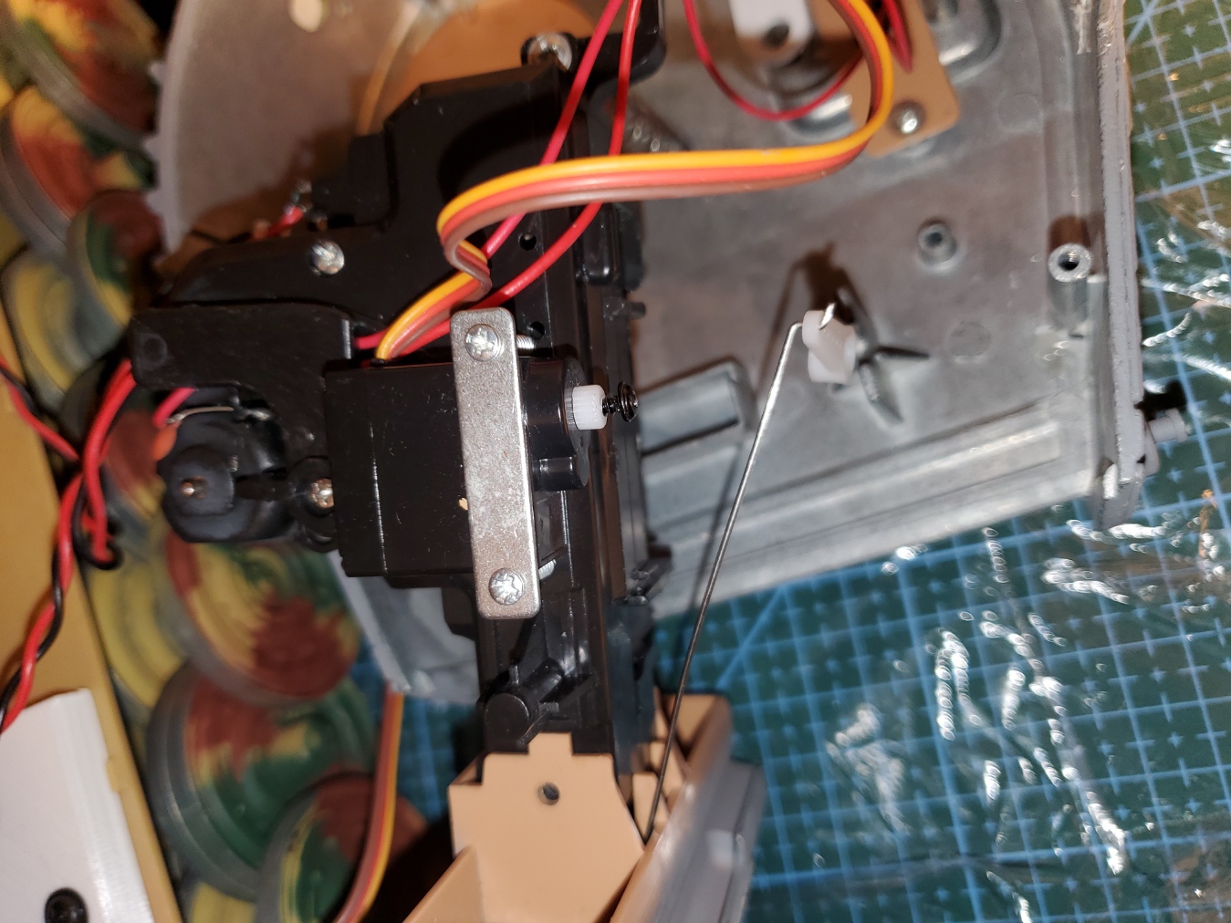

Hi Jofaur
Thanks again for the info, now the Airsoft canon works. The Taigen turret I have has recoil operated by a servo.
![Image]()
It is disconnected at the moment while I fit a fpv camera to the mantlet.
- aigen recoil servo.jpg (492.05 KiB) Viewed 3302 times

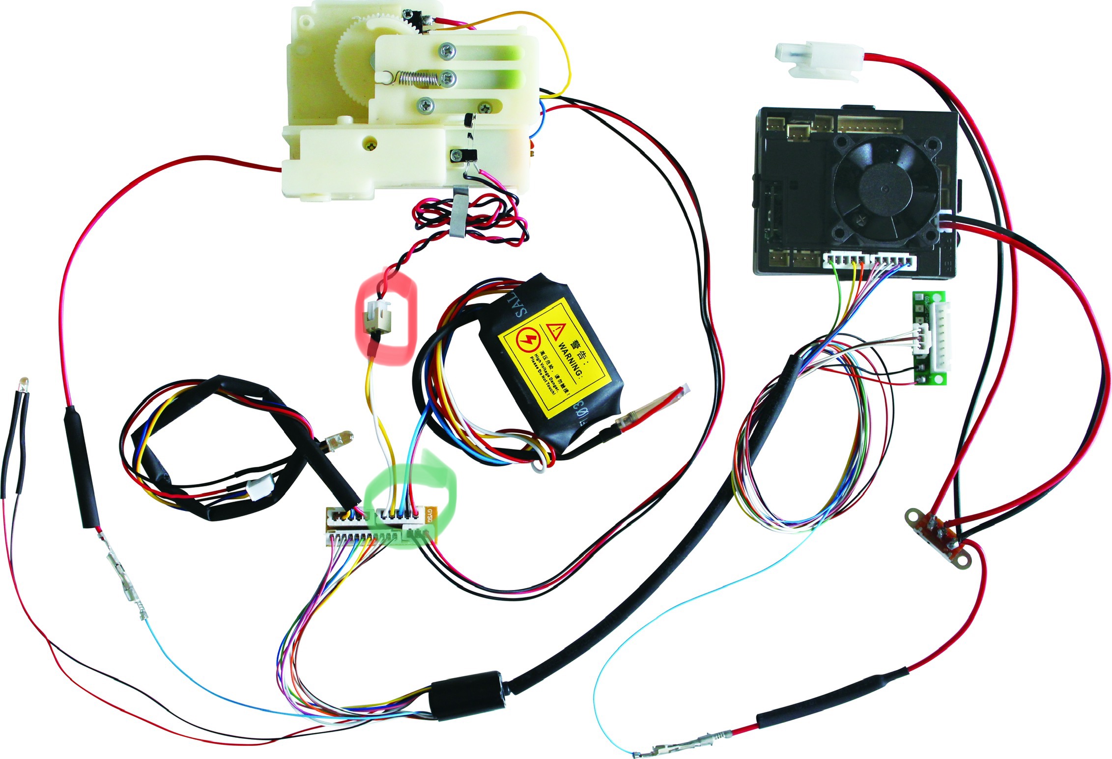

In the case of Xenon, there is, in principle, a 5-pin plug with a small 2-pin plug, which comes with the microswitch plug
if xenon see photo below in red/green, airsoft microswitch, in green 5-pin CN3
if system with led, see quick diagram below and unless I am mistaken, there is a general configuration on the PC to perform? It is also possible to modify servo courses, etc. or trigger the shot, with a switch from the transmitter menu!!!!
