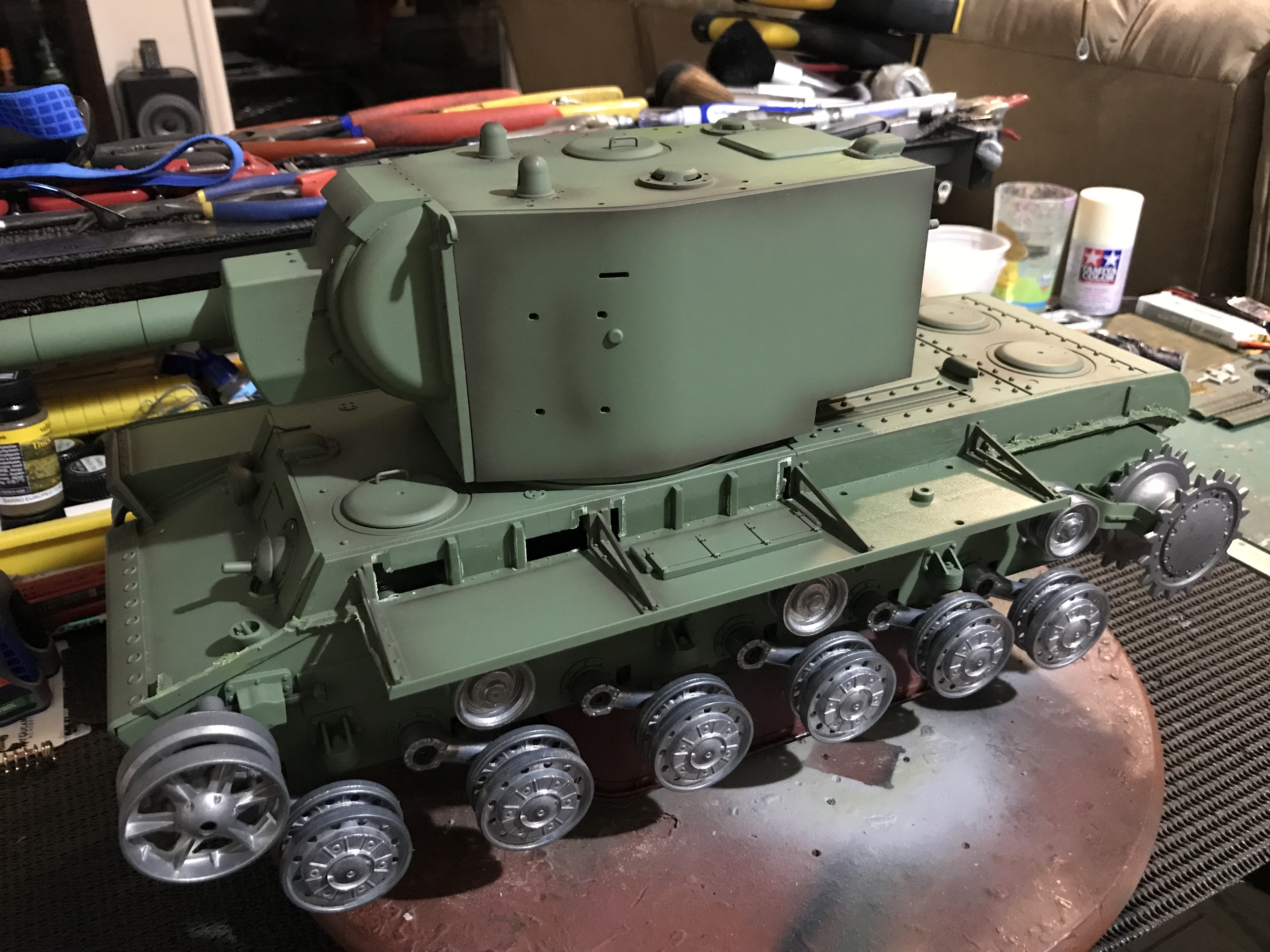

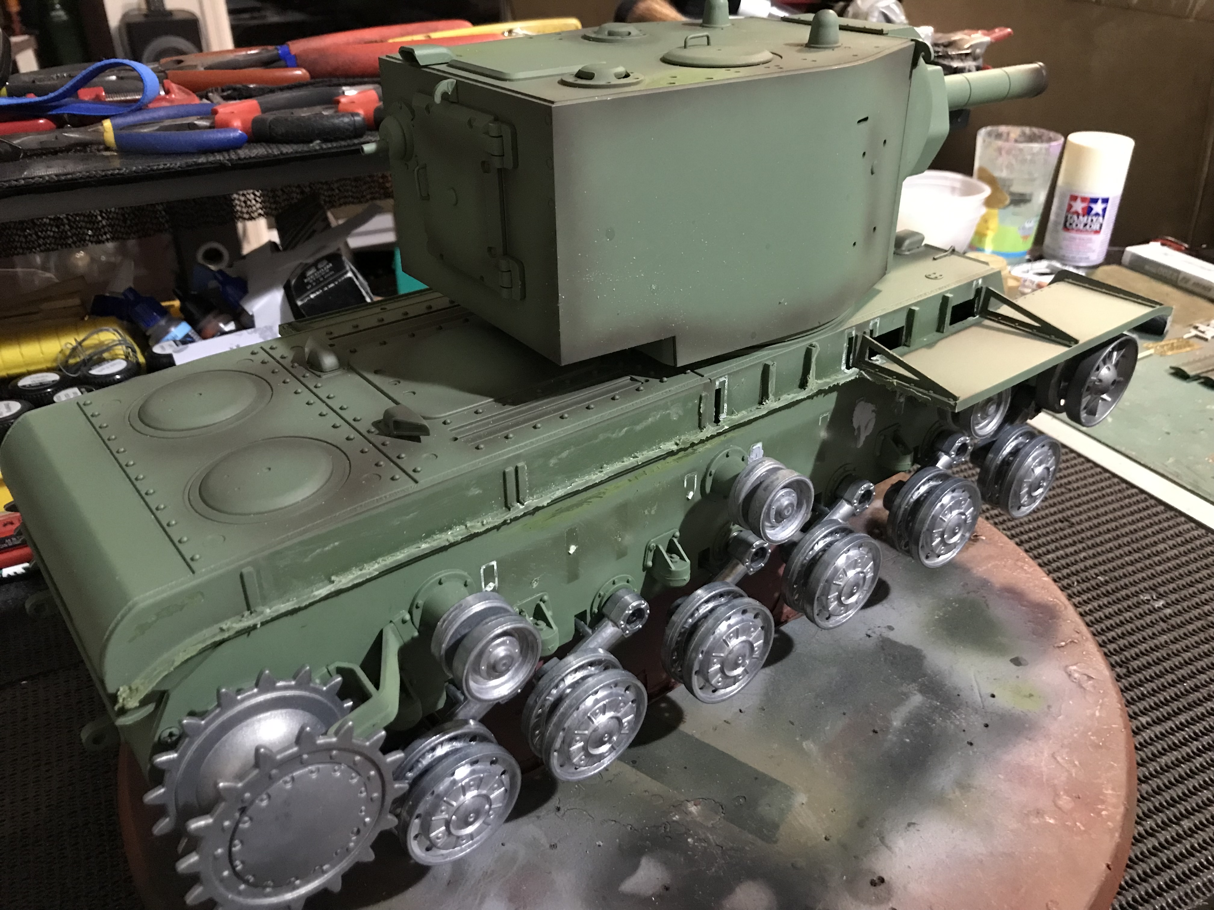

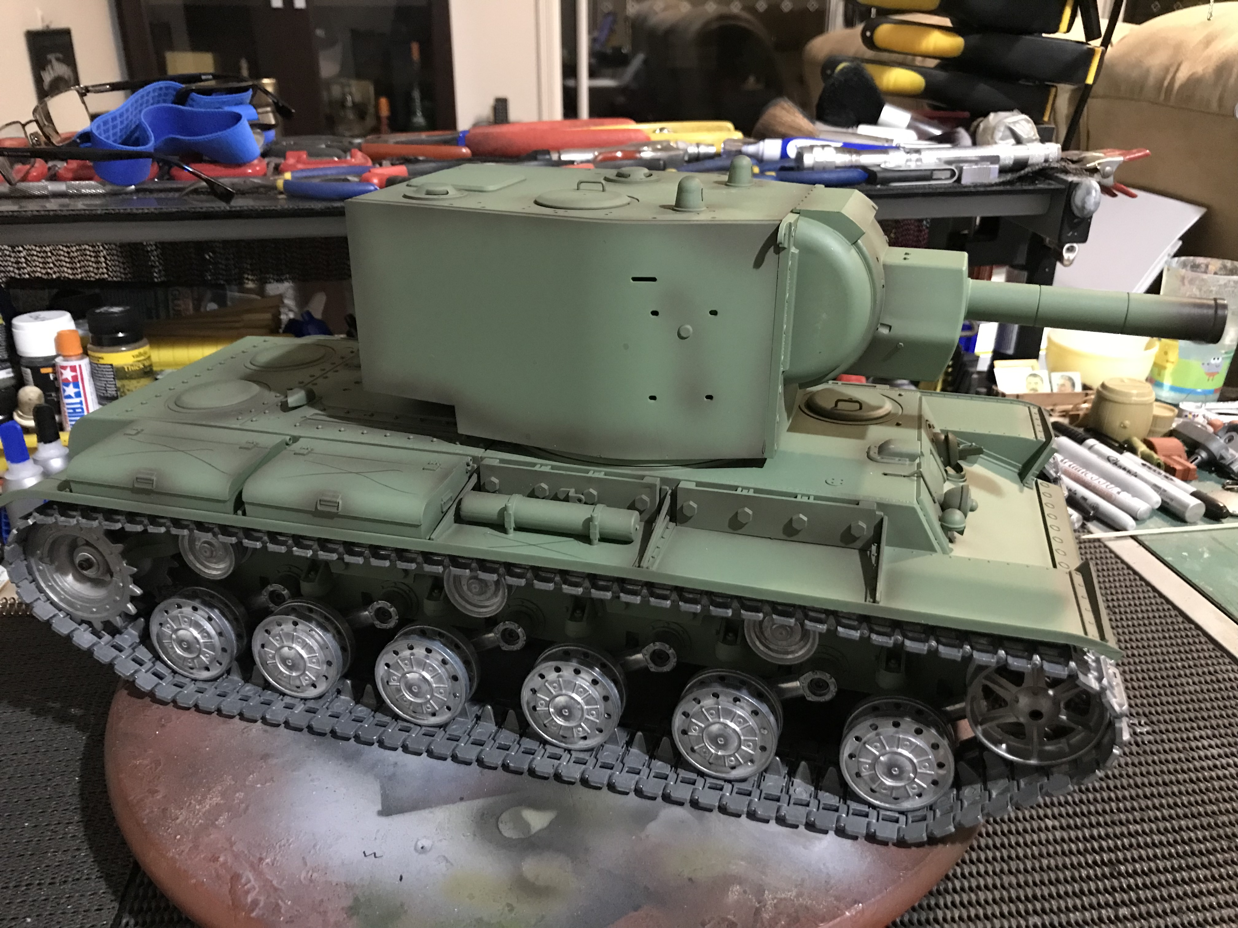

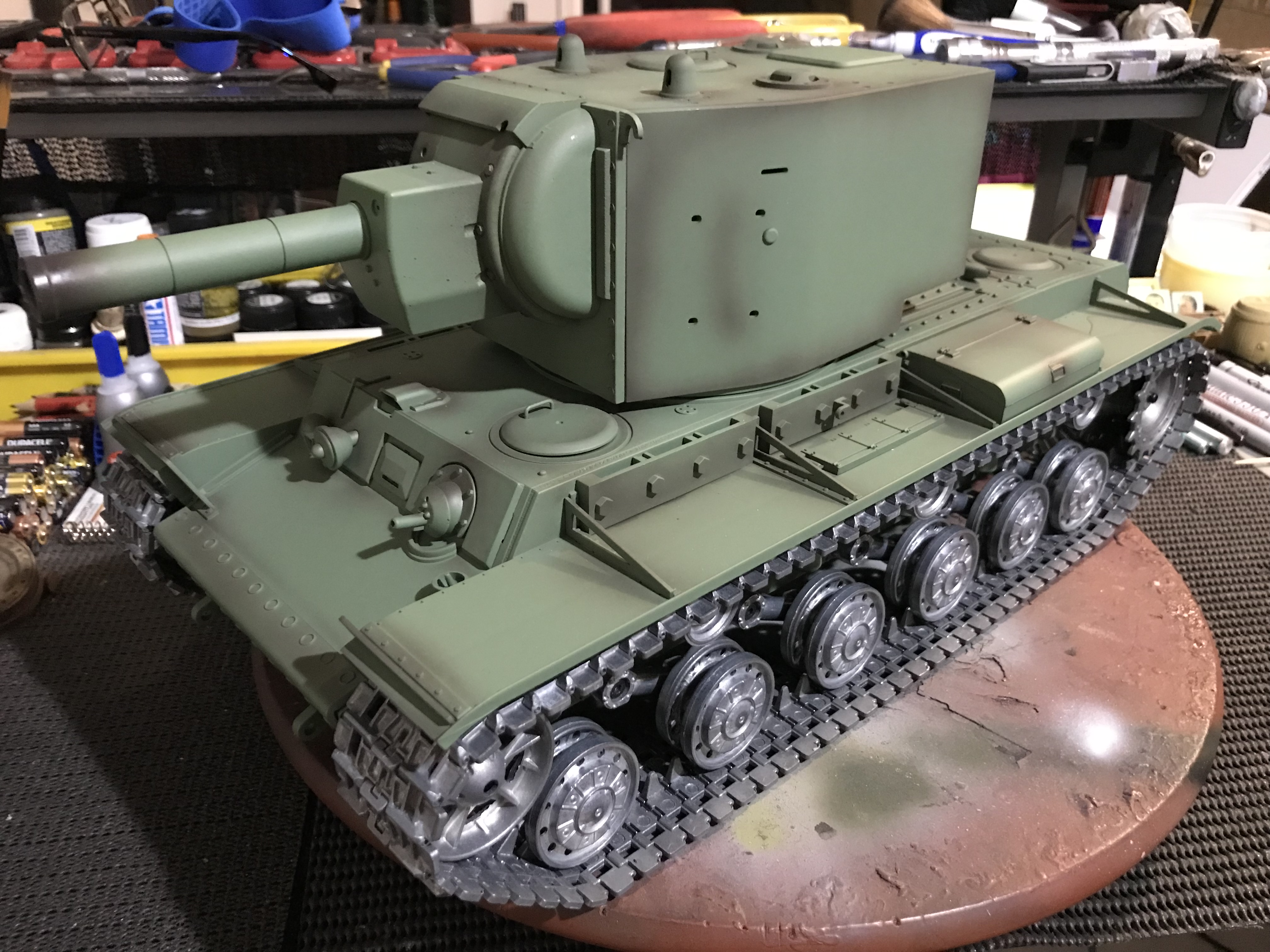

Great service from toucan Hobby, arrived well ahead of its projected time and was better than I thought it would be.
The Wife remarked that the tank was bigger than the gun it carried............(hmm
After a test run, that thankfully confirmed its NOT a gas turbine, onto the bench it went.
Taking a bit of artistic licence based on the picture available, I set about removing the KV-1E parts off it, and then the mudguards.
Again I get the comment that for such money, why wreck it !!
Because I'm a terrible child, always wrecking my toys
When i removed the bolted armour from the sides of the hull either side of the turret, I discovered that there are holes in the sides which are now exposed.
Looking at the period picture these should be hidden by add on plates which were part of what makes this KV2 so odd.
Good thing too as finding these holes was an unpleasant experience.
A bit like finding out you H/L King Tiger hull has a gap if you take any guards off .
Loads of clean up to do on the remnants of the guards, so more green plastic debris spraying all over the area I work in .
Go the handi-vac to rescue me from a "Domestic Flogging"
Its looking better & busted-ass already !!

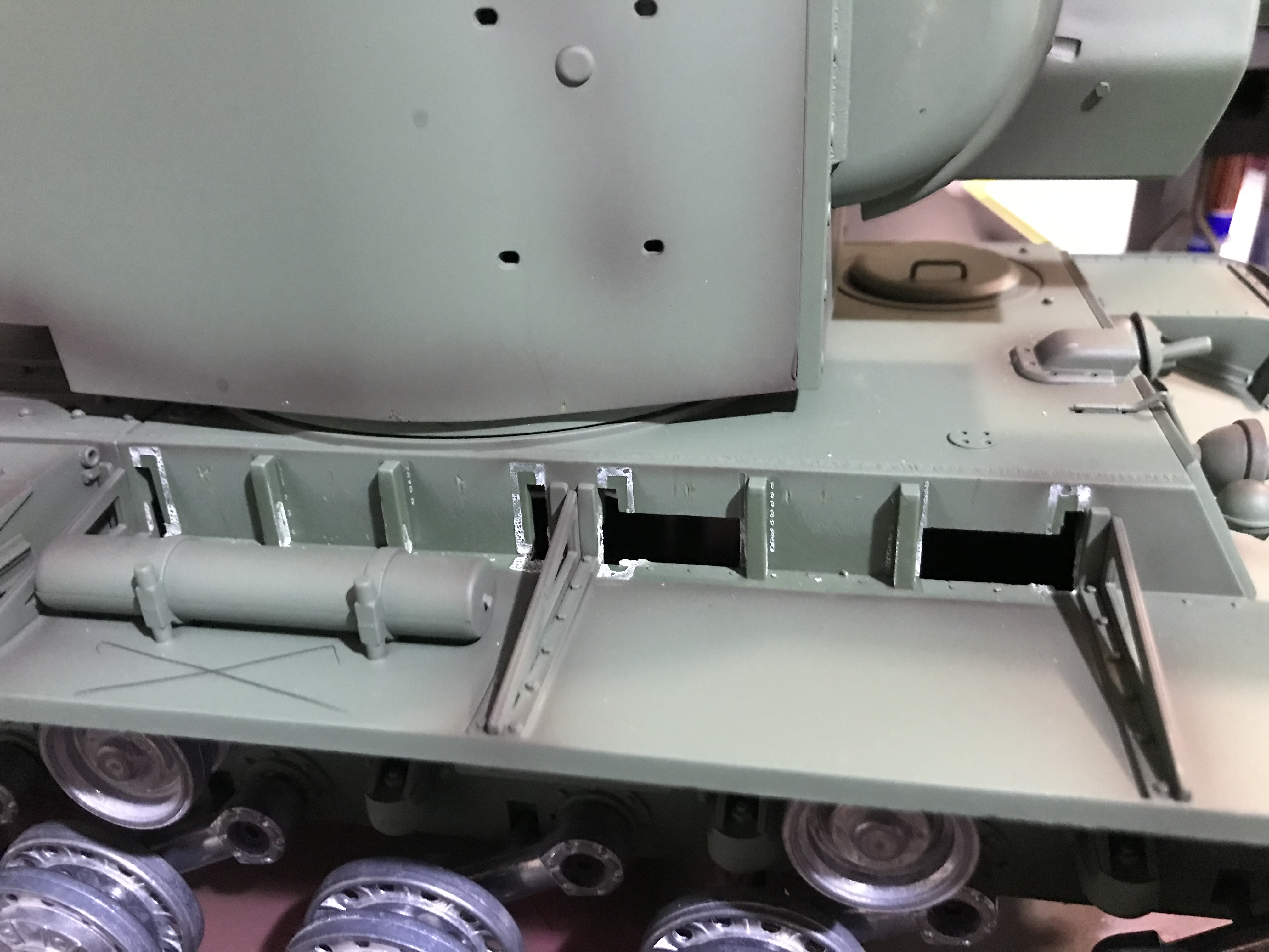

I know the Taigen lower hull armor was pretty easy to remove. All I needed was some plastic rod inserted into the holes left over and trimmed flush. Have fun with the build.

The lower isn’t too bad mate, the upper though has a load of gaps on both sides.
I need to close those off and open the engine deck louvers under the mesh to at least let a bit more sound out.

It was a bit a pain in the butt, but I opened the vents up on mine using a small razor saw. I just ran the tip of the saw back and forth along the vent line until it opened up a small hole. Once a small hole is there the serrations on the razor saw make quick work separation the louvers. After opened I have a bunch of emery boards to sand between the louvers and clean them up. I didn't want to completely cut the louvers out and build my own. You don't really see much of them under the mesh once painted anyway so they don't have to be perfect.

They are a p[ain, but mainly because they are smaller than the T34 ones.
i've done enough of those to get the hang of it as have you !!
I will make brass slats and then muck around putting mesh in the frames to remove the solid plastic that they are made in.

It's coming right along! Those vents are a pain but a nice addition when done right (upside down smoker mounts on upper can be a pain as well ) Following along!
