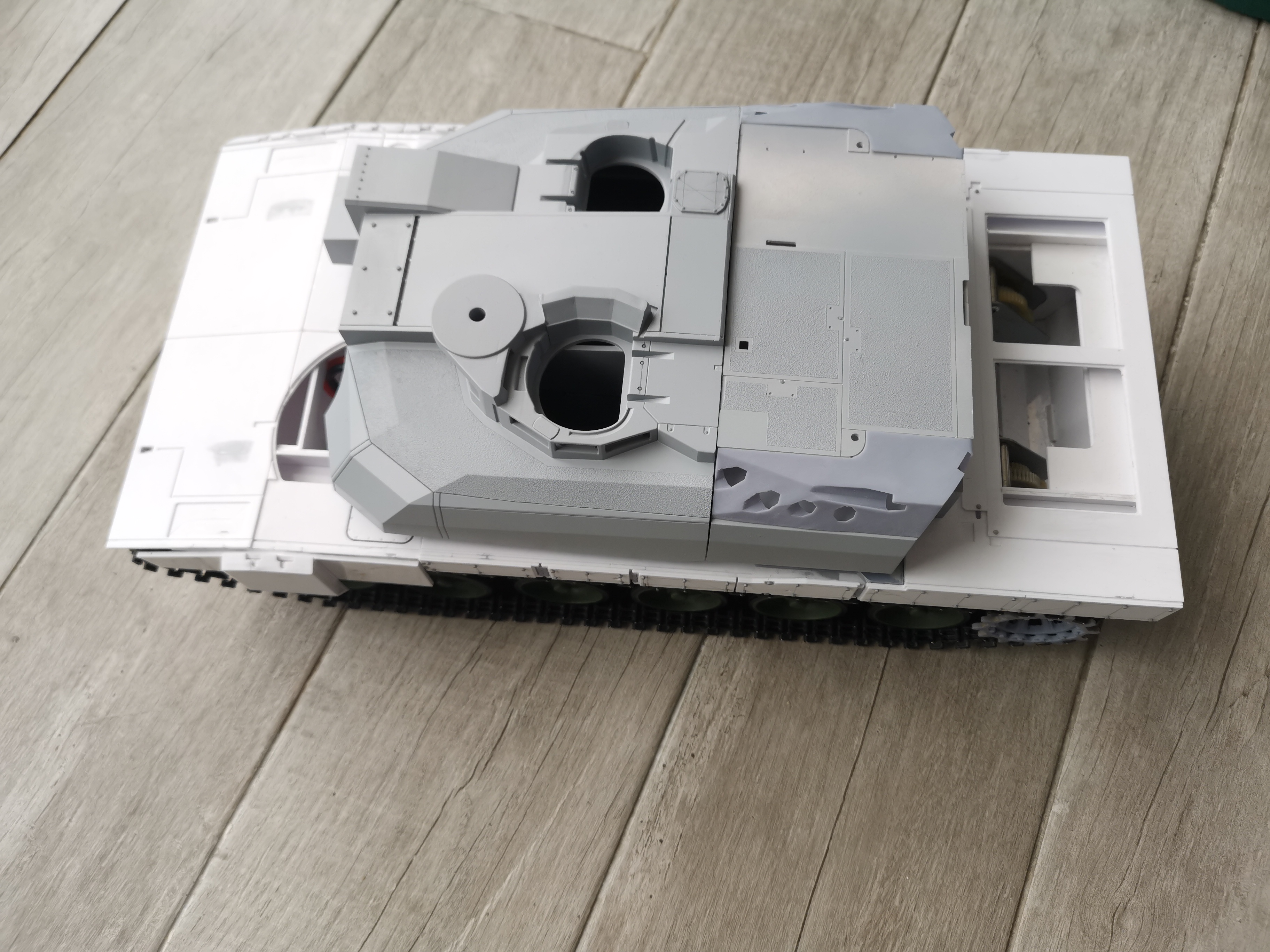

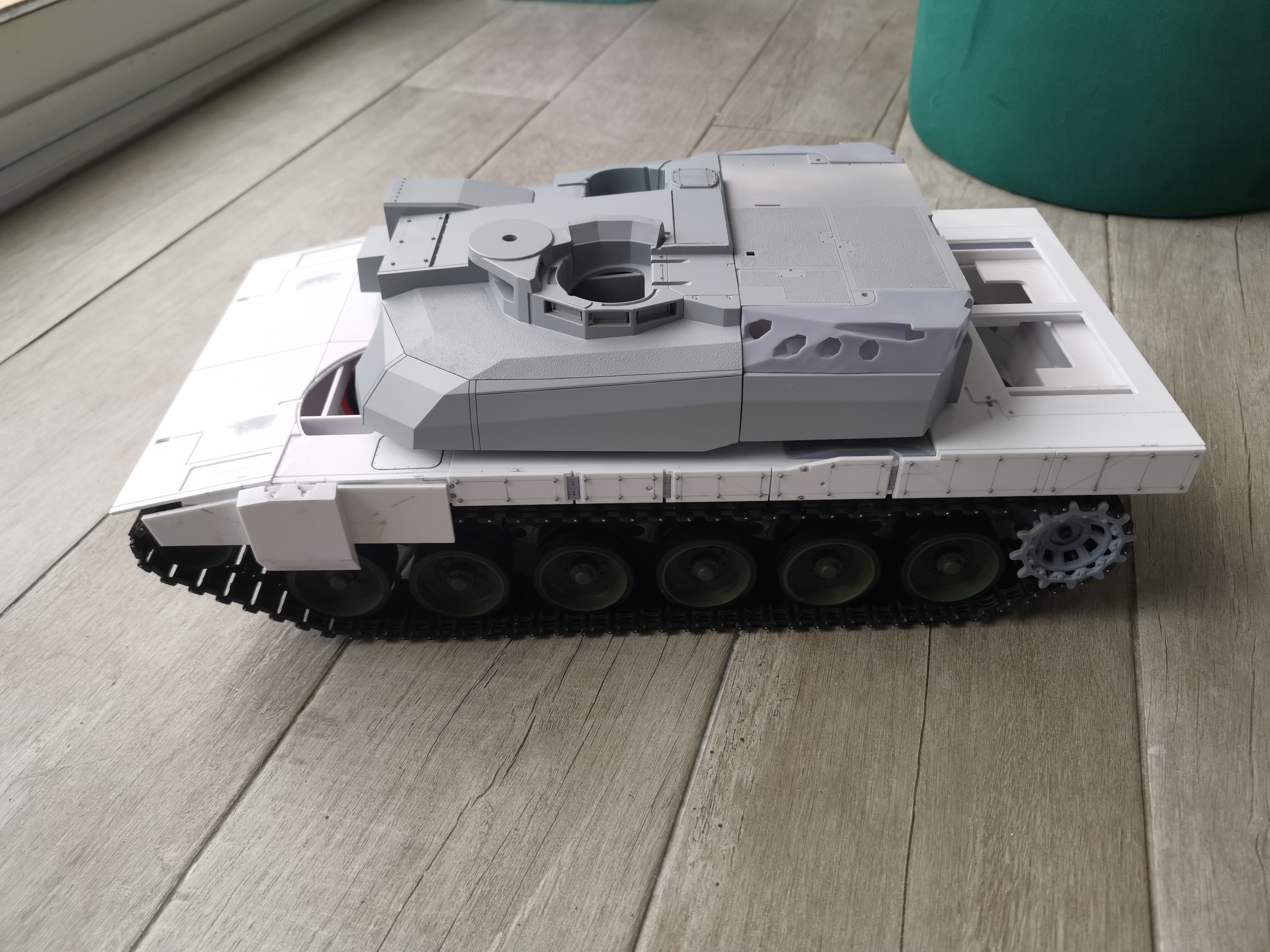

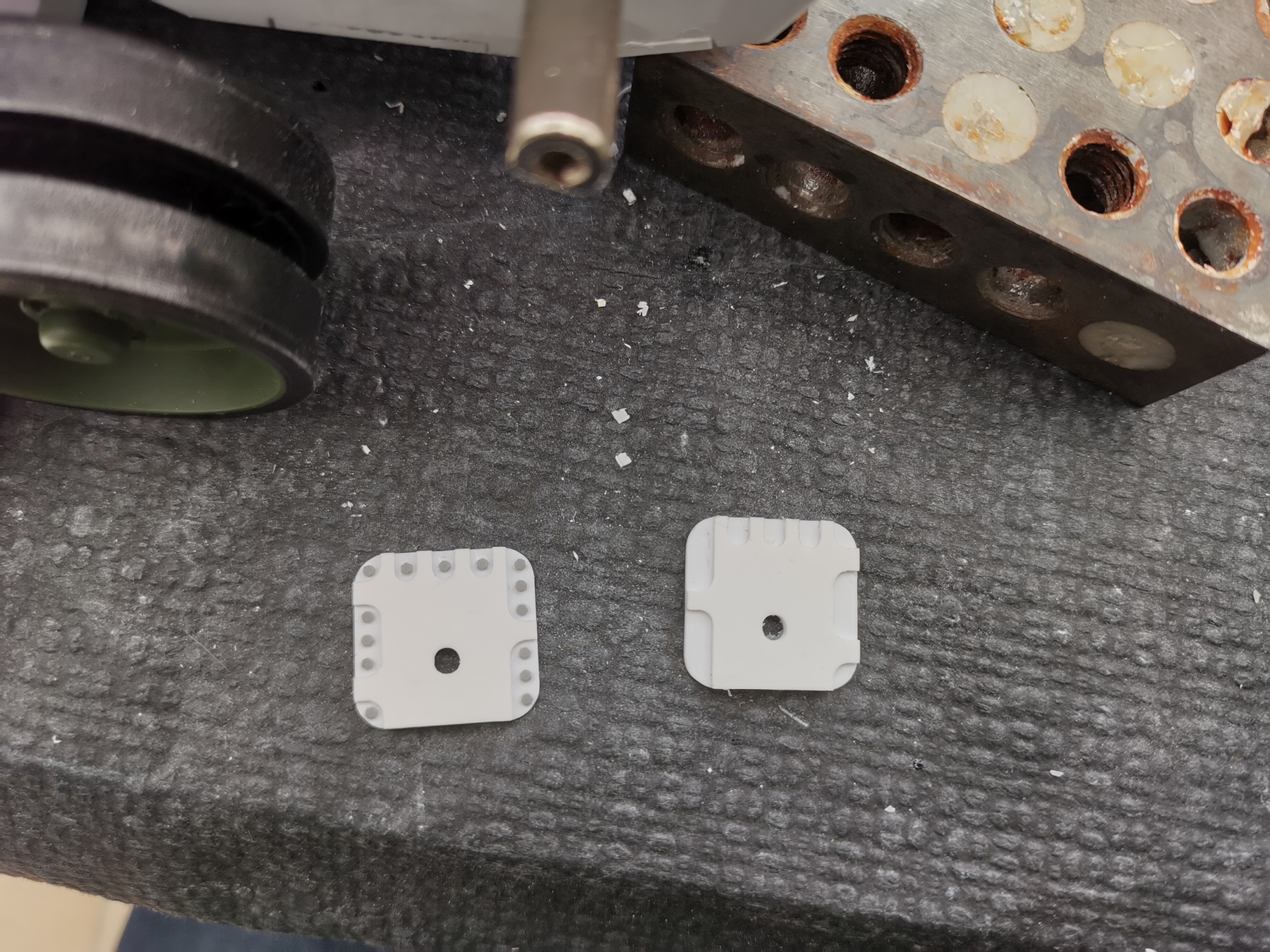

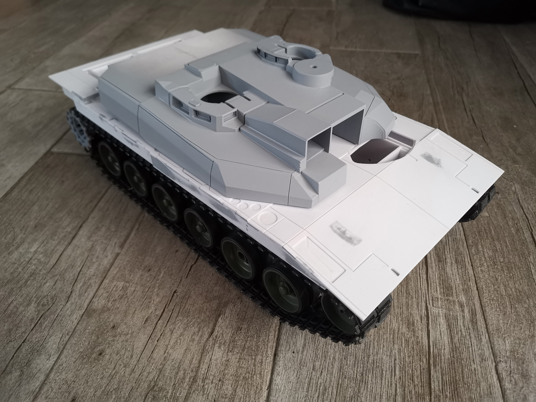

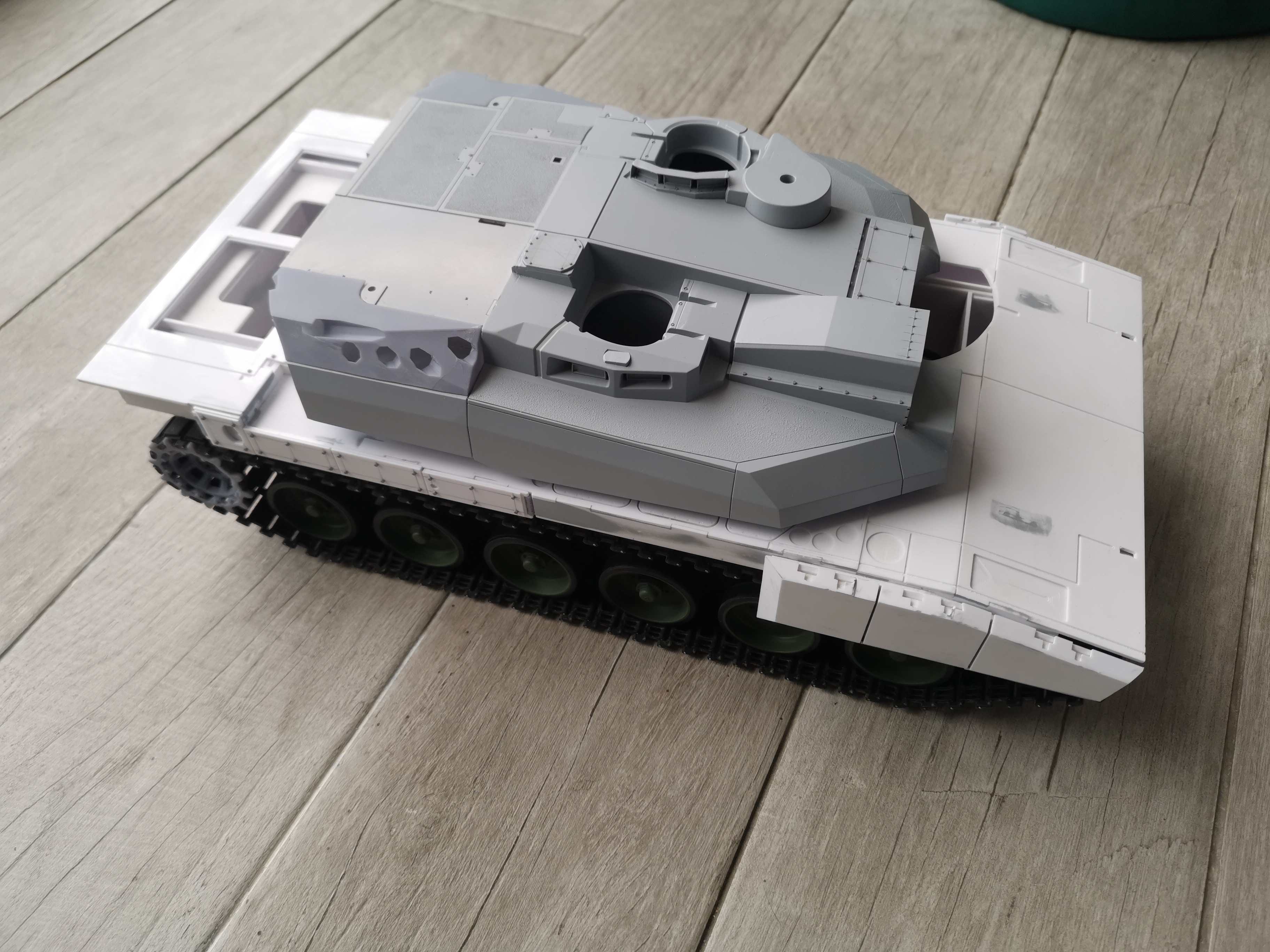

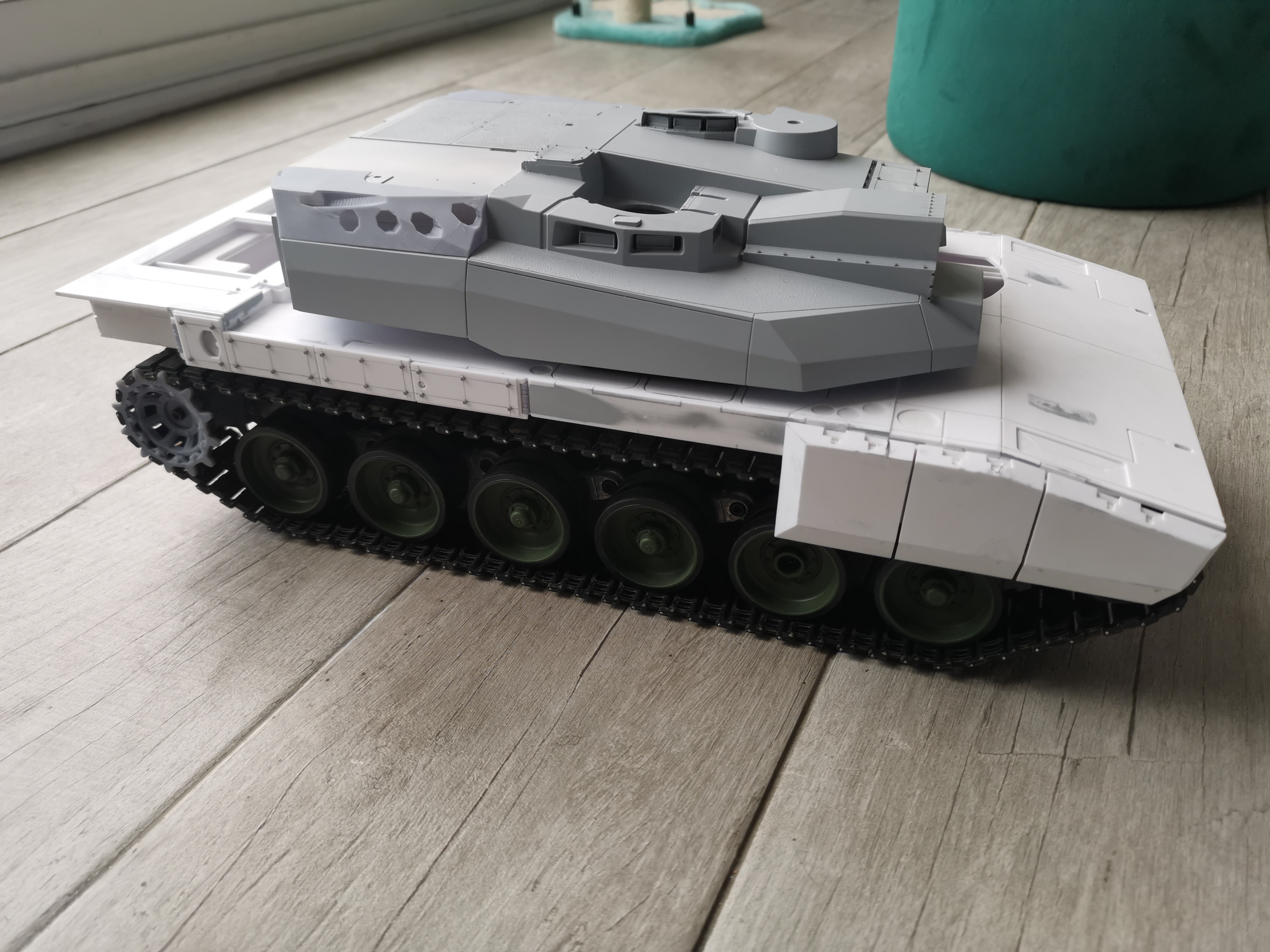

Hello, I made some progress. Actually the tank is running. It's running well, pretty well, however I'm using the HL Leopard idlers, I will made custom ones (slighty larger diameter), the return rollers are not made yet and the standard HL leopard suspension spring are a bit on the weak side, I need to find stronger ones because the Leclerc is becomming heavy !
Support bracket of the idlers, just for fun because they will never be seen behind the idlers and the side skirts.

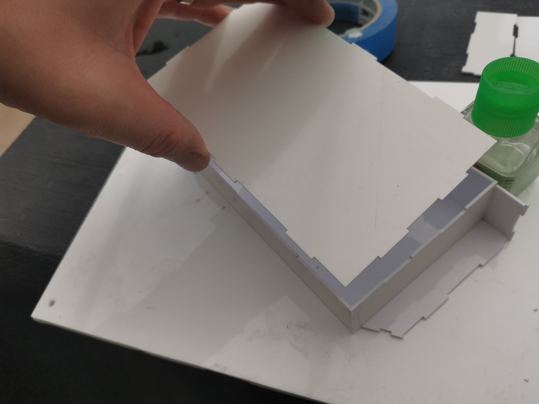

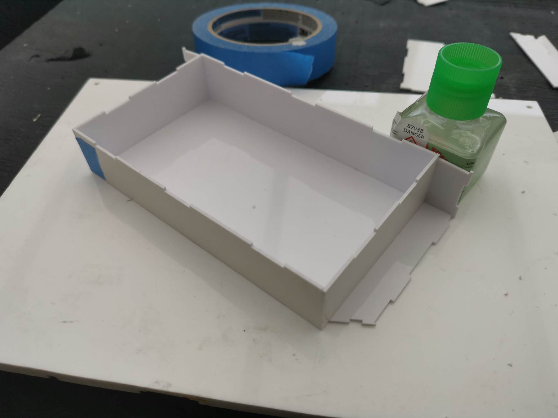

I've built the rear of the turret (the auto loader, I still have to build the top rear, storage boxes and A/C).
Everything fits well

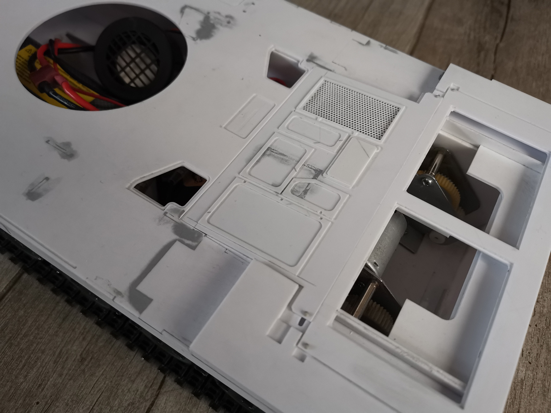

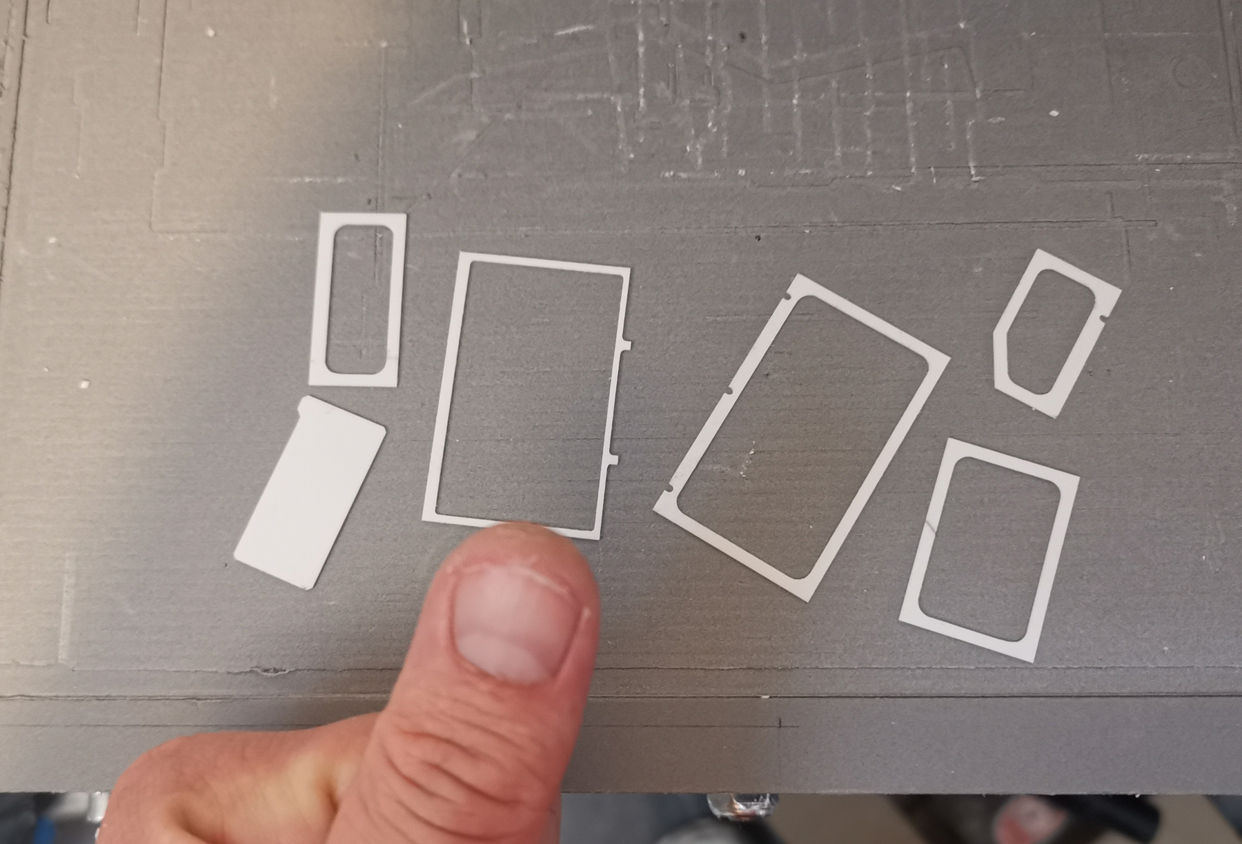

I've started to build the engine deck, I'm not sure yet but I think I'm going to hinge the engine hatch. The hinges original hinges are easy to reproduce.

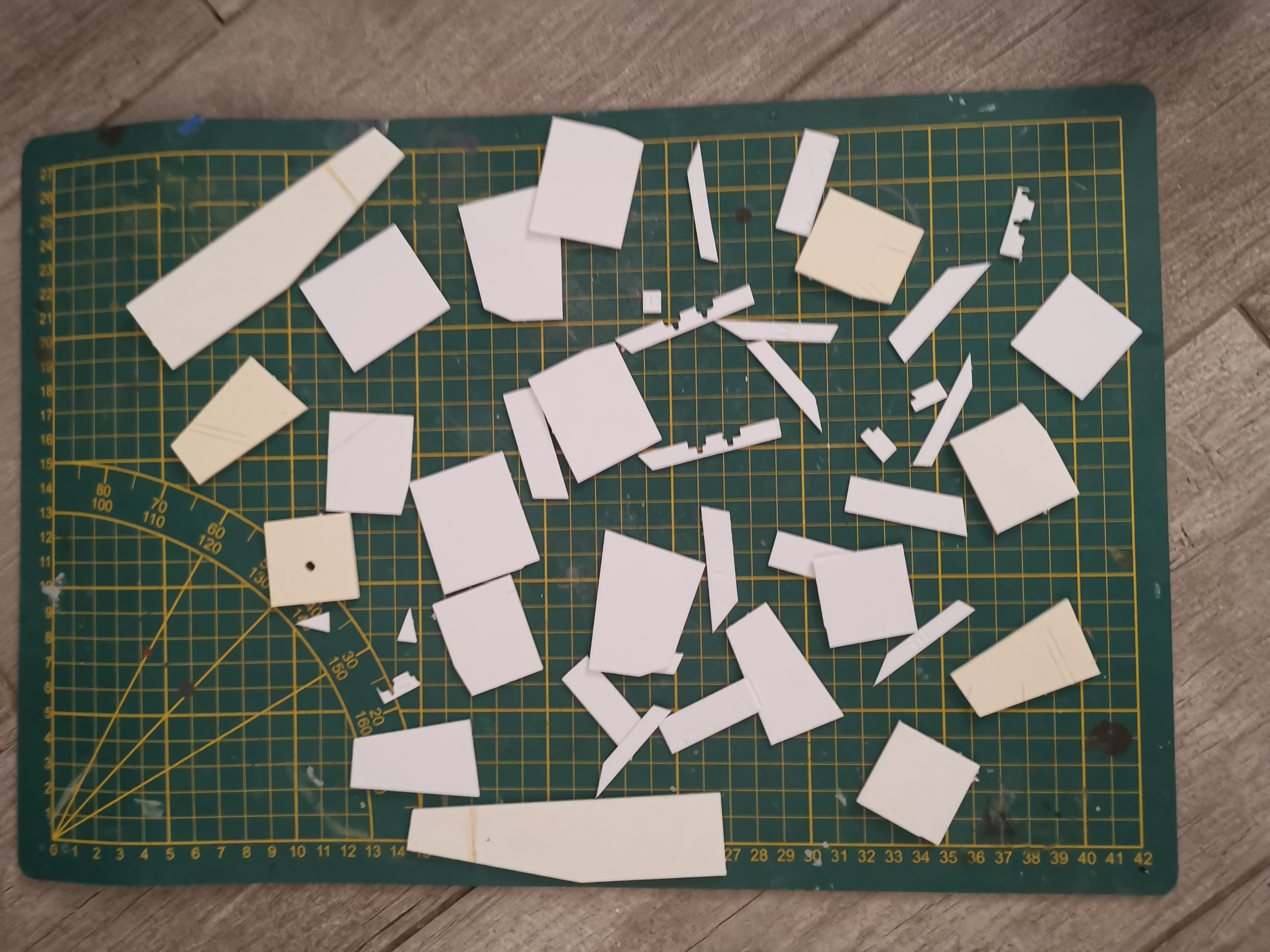

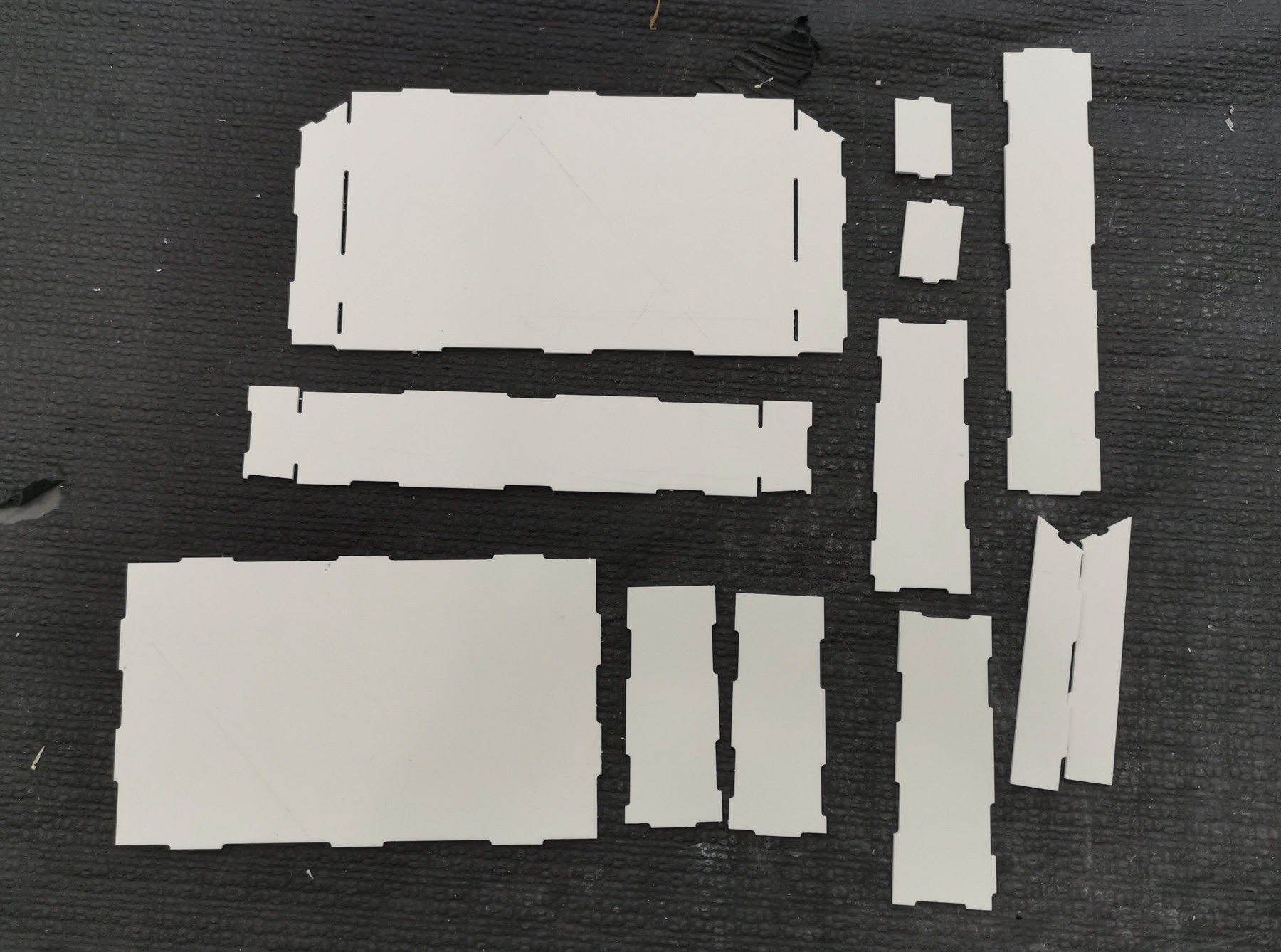

The small frame are 0.5mm styrene cut on the CNC, worked well.
The frame that frames (:)) the holes is not glued yet, I have to find a very small mesh. I think I'm going to use nylon pantyhoses for that, once stretched a bit, it should work well.
You can see I missglued one of the frame, I have to remove it and putty the gluing marks :)
Thanks for watching !

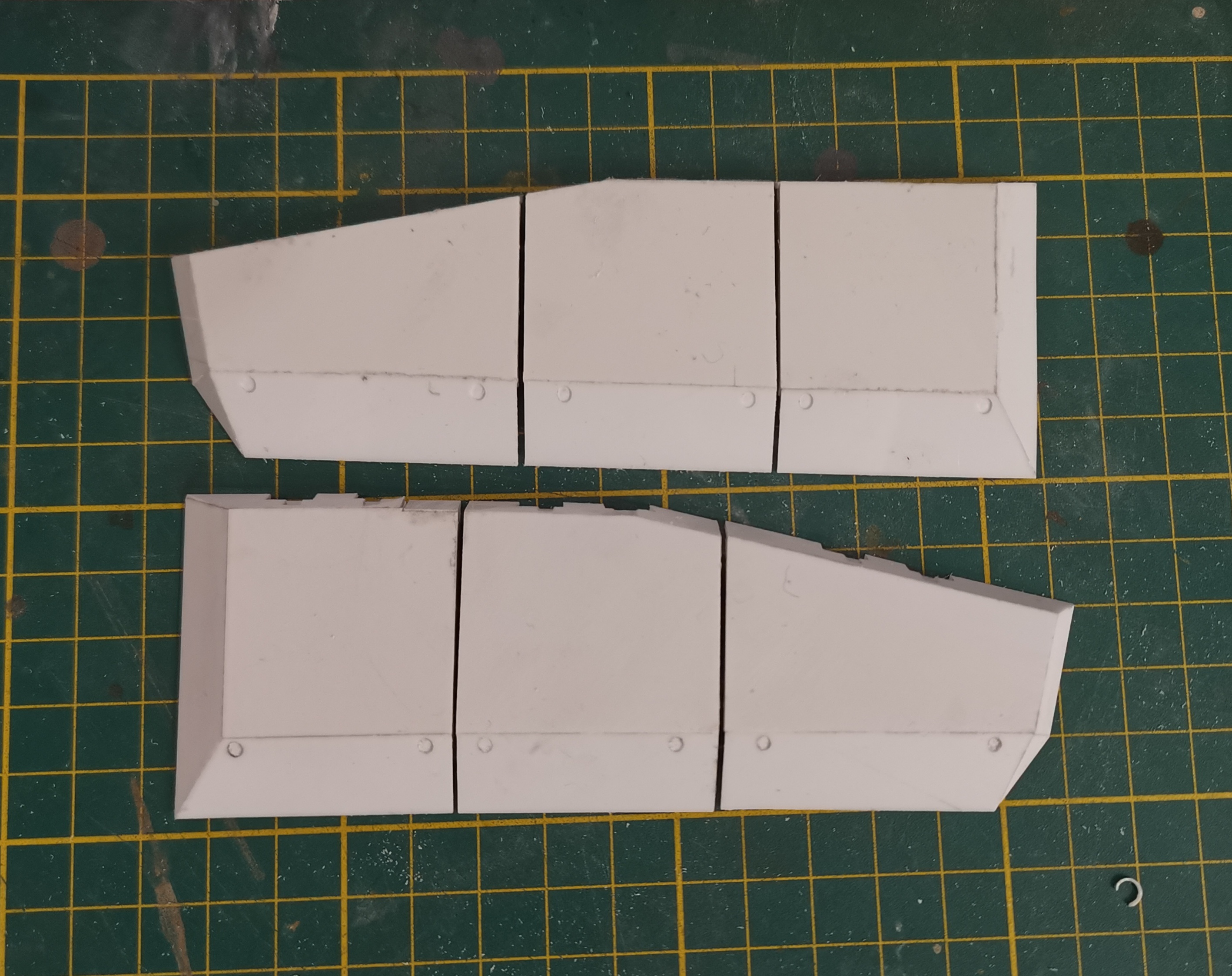

I've built the front side armored skirts. Where are the instructions please? 😁

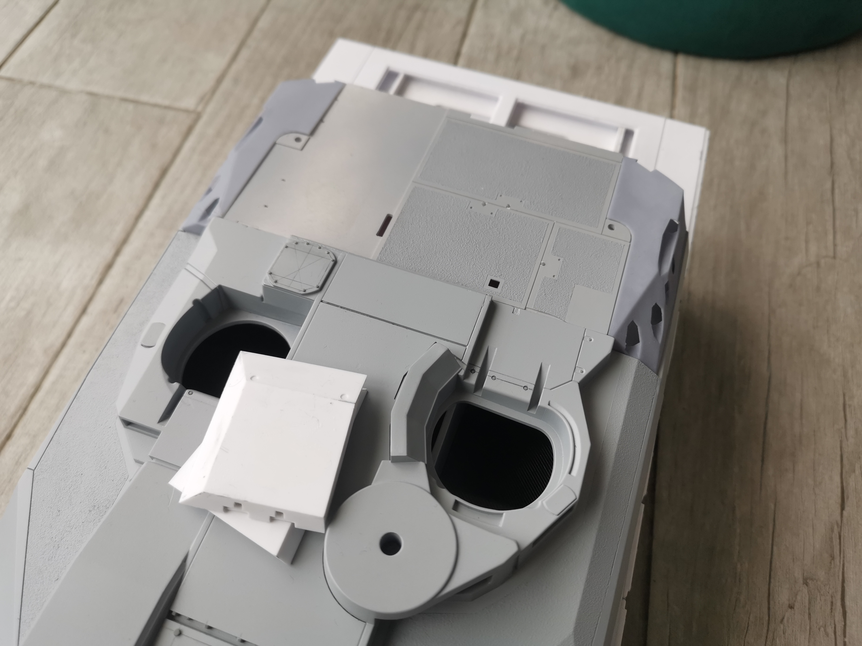

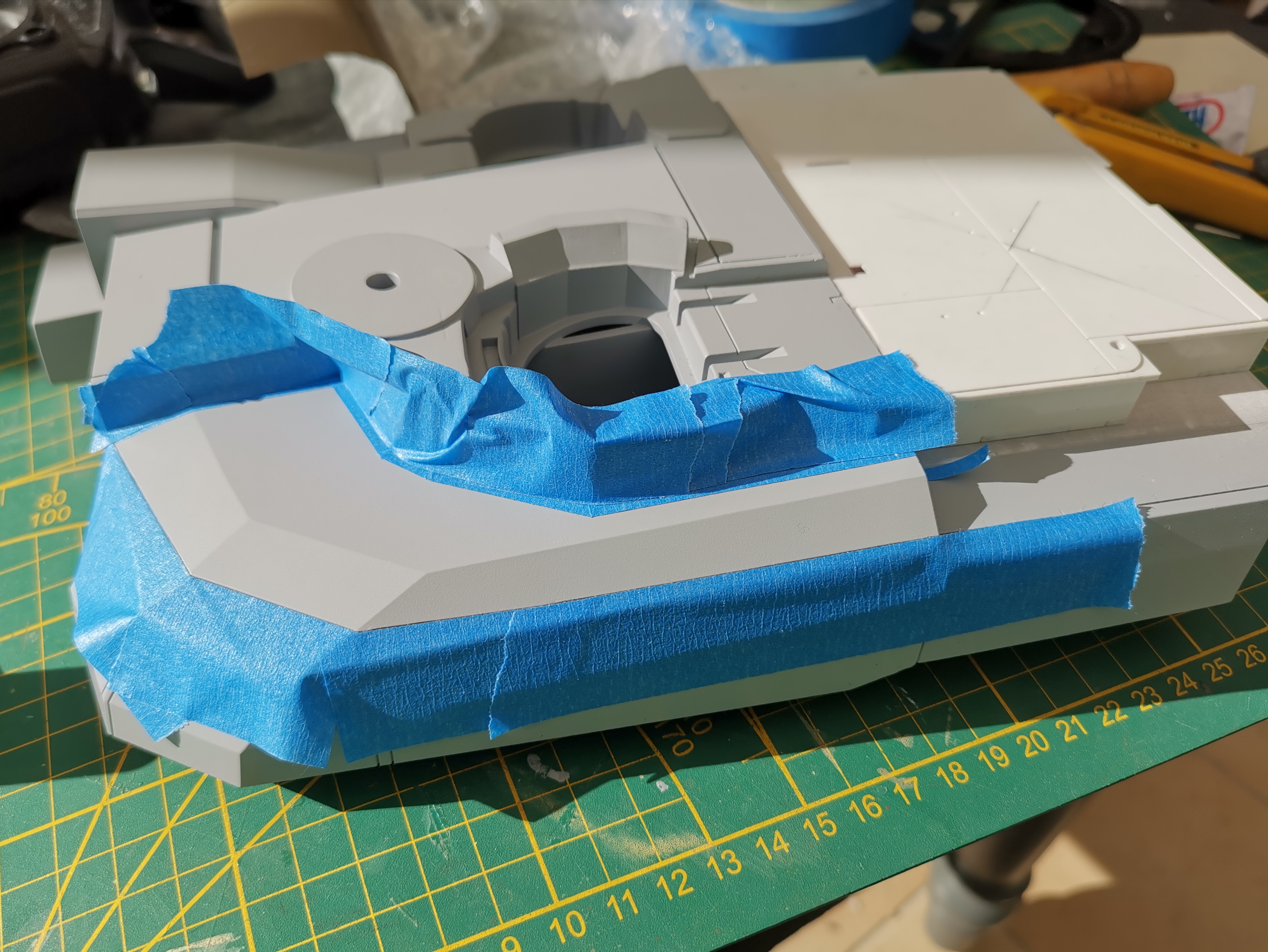

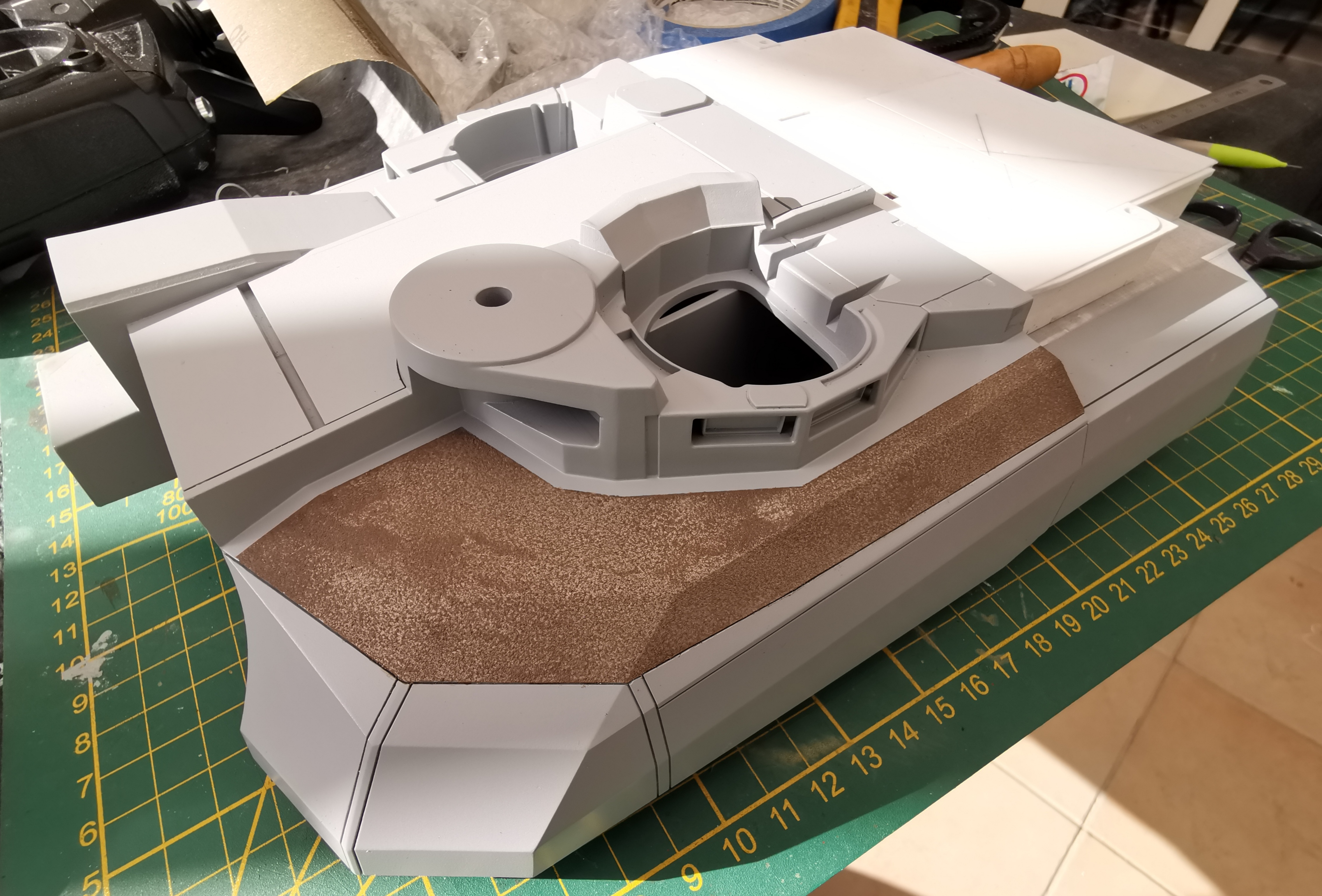

I printed a new front turret, the first one was not wide enough (thanks Tamiya for being wrong on that!).

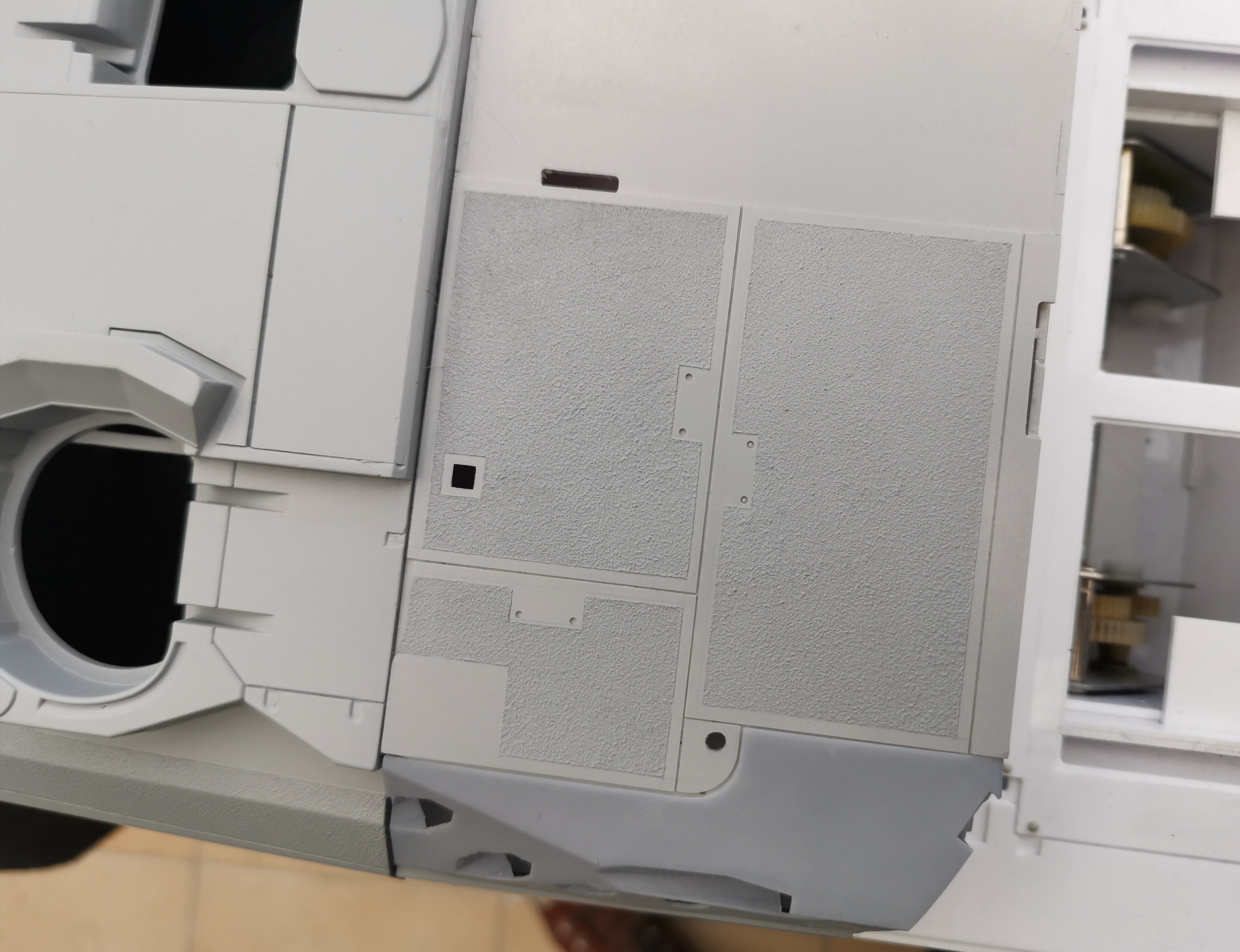

I've used Ammo anti slip paste for the textured effect, worked nice.
Bolts are from Meng.
The smoke covers are 3D printed, there are very thing (0.5mm) and quite large, they need some more clean up and some styrene inside to get them perfectly straight.
The side skirts are just put on with double side tape for the pictures (some panels came off! Too shy probably :))

This was my first attempt at using Ammo anti slip paste.
Close up on the rear ompartment of the turret :
