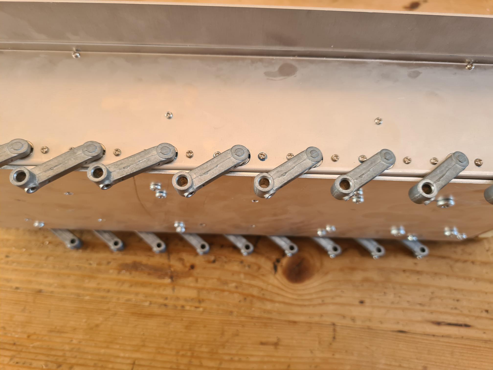

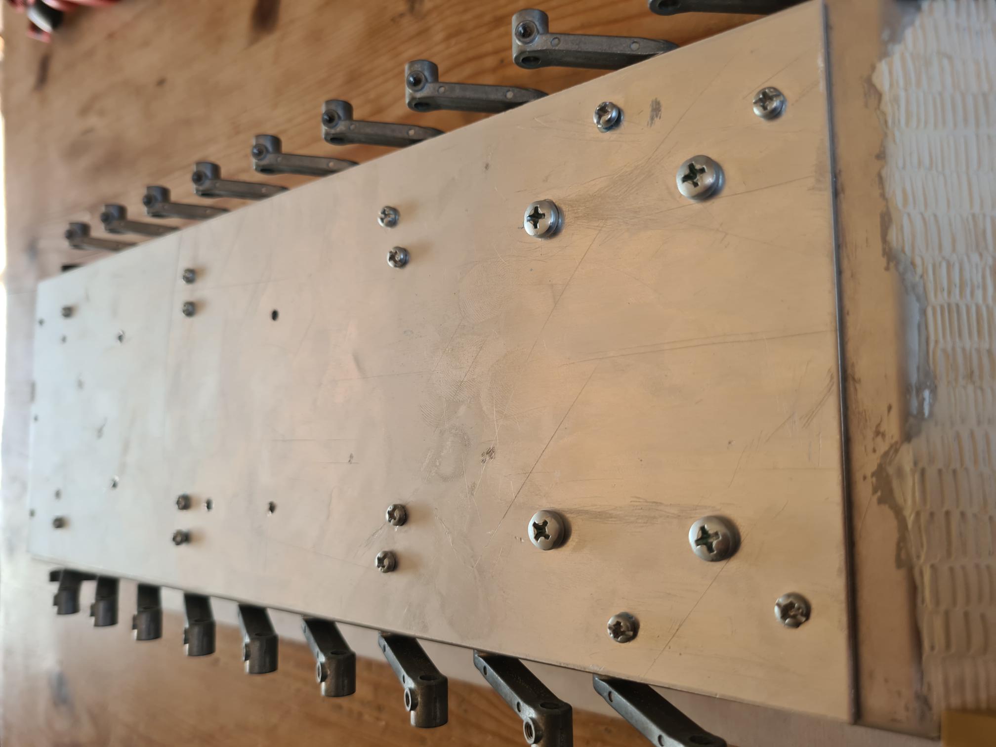

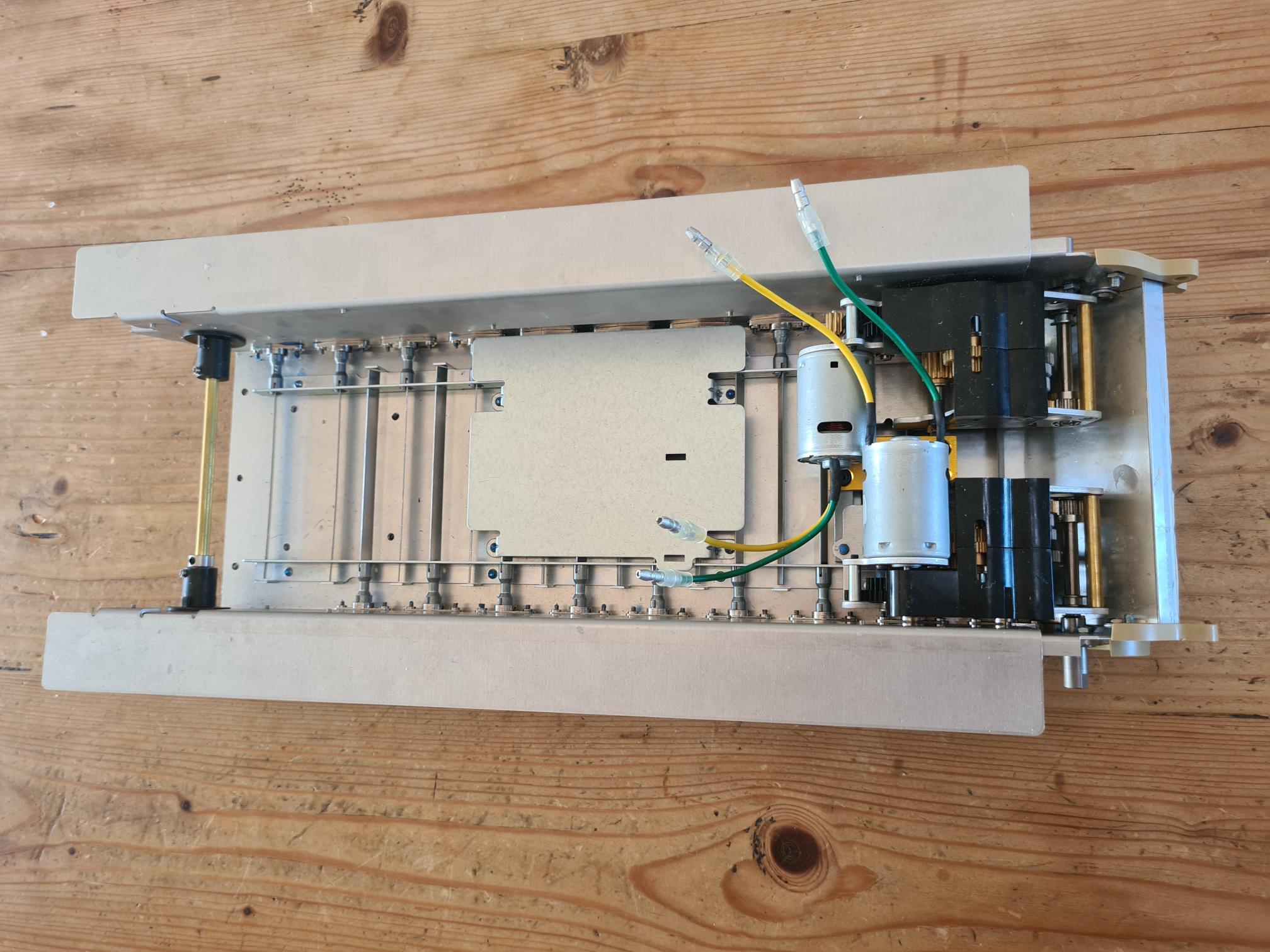

So first thing I did was get some aluminium 2mm plate cut to size online and fitted a belly plate, also have put in the DKLM brace (which needed me to get some slightly longer screws as the belly plate added some thickness). Hopefully this will stop any flexing at all, the tub does feel really really strong now
Have got the motors fitted obvs on top of the brace, also put in the axel support bearings, now these clashed with some of the kits screws, I should have gone and got a countersink however a razor saw and taking off a little bit of the supports was quick and dirty. theyve still got their integrity and to be honest i couldn't be arsed with messing about. :D

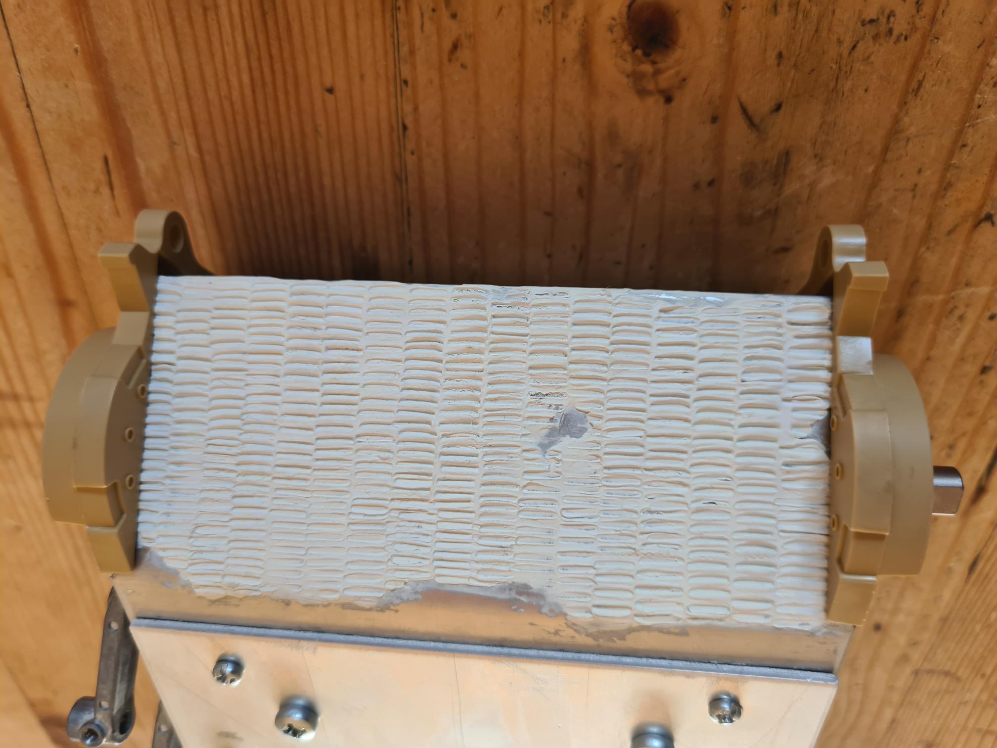

So after that I needed to get the kit actually built, the roadwheels are all put together, however i dont think anyone wants to see a pic of that! Next bit was to get the zimmerit on then start adding the voyager phot etch. Worked with PE a bit before, kinda like doing it, adds a lot. Anyway some pics

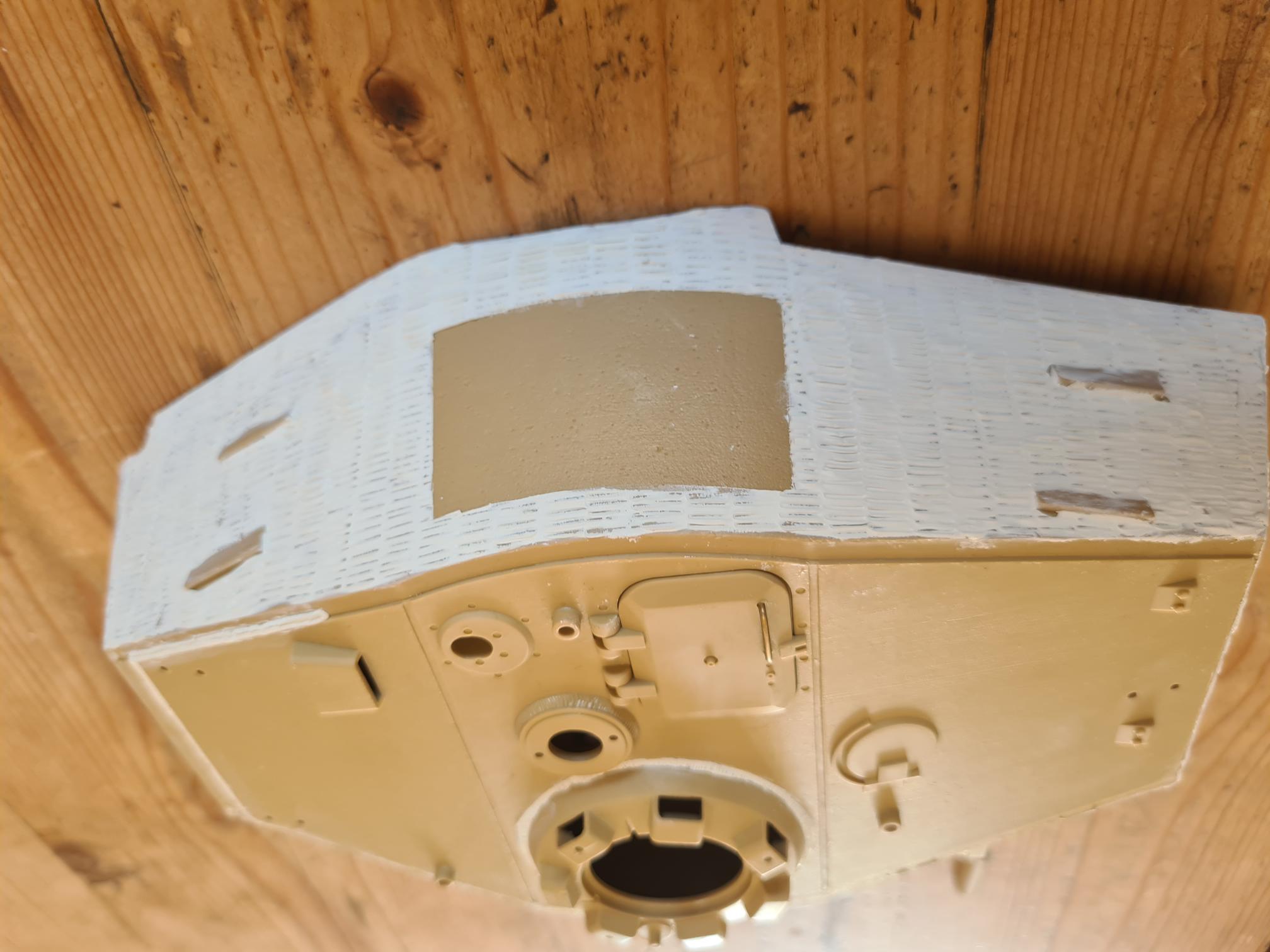

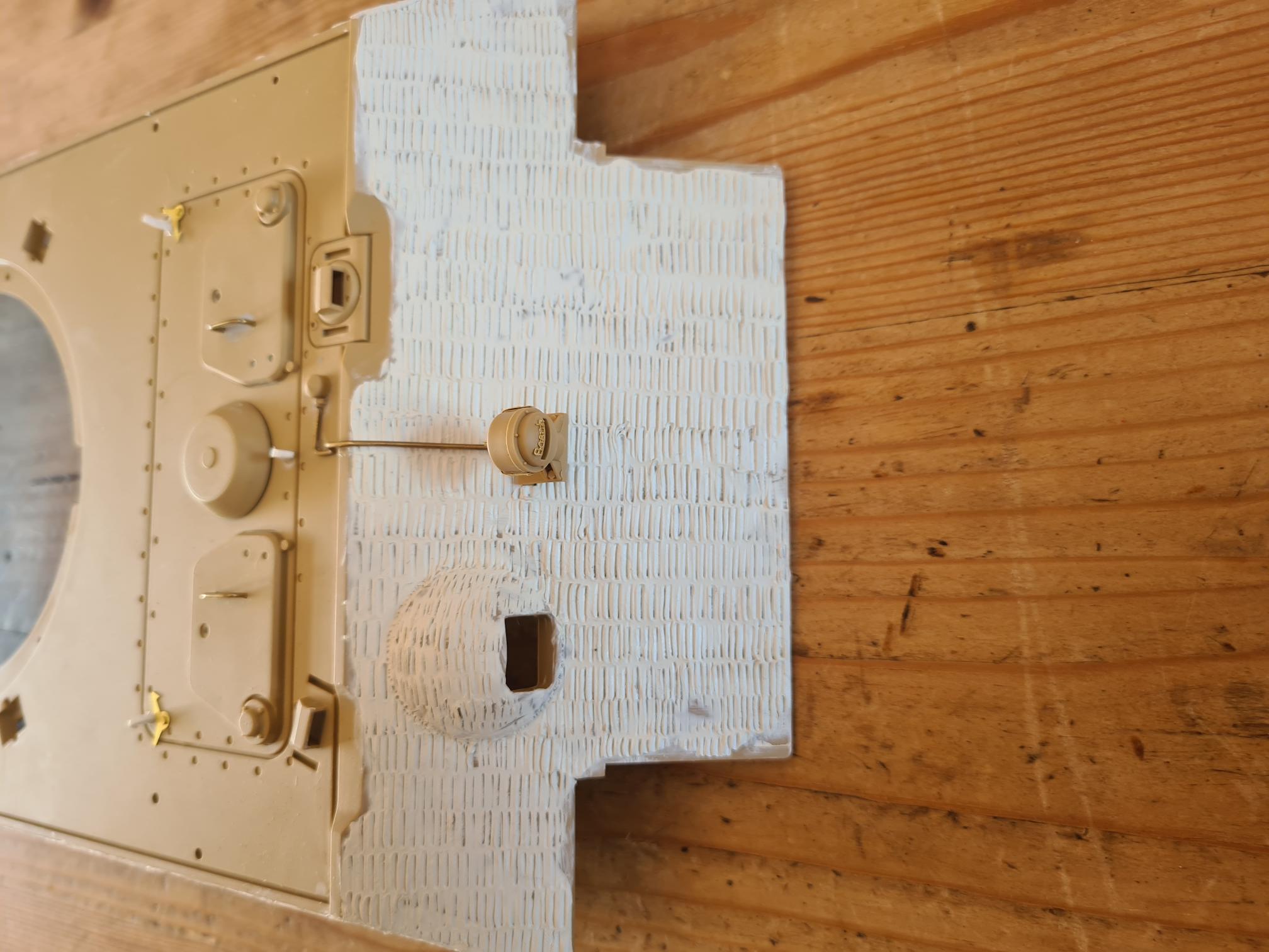

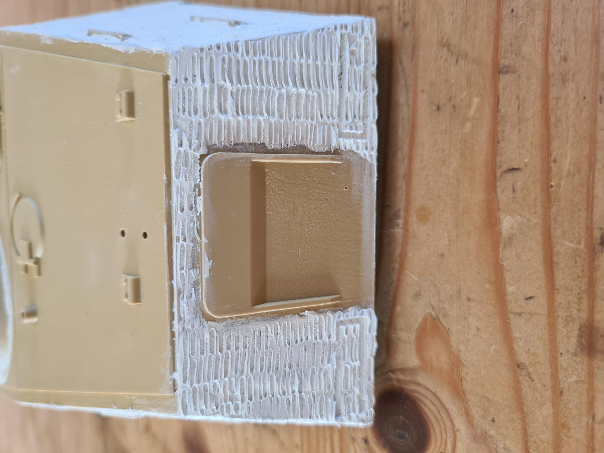

Front glacis with the zimm done (milliput and screwdriver), have also removed the moulded armoured light cable and bent a replacement brass one up

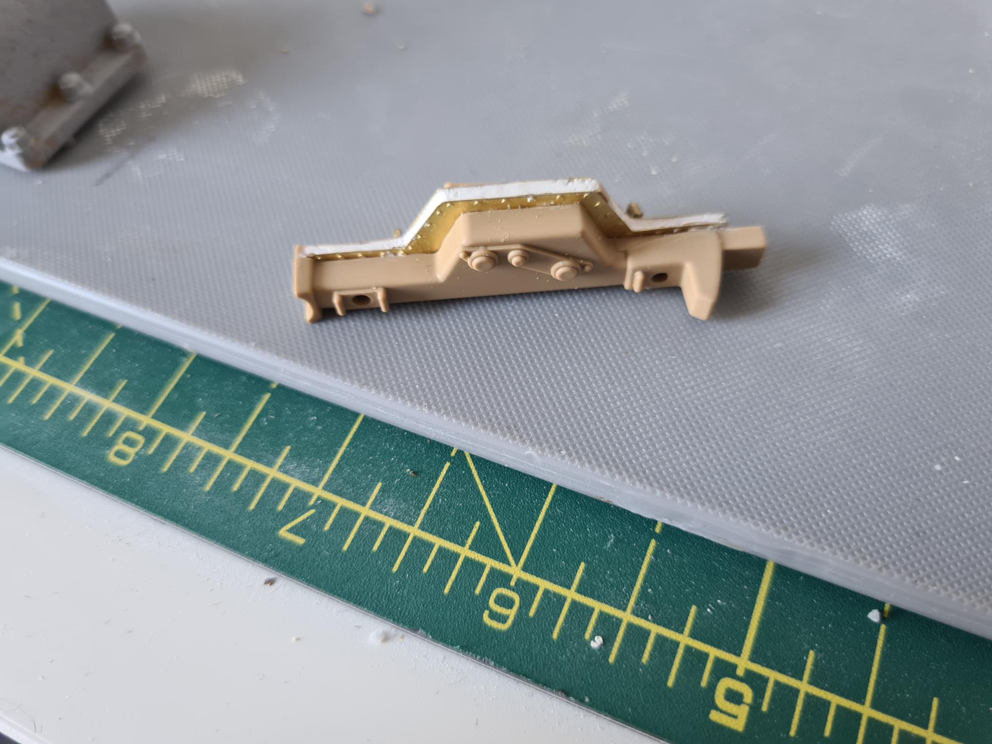

Have fashioned some plasticard lifting lugs for the front, best thing about armour is that if thse are a bit rought it doesnt matter as they took some hammer in the field i'd say! The stupid moulded handles removed and brass wire ones bent and fitted

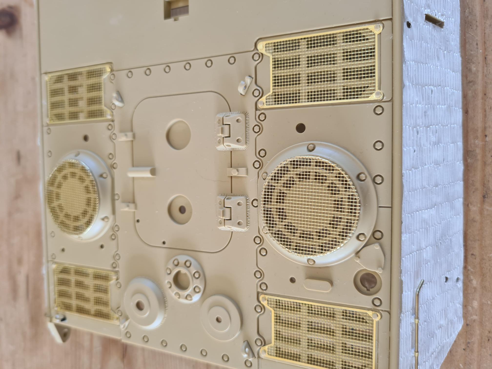

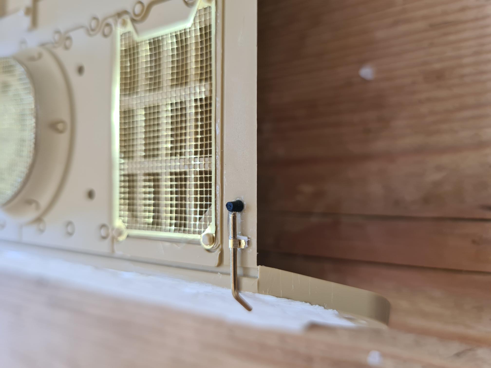

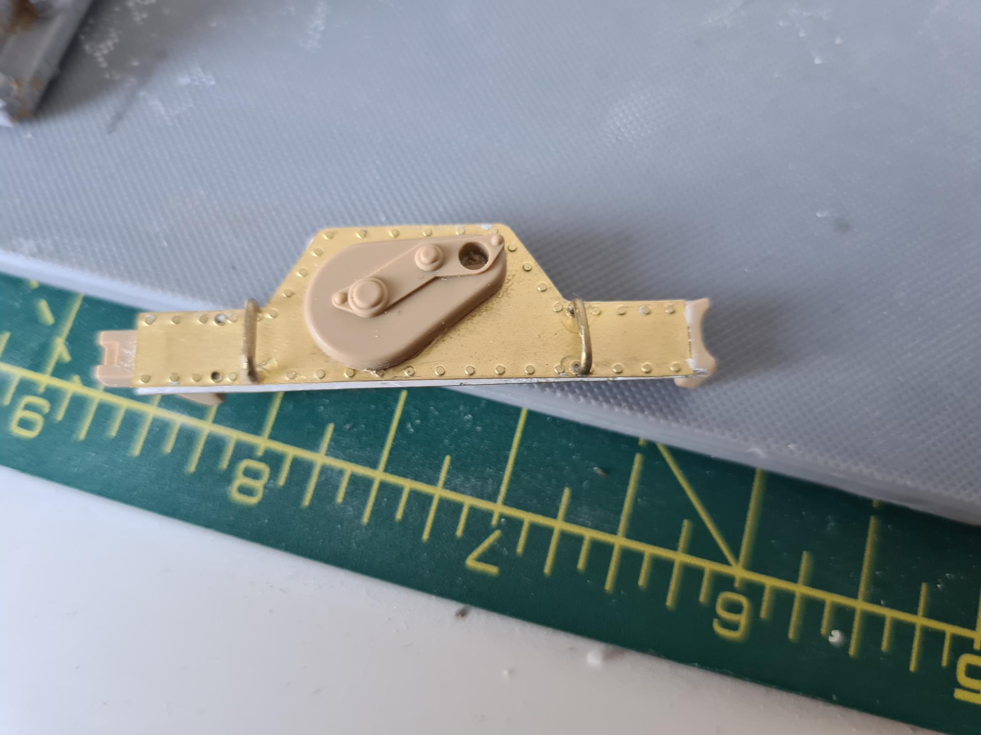

Fitted the vent grilles on the rear deck, snipped off the moulded nuts and then glued them on top of the grilles after. Roughly bent some brass wire for the air intakes then put the circular mesh on top. Also knocked up some overflow from brass, PE and plasticard too

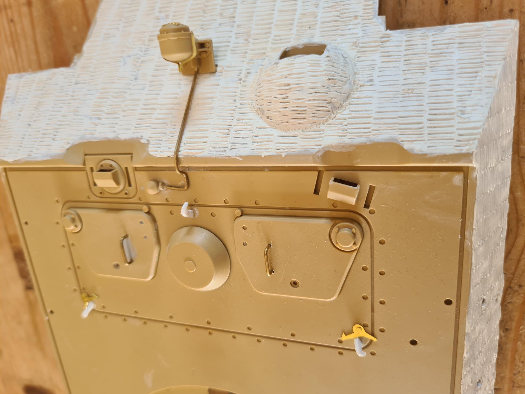

Put the zimm on the rear, have used the original jack mount as the PE one would just be too delicate. Want to use the tank after all!.
Have put most of the zimmerit on the turret, left space for the charging knight marking, which i did by masking. started the weld lines for the turret too

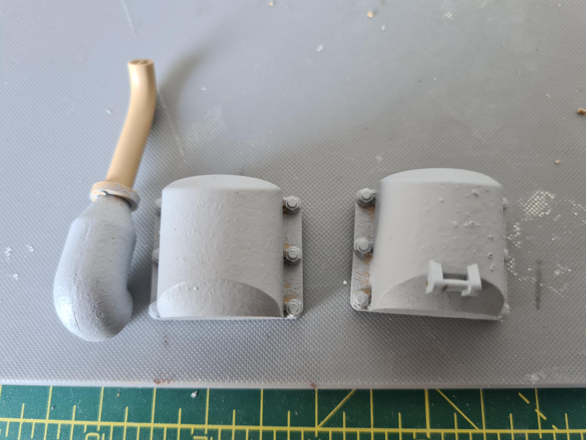

Have started to prep all the external pieces, exhausts, tools etc. Some Mr Surfacer for the casting on the exhaust armoured covers stipled on.

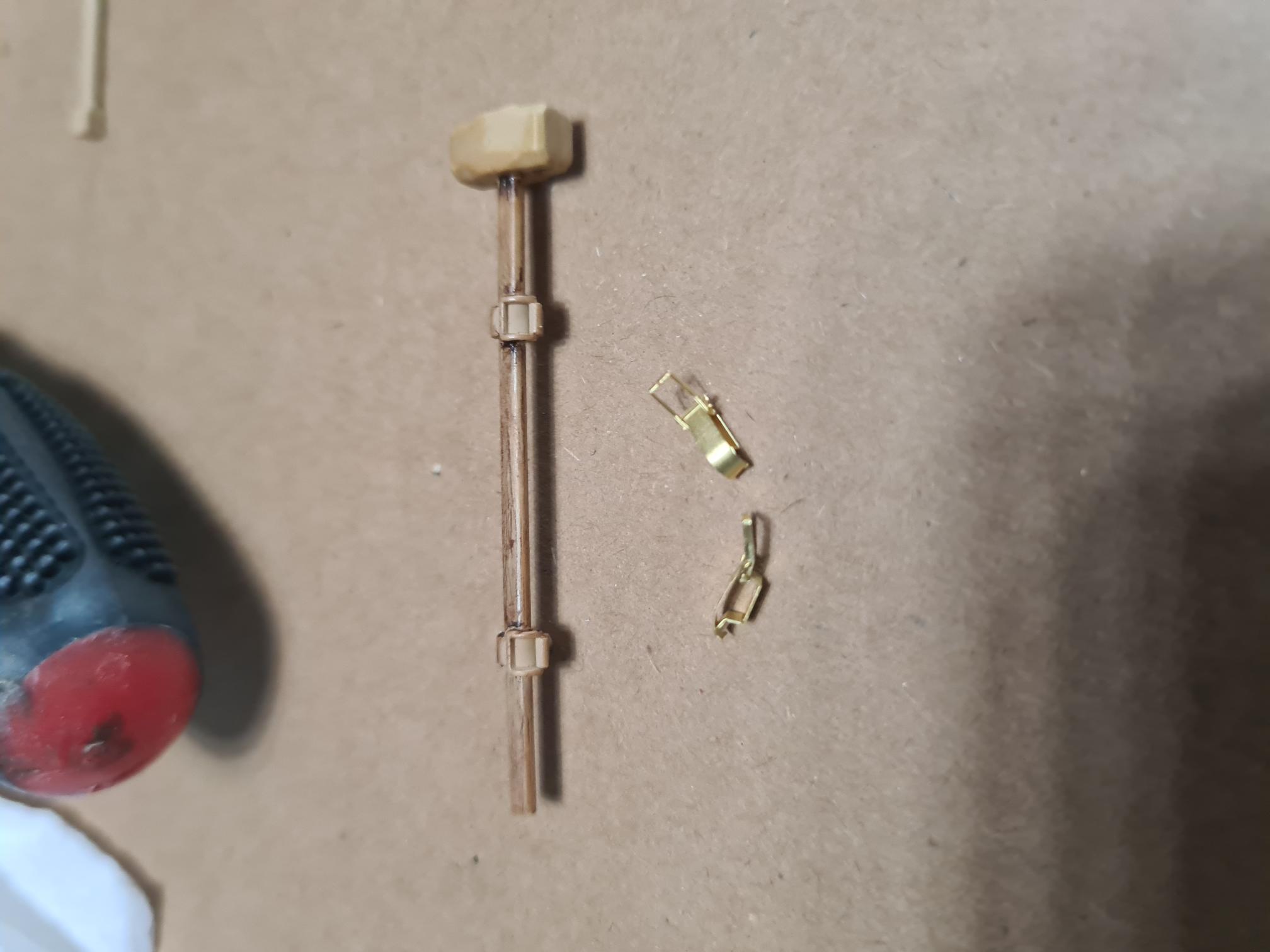

Cut up the jack which was not great and fitted the PE parts, not done yet totally however an improvement. Putty added to fill it out.
Have started on the tools and the PE clamps, these are tiny but add some good detail, have used oils to simulate the grain. Going to remove all the moulded clamps and then paint up the rest of the tools.

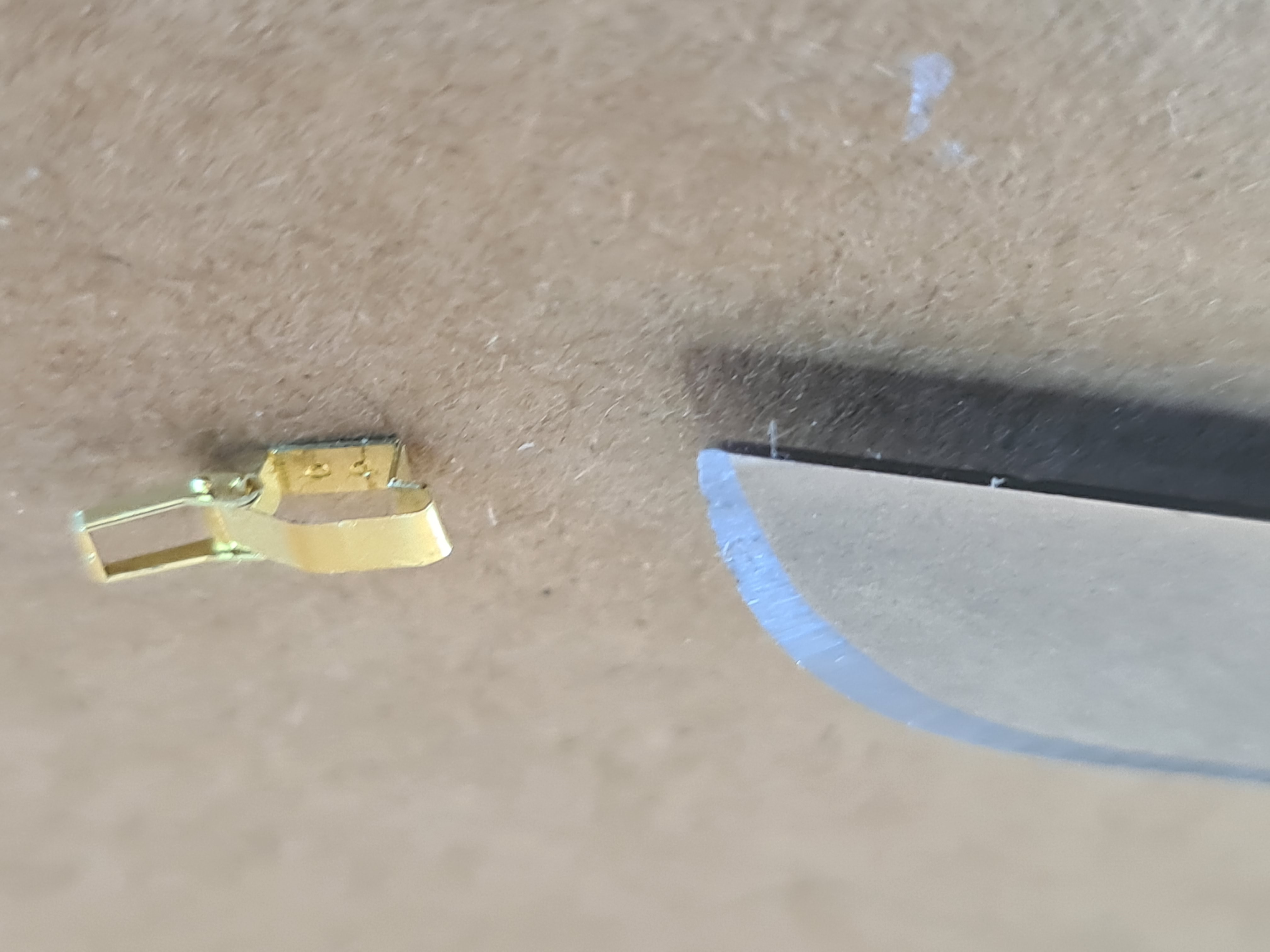

Thanks for the comments, did a little more today on the clamps. Fiddly but I am sure they will add a lot when I get them on the tank with the tow cables. Would recommend them if you have the inclination.ImageImage
